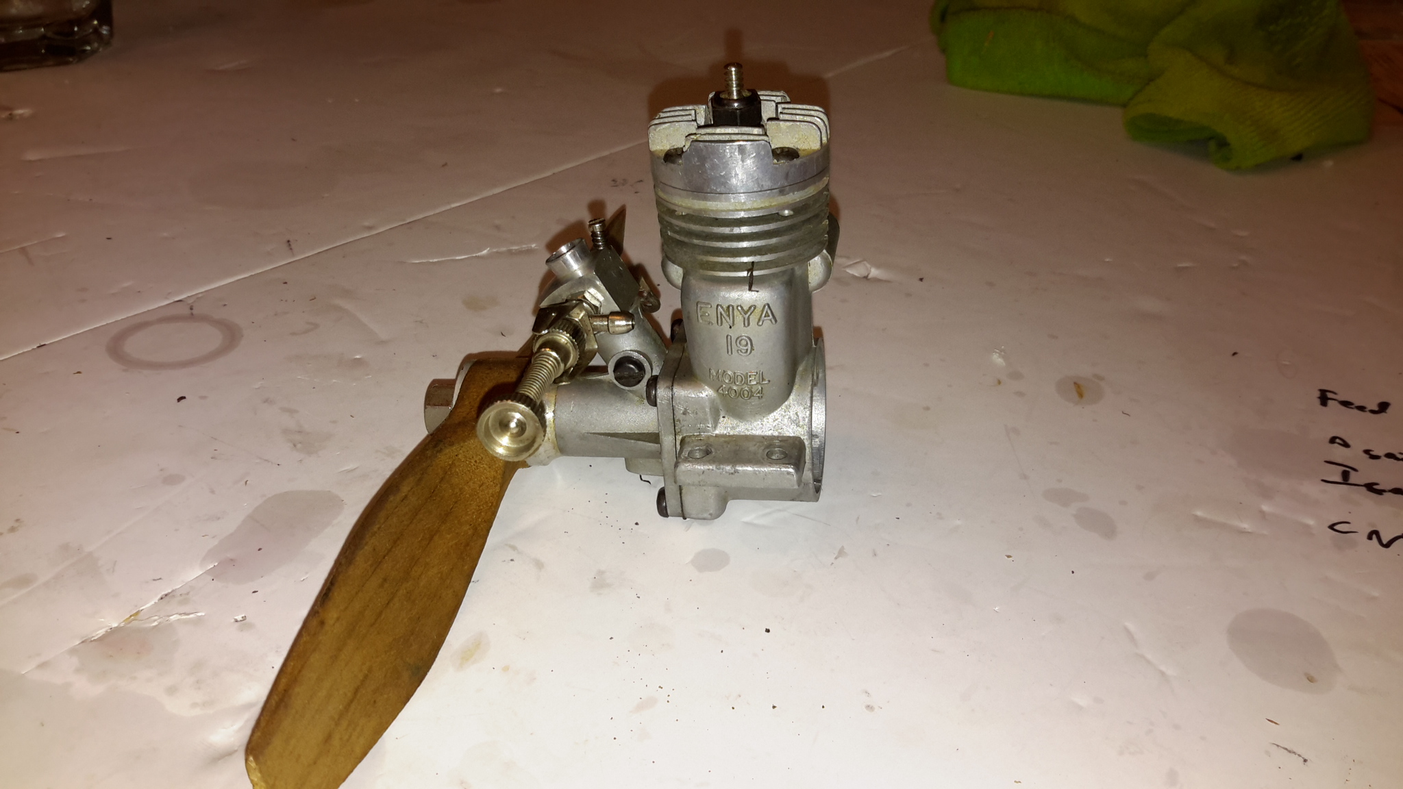

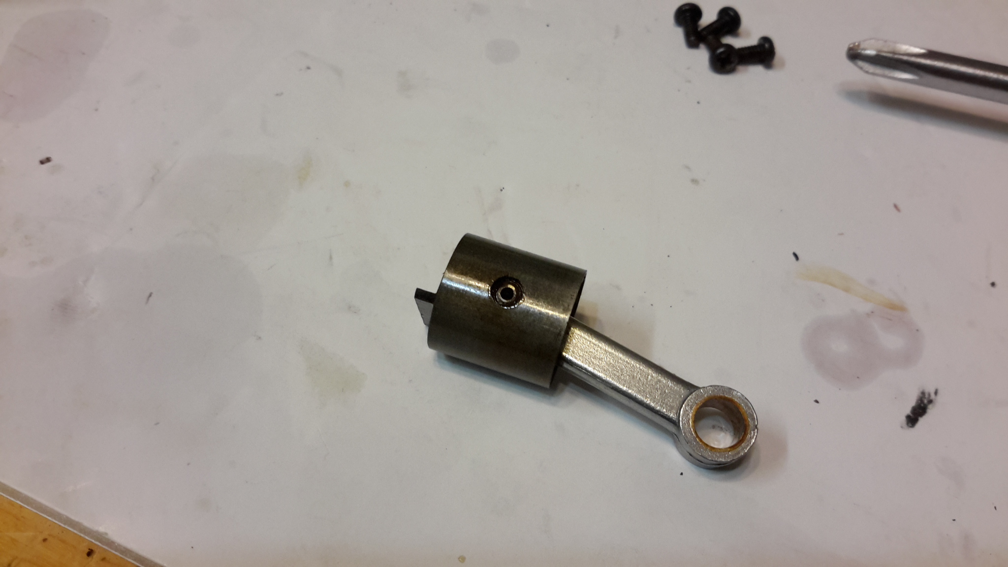

Well, it looks like I might need to revive a thread from the dead... I just acquired a Enya 19 IV today that was given to me after being found in an old barn of all places, along with a bunch of other stuff. When I got it this engine it was frozen solid, but otherwise looked to be in pretty good shape. So I went to work on it, got it free'd up, mounted it on the bench, and what do you know but it runs pretty good! The only concern that I have is that the rod seems to be still frozen to the wrist pin and the pin is turning in the piston itself instead of the rod rotating on the pin. I do not see any kind of a wrist pin circlip either? I have read where some of these engine have brass inserts on either side of the wrist pin to keep it place, but I do not know if the .19 IV has this or not.
Right now I can move the rod/wrist pin back and forth in the piston, but as I said the pin moves and rotates with the rod. If I move it to either side of the piston the wrist pin will protrude about .5mm one way, or 1mm the other. Do I need to soak the piston/wrist pin/rod to get the wrist pin free? And should there be circlips keeping the wrist pin located? As of right now I think my intentions are to build a period correct r/c airframe like a sig seniorita or a Goldberg falcon 56 or similar for it to go in. I believe a M153 strap on muffler will work with it as well since I will need a muffler to fly it at our field.
I hate to revive a 7 year old thread, but it is all about the Enya 19's. Thanks for any help!

Have you baked (heated) the piston assy?

The wrist pin should have brass pads either end and, although it's hard to tell from the photos, I think the pads are there. To free up the wristpin in the rod, put the piston back in the liner to limit the sidewards movement then, with a bit of heat or by filling the interior of the piston with acetone, use some pressure on the rod to start sliding it along the wristpin. Once it starts to move it'll free up quite quickly and once out you can give it a clean with fuel. Before you remove the rod, mark the side showing in the photos as the side facing to the back of the engine so it goes back into the piston the same way it came out.

Thanks, and I also do believe the brass pads are there. I left the piston filled with break free overnight, but it has so far declined to actually break free. I then heated the assembly with a heat gun while the piston was upside down in the case/sleeve. All I managed to do at this point was to remove the sleeve from the case itself even though I heated the piston/rod/wrist pin to 306f and then tried to move it back and forth with the pin captured like downunder suggested.
Right now it is soaking again, this time in acetone. To be perfectly honest, if it does not free up I am not sure I am going to worry too much about it as the pin is going to rotate in whatever offers the least resistance. Even if I get the pin free from the rod I do not know that the pin is not going to be rotating in the piston instead of on the rod.
So now I will give the acetone a chance to get after it. On another note does anyone have a good suggestion for a period correct airframe? I think it would be kind of neat to put it in an early to mid 60's airplane. It would have to be pretty light though with some good wing area. I am really considering a Sig Seniorita or something similar.
