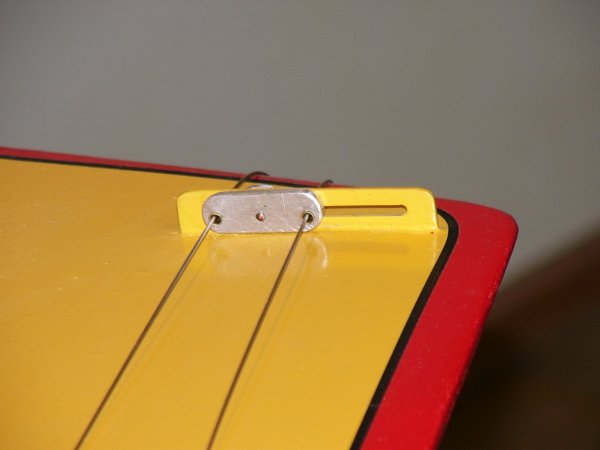

The position of the wires at the wing tip leadout determines how the plane flies, either nose in or nose out (yaw), and is more or less a straight line between the centres of the two wires at the wingtip through the CG of the model. It doesn't matter where the bellcrank is located. It's desireable to have a slight sweep back of around 1 1/2 degrees which means the centre between the leadouts should be slightly behind the CG. This is easy to see by just hanging the model evenly by both the leadouts and looking for a slight nose down attitude of the fuselage. That's what's showing in the first photo. Looking at that photo it's easy to imagine that if the leadouts were further forward on the wingtip then the nose wouldn't be pointing down as much.
But then there's the next trick. In the photo the model is suspended evenly by both the up and down wires the same as in level flight. However, when you're doing a loop or any other manoeuvre then there's a different force on each wire. Say you give full up, then there's more strain on the up wire but an equivalent amount less on the down wire. That shiftes the average position that determines what angle the model hangs to the CG so the yaw attitude in flight will change. To make that change as small as possible the two leadout guides should be as close together as practicable. With your leadout guide having 6 holes you'd have to choose the two closest holes that also gives the correct yaw angle. The trouble is you can only find that when the model is completely finished and ready to fly by checking exactly where it balances then fixing the leadout guide to give that roughly 1 1/2 degrees sweep back.
The better way is by using an adjustable lead out guide like in the other two photos where you can simply slide the guide in a groove by loosening the clamping screw. The one in the photos is just a roughy I made up for that basic stunt trainer I made for my son and the two lines should really be a bit closer together but it's good enough for the purpose.

It's often a real good idea to have the two leadouts on the same line with the centerline of the airplane. The idea is that there is less drag from one leadout following directly in the wake of the other, compared to two of them cutting their own path through the air. Once you've got a couple of loops in the lines, it doesn't matter so much (if it did in the first place).
Some guys used to theorize that placing each leadout so it'd "pull back" and help fight the natural yaw was the way to go. So they placed the up line aft the down line. Nose up pitch would give p-effect that would yaw in, so that line being behind the perfect spot in the tip should fight that yaw. Same idea with the up/down leadout relationship for roll couple.
Considering the real effects, it was a lot of fun to discuss.

Downunder has illustrated the basic 'slider" type adjustable leadout guide. I make my slider out of 1/8 ply with a blind nut for the holding bolt and use the golden-rod type yellow plastic tubes, about 3/8 long, for the leadouts to go through. I glue them in with thick CA. Get the leadouts as close together as you are comfortable with. Separation will generate yaw when you give control one way or the other. On a 1/2A size airplane, I like both leadouts to come out one hole.
Where adjustable leadouts help you is when you have good line tension down low, but poor line tension above 45 degrees. This can be corrected by moving the leadouts forward. Move them about 1/8 in at a time until the airplane pulls to suit you. If you get them too far forward, the airplane will yaw in when you hit a hard corner.
Where adjustable leadouts help you is in trimming the airplane. Where they wind up can help the airplane fly better, but where that is is up to you. Just having adjustables won't do squat by itself.
If you're one who adjusts your CG in your trimming flights, or adjusts your surface throws to get better turns, then you'll benefit from an adjustable setup. And you'll need to keep it adjustable until you've got the sucker sorted out.
Having the two leadouts as close together as possible can be a good idea. But keep in mind that your line connectors are going to hang up on each other given the chance. And if the leadouts are the same length, they'll have the chance from the git go. And the closer the leadouts are to each other the more chance they'll have.
So if you're new to this, it's a good idea to have the leadouts close to each other, but if you do, then make your leadouts sufficiently different lengths to solve the connector fouling problem. Have you ever noticed how long the adjustment is on most guy's handles is? That's to make up for the different length leadouts on their airplanes. There won't be connector fouling at your handle, but there will be at the airplane. So the handles are made to deal with what happens at the airplane.

I think you would be better off having the leadouts far enough apart to not hang up, than having them different lengths. That would be a big headache I believe. I like to keep all of my stuff the same length if possible. I mostly only fly combat aircraft though and we hook our lines directly to the bellcrank. No leadouts required.
Also, I generally setup my leadout location so the fuselage is parralell to the ground. This is sufficient for proper line tension (which is the main reason in determining the location). If the plane is yawed extremely away from the circle this can create unnecesary drag and can actually create too much pull. Depending on the aircraft, you can get your arm tired. I prefer mine to be a little lighter. This is personal preference though.

Actually the model in my photos is just a sheet wing thingy. Except it's got a Magnum .53 in it..........................
