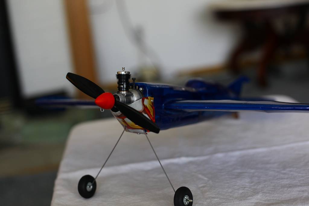

Here is a Crackerjack with full fuselage that I adapted from a 1/2A profile plan. I also added a sym. airfoil.

How does she fly?Looks good.

I have not yet had the guts to try it!! That .o49 has a GloBee head and timing shim with dual bypass cylinder and it cooks! I am still practicing going around in circles while waiting for the 108 degree weather to break.. I will post after the maiden.[8D]

Hey what is the Globee head and timing shim?

They are an upgrade aftermarket performance plug/clamp ring that were made for Cox engines back in the day-you can still get them on eBuy occasionally. I have read that they work just great on td and Med. engines without a timing shim but if you put one on a BabeeBee or Surestart you have to put a copper circular shim/gasket between the crankcase and cylinder head(at the bottom of cylinder). These shims are available on eBuy as well. If you do not use the shim on the BabeeBee and S. start, they just flat won't run. With the shim, look out! The shims usually come in set with three different thicknesses-you just have to experiment to find the right one. I think the major advantage of these heads is the flat coiled glow element itself-much greater surface area. The increase in power and rpm can be substantial. If you blow the picture up all the way, you can see that it is not a stock head-you can also see the copper shim at the base of the cylinder.
If you cannot find GloBee, Merlin Glow Plugs makes one that is almost identical-they are on the web. I do not Know if they require a timing shim or not.[8D]
