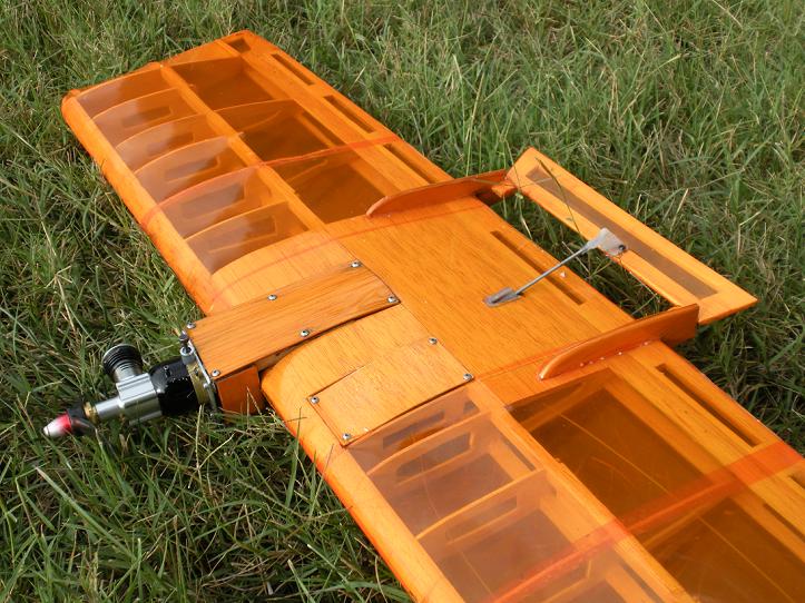

I had not flown Control Line regularly since about 1977 until 2 months ago:
This summer to do something different from the regular swim team / soccer camp / etc and get my 8 year old son outside and away from the video games we're kickin'it old school with some Control Line backyard stunt flying excitement.
The plane is a classic late 60's "Top Flite Combat Cat" look alike.(I used to have one) My son and I re-designed and scratch-built the model to run on an “Ebay†Cox 049 just like the ones I used to have when I was his age .
Plane Specs:
- NACA 0018 Airfoil
- Carbon Fiber reinforced adjustable beam engine mount
- 32" Wingspan / over 240 square inches wing area
- Less than 10 ounces flying weight
- Thrust / weight ratio greater than 1 for unlimited vertical fun
- Custom "Exponential" control handle
The Engine is an unknown vintage "Ebay" Cox 049 Black Widow that's been re-furbished and modified as follows:
- "Decked" Gilbreath high compresion head
- Nelson Glow Plug
- Custom milled Dual Ports / Dual Boost SPI cylinder
- Custom milled lightened piston
- Polished crankshaft
- "Decked" crankcase with hex brass drive plate
- Gilbeault mouse racing program Tank gasket / Carb needle mods
Currently running a custom blended PowerMaster 30% Nitro Heli fuel with added castor oil
Using a Cox 6x3 prop to keep the revs / speed down and be more crash resistant
I am still fiddling with the CG: It's currently at about 30% of chord and I feel it needs to go futher back to make the loops smaller.
We both love flying it and with 50 ft total line that thing is just screaming in our backyard around it's little 25ft radius circle. It could probably use longer lines but we're at max for our yard and I love being able to fly at a moment's notice.
Check out our Video (Don't miss our bloopers at the end) on YouTube at [link=http://www.youtube.com/watch?v=4vzPJtNqvvI]1/2A Combat Wing Video[/link]

Thanks for the kind words. He's was even braver and doing loops when we were flying our Coroplast wing. Same here, when I was his age, it was somewhat of a record when we flew the whole tank..
We did practice a fair amount this summer: We've burned over 1.5 gallon of fuel, 8 CC at a time... I'll bet our wing has already over 100 flights under its belt.

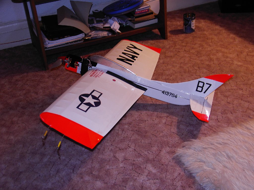

Well the final pic's from post#40. Have about 7 flights and it seems kinda quick to me, but I'm not very experienced in C/L.
Seems to turn about 5 second laps and line pull is real strong even in wingovers. Controls are very sensitive.
My question is should I try to slow down the lap times, and how should that be done? Am running Fox 35
with Zinger 10-6. 60 foot .018 lines.

Hi Pat,
5.0 lap times on a Ringmaster seem about right. You could go to longer lines, about 62 feet and reduce the diameter to .015's. This would slow the rotation without killing the airspeed, which the thin wing needs.
A 10x5 prop will slow it also, keeping the same rpm and all.
Try to put a longer horn on the elevator or reduce the spacing on the lines at your handle to reduce sensitivity. I've seen 1.5 inch to 1 3/4 inch horns on them when using 3 inch bellcranks.
Fly the wings off of it, looks really nice!
Chris...

Thank You Sir;
Will reduce spacing on the handle and try the 10-5 next weekend. Stuck with the .018 lines for now. Just got U-Reely with .015 lines but spaceing is about what I have on other handle.
Might try to get .015 from S&S before Sat. Maybe a back up RM also. Well not back-up, You really can't have too many. Also flying a Brodack Smoothie ARF
and this is better than the one I had when I was a kid (Veco Kit). What do you think would be an ideal choice for a stunt retread who can not get enough of this stuff?
Thanks Again Guys:
DAVE

Dave absolutely stunning Ringmaster congratulations.
If softening up throws is not practical at the handle then perhaps using one of these control horns would be of service. I use a lot of this particular one on RC aircraft and on my only current Ukie. The offer infinate adjustability and are much longer than most commercial ones. They also are very easy to use. Maybe not traditional but a far better horn that offers good options in throws.
http://www3.towerhobbies.com/cgi-bin...&I=LXD932&P=RF
Agine maybe not traditional but APC offers some wide blade 11x3 and 11'4's that would be interesting on the Fox, They do work well on my OS 40fp. Just a thought.
John

Thanks John;
Come to think, I purchased some of those horns for my EU1-A and did not use them. Will use one here.
And I am sorry for kinda hijacking your thread. I will be quiet now. Again. THANKS GUYS.
DAVE
Oh. Next up might be a Sterling Mustang kit # S2. Had about 4 of them when I was a kid.
