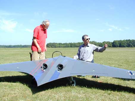

Here is one of the flying wing project. Use wing gyros to help stablize the plane.
[link=http://www.amtjets.com/gallery_horten.html]More Pictures[/link]

More POWER! Way to much weight plus drag on that poor little 70 4 cycle. You should consider gyros for roll and pitch axis. This is not a simple project without a doubt which allmost allways means a little cost overrun or two. The stability provided by those gyros will more than out way the cost and time of rebuilds. Good Luck Yogi
