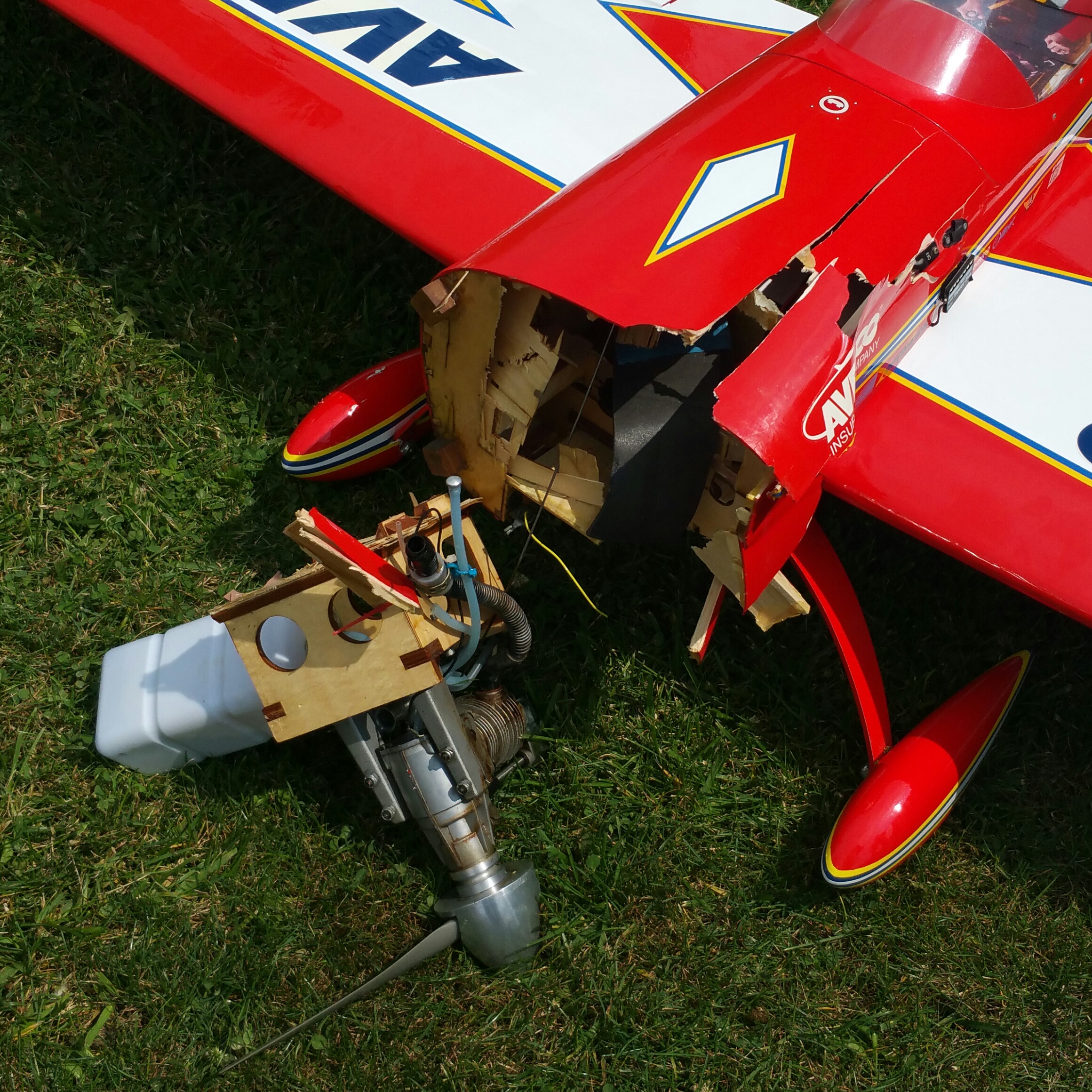

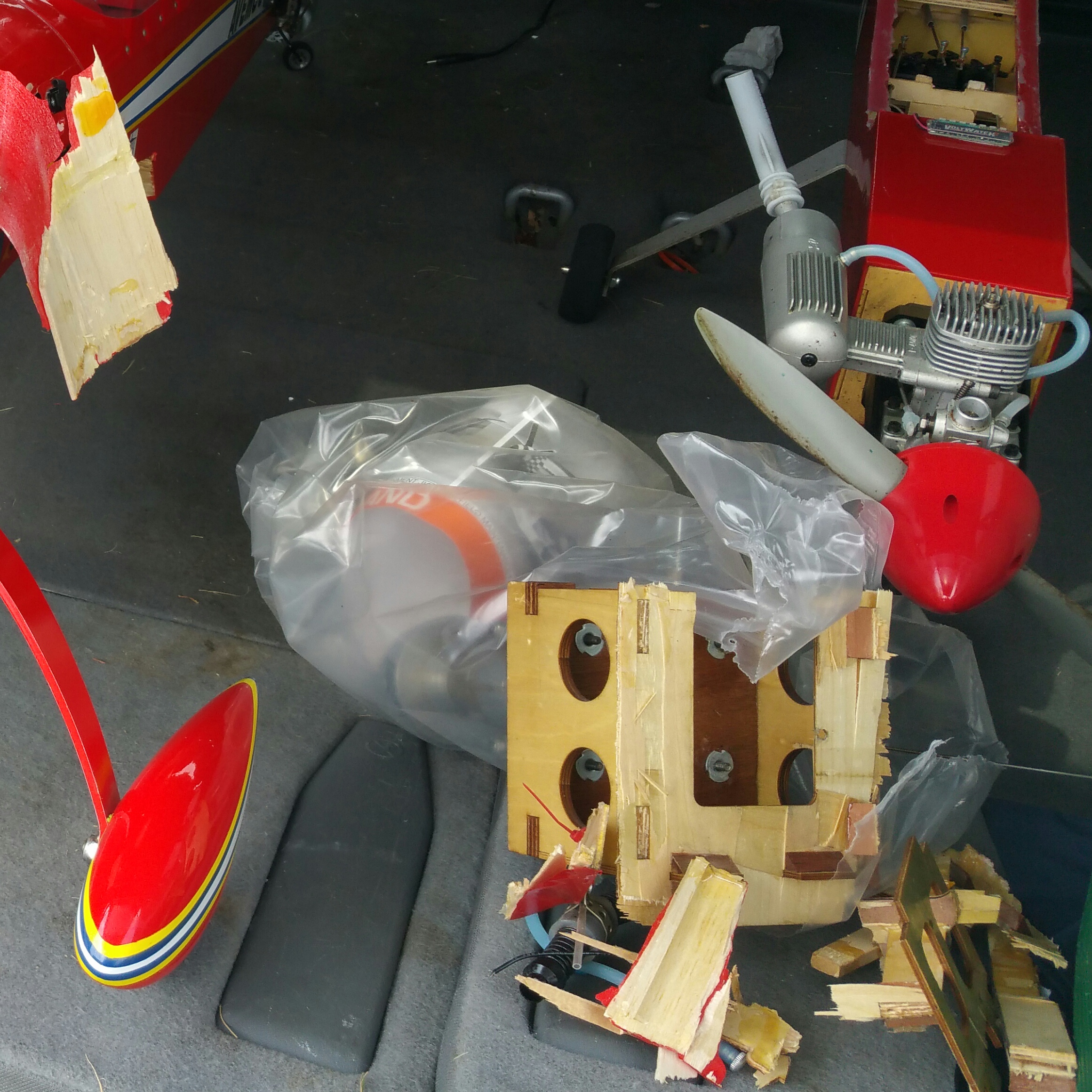

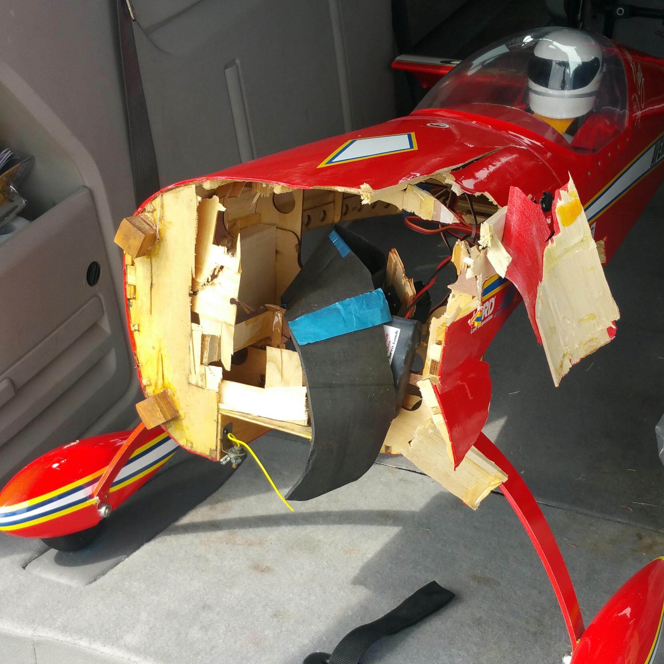

Ok this would be my first big fix. Not sure if it can be done or how to exactly go about this. The motor box is still solid I can post more pictures. Trying to figure how to go about doing this? Thought maybe you guys could help me out.

Almost anything can be repaired. It depends how bad the damage is and what experience the person has doing repairs. If this is your first dive into any structural repair I believe this is a bit beyond your skill set.
Almost impossible to instruct you via the internet. I would recommend finding someone in your area who has done this before and is willing to sit with you and help you along the way.
Or just buy a replacement fuselage.

Try fitting and taping the little parts together to use as a pattern for the real repair. Or you might try glassing on the inside and use the pieces.
Either way it's worth a try if only for the experience.

From the pic's of the bird I think for the color and trim I have the same bird, that said when I broke mine I did not take out the whole fire wall, and found the biggest challange was fixing the cheep ply used and getting the rubberie glue they use on the ARF's
Just make sure all the damage is fixed I found joints loose aft of the wing saddle.
Good luck

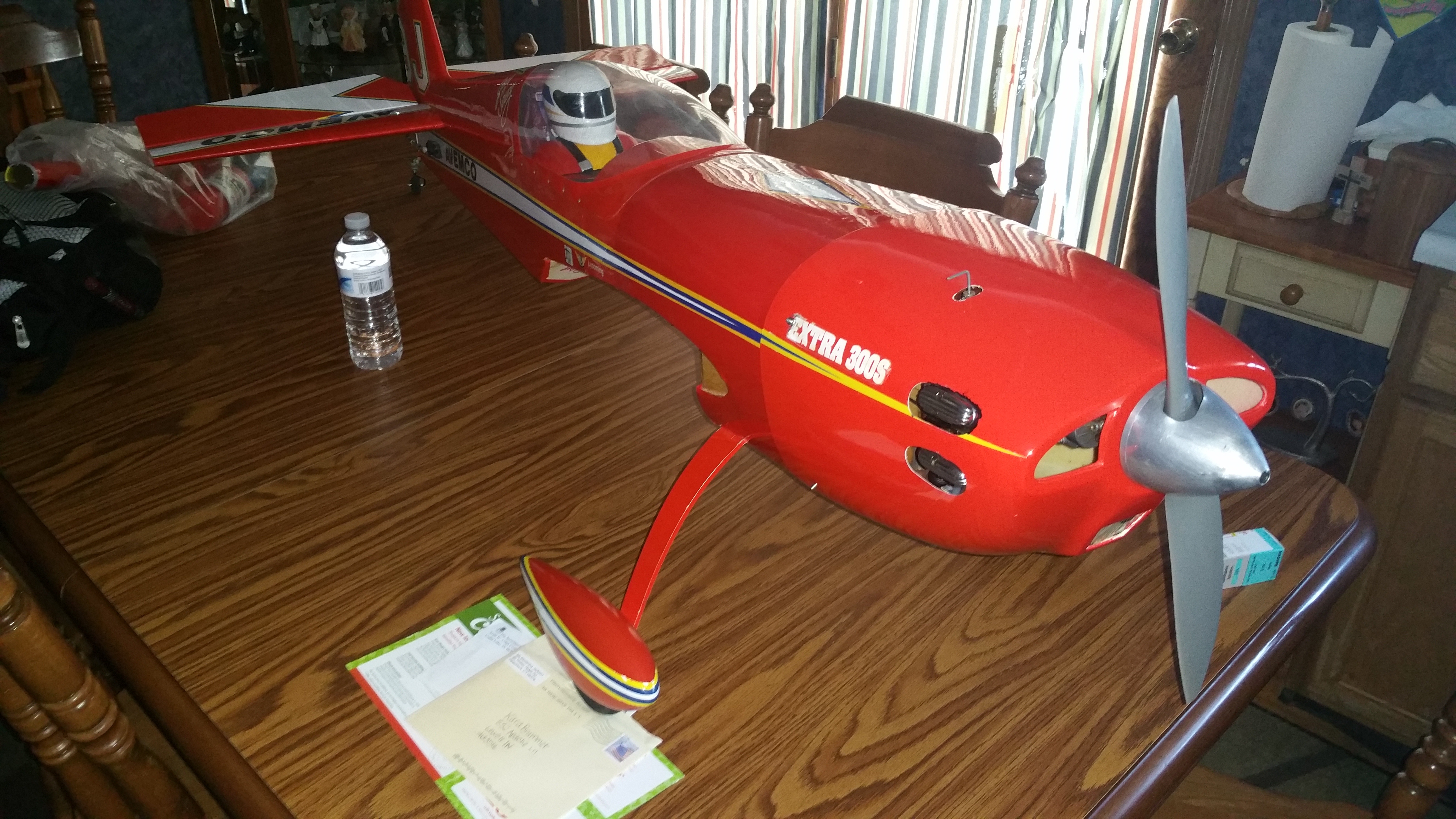

sorry for got to post pics got her all fixed up other than red being a little darker never would know
I like the new darker red better!

Feels great when you do a nice job like that. Very good and think how much you've learned. Great job. As far as the color match sometimes its difficult to easily see the difference between for instance red, bright red and missile red. Sometimes the manufacturer calls out the color matches used for the covering in the instructions.

Or, I've even had the situation where I use the correct color but the batch is just a little different from the original. I think it looks just fine. Gives it character.

Pick two stationary points close to each other cut your parts and glue and secure.The firewall will be next to your last and the strongest of all of them.If you need parts I can cut them for you as long as I have plans to go by.Ive been kit cutter for years and quite alot of experience with large scale projects.Its almost just as easy to build a new fuselage which I could cut you the parts for that and rebuild a new one ...Michaes
