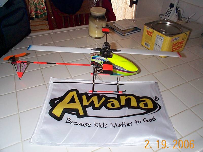

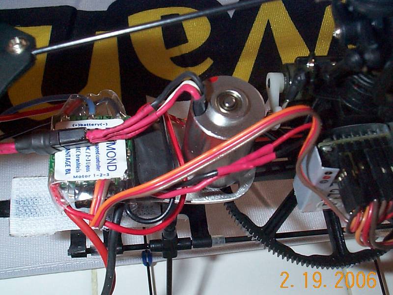

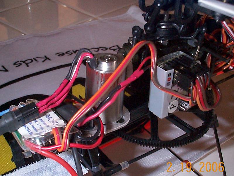

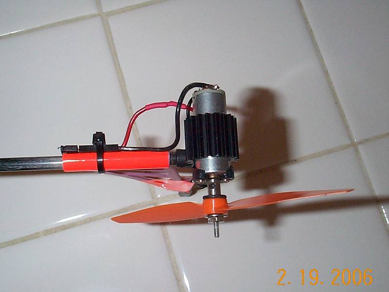

Hello Fellow BCP pilots and Tech service crews... I was given a used BCP this morning and I am glad to say as of 10pm it has flown, hovered and touch-n-go'ed off the wifes car hehe (her car has nice flat roof). I will post photos and my set up with list of parts as soon as i rest a bit. Most of the parts are off my ole FP walkera (gyro, esc's and tail rotor motor) I chopped a new un-used set of Aligin 315 wood blades to size, sealed ends and painted tips one red and the other blue and balanced, I'm using a Optic6 TX, GWS RX, E-flight servos, Park370 4100kv motor with 10 tooth, have new BH set as well. I did read most of the Blade posts and paid close attention to tracking troubles, may have saved me days if not weeks. 1st impression of my lil hot rod heli is NICE machine! Thanks to all your posts and photos!
edz

setup is
normal mode
pitch...throttle
1=45....10
2=48....65
3=58....70
4=80....90
5=100...100
ST-1
1=0......100
2=20.....85
3=50.....80
4=80.....85
5=100...100
revo mix +80 @low throttle, +30 @high, +30 @high & low on ST-1
I get 10mins flight time with 650mha NiMh batteries, I'll need to lower gear to 8t for 3C1P 1100mha lipo
I hope this helps some?
