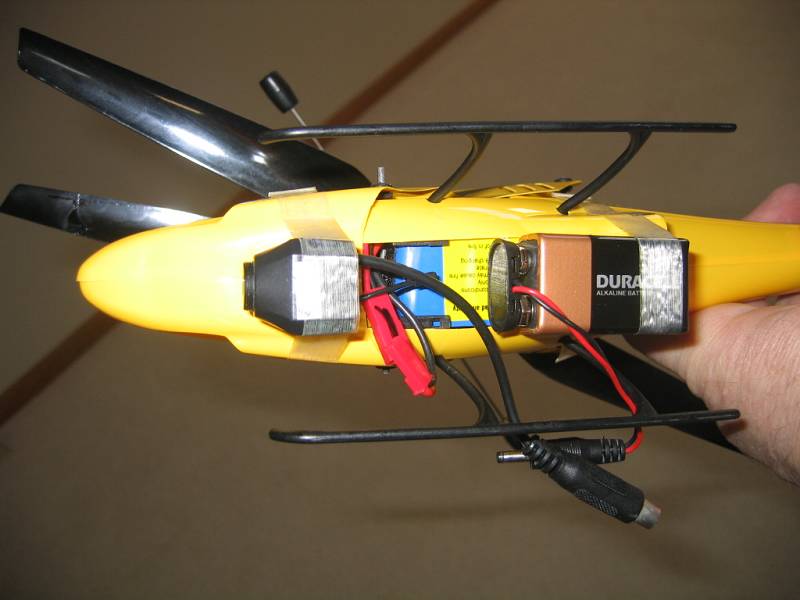

9oz camera on a CX.........what a riot !
