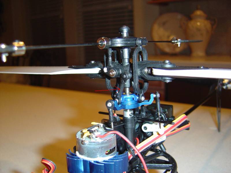

ORIGINAL: mrasmm
Thanks mrasmm - have some more info interspersed below - will attempt to get some pics up tonight.
yeah, it sounds like something is off, and it sounds like you are right in the trouble spot. The neg collective should be the same as the positive -12 or 13, and you said you are only getting 6. I would also make sure to use some 3 in 1 to lube the swash and the shaft and the main bearings, and work it out so you can get rid of that binding.
I adjusted the servo linkages on the swash 2 full turns (lowered the swash) so now it is more like 9/16" below the top of the main shaft. This eliminates "bottom out" with full negative collective. Adjusted pitch to now have -12/13 to +12/13 with 0 at midstick. This seems to be 2-3 degs too much, though and bogs down the motor at higher throttle. Now about -1/0 to +12/13 in normal mode. Pitch links are as short as I can get them so no way to remove anymore pitch in normal mode. Seems like this is still too much pitch with no way to adjust it further.
I have lubed the swash, but the binding on left/right cyclic is (seems to be) due to too much servo travel/limits of swash pivot. The mainshaft gets pushed (temporarily bent) to the left or right (maybe 1/16" at the top) with full left/right stick. Perhaps it was like this all along and I just never noticed. LHS seems to think so, but who knows.
Also check to make sure that your main pinion is not too tight or loose against the main gear. There should be some play, but not enough that it skips teeth or would rip them off.
I have tried several gear mesh settings and all have the same result. Right now it is as you suggest, a little bit of play but no chance of skipping teeth.
Guy at LHS suggested using a 10T due to the altitude here (~6200 ft). Bought one but haven't tried it yet. Still, it isn't performing nearly as well as before the rebuild.
Will get some pics up tonight and thanks again for the help.

you've probably already done that, but like you said, your problem is probably in your swash or head somewhere. My servo arms do not sit level either for the same reasons.
Go ahead and upload some of those pics, and we can look at it to see if we can see anything =)

I am not really familiar with that altitude, I fly mine at 5k feet. I am using flat bottomed blades and an 8T pinion though.
As far as the servos pushing the mainshaft from side to side... mine does that too, and has ever since I can remember.... i wonder if they just come that way like you were saying.
Is there a problem with your heli as it sits? Or does the way the head is setup just seem wrong? Did the LHS have any good words of wisdom when you took it in?

To me that sounds spot on =) Those are all the angles you want. The stock brushed motor will bog down with full collective because it just doesn't have the juice. That should be better if you get a brushless setup.
[/quote]
Double checked pitch curves tonight and actually it is more like +2/3 at mid stick in idle up and +12/13 to -10/11, so just a little off from being equal. It seems like I need to have a longer lower pitch link (the link to the swash on the blade grip). I may try using an adjustable there. I cannot shorten the upper link any more to get more neg pitch. I am still not sure why I now need to have 9/16" from the top of the main shaft instead of 1/2". Have a few pics of current setup.
Another thing that seems out of whack is that when I switch back and forth between norm and idle up, I have to have the throttle one mark towards positive collective for the servos not to move (see pic). At true mid stick the servos move when the switch is flipped.
OK - picture upload is not working???
LHS couldn't figure it out. Just seems like something is different with the geometry for the head.
Thanks again for taking the time to help out.

tom235,
someting has definitely changed, but all I did was remove the shear pin, disconnect the swash linkages, remove the mainshaft and everything else from the broken frame and install it on a new frame. I didn't disassemble any of the head components. So I am just a bit baffled. Thanks.

I would not recomend making pitch adjustments with your upper control links. leave the very little adjustment that is there for the tracking tuning. I would recomend adjusting the links between the servo arms and the swash to correct the pitch.

Thanks for the input. If I set the top of the swash to 1/2" from top of mainshaft with the servo pushrods I can't get full range of travel on the head - have to set it at 9/16" to get full travel. I realize this messes up the pitch range. What would happen if I used some upper pitch links in the position of the lower pitch links (so both are adjustable) to replace the fixed length links that connect the swash to the bell/hiller mixer arm. I have been over and over the geometry and it seems to me that I need to have a longer lower link to get more negative pitch. I have no clue why the geomerty has changed, but I'll keep at it.
Thanks!
Thanks!

That's a great idea. I think the LHS will let me do that. You're absolutely right, I don't know if I will every figure it out unless I have a "correct" one to compare it to.
Jeremy
