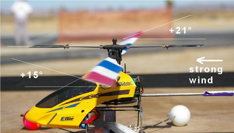

My blade has been acting wierd. When I turn it on it initializes and when I give it throttle it spins up but it doesnt lift off I go all the way to red light comes on it still doesnt come off the ground. The battery is fully charged and the 4 in 1 is ok but i dont know what the problem is the pitch is ok to.

Main motor is probably gone, they don't last long especially if you're using lipo's.

there are two possibilitys....bad main motor, or your pitch is messed up. I would verify your pitch with a pitch gauge first because usally if the motor is going you will notice less power before it wont even lift off.

I clamped the CP to a bench at the field, and ran up the motor.. I got these blade angles at somewhat less than max rpm... (the tailwind was making the rotor kinda wobbly).. 1/3200 th of a second exposure.
The thing -should- able to lift off with that much blade angle..

Well, not neccessarily, seeing as you should be getting +4-7 degrees. That must be your problem.

Yeah with that much pitch and possibly a weak/worn-out main motor, it would be hard to leave the ground. That's alot of drag. I know this may sound stupid, but make sure the the main rotor is rotating clockwise. Maybe the motor lead got switched around [sm=confused.gif]

You should have the same pitch on both blades too. Being out by that much, they aren't going to have good tracking at all. Goto http://bladecprepair.com/ to see how to set the pitch correctly.
