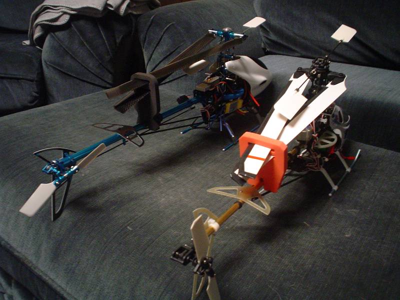

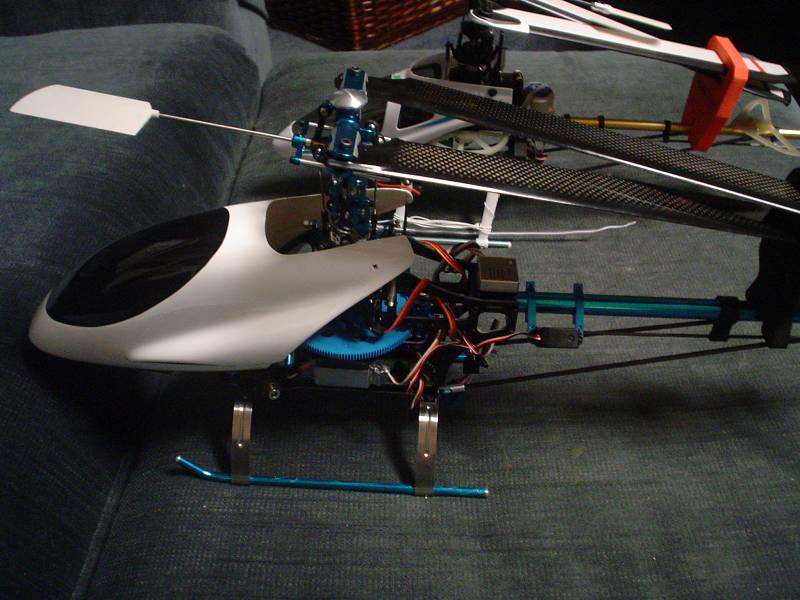

finally a day off to spend with the helis.....
and of course it's WINDY!
but that don't stop me. sure you think 5-10 mph winds too much for outside flight with a CX2....
going back to helicopter basics.... higher voltage LiPo = higher head speed = better performace, stability. right?
so I changed out the JST connectors on my CX2 and soldered on a Dean's Ultra for use with some more powerful LiPos. Made some mod's to the battery tray for holding a bigger batter, and......
Test flight 1) using a CSRC 7.4v 1100mAh LiPo, the heli could not hover higher then 5 feet with the added weight of the new pack.
Test flight 2) using a TP 11.1v 910mAh LiPo, WOW! this heli got some power now... however, during the second flight I burned up the stock 180 motor and she's now grounded.
Test flight 3) using the TP 11.1v 910mAh LiPo with Dynam Vortex 180 motors.... talk about an outdoor CX2! Wanting to see how much power the heli could handle, I punched the throttle and the heli dropped to the ground. Upon inspection, I noticed stripped the lower gear clean with the surge of power.
Off to the LHS for some parts!
also, got my TREX 600CF flying! Now that's a heli! now just got to figure out how to charge these 5000mAh LiPo's!
and finally, made some great progress on Rick's TREX 450SA. She's almost ready to ship out! Figured out the gyro settings and the tail is solid, tracking is perfect.... the only thing is she's got a little drift, just take some minor adjustments and she'll be heading home to Texas!
Here's some pics and vid link of a test hover:
http://www.youtube.com/watch?v=Q5MHLfuLY1I

LOL....you and the CX's, that's funny stuff. The 450SA looks a little bouncy.....wind? Gonna get some SNOW flying in today.
Tried the flight....crappy. Wind was a bit much and tail control was gone fast from the belt shrinking in the cold. So much for that.

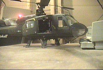

Top anti-collision flashing beacon installed. Works independantly from the navagation lights and is motion activated (slightest motion turns it on and it stays on all while the heli is flying and running, shuts off after 20 seconds of no motion). Runs off 3 AC30 button batteries. Works real good so far. Wait a week, I'll get the bottom installed....maybe sooner (LOL).
#5246
Vic-- Looks good...! To nice to fly...Lol.. Funny, I was just eyeing the HBK2 on JagHobbies...Brushless 3800 for $209.00...The last few days have been tempting...Lol...If not soon there will be one in the hanger within 2 months. That means I'll have to be visiting from 2 forums to three...I need more time in the day ! Alright, good day to ya... Jeff
