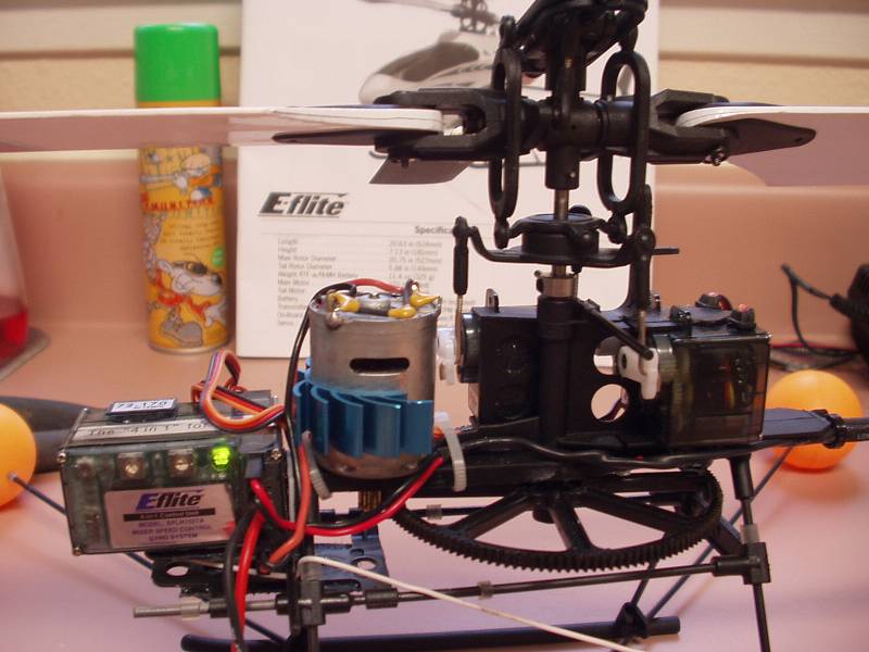

Heh........... Got the Blade CP delivered today, bought if from a great guy on the classifieds from here. (TY Ken!)
Looking at a couple things that may be stopping me from getting any real control over it. First off.....the blades are so tight......they are unmovable. I will find my allen wrench set, and get those loosened tonite.
Looking at the servo linkages I noticed they are at the end of the arm...........in the center slot. By end of arm I mean the farthest point away from servo body. If I was to move them either up or down at the end of the arm........would i be creating a nightmare?? Or..........if I moved them in one slot closer to servo body, would that possibly help or hinder me?
All I can say is tho.........sweet deal..........I am like a 13 yr old on his first date...... nervous and so charged up, tranquilizers wouldn't slow my heartbeat down...........heh!

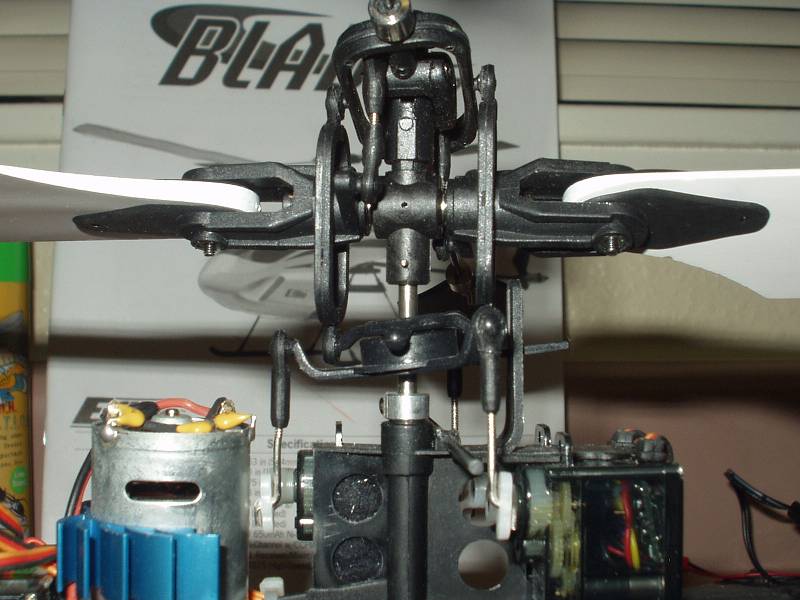

Moving the servo arms closer to the screws will lessen your cyclic response. (body-pitch and roll)
If you are having trouble controlling it at all, that may help.

Ty BZ.....thats what i thought also..but didn't want to attemp without seeing if that would create other issues.

Ahhhhhhh!! i knew i was forgetting basics!! Servo links........... (slaps forehead). Ya...i had the tx trim set all the way back.....and still holding rear stick to keep it from blasting off forward. Also have a little left movement too.......will try to adjust that as well.

Heres a couple pics of the swashplate with 4 in 1 armed........LOL notice the bent servo linkage in the front!
Lots of adjusting to do i see.........and a trip to LHS for servo linkanges.

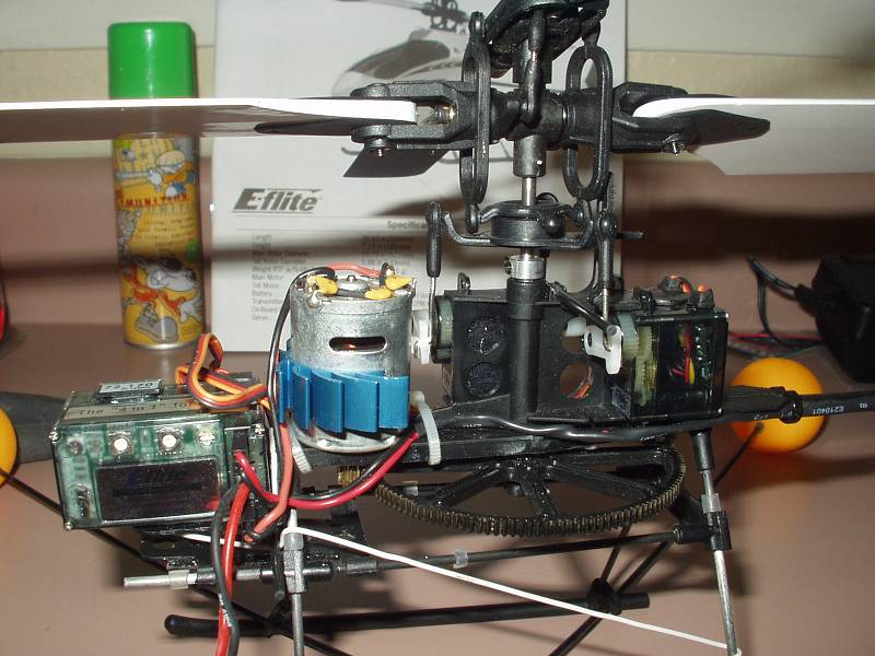

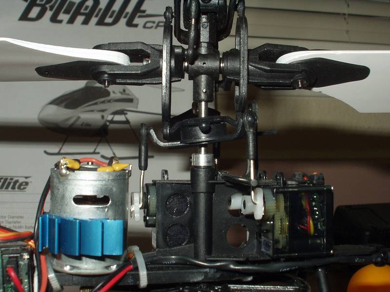

Ok.......did alot of adjusting and fiddling, this should look more like what i need when 4 in 1 is powered up. Haven't flown it yet, but will in a min...wanted to post pics first.
Front Servo 2 1/2 turns out ---- Right rear servo unknown ( i lost count....but originally did 9 turns in) 7 turns in? - - - Left rear servo out 1/2 turn

power up the tx and the heli and wait to arm. double check all controls/trims at neutral. hold heli in right hand out of rotor path. the tx in left. power up slowly and feel which way it wants to pull your hand (adjust trims if it pulls/rolls/etc. be careful when powering up that it dont roll into you. power up more till it gets very light (flying in your hand, I hold the landing gear for this). If it's not pulling/pushing/or trying to roll let it go quickly and catch it. when I release mine, it will stay in one spot, go slowly back or forward, and I grab it again. This tells me the trims are fine...time to fly. My son has a two car garage he cleared for me today. I hovered 2 full charges over his floor drain with out a problem. The last flight, I walked behind it and made basic turns and hovered it around the garage. What an awsome fly day this has been for me. I hovered my first pattern today. I kept it tight to me and the designated hover area (a 2" floor drain). One little trick I do is I over trim a tad to the left and keep constant pressure on the rudder to the right...it seems to make the tail more stable. When I turn the tail to the right, I add more right pressure on the stick. If I want left, I release pressure on the stick and it automatically swings left, reapply right pressure on the stick to hold center...works for me for now.
