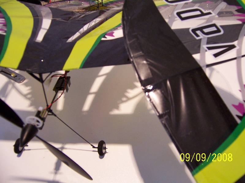

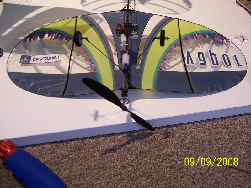

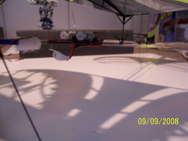

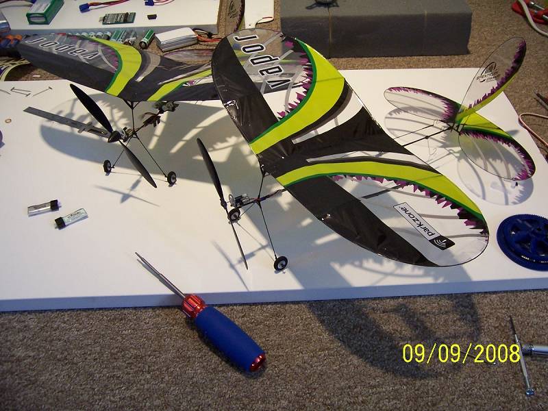

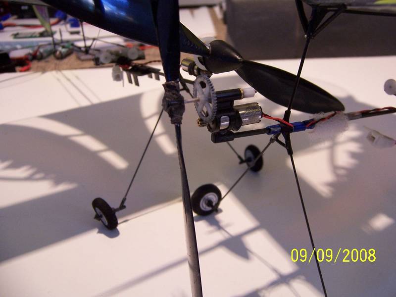

Been super busy, but I know you get your Vapor tommorow most likely... Stealth mode yes...Lol..
I always can find the time to read on RCU, but posting takes more time along with getting sucked into the excitement and then time seems to disappear...
The weakest link on the Vapor would be the main-wing. My first few flights I realized this, as the mylar that attaches to the plastic wing frame will tend to come apart... I just used small pieces of scotch tape, and applied them in small spaces apart around the whole edge of the main wing. It doesn't look pretty, bu the Vapor isn't all that attractive anyway, so I was just going for function, not looks. This has served to work very well in the abuse I purposely gave it in its 54 flights... That mylar is extremely tough stuff whatever it is...
On flight 36, I had a nose-dive from experimenting in winds beyond its capability through my 'wind-experimenting' and had a nose dive to the asphalt, resulting in what Lookyj had also said, and that was the motor mount. Luckily for me, it did not detach all the way, and I CA'd it after putting it back into its place. And has worked great ever since.
On the tail sections with the mylar, I used only a couple pieces and that was it for strengthening the mylar there also to the plastic frame it supports on. I did that there just in case, so as not to lose the whole section of mylar in case of a mishap. But its held together very well there from just the very few pieces I did use...
I also put the rod on the servo arm to its inner-most hole for maximum throws, and clipped the rest of the arm off. I removed the battery tray, and use velcro. I trimmed off in total 7mm to each side of the prop, along with removing the soft cone that is in front of the prop. I like the cone off, as it reduces the mass to the prop, and in my hopes would help eliminate bending the small shaft. I have nosed dived many times on the concrete with it off, and now the motor mount Ca'd, has come out fine with no damage...
I also clipped on the underside of the wing some of the extra wing supports that was doubled up, and made it so it is just a single support for each side. This always it to flex a bit more and less stress for breakage, and works more like a birds wings I guess...LMAO..
This thing flies very well, and you will be surprised how well it does compared to my CX2 or your Lama in the wind... At the weight of almost two nickels, its quite amazing...! Although light enough, some of the things I did were for the intent of a little more weight reduced for better flight times with the lipo, and more agility in the skies, and for the weight it gained from the tape and such... Process of give and take I suppose...
These are just ideas that I've tinkered with as I love experimenting on all my RC stuff. I still have the other one brand new with only a 2 minute flight, so it alllows me to really torture-test the thing with no worries... I would recommend doing something like the tape on the main wing however.. Some guys I think ran a bead of CA around the wing-frame attaching the mylar also but haven't tried it, and I like the flexibility of the tape...
You'll find it very relaxing to just fly... I do use my DX-7 that is binded to it, so I'am not sure what the difference is with the stock TX as I haven't tried it...
One other thing, is I used tiny little pieces of blue tape to keep the battery tray from shifting, and did this also for the main-wing attachment to the frame. It keeps it from shifting back and forth and changing the CG from time to time. You'll find the sweet-spot of where you would like the CG, and then you may want to do this...
Have fun with it.... I hope to acquire some of your ideas as well during your exploits with it. I still have the new one to masterly tweak through my experiments with my first one, and the ideas you may come up with also... Get a second battery ! By the time your done flying the first one, the second is charged just about ! It allows constant flying after cool-downs of the electrics of course and keeps ya in the air endlessly.... Its super quiet, and when Liz is sleeping, you could hover it over her head, and she wouldn't know....LOL..
Take care my friend,
~ Jeff
