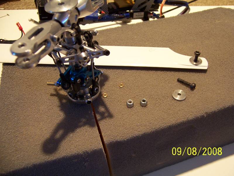

Jim / Wnuk,
I would recommend shims, reason being! If don't shim the blades, when tightening down the grips to make them the appropriate tightness. One grip compared to the other may bend more in one direction, than the other, top or bottom of the grip, up or down. This could throw off the tracking and cause major headaches.. Been down that street.. Take the time to find something around the house to make your own shims. Plastic, metal or what ever.. Only takes a few extra minutes to do this.. I use plastic and works very well.. Just look around the kitchen for something to take apart..
Dave / Choppersrule
Dave / Choppersrule

Quick question for you guys. I spent the weekend tuning up the B400 since wind and rain had me grounded. In trying to balance and CG the baldes, I came to the conclusion that they were just too far apart and too much tape would be needed. So today I bought a set of Align 325 mm blades (woodies). It seems to me that the thichkness is smaller then those of the B400 so they are looser in the blade grips, maybe about 1/16" smaller. Do you think tightening the blade grips down on them might be pushing it or should I maybe look to shim them instead? As a side note, these Align baldes were nearly perfect right out of the package.
Jim
Jim
I have to use 'shims' or in this case small thick washers that came with my Microheli head.... For all my blades, I must or the result would be exactly what Dave just said... It works great and the bird still tracks to the tee, with no vibration issues or anything...Like I said, these washers came with the Microheli gear. Maybe you can figure something out that is similiar to this also........
~ Jeff

Yep, spooled it up and tracking was out. You called another one right Dave! I have some shims to use so I will set it up in the AM.
Thanks for the advice, I should have known better.

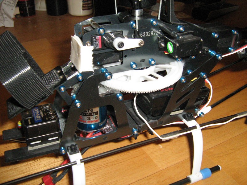

Vic... What you have there is a generic T-Rex. We all have to take prescriptions so you know that in the medical field the generics are just as good as the name brand. I held my T-RexSA in my hand while staring at the pictures Crash uploaded and I found 3 things different. One being that Vic's tail fin is slightly rounded and mine is straight. Second is I have a plastic block that is embossed, "ALIGN" right underneath where the gyro is usually placed. Last is the plastic under the battery tray, different cut outs. All screws look to be in the exact location.
Vic, take a picture with just the frame assembly and head and then one of the tail. I'll post the same. Let everyone compare. I swear it's the same bird as my SA.
Pictures of my SA
God Bless,
Jay
Pictures of my SA
