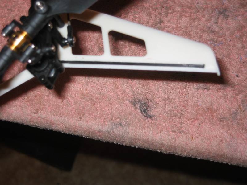

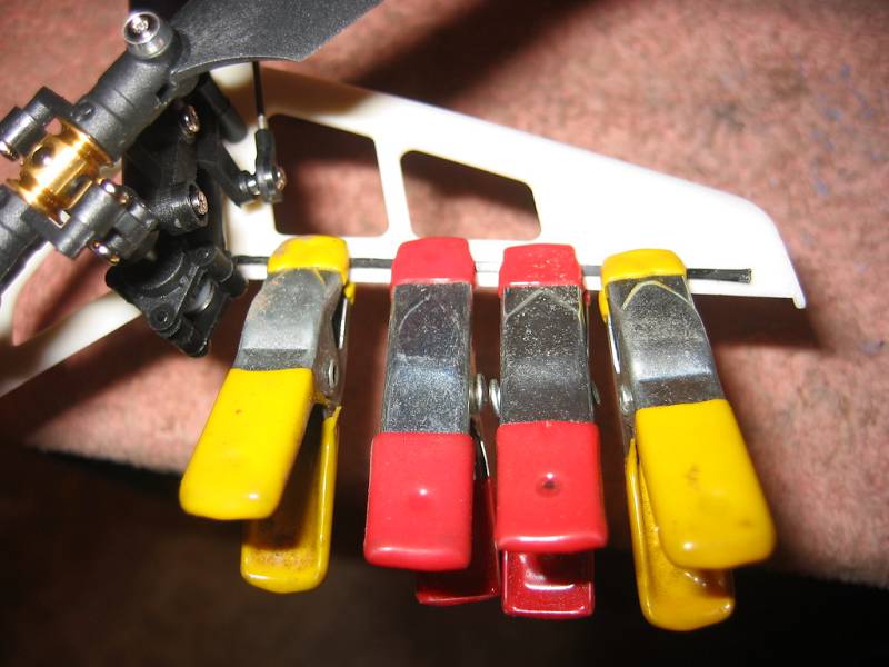

Jay,
On the rear fin, ya might want to try and CA some carbon fiber rod, on each side, front and back of the fin and give it a shot of white spray paint. I'm cheap. LMAO
Dave
Dave

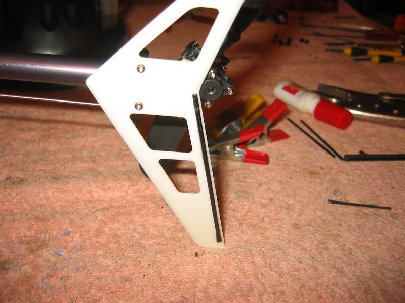

Jay,
Here's a couple pictures of the Modified tail fin, with carbon fiber rods. Oh, so much better. One on each side.
Adds contrast too, LMAO!
Dave
Dave

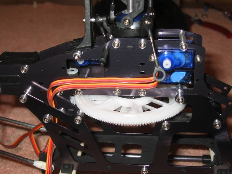

Tip of the Day.
See picture.... I CA'd the servo wires to the frame.. Yikes! Works great.. A couple drops on the the frame just above the main shaft and a couple drops just about 1 1/2 inches to the left of the main shaft. One spot at a time.. Looks great and won't move.
Dave
Dave

Hahaha LMAO that's an awsome tip. I can't believe that I never thought of that before. I'm always looking for ways to zip-tie stuff to make it look cleaner. Thanks

Joey,
That's what it's all about, sharing information. Glad to have ya checking in.
Dave
Dave
