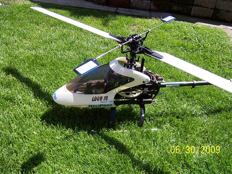

I took off my Logo 10's flybar paddles which are 26.5 grams a piece, and threw on some 9 gram Trex 500 paddles that come with the Trex 500 CF kit... Wow, it sure made it much more powerful in a punchout... I couldn't even tell that there is a change other than more power and it seems easier to move around... That's close to 35 grams lost in the rotor head. Crazy...
I know with my Trex 450 I had the 8 gram paddles on for a long time and then I put on some 4 gram CPP paddles and it really freed up the head also... This will be my new set-up for the Logo for sure !
It should help to keep the temps down, and maybe a tad more flight time... We'll see.... I'am thinking Loops tomorrow A.M.....
