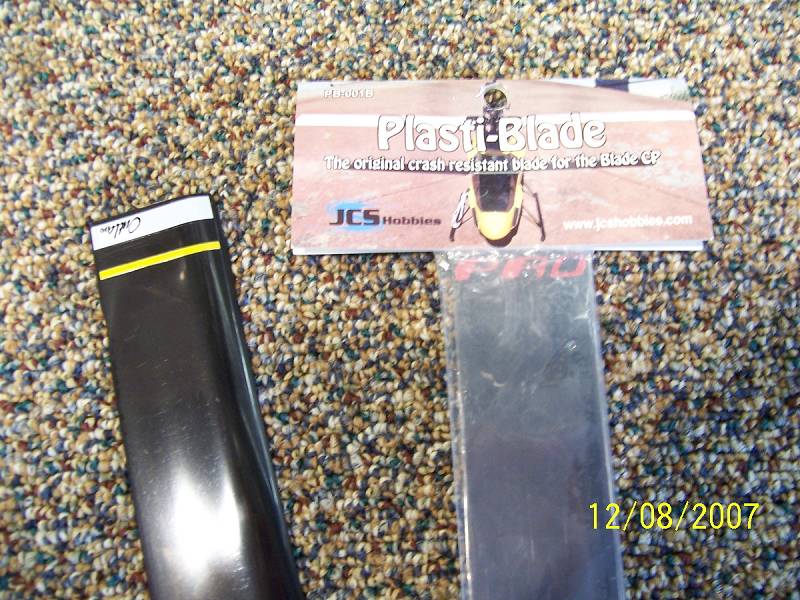

Maybe it is because I am a beginner, but I think the G90 is well worth its money. I would recommend it!
Wow, those blades are sexy! How much were the mains? How are they in weight compared to the symmetrical balsa ones that come stock?

J-Michael- thank you so much for all of the info you have provided. I really appreciate it, as it expands my knowledge even faster.
I was planning on going outside for the first time today, but the winds aloft around Anchorage are predicted to be 20 knots or greater- glad I am not up in my little Cessna today- it would be a fun ride.
I think it is for the better though, I am going to stick inside and gradually get myself to do nose-in.
I am going to run to the LHS and get a pair of those Plasti-blades- thank you for the info on them.

The G90 makes learning to hover much easier. Unless you never crash, forget the plastic blades - they will cut your tail boom every time. If you tape the tips and leading edge of the balsas, they will with stand many crashes and not cut your boom.
Joined: May 2006
Posts: 5,238
From: Greenwood,
IN
I agree with Wsdepa, plastic blades are detrimetal to the heli world. They are stronger than other parts, as mentioned tail booms, also the main rotor parts and grips go in a heartbeat. Not to mention bent main shaft. You can take a set of woodies, take off the white mono-coat plastic film stuff, and give it a couple coats of tru-oil. Wait between coats. It makes the woodies much stronger. You could give them a shot of white spray paint, or any other color you like, later. MAKE SURE, you balance the blades after words. This is a tip from Crashcrash on the Weeeeeeeee CP thread. One of my worst crashes, busted parts were cause from plastic blades.
