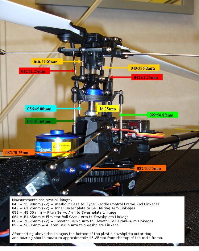

I have the bits that I was waiting for and I have put them on. (seesaw holder)
Everything is level.
The problem I now have is sorting out the pitch. I spent all evening trying to do it, but I just can understand it.
At the moment my red blade (tipped for tracking) is +13 full, -0 centre and -5 at no stick.
The blue blade is +13full, 0 at centre and -3 at no stick.
I adjusted the red blade and the reading is +11 full,-2 centre and -7 no stick.
I seem to be turning in the right direction, but just cant get both sides to be anywhere near the same or what they should be. (+10, 0, -10)
The pushrod that I adjust is the same as the tracking so now my tracking is way out.
Please could anyone tell me where I'm going wrong.
Many thanks

Are you checking these pitches with the motor unplugged and the heli in idle up mode?
If not you need to do that or change the Throttle Hold curve to 0-25-50-75-100.
Next thing is to make sure at half stick the swashplate, washout base arms, flybar control frame arms, blade grips and mixer arms are all level and parallel with each other. Otherwise you will never get linear movement and consistancy in regard to pitch.
I'll see if I can get SeaComms to jump in on this but let me know if you got that far.

Phill,
Those curves look fine.
My main point was if you are measuring pitch with throttle hold on then you will be getting the pitch for that curve.
In otherwords Throttle Hold has it's own pitch curve.
So, in the examples you posted above if you are switched to Idle up with Throttle Hold on you should actually get -3/0/+10 for
pitch at low, half and full stick instead of -10/0/+10.
Does that make sense?

Today I spent another 4 hours trying to get it to be -10, 0, +10 . I did it with the DX6i, totally started from scratch, which Im glad I did because it helpped me understand it more. I am still not getting even numbers on both blades though.
I have managed to get one blade at half stick -1 and the other -2. full stick +9 and +10 and at at low -4 and -6.
Is it ok to fly like that or must you have them both the same?
I am wondering If I have damaged the flybar control frame set as I cannot get them to both be the same . It looks ok .
Another odd thing that I noticed. I spun her up just to see what the blade tracking was like. at low to mid it was slightly out. Mid it was spot on but a few clicks more and it was out of line. Does this mean anything ? I have never noticed this before but I have never really paid that much attention to it before.
Thank you for your continued help I really Appreciate it.

Hey Phill, just looking over this and it seems like you are on the right track, but maybe through fiddling you have the links to the swash at the wrong length affecting everything from there up.
Time to start again me thinks. Navy blade on RC groups has been going through the similar problems and through some help form others got all the default factory link lengths. He has done a pic with the lengths on it they may help you out.
Start by setting all servos to mid alignment to their cases using subtrim, with pitch at 50% and all normal trims to 0, dual rates, expo etc all to stock default settings. Use a pitch curve of "stunt mode" with a little mod on the middle 3 points (ie, on a 5 point curve like the dx6i set the pitch curve to 0, 50, 50, 50, 100; center stick is not so critical then but you still have full throw top and bottom).
The swash to frame measurement is with the pitch at mid stick (50%).
This should be an excellent starting point, then you should be able to just adjust the links to the blades to fine tune 0 pitch at centre stick.

Yep, exactly what you said!! Just was lucky enough to find a pic with all the stock measurements.
What did you mean Yoda? I thought that pic had all the links and their lengths in it? or...... is the pic not showing to everyone else? If not let me know and I will try to attach it.
do you have link to the control arms length picts, that would be cool
