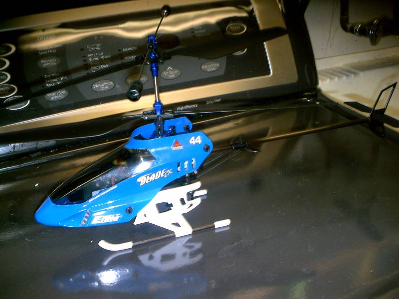

Soloboss, I agree completely. I have mine so well balanced out now, that I can fly it in my driveway if theirs no wind. And I could sit down under it like it was a fan and enjoy with cooling. Now like you said this only works outside in my case. (Since I have no indoor areas to fly other than my garage) But even in my garage if I get it high enough and out of the way of anything that can interfere it hovers perfectly. And the TBE is gone also now. It just took a good studying of the blades and picking the best out of the bunch I have. The guy that I got this from sent me a set of aftermarket blades that say cx-2 on them, but are a different configuration. They have only one screw hole on the top. So I need another aftermarket part for these to work. I already bought the aluminum bulkheads and swashpplate, so Im thinking if I wanted to run the aftermarket blades that Id have to get some more parts that would defete the purpose of why I bought the eflite alum parts. Whats your experience on the different blades? Are they any better? Stronger or better performance? Or should I just stick to blades that will fit with the way I have it set up now? Thanks alot!
