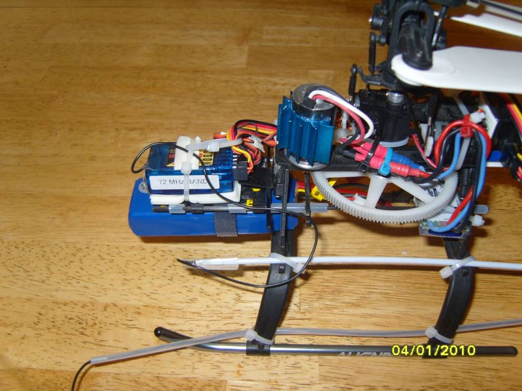

I've updated mine with the SR 2 in 1 and the 370 brushless motor. Power is realy good, but my motor is getting hot!! I'm also using 25c batteries. I'm going to try some 15c batteries and see if it helps the heat issue. Power is great though. I may install the Park 400 4200kv motor if the 370 keeps getting hot.

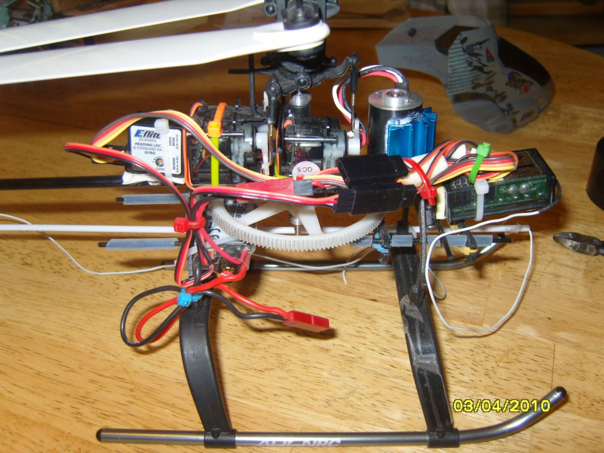

Here is mine with the upgrades. So far its working good. I've gone back to the 15c batteries and the heat issue is much better. I've also got three squares of weight in the nose of the canopy for ballance with this setup.

One thing I also noticed, I had to use the pinion gear off the brushed motor for proper meshing. The one that comes with the brushless motor does not mesh correctly.

I wouldn't do that. THe gear ratio for a brushed motor and brushless motor are going to be different. You can end up destroying your motor.

Solman,
They are both 10t pinions. The brushed motor pinion has a larger diamiter with wider gears. The brushless motor also comes with a 12t that is about the same diamiter as the brushed 10t. There shouldn't be any ill affects but is needed for proper meshing.

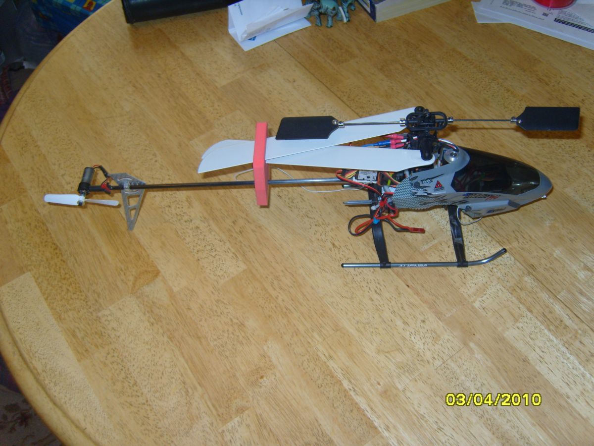

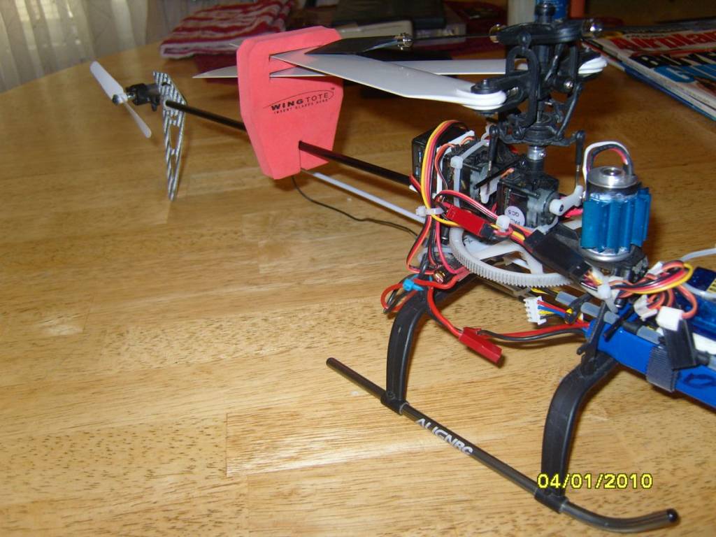

Added some more upgrades. I've got the Neon 6 channel reciever and the 110 gyro in. I'm still getting some tail whip when I try a loop, but normal flight is great.
