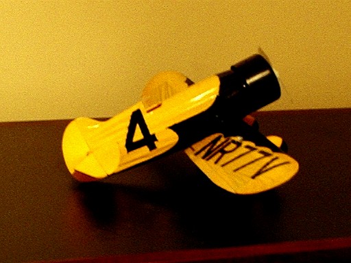

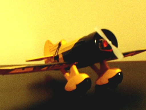

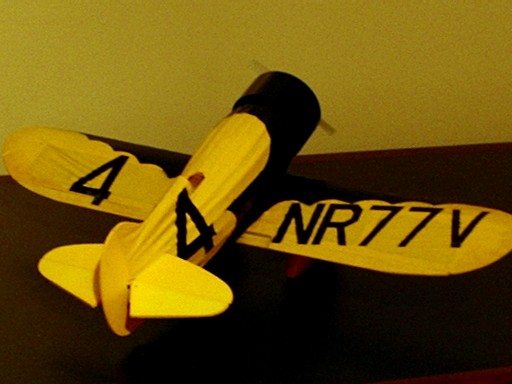

Here's the latest pic's of my indoor GeeBee Z, lacking only the canopy, almost ready to go. (There's no tailskid, either, but that's okay - the wheels are going to have to come off for flight anyway I'm afraid).
I'm also waiting for a calm, dry day, too. At its present weight of 50g, the first flights had better be outdoors I'm supposing. I may even need to up the motor and prop size, too.

That looks very good, Dan. How about shooting it on a neutral background so that nice job doesn't get lost in the backgound? How long before you get some flight tests?

Dan,
Excellent job on the airframe. I hope she flies well for ya!
Just a little advise, the folder prop and KP00 is very inefficient setup. You won't get the max thrust the KP00 can output with that prop. The U80 is better and a GWS 3X3 is even better.

Thanks guys... Excellent advice, I will take it all.
I had to mess with the pictures quite a bit to get even that much yellow out of them! I'll just take it outside or something and get better pictures.
Thanks for the tip about the prop - I'll need all the power I can get out of this setup to fly this plane. I just stuck the folder on because it seemed to clear the cowl better, but I think I'll look up the 3x3.
If I have a lot of trouble, I'll try the 4.2:1 gearing and the 10cm prop...
I'm finishing the mold for the canopy tonight, so I may be able to get a test flight in this week, if the wind stays down. By the way, Mike, I never did see a flight report for the Albatross - did I miss it?
