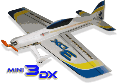

Foamaholic,
Now I might be making this one. I e-mailed Tim about a setup to include all gear (servos,Rx,motor,ESC,etc...).

Wow, great. Everyone says it's a good one.

Here is the thread Tim started on the Mini 3DX.[link=http://www.rcgroups.com/forums/showthread.php?t=270198&page=1&pp=15&highlight=Min i+3DX]http://www.rcgroups.com/forums/showthread.php?t=270198&page=1&pp=15&highlight=Min i+3DX[/link]

I built the 23" Ultimate powered with a AXI 2208/34, Phoenix 10 ESC, E-Tec 700mAh 2S1P Lipo, and three 9g Servos. Lets just say, It would have flown great on a lower rate than what I maidened it with. I had it on high rates when I maidened it. It snaped and hit the ground breaking the lower wing/fuse connection point. Looked at it and said what the heck, tossed it again and flew it around a bit, before it finally bit the dust.
I ordered the supplies for the Mini 3DX and Built it. I used the same set up for it that was used for the 23" Ultimate mentioned earlier. It flies great. Haven't flown it indoors yet. Once I receive my Christmas gift from my parents (a digital camera) I'll post some pictures. It should be here soon. Speaking of that, I'll have a lot of pics to post with other projects that are finished and ones almost finished.

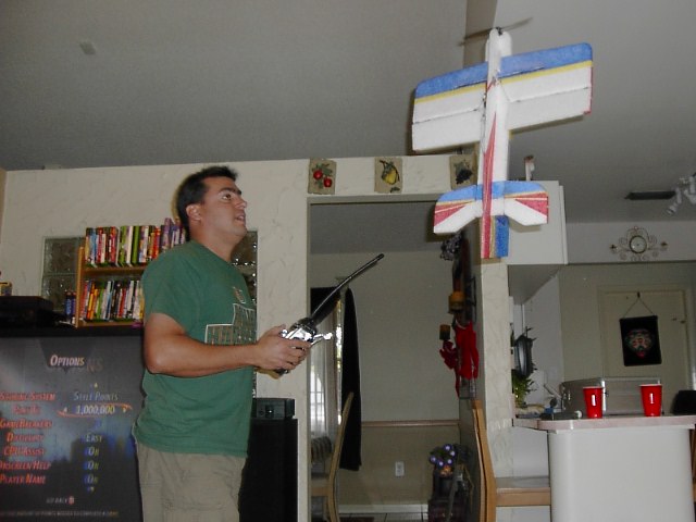

heres my 20 inch yak i made out of epp with a cd rom motor and etec 2 cell 450. all up weight is 4.5 oz.
