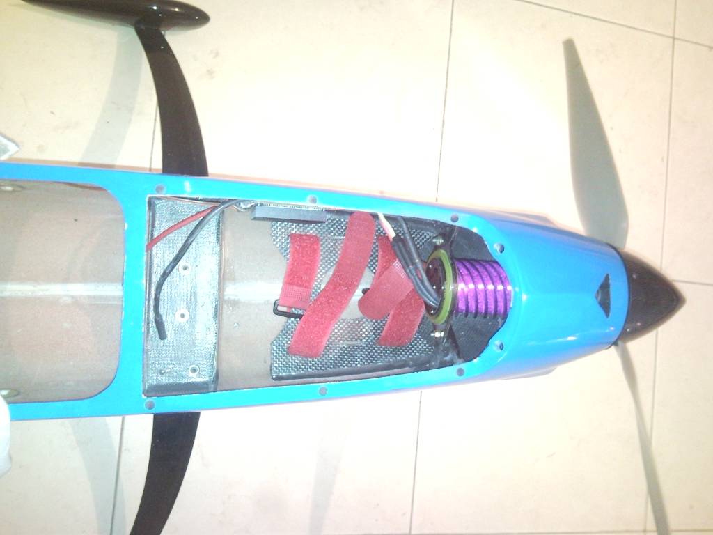

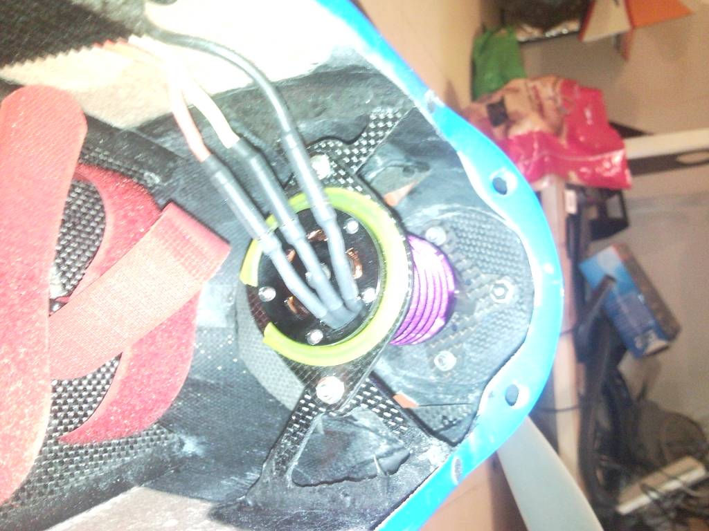

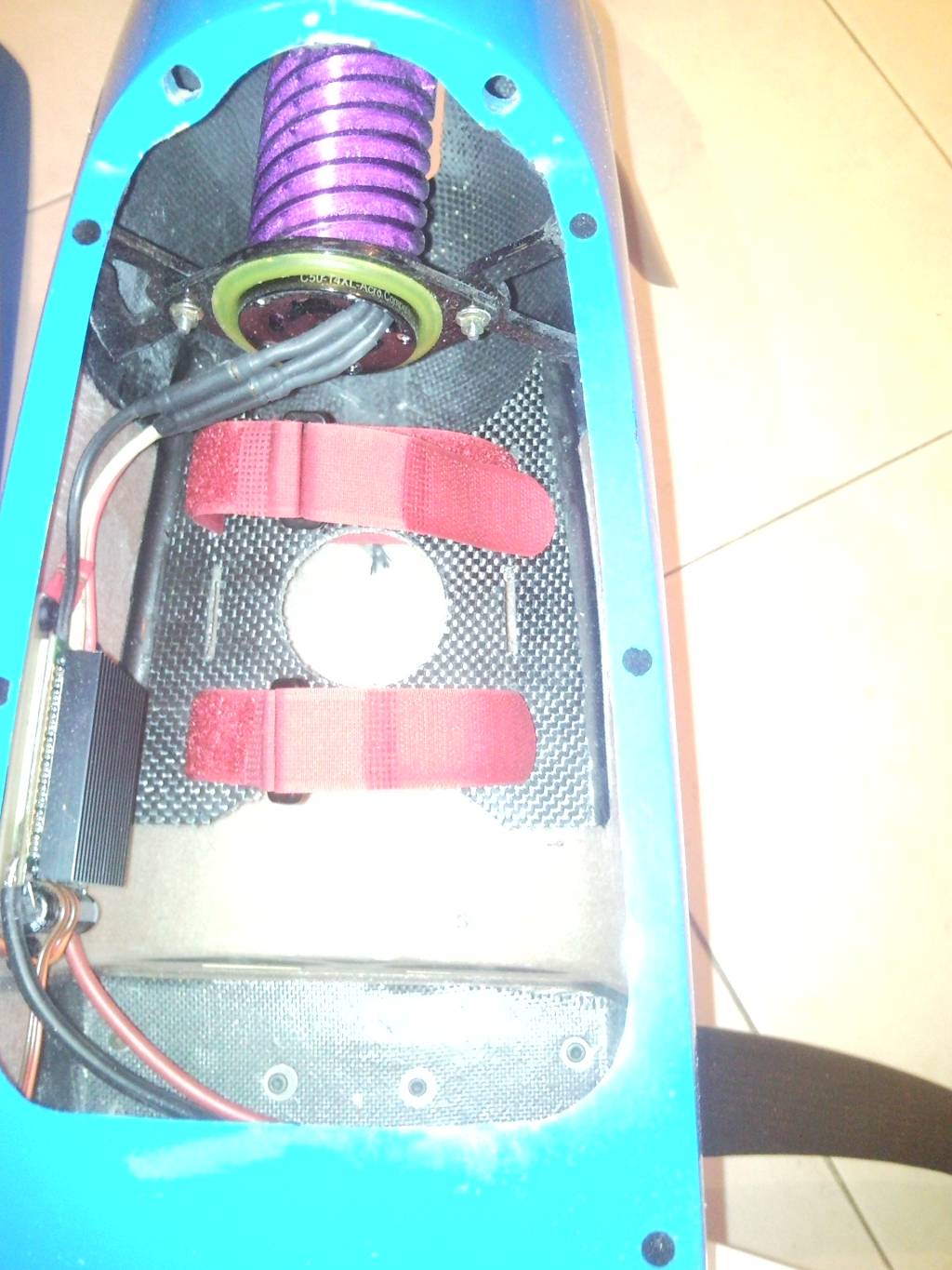

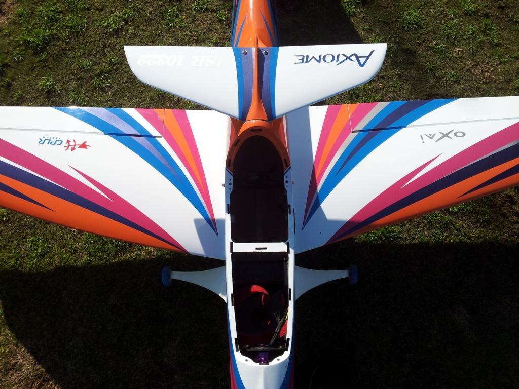

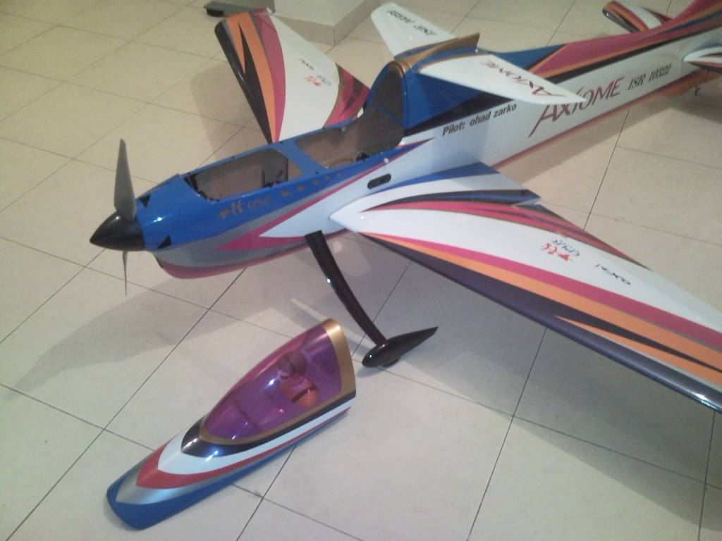

Hello
hir is same pictures of my new axiome ep
My setting is:
Hacker c-50 14xl +master spin 99
21-14 apc
2 Futaba bls 551 for ale
2 Futaba bls 153 for ele
1 Futaba bls 451 for rad
The model is 4.970kilo with 1.200 kilo battery

Old 10-06-2010 | 03:30 PM
Joined: Jun 2005
Posts: 30
From: a, ISRAEL
Default RE: new axiome ep
more

Old 10-06-2010 | 03:41 PM
Joined: Jun 2005
Posts: 30
From: a, ISRAEL
more

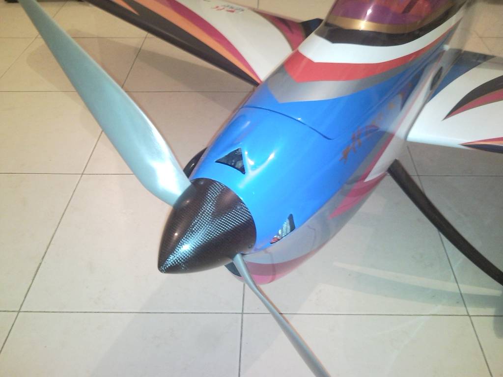

Old 10-06-2010 | 03:52 PM
Joined: Jun 2005
Posts: 30
From: a, ISRAEL
more

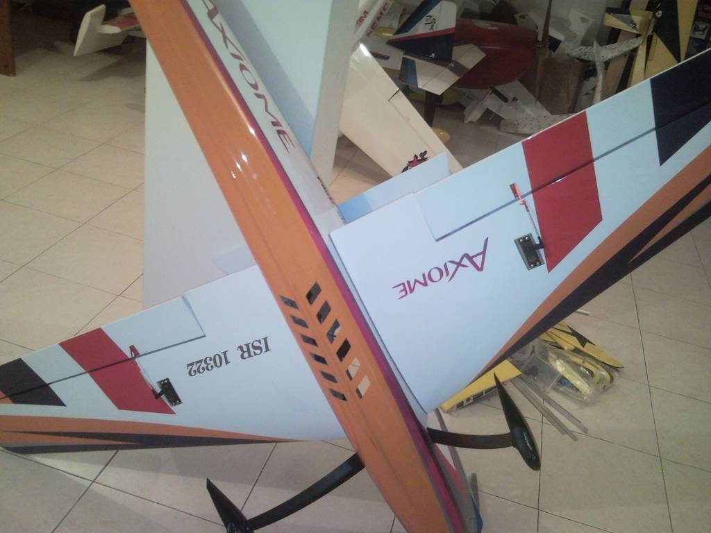

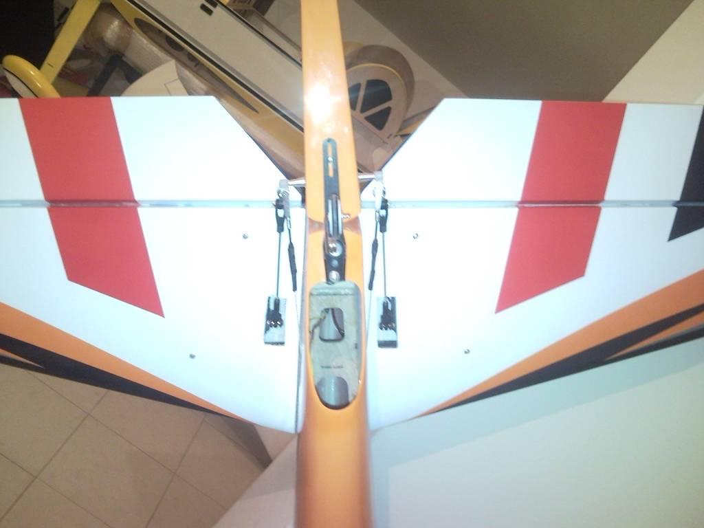

This photo is from the building part so the wires are not in the place bat I modified the Rader servo try to 1 servo from 2 like it came from oxai

The model flies beautifly, it has excellent rudder control , the same as elevator. There is slight coupling(maybe because the forwardCG which I prefer). The model arrives with the opening in the tail skid as standard although I enlarged it a bit because of the hot weather. In the center of the fuselage at the bottom I have added another opening.
What I dislike about the model is the weight of the wings (420g each not incl. servos) making it 100g more than the standard.
And because I put the elevator servos in the tail, the battery tray is haif way under the engine, making inconvenient to access.
I think the engine you chose will put the model on it's upper limit with a 1180g battery, take note.

Why did you put the servos back depth? Is it difficult to mount with 1 servo only deeply.
I'm Spanish team
Greetings.
Old 02-16-2011 | 05:12 AM
Joined: Jun 2005
Posts: 30
From: a, ISRAEL
yes it was me with the Azurite in wc Pombal in the 2009
i think that you can have beter control when every elevator have 1 servo and i didnt like the wire mechanism on the elevator
and the elevator have maunt for servo (bls 153).

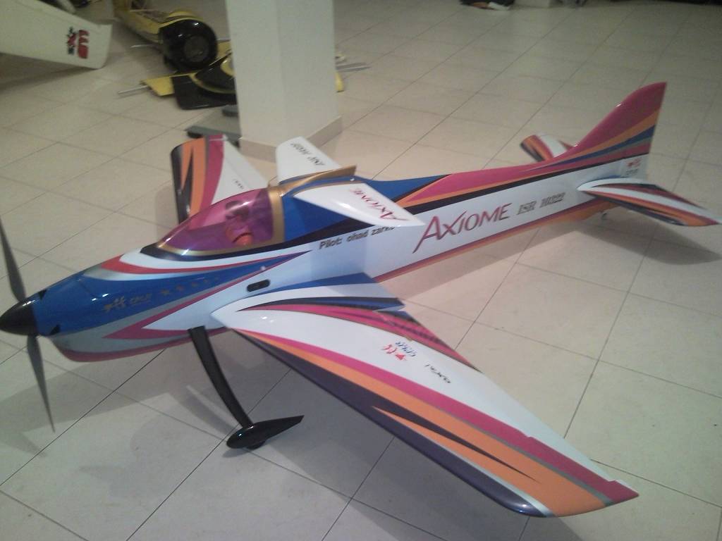

Old 01-20-2013 | 08:20 AM
Joined: Jun 2005
Posts: 30
From: a, ISRAEL
my original axiome was upgrde to axiome+ as you can see in the photo.
i buy new set off wings from oxai that fit excellent to the old model.
the model lost alot of weight (150g) and the model is new 4850g flight weight.
the snaps are mach better and accurate (probably because the lite weight of the wing).
it roll beter and the most important for me that the model is more stable .
ohad zarko
