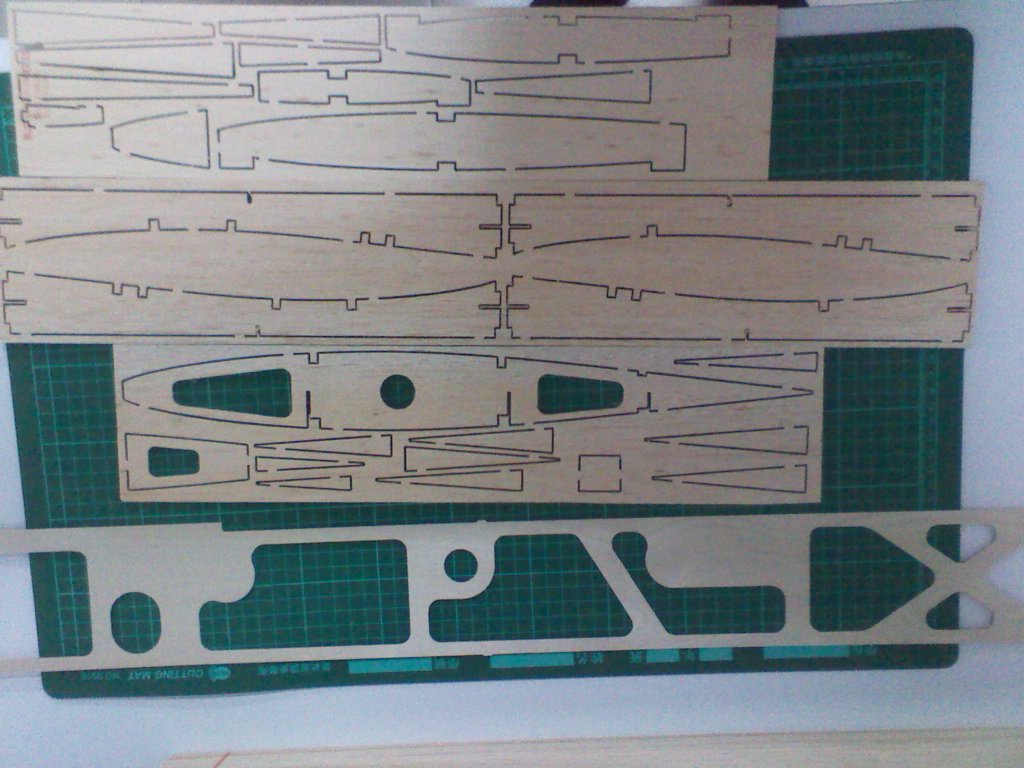

Hi Jeff
I will start to build a Lightning .
Could I please get a copy of the plan.
thank you,
[email protected]
