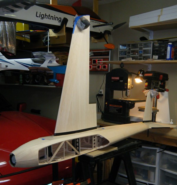

Here are some pictures of the gear and also the promised picture of the elevator servo setup. My camera charger still has not been found post move, so the low quality phone camera pics will have to do.
ID:	1742043   Click image for larger version
ID:	1742044   Click image for larger version

Old 04-14-2012 | 07:16 AM
  #338
Viper Driver's Avatar
Joined: Feb 2003
Posts: 397
Received 5 Likes on 5 Posts
From: Archer City, TX
Default RE: Lightning Build
Steve,
The picture you are refering to is of the root ribs for the wing and stab panels. They are glued to to the wing and stab, not the fuselage sides. The carbonfiber is added to the balsa to provide strength for the anti-rotation points.
Old 04-14-2012 | 07:22 AM
  #339
Joined: Feb 2003
Posts: 397
Here are the ribs being prepared to be glued to the stab and wing, as well as one of the wing being glued to the wing root. I pin the rib to the fuselage side, and then glue the wing to the rib.
ID:	1749965   Click image for larger version
ID:	1749966   Click image for larger version

Old 04-18-2012 | 04:48 PM
  #343
Joined: Feb 2003
Posts: 397
Steve,
I omitted FN1 from my fin. If you added FN1, just cut it to fit between FN6 and the tail post. To mount the fin, glue FN6 to to F12, glue the sheeting from the fin to the top of the 1/8" balsa fuselage sides, and F13 glues to the inside of the fin sheeting and FN2. In the picture with the fin mounted, you can kind of make out the glue joint at the base of the fin. Unfortunately, these are the best pictures of the fin mounting. PM me if you need more info.
Jeff
ID:	1752092   Click image for larger version
ID:	1752093   Click image for larger version
