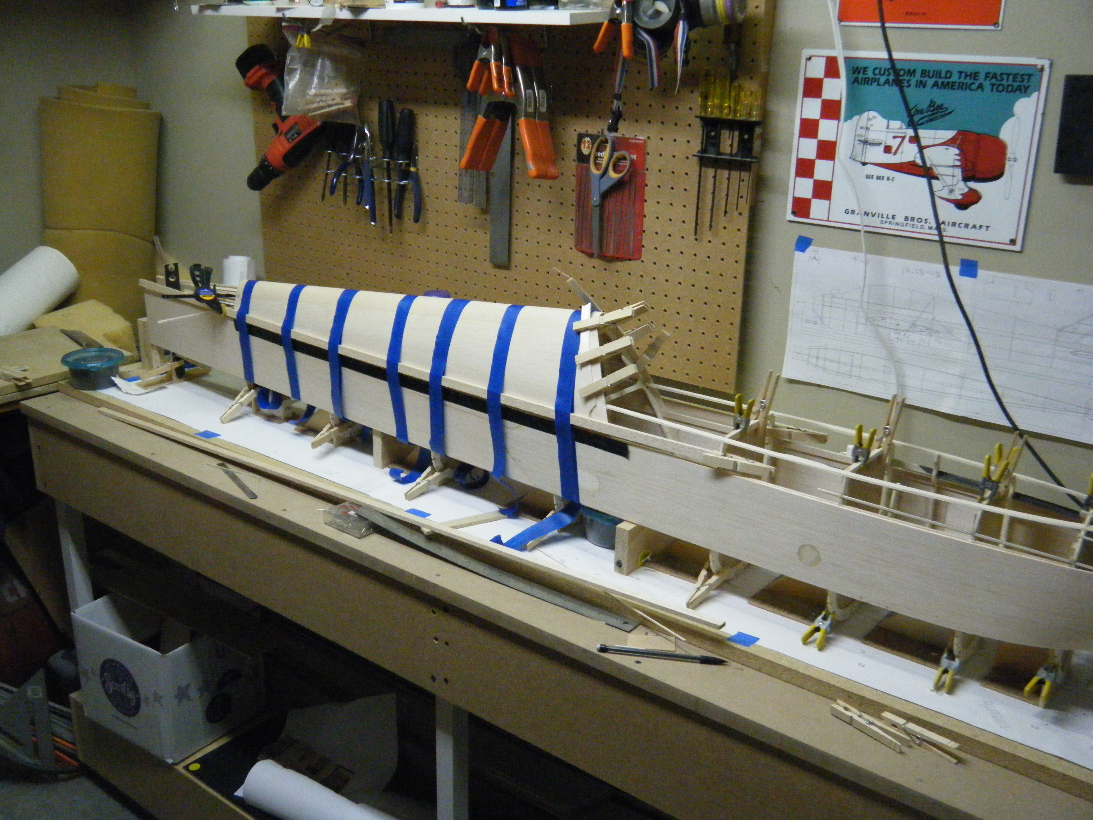

The nest step it to trim the turtle deck sheeting and glue into place. Since the fuselage curves as it goes back, the edge of the sheeting is not straight. To mark the shape, I tape down one side, and then trace from the inside. Once I cut that, I tape down that side, and then mark the other side. One trick is to leave excess sheeting on the forward end so if you trim too much, you can just slide the sheeting back and it will still fit.
I glue the sheeting on with Gorilla Glue. To prevent a mess, I mask under the seam with electrical tape. I tried blue painter's tape previously, but it adheres to the glue and makes a mess. I used long, heavy balsa sticks running down the sides of the sheeting to ensure it did not bow as I taped it down.

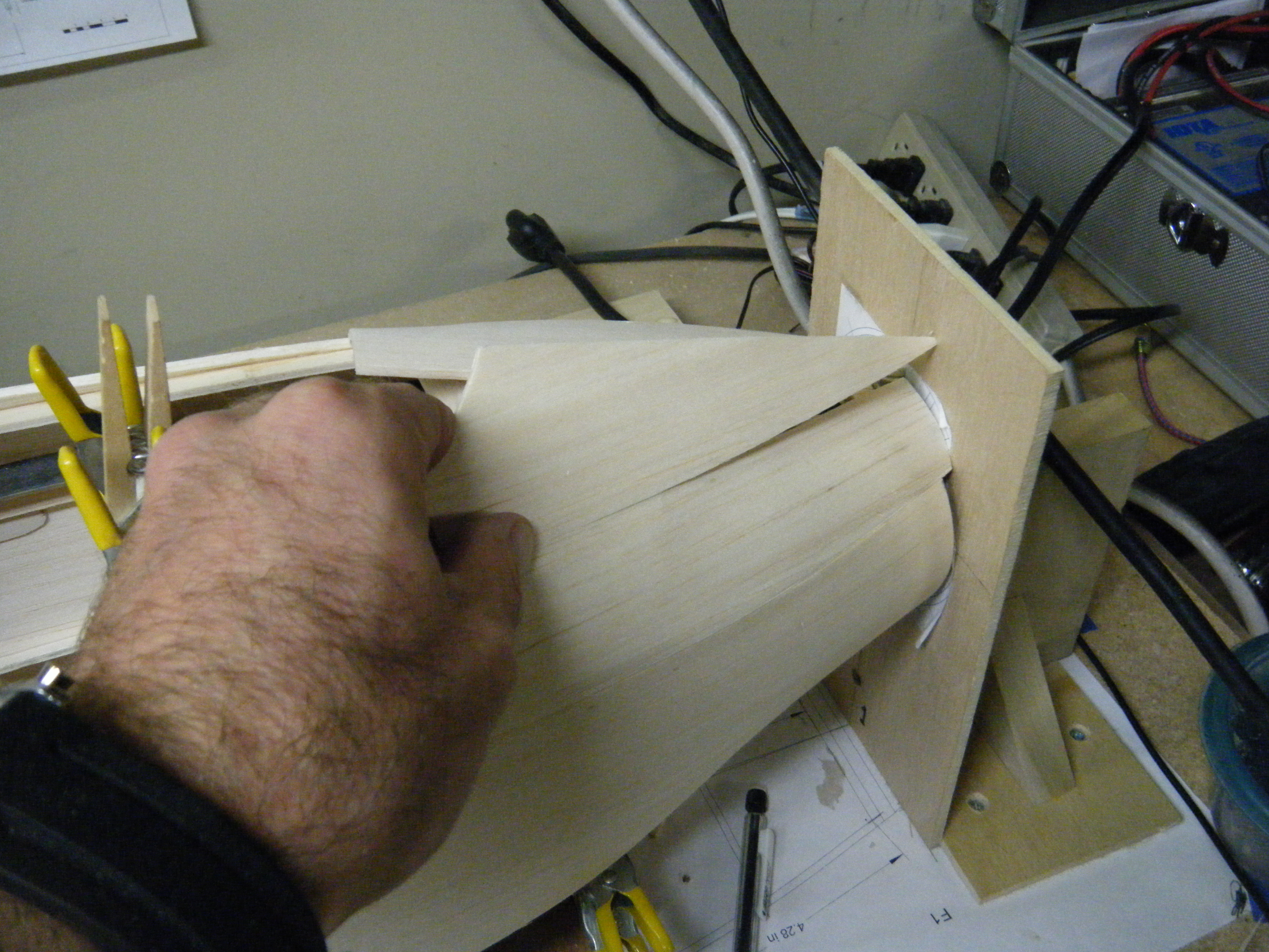

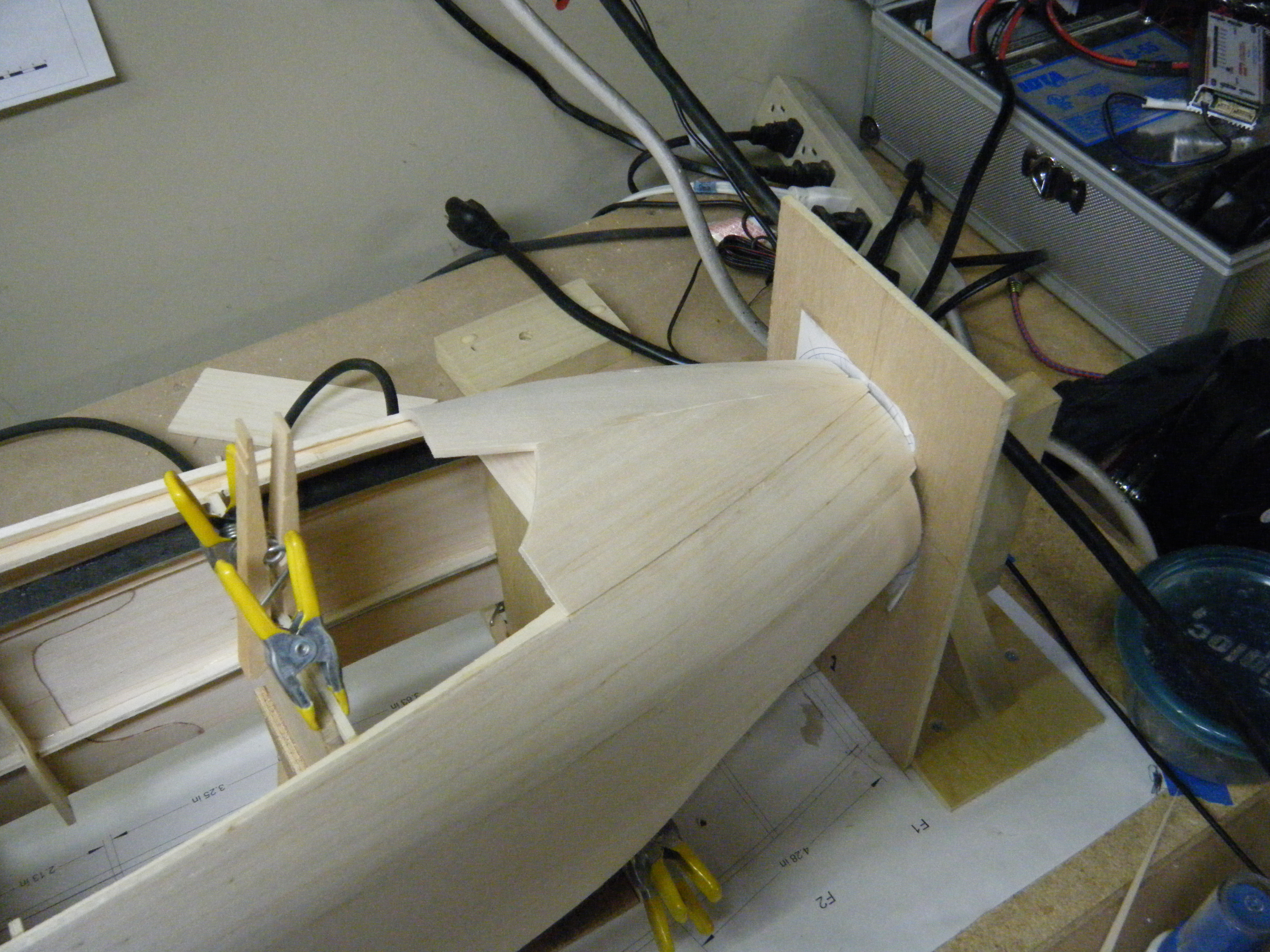

The next step on the fuselage is to sheet the front section of the fuselage with 1/8" balsa. On the prototype, the upper section of the nose was about 12" long and was planked with 1/2" strips of 1/8" balsa. On this version, the canopy extends further forward, leaving about 5" to sheet. I decided to use four larger pieces of wood for planking since there is such a small area to plank (I have enough fingers and hands to hold it all down). In addition, the reduction in the number of seams will be a benefit as after three years they have started to show under the paint. The diagram on the picture shows the outline of of the sheets.
I used a heavy piece of 3/32 balsa out of the reject pile to make a pattern. The using the heavier wood (stiffer) was great for the pattern as the soft stuff will just bend into place. I cut and fit all of the pieces for the nose section and practiced holding them onto place.
Start by edge gluing the new piece of wood to the previous piece already in the airplane. I used medium CA for this job, taking great care to not have any ooze out of the seam. If the edges don't align perfectly, not a big deal. There is pleanty of material to sand the seams out smooth. Once the edges are glued together, I do some real finger gymnastics and CA the rest of the piece into place.

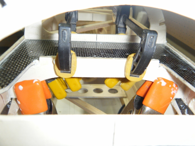

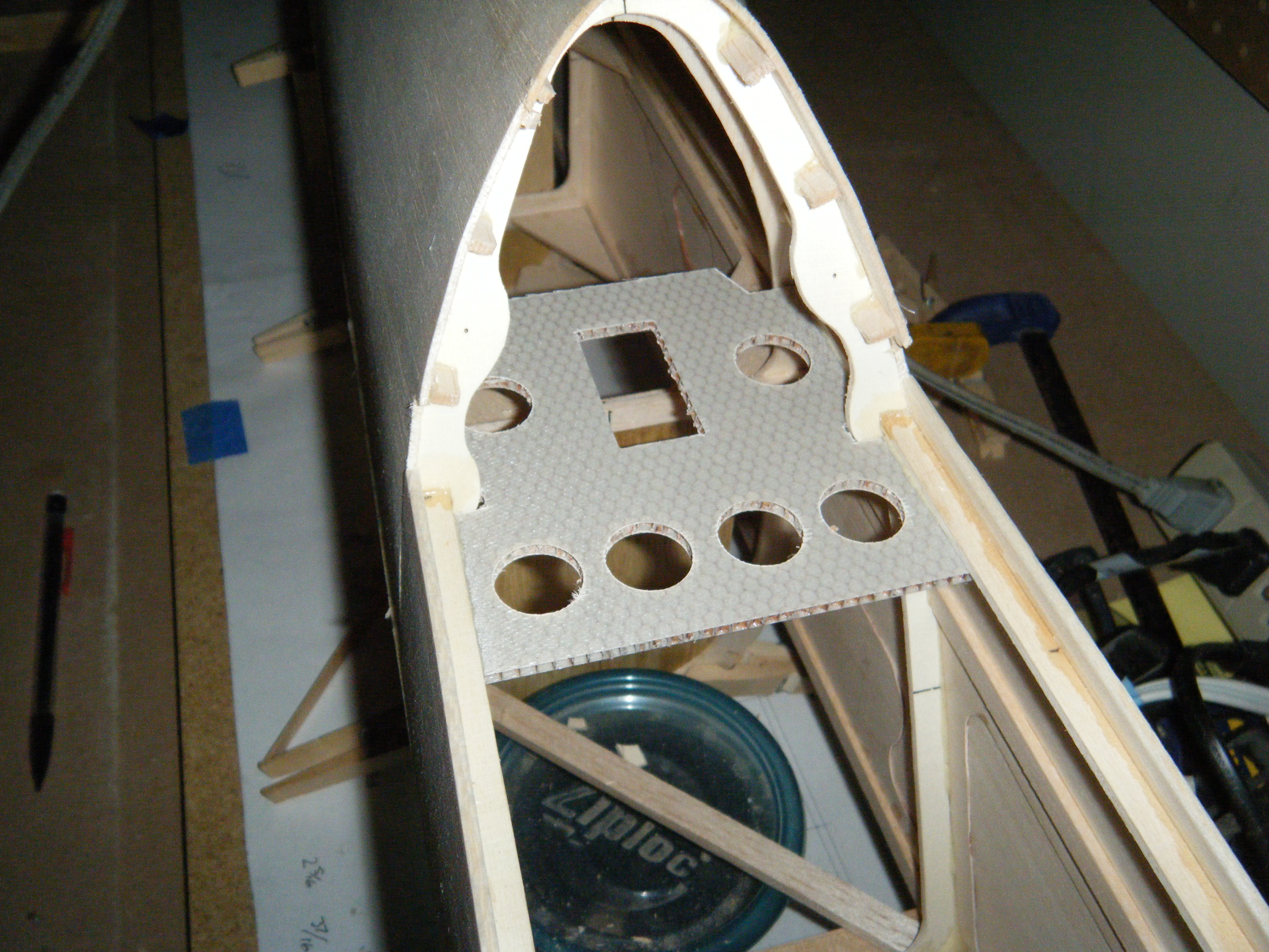

I have added the 1/8" nomex honeycomb rudder servo tray prior to removing the fuselage from the jig as it also provides additional stiffness to the fuselage.

Jeff,
I see a very slight gap where one of your notches fits the fuselage. Judging by the work on the rest of the plane this is unacceptable and now your fuselage is virtually useless. lol...just kidding, AWESOME work and looking forward to seeing the new one fly in the spring!!!
Arch
Old 01-05-2011 | 06:07 PM
  #40
Viper Driver's Avatar
Joined: Feb 2003
Posts: 397
Received 5 Likes on 5 Posts
From: Archer City, TX
Default RE: Lightning Build
Dang Arch, I guess I need to dial the resolution down a bit more to hide the flaws

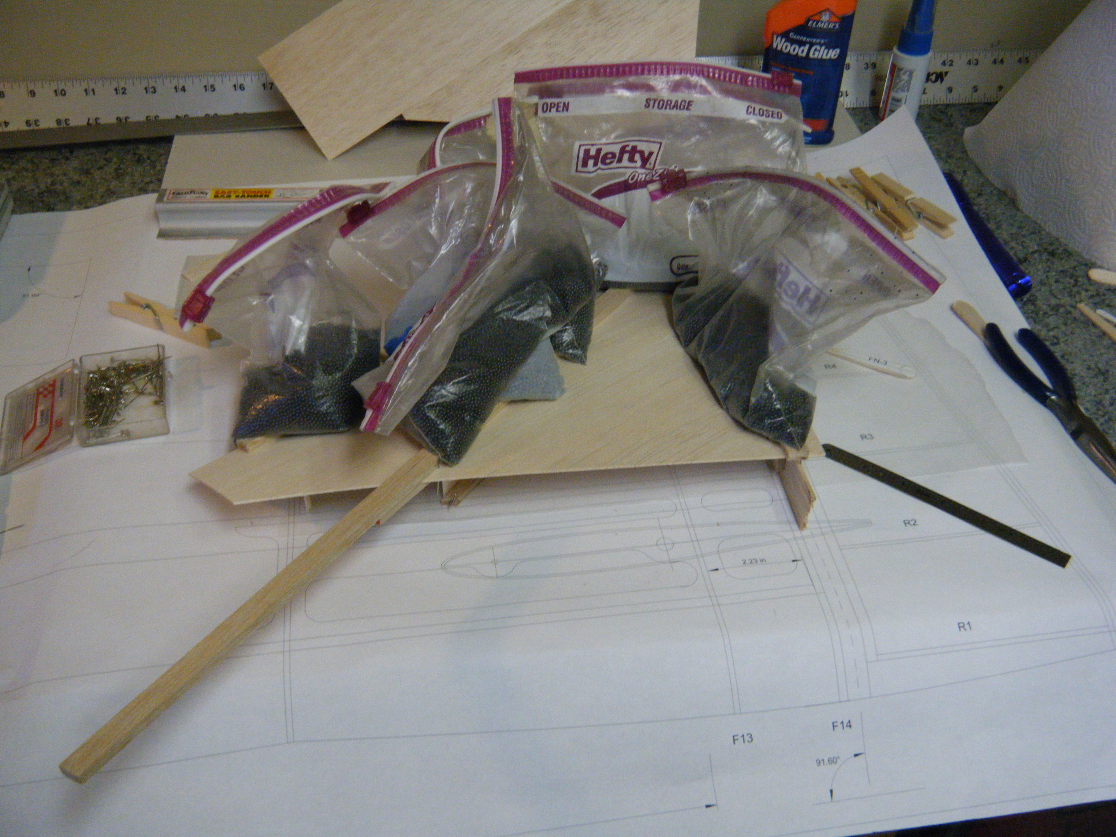

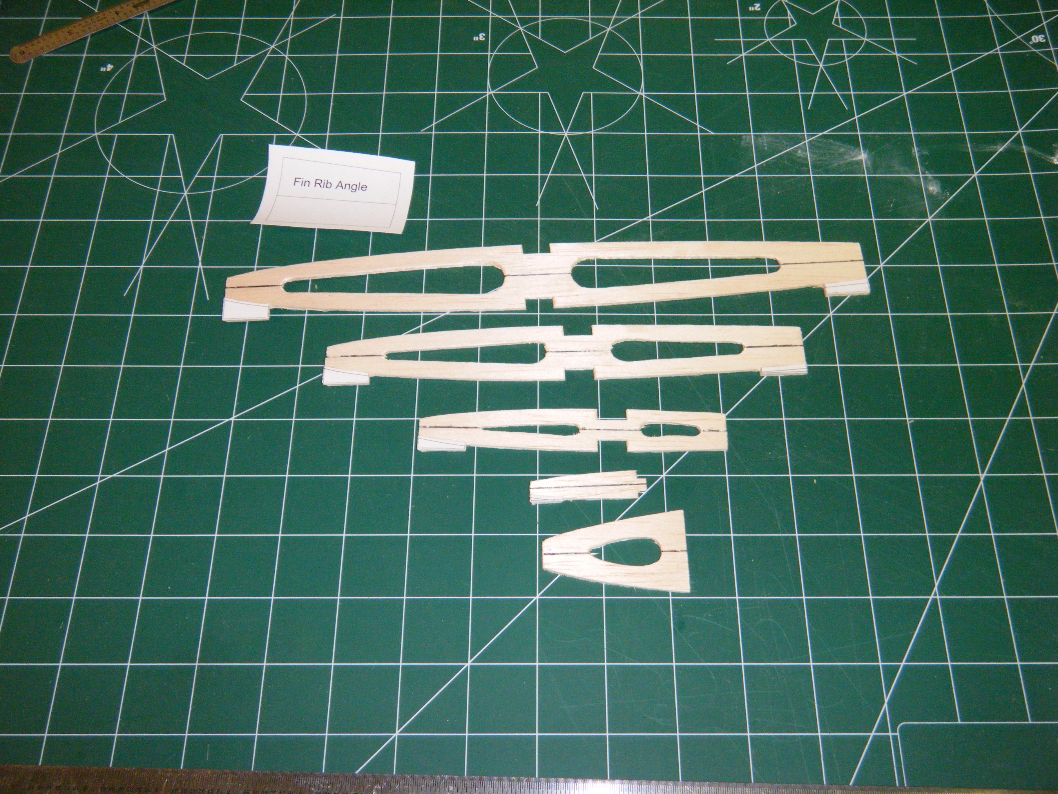

On to the fin. The fin is built up with 3/16" balsa ribs, 3/16" x 3/8" balsa spars, and sheeted with 1/16" balsa. I reduced the sheeting from 3/32" balsa that I used on the prototype to save some weight. The fin came out plenty strong, but the thinner sheeting is going to make finishing a bit tougher. I think if I was going to do it again, I would go back to a minimum of 3/32" sheeting for built up structures.
The ribs are cut with alignment tabs, making construction similar to building a wing.
I use zip lock bags filled with shot as weight to hold down the sheeting.

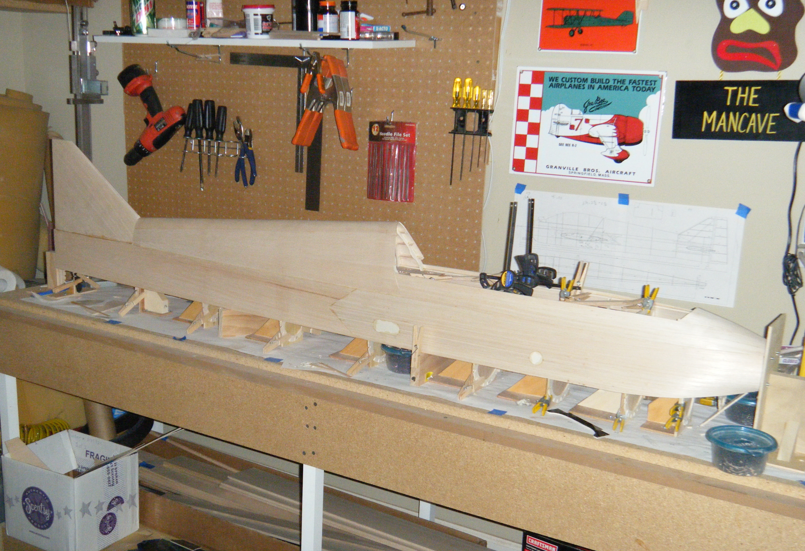

The day I have been waiting for is here, removing the fuselage from the jig. Prior to removing it, I did put some temporary cross bracing across the canopy opening to ensure the fuselage doesn't flex prior to sheeting the bottom.
If you remember from and earlier post, I used hex head screws to hold the jig stations down. Now all I had to do was slide my ratchet under the fuselage, remove the screws, and the fuselage is free. The formers were held to the stations with clamps and rubber cement. After removing the clamps, I slide my xacto between the former and the station and it easily popped free. Now we have a 90% complete fuselage!

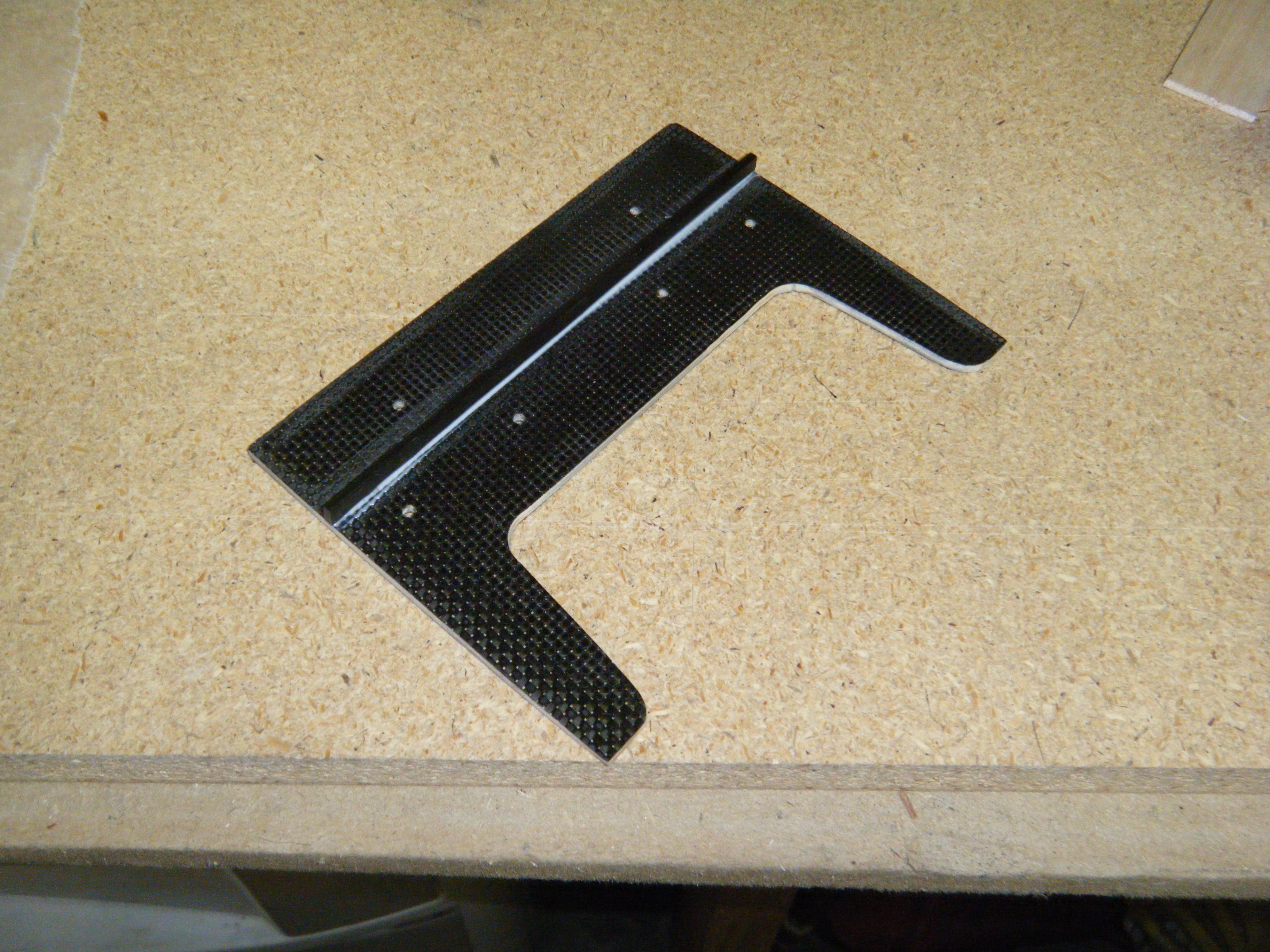

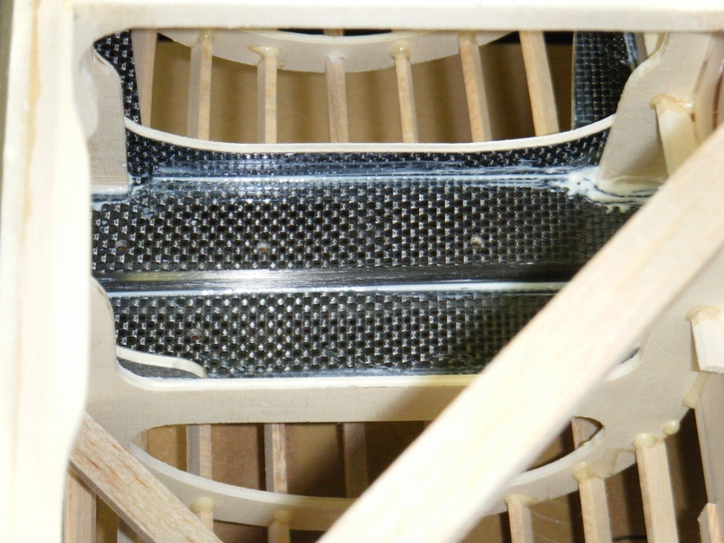

Now I can access the bottom of the fuselage to do the work I couldn't do while it was on the jig.
The forward landing gear former is made from 1/8" light ply laminated on one side with carbonfiber. Once in place, this former ties the front to the landing gear plate into the fuselage spars to prevent the front of the plate from pulling out of the fuselage (lesson learned the hard way from Lightning #1). This is glued in with hysol. There are two rear landing gear plate supports, made of the same laminate, glued into place at the back edge of the gear plate to prevent the plate from pushing up into the fuselage.
I also glued in the lower 3/16" by 3/8" balsa cross bracing.
