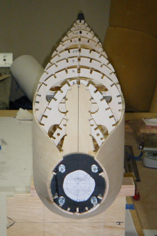

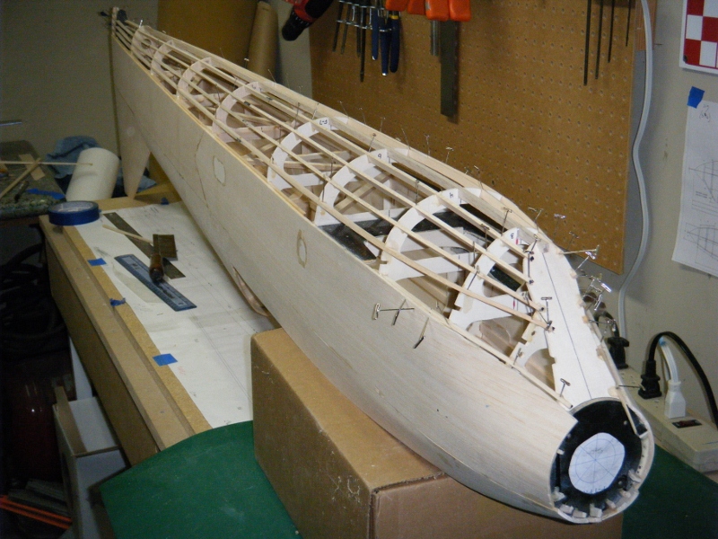

In my time away from "WORK" I managed some progress. Here, the lower stringers are installed. Also, a picture from nose on to show the curves a bit.
Next I will be doing some wetting and bending of balsa to fit the bottom.

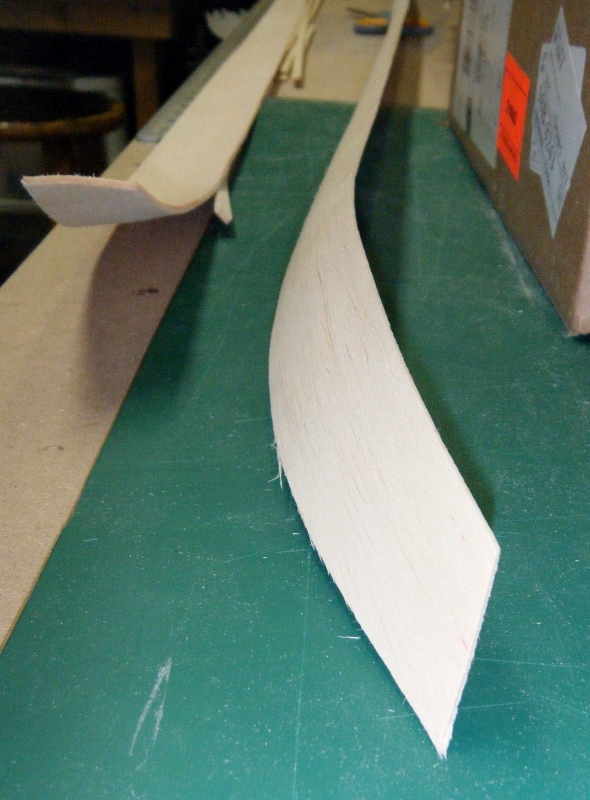

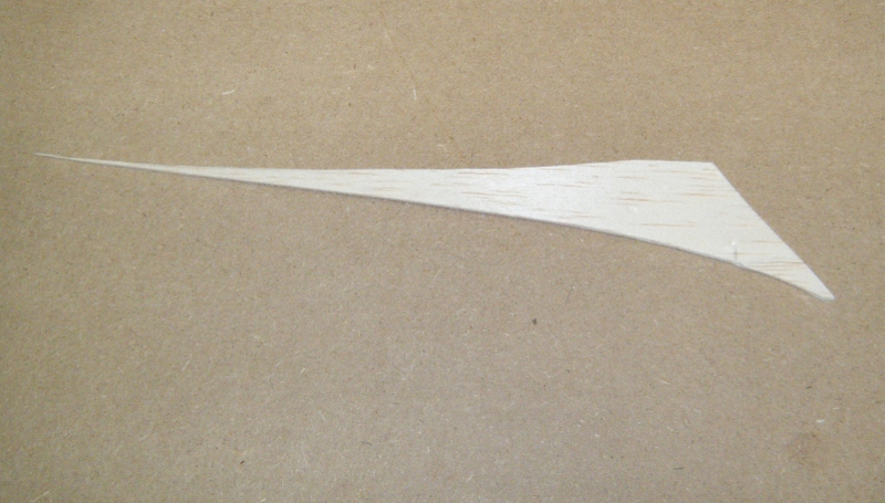

Now, on to the task of sheeting the bottom of the fuselage. This is more complicated that sheeting the top as the curves are more complex. In order to make it manageable, I am sheeting it in four sections. I don't have a good shape pre-mold like I did for the turtle deck sheeting, so it is all done on the fuselage. To keep it from getting waves, I only wet the inside of the wood, and I use balsa sticks pinned along the edges to keep them straight. When I tape the sheets to the fuselage, I only wrap it around where the formers are to prevent waves. I shape the edges of the wood prior to wetting, much easier to sand!
Here are pictures of the first two sections on the fuselage for molding, and after they dried and were removed.
ID:	1555048   Click image for larger version

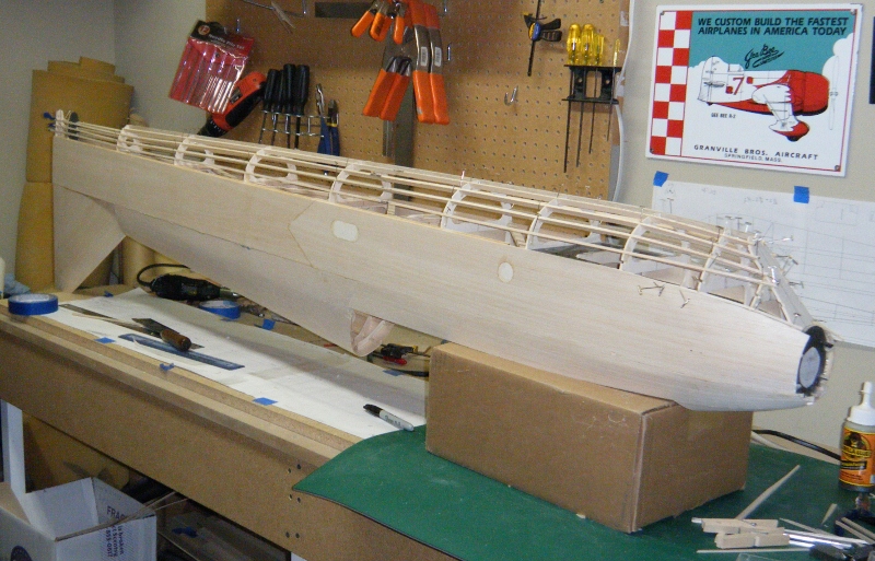

Section three and four of the bottom sheeting are molded in the same manner as the first two. Balsa holds shape very well once it is dry. Once I removed the dry sections from the fuselage, I trimmed the edges to make nice seams. This is difficult as prior to having the sheeting glued on, the stringers and formers have a bit of flex. As you try to hold the parts into their final position to test the fit, you distort the structure with the pressure of holding them in place. It may look beautiful has you hold everything together, but when you take your hand away, everthing springs back into place and your seams open up. This is exactly why I keep large tubs of filler on hand.
Electrical tape was not required at the balsa sticks I used to hold the edges down while gluing are covered with a layer of clear packing tape. Easy mold release! The syringe technique also made for much cleaner seams.

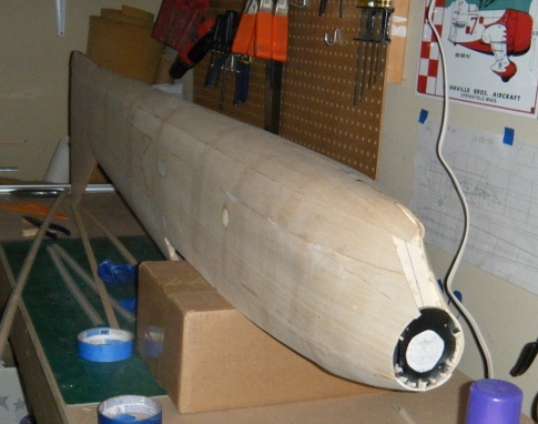

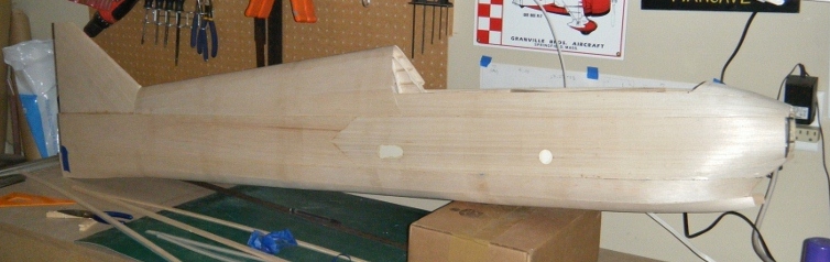

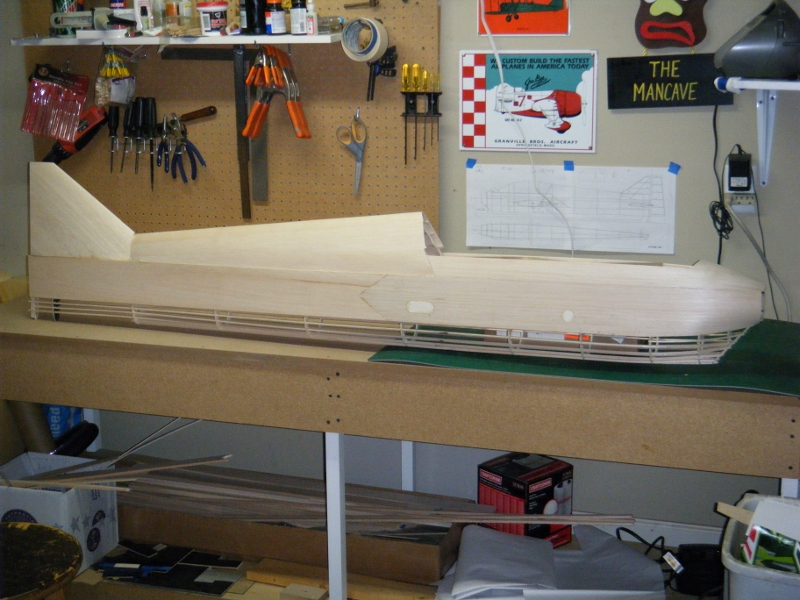

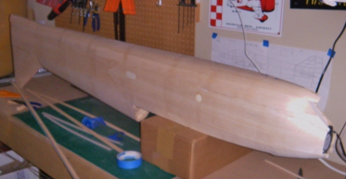

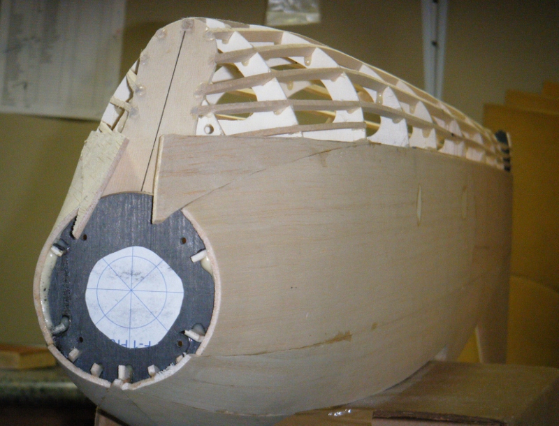

I have finally cleared out a mountain of blue painter's tape in my garage to reveal a 99% complete fuselage. The only steps remaining are to install the wing and stab sockets, and then sand to final shape. Also, I left the sheeting off of the bottom of the subfin area to allow access to the stab socket. Once the socket is glued in, that area will be sheeted. Right now, the fuselage weighs in at 20.8 oz. For comparison, the prototype weighed 28 oz at the same stage. Now, on to wings and stab.
ID:	1562165   Click image for larger version
ID:	1562166   Click image for larger version

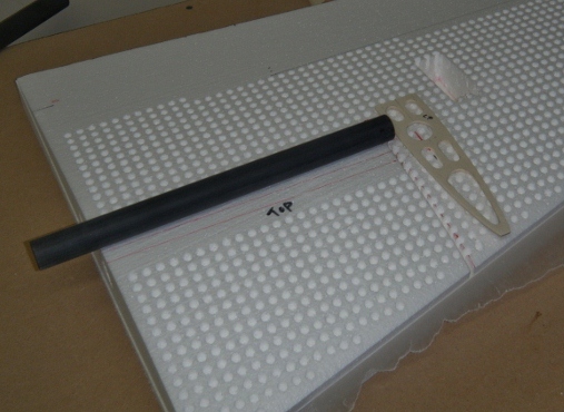

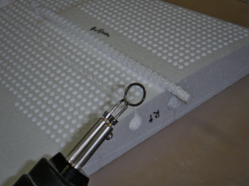

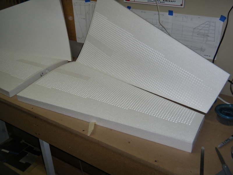

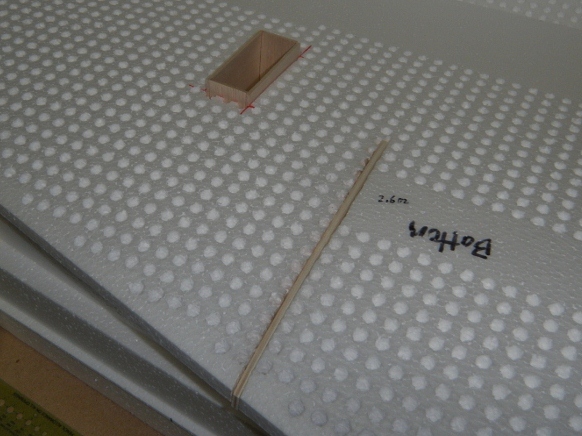

On to the wings. They are more or less conventional foam and balsa wings. I do use some strips of carbon fiber for reinforcement. I had the cores cut by Mark Hunt, Insight RC. The unique thing about the way Mark does wings and stabs is his "honeycomb" method. He drills a grid of 1/4" holes rather than the traditional square pattern. I use a 1/8" lightply rib at the end of the wing socket. I also cut the holes for the aileron servos and install balsa boxes prior to sheeting. I made a tool out of 1/16" wire to cut the hole for the aileron servo leads. It is a simple loop that plugs into my soldering gun.
ID:	1566065   Click image for larger version
ID:	1566066   Click image for larger version
ID:	1566067   Click image for larger version
