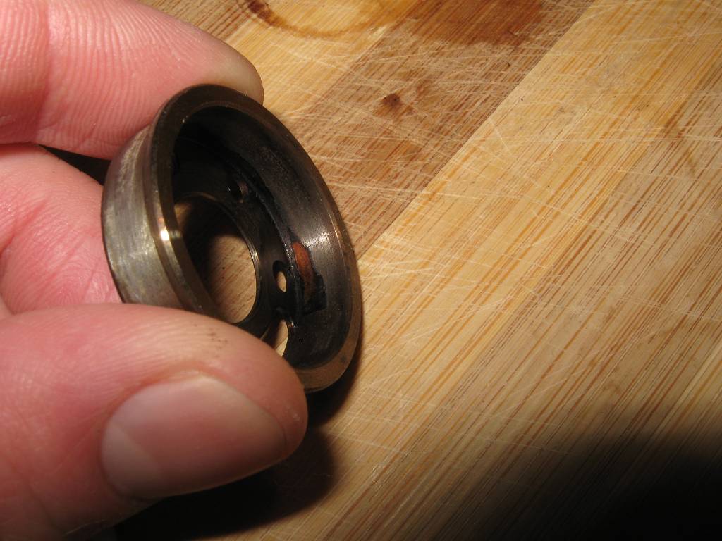

Guys, thank you all!
nonstoprc, that's just what I tried when I was on it a few weeks ago. Maybe the diameters of the dowels weren't that perfectly sized.
wagen017, Plettenberg didn't have any available, but quoted about 12 euros for the ring + 5 euros for regular shipping to Bulgaria. Maybe this would be a nice bet, because I bent and then straightened the original one, despite so far the motor seems to be running axially.
Aussie_Knife_Edge, I may try the heating or freezing method. I don't have a Dremel
Thanks!
Nickolay
Thanks!
Nickolay

Hello all!
I tried freezing the assembly for a few hours and then putting it along with some nicely aligned round wooden blocks in my vice, but that didn't help.
What would you recommend? Maybe heating it all in an oven? But at what temperature?
The ring is not made from aluminium, I think.
Thanks!
Nickolay
Thanks!
Nickolay

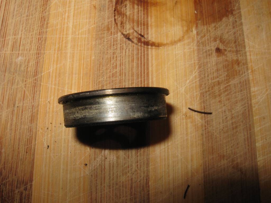

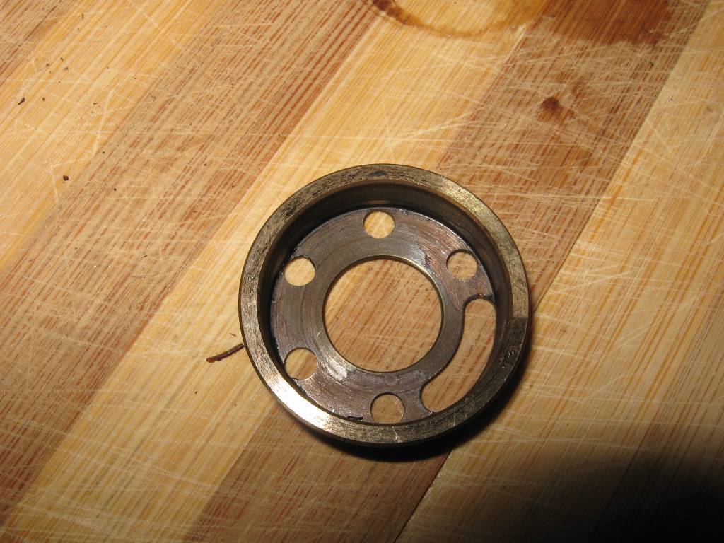

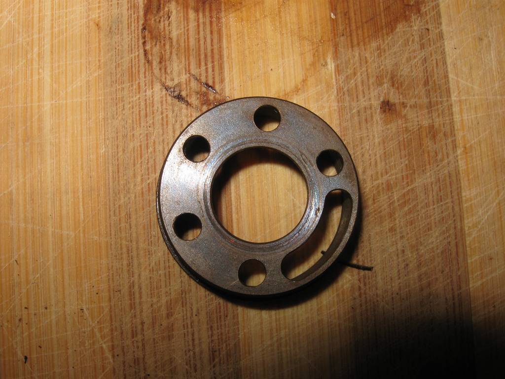

Today I made some tests. I used our kitchen oven. First, I set it to 200 â°C and put the assembly in it for about 5-7 minutes. I tried to separate the ring and bearing, but I didn't manage to. I then tried 300 â°C, but that didn't help too, maybe I didn't wait enough. Finally, on the third approach at 350 â°C (the maximum temperature of the oven) and some more time in it, I could hammer gently the ring out, using the round wooden blocks. It seems the bearing and ring were glued together.
I have another concern, though. On the pictures you could see the ring changed it's color to much darker. Maybe an oxide built up. Do you have any recommendations on how to clean it or I should buy a new one? I'm thinking about some alcohol and maybe acetone to clean the glue residue. Afterwards, if the new bearing doesn't fit, I'd have to heat the ring again and try again, but I'd like to get it cleaner first.
Thank you!
Nickolay
Thank you!
Nickolay
#39
My Feedback: (90)
Good to know that you have taken the ring off.
To mount it, you may need to consider the same mount method with good high-temperature locking liquid. The ring probably should be put in the freezer prior the mount.
The 350 degree heat should destroy the integrity of the glue and maybe you could lightly sand it clean with 400grit sand paper?
