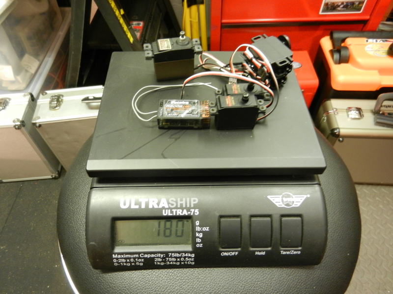

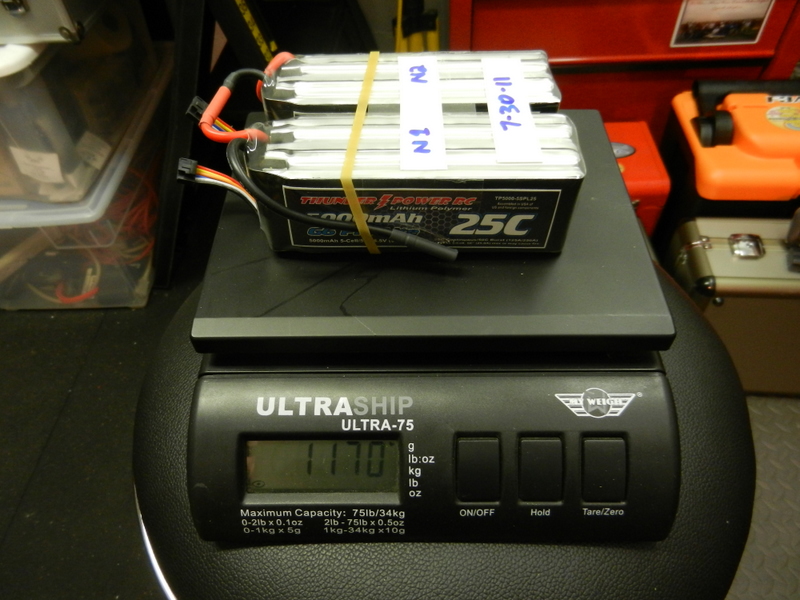

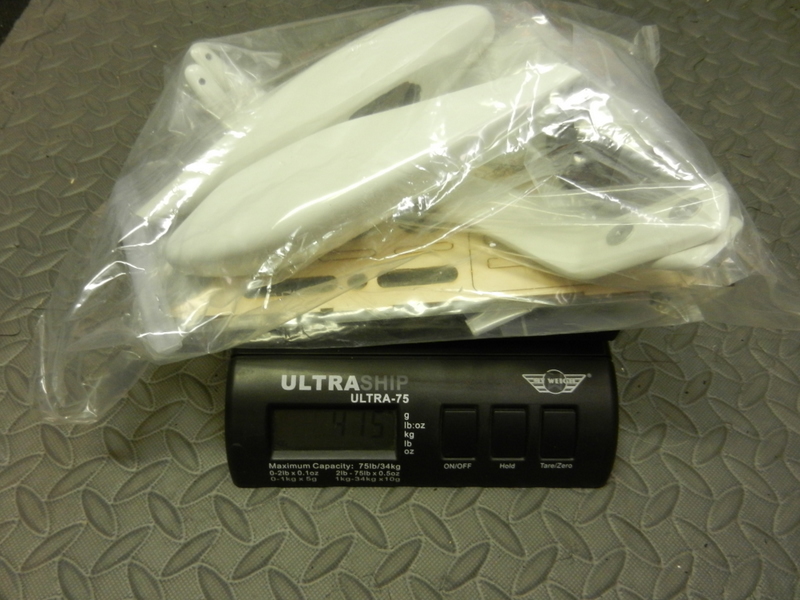

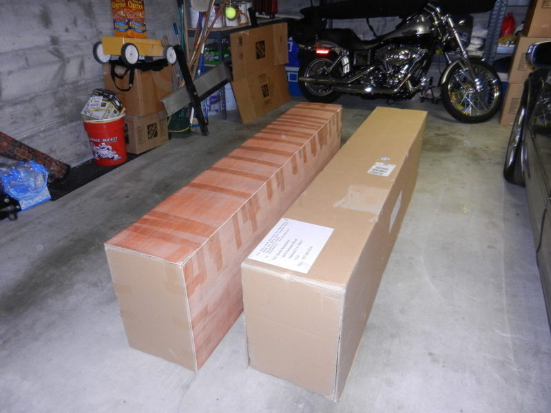

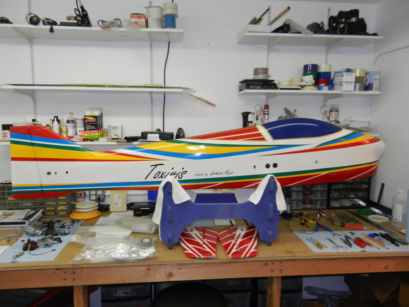

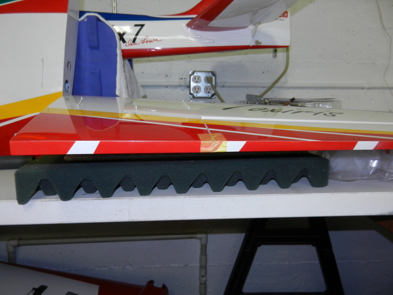

My new Toxiris arrived today! DHL delivered the plane safe and sound after a 3 day trip... not bad! The box was in perfect shape.... after lifting up the cardboard top I was surprised to see the lower cardboard box lined with light ply on the outside to protect it even more. See the pictures for more detail... you can see this plane is BIG!

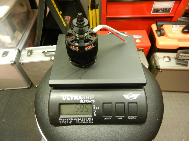

I weighed all the components and they are as follows:
Fuse - 1130g
Left Wing - 390g
Right Wing - 380g
Wing Tube - 50g
Left Stab (and tubes) - 115g
Right Stab - 100g
Parts/Accessories Bag - 415g
I plan to use a Plettenberg Advance motor (595g) and all Futaba servos/RX (total of 180g). TP5000 batteries (1170g) or TP4400 (1040g), F3A Unlimited RX battery (45g), Digiswitch and regulator (15g) and probably a Jeti ESC (120g) - weight should be in the 4880g range. This is a great looking ARF and I'm really excited about it and can't wait to start putting it together. For more details see the [link=http://www.toxiris.com]Toxiris[/link] website.
Some pictures follow:

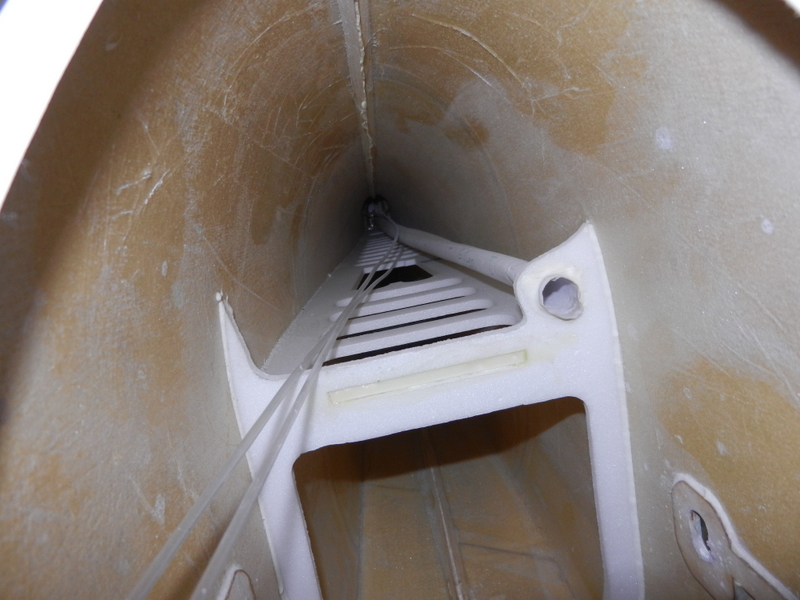

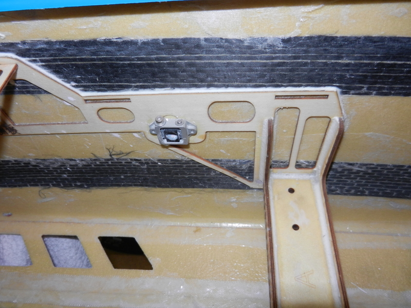

Out of curiosity, why does the carbon reinforcement inside the fuselage right side different from the left side?
No idea...

Maybe it's to compensate for Derek's unequal left/right/positive/negative snap setups?

I'll offer up an idea on this. As I found out with my Opium, there is more pull on the front left of the fuse from a rear mount type of setup like with the Pletty Advance. I actually pulled the side of the fuse inward and it put a dent there on that side. Had I reinforced that side, I don't think it would have happened.
As I say, it's an idea..

Looking at the picture inside the fuse toward the tail, i can see the inner fiberglass layer that present a non uniform colour.
I have the suspect that the lighter areas could have a weak bonding to the foam. I hope it's only a matter of light effect instead.
Roberto,
I hope you are wrong! It seems pretty stiff and there doesn't appear to be any breakdown of the fiberglass in those areas.

I personally have seen that with the flash of the camera before. Does it look a uniform color when you view it normally Derek?

Sometimes the airex is a little rougher, or more porous, on one side than the other which gives the "patchy" look when using a light layer of glass on the inside. I imagine the camera flash enhanced this also.
