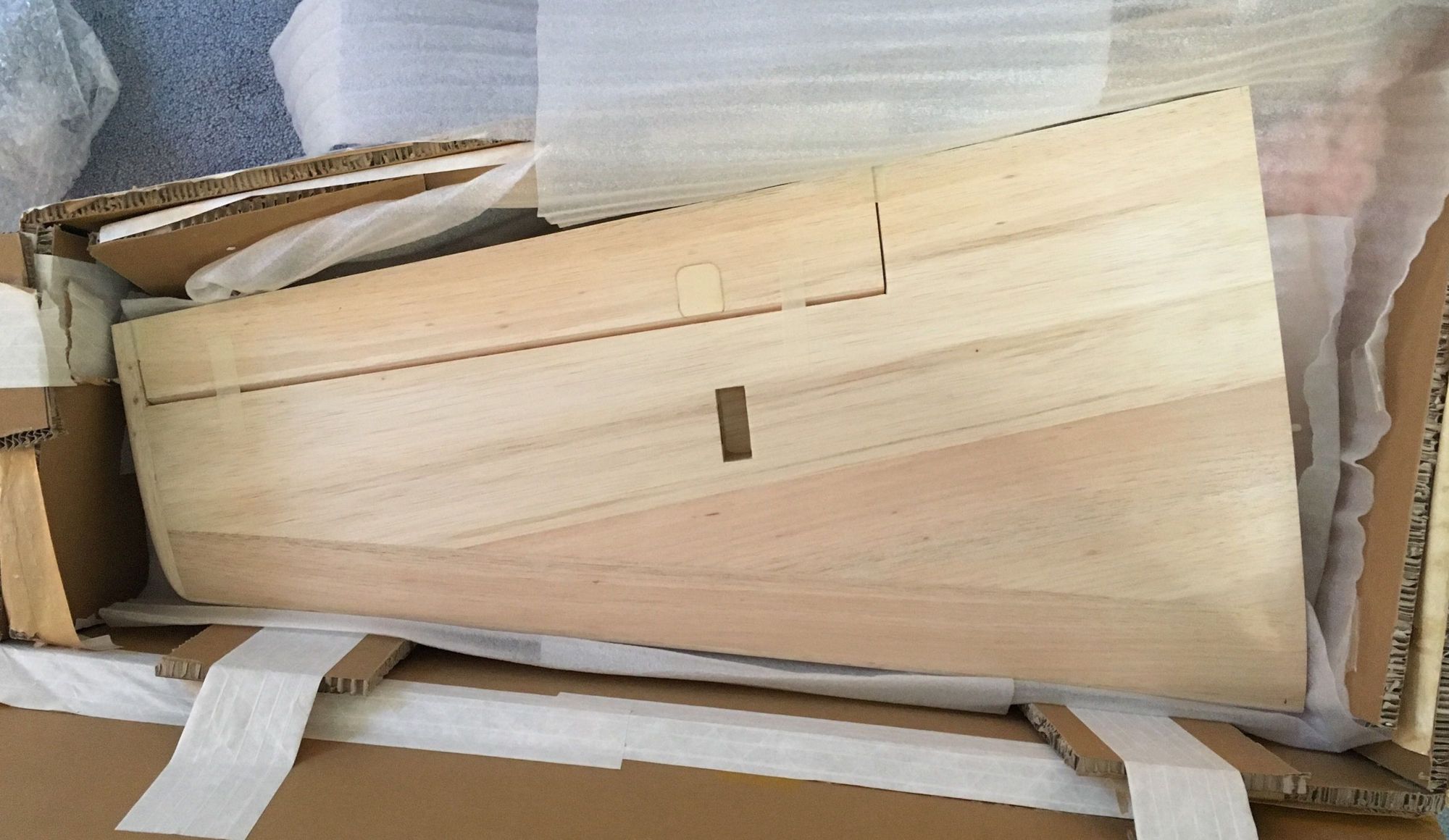

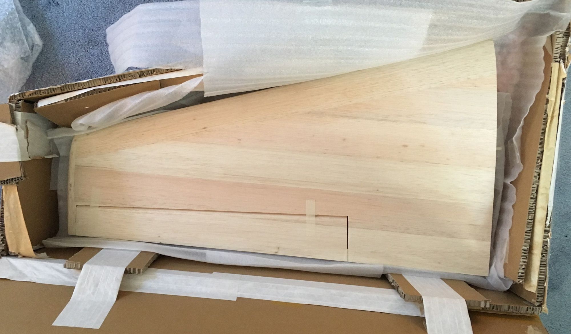

http://www.f3aunlimited.com/webstore...roducts_id=607
We have the replacement wiings for a few of the planes we had in stock.
Granted it took a longtime.
I've flown a Griffin the whole season and it's a proven to be an very good plane. Plus AC Glenn flew his to a top three finish in the US Nationals.
We can also offer anyone partial and complete building services so you receive a turnkey plane on any of our F3A Models.
By this time next week we will have an even more interesting option. Dave Snow is going to have lighter built up wings as an option.
They will cost $400 and be in a ARC state. We estimate that the savings in weight will be 6 ounces or more.
I'll have my new set and post a picture soon.
Thanks for your patience. Mike Mueller
FWIW we only have the White Griffins stock at this time.
