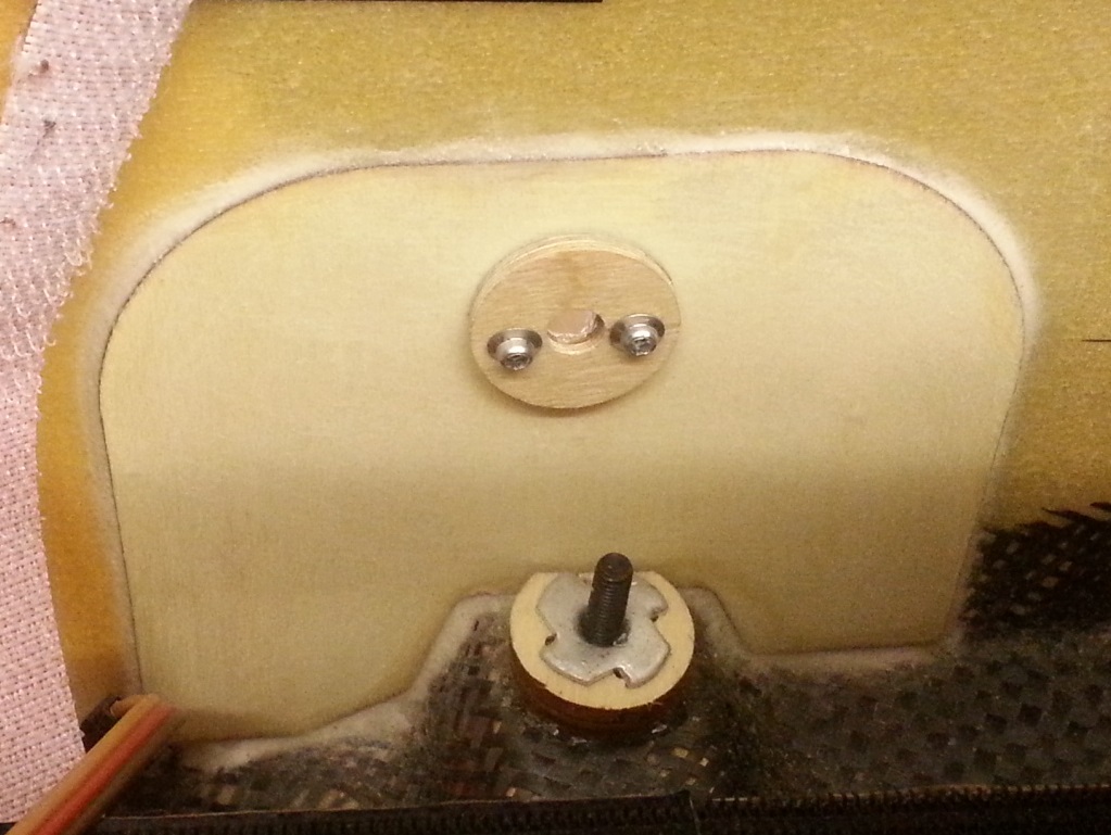

Tom, What's the best approach to using screws on the front pins rather than a wood donut epoxied in? Are those pins threaded?

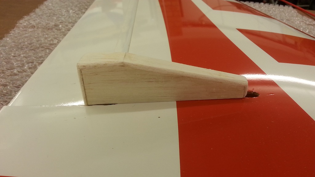

I fitted the wing to the body, put the donut in place and used two servo screws to hold it in place. I had already drilled the two holes in the donut. Eventually I will replace the servo screws with two M2 nuts and bolts.
I also made two of these linkage covers from some 2mm balsa one night when waiting on the batteries re-charging. They are a snug fit so that they do not easily fall off, and they stop the linkage snagging on the inside of the wing covers.

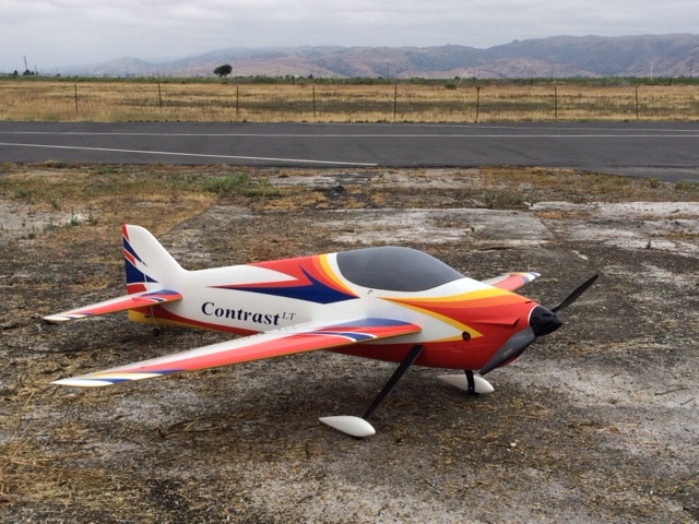

First 3 flights on Saturday. Very little trim needed. Was a bit nose heavy with the CG right at the tube. Moved the battery back about an inch, vast improvement. Perhaps it's me being nervous with a new plane, perhaps it was the wind, perhaps the Contrast LT stalls more easily at touchdown speeds than my old trusty Neptuno, perhaps all three.... but I definitely got close to busting the thing at landing 2 out of 3 times. Second landing, too slow, stalled a foot above the ground, but landed flat on the gear (busted prop) The 3rd one was actually looking really good, then a gust came up, raised my altitude a foot or two, then it tip stalled. Scuffed some paint off the bottom of the wing tip. Total cost, a falcon prop :-( Next adjustment is to add a tad of positive wing incidence, as it seems to pitch towards the canopy in both up and down lines. Any thoughts?

I used gator adjusters on one of mine they work fine . Also the tip stall problem was overcame by running a 20.5x14 or a 20.5x14.5 and adding stab fences to the stabs will solve the problems it has with a negitive G aspect (Going over the hill in a push push pull humpty bump ). I found all of this out while flying this plane last season had over 1700 flights on them. They are a great plane, Algis is a great guy who builds them personally one at a time.

The plane nature needs to fly a little faster.so the 14 or 14.5 gives you the air movement that is need to keep the tip stall down. on the negative g problem is that the rear end of the plane quits tracking and gets loose like a race car getting loose in a corner. If you have anymore questions please ask.
