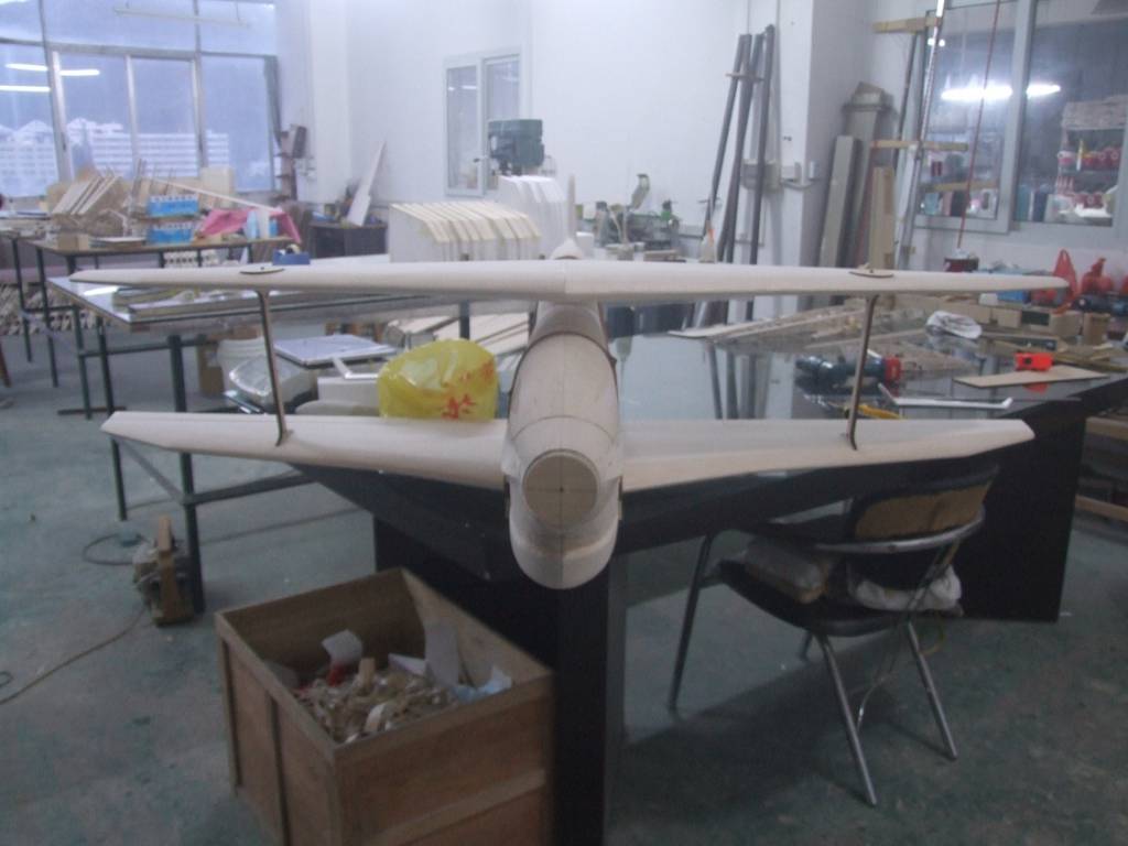

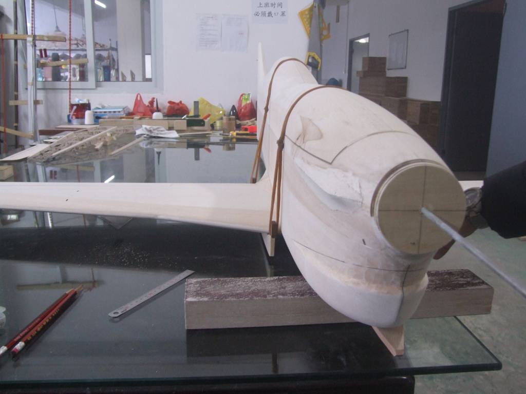

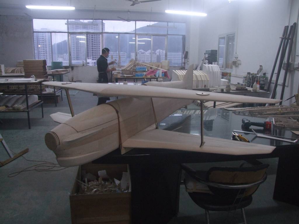

Here's info on B.J.'s bipe project. He is calling it the Competition Biside. The name relates to the double natured aspects of a bipe and pattern flying. There are two wings and strong positives along with compromises in a biplane design, hence the two sided aspect of the design. In addition, when you compete against someone they are your foe, but at the same time they are also your flying buddy. This is the two sided aspect of our sport. B.J. decided to roll all this into the name of his new design... Biside.
Here are some pics. As usual, he will conduct extensive testing and development prior to releasing it to the market, but the process has started.....
I am really sorry I didn't get a chance to visit him this past week, hopefully I can stop by on my next trip over there.

A couple interesting features on the Biside:
- DTFS wings, based on the wing planform utilized on the Episode and Nuance DTFS design.
- Flying stabilizer.
- Narrow fuselage.
- Contra option. All of his airframes can be ordered for a Contra Drive, meaning thrust and spinner diameter settings for the Contra Drive.

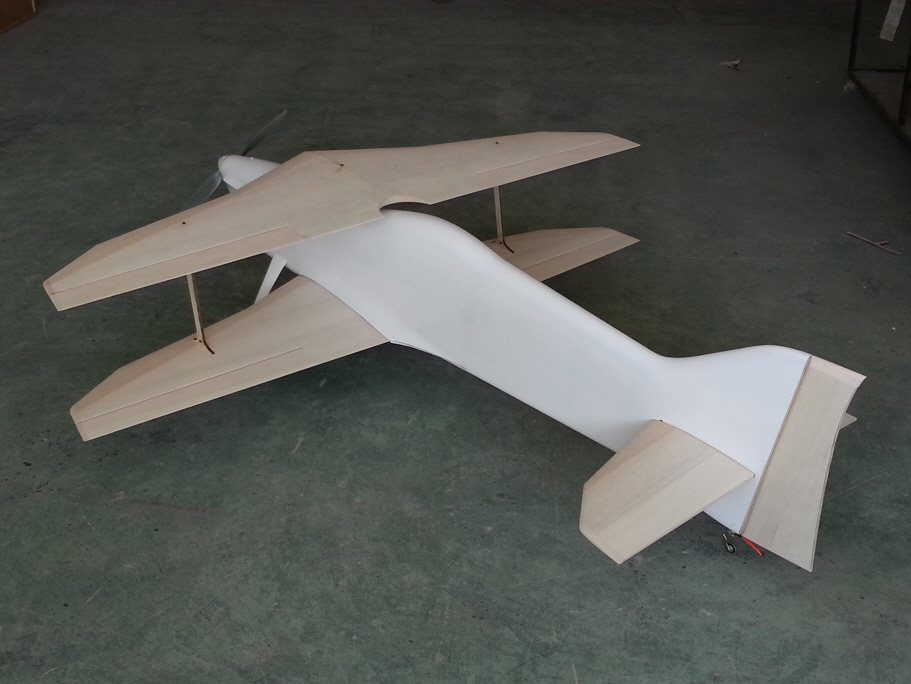

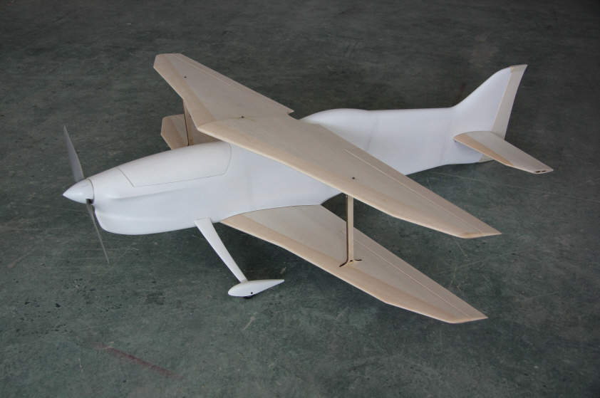

BJ has been making progress on the Biside. Here are the latest pics. I think it looks fantastic. He is hoping to put in the initial test flights this week. He is very deliberate in his testing and release process so this is just the beginning of the Biside introduction. Hopefully all goes well with the flight testing and it makes it to market soon. If it is as awesome as his last two projects then we are in for a treat.
Specs:
Weight 2038g (frame only)
Length 1998 mm
Wing span 1700 mm
wing area 96 dm2
H.Wing area 14.2 dm2
V.wing area 16.8 dm2

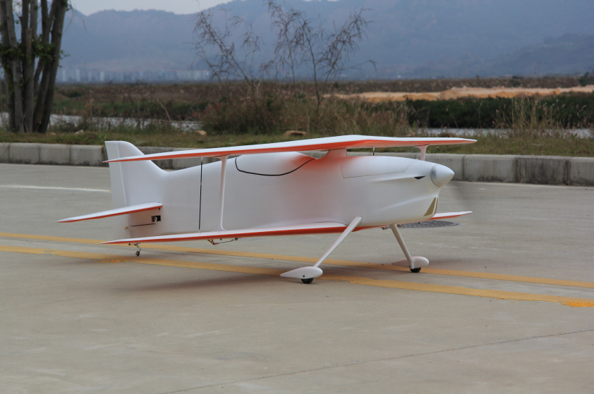

BJ has test flown the Biside. Here are some pics.

Hi,
BJ put up a lot of detailed comments on his blog site: http://rcone.kr/board/index.html?id=bjair1&no=110
here's some specific data
Weight
ARC weight 2038g (landing gear, wheel, pants,tail gear all included)
Accessories 1230g (neumotor, apc 20*15, esc, servo, rx battery,EX cords)
Others 272g (covers, Battery bed , rods , horns etc)
Battery 4500mah 10S 1240.3g
Flying 4780 g

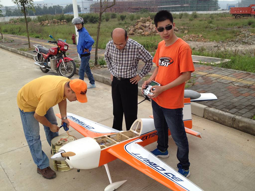

After lunch we figured we had enough time to go flying again so he threw his IMAC Extra 260 in the back of the van and we flew that. PaPa did some cool 3D flying over the water. I got to throw it around a bit then we noticed that time had escaped us and we had to race to the ferry terminal. I got there with just a few minutes to spare.
My day was complete. I saw some cool stuff and visited my good friends. I tested the future and I think it has two wings....
