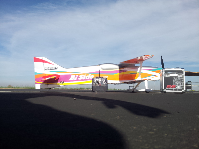

Installed the 28x in the Biside and tried the last method Steve told us about for the throttle to rudder mix.. Where you trim for the downline and add mix points for everything else. Works really well. I did try to add more right thrust and as BJ said, it really didn't make any difference. I'm really curious how the contra works on it. I use the F3A U 4500's and the batteries are about 2" from the back of the Pletty Advance. I do have the new wing incidence kit on it. It flys pretty awesome in my opinion. Kinda shocked that F3A U has them for such a good deal still. U da man Mike! Almost want to pick up a ARC version and do my own scheme. Although I don't really have any issue seeing it. Maybe if work picks up soon.

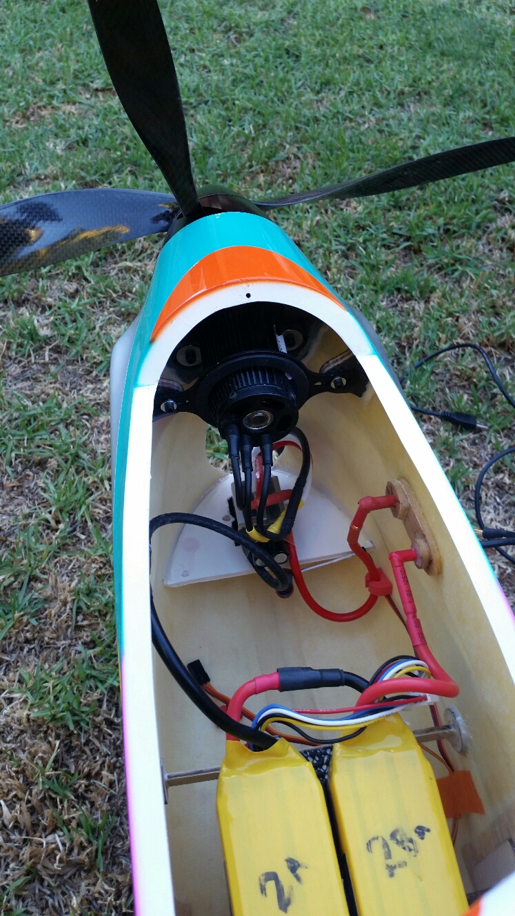

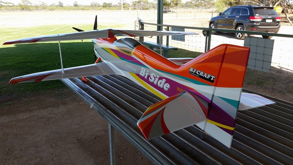

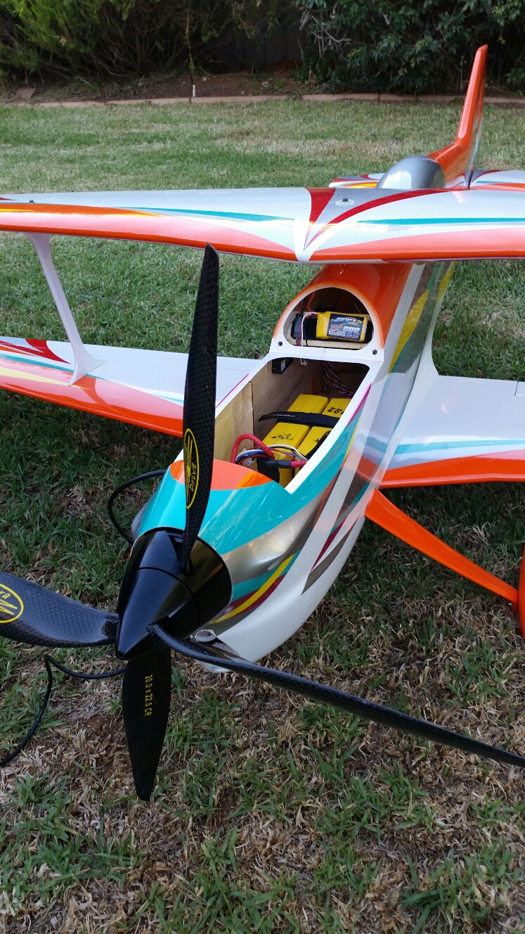

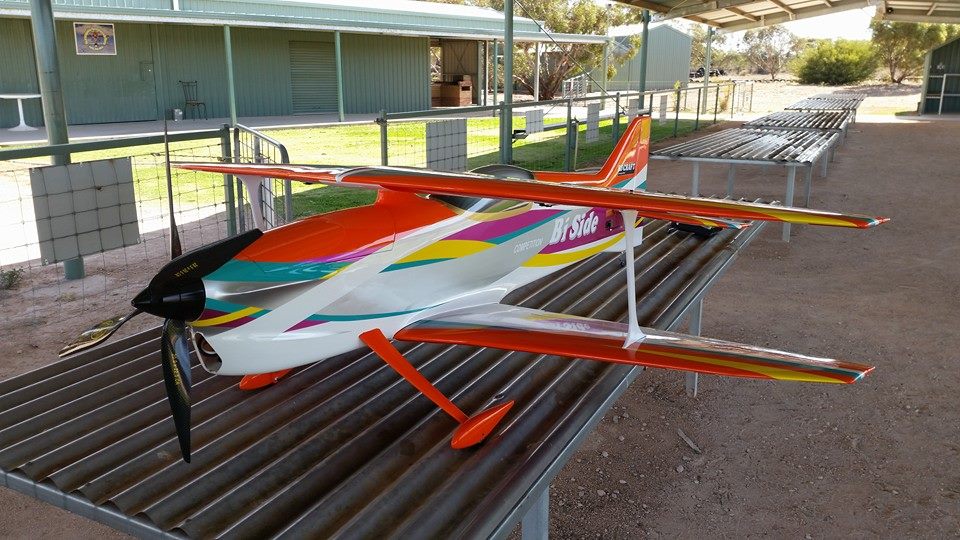

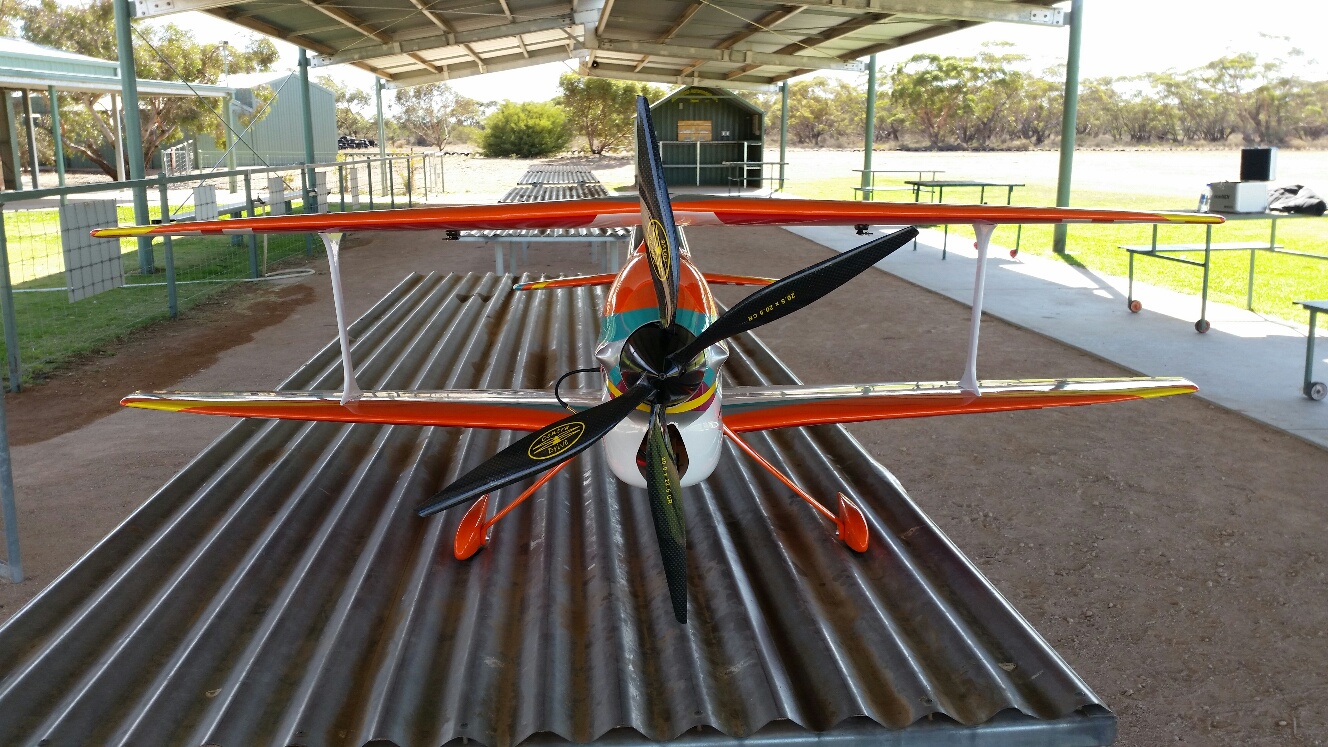

Recently got mine in the air . . 22 flights on it now, and it's a great flying airplane. Just a real pleasure to fly.
It does everything easily and I have no issues with the build quality or airframe design. I think BJ knows what he's doing in that regard.

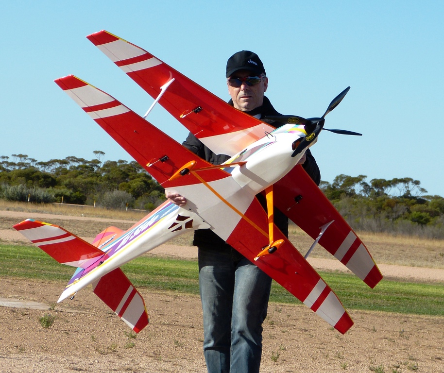

I haven't added the shim at the top wing mount, and it hasn't been an issue at all . . although I will add it just for a little extra support at the root. You can see in the pic, I carry it by the leading edge of the top wing and trailing edge of the bottom wing . . feels safe and secure.
Value for money, it's a 10/10 (if you want a Bipe).

Jeff,
What size/weight packs are you running?
Any issues getting the CG with the Contra?
I like the painted landing gear...looks nice
Old 04-10-2015 | 03:49 PM
  #509
Jeff Boyd 2's Avatar
Joined: Mar 2005
Posts: 732
From: Adelaide, AUSTRALIA
Originally Posted by ltc
Jeff,
Thanks .. I like the scheme. Very easy to see
I'm using 5200's weighing 1200g. I could go smaller in pack size/weight as I'm only using 3200mA for P15 on average even in wind. No problem with CG. Flying weight was 4780 .. but I've added the stab fences since.
It has a very light feel in the air. Nicely locked on and predictable. Easy to snap and it's the easiest airplane to stall and induce a spin in either direction I've flown.

Hi Jeff the weight or your plane is really impressive with the Contra unit.
I'm happy to hear that it's good so far.
