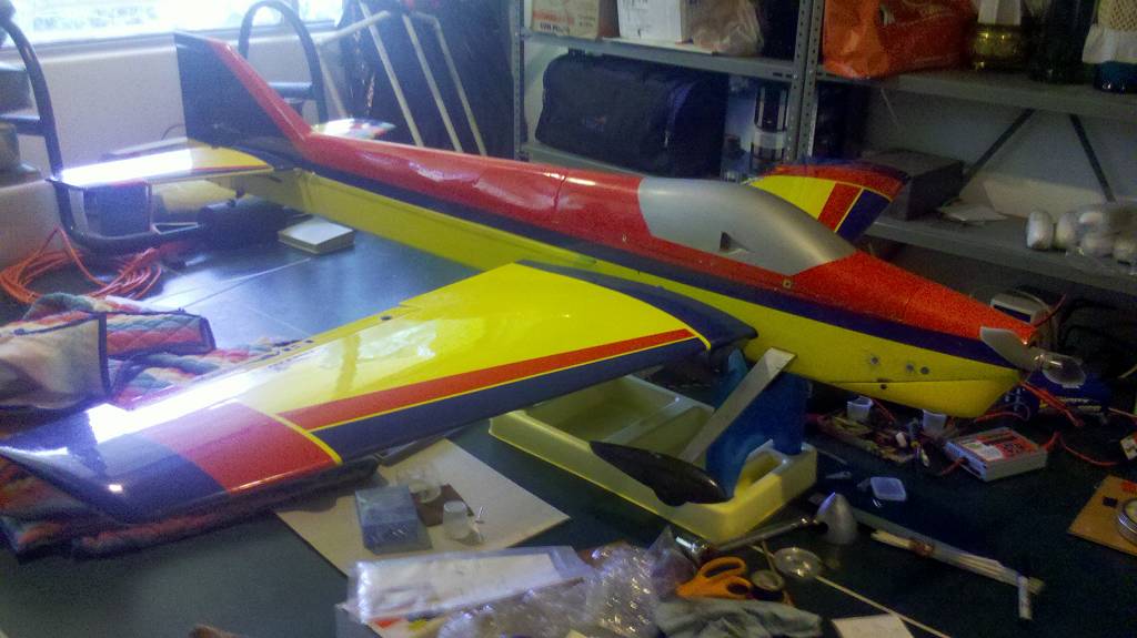

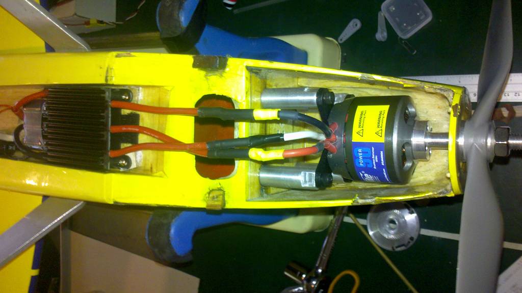

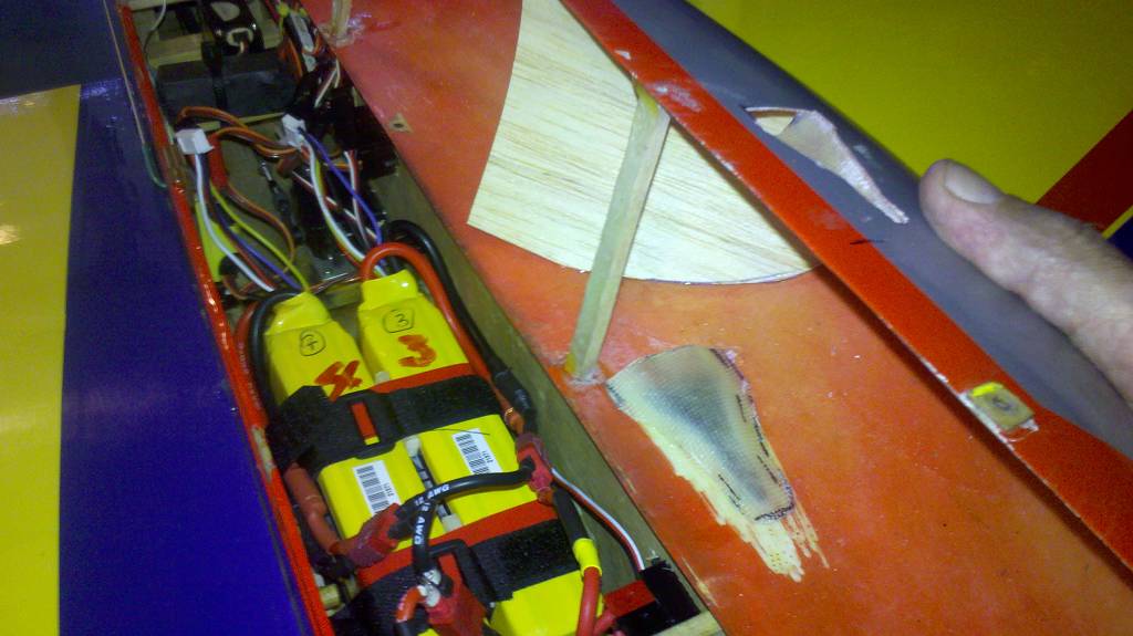

Mark:
I have just finished an E-flight Power 90 conversion on an old Desire .
The Power 90 is a good option for a 110 size plane weighing around 8lbs.
On an 8c setup with a 17x10 APC it produces 1800 watts (225 watts per pound)
Zippy Compact 5000 mah.
Here are some pics, showing the installation and cooling ducts. The batteries and ESC are just warm
after a 7 min run. The motor at about 60c, which can be reduced with a front baffle .

Here are some more pics showing the cooling ducting and ESC mounting in the vacant pipe tunnel.

ESC mounting

MK
ESC: I started out using a Castle Ice HV80 which stopped working after three runs, so will be
sending it to Castle to check it out. Meanwhile I am using a HK Sentilon 100A HV, shown in the pics, which
programs easily with the card for voltage cut off and so far works well on the default settings. Mine has a
number of upgrades not shown on the HK site, but they still call it a version 4.
To save time when arming the system then securing the four canopy hex bolts I used an Arming plug from F3A Unlimited.
