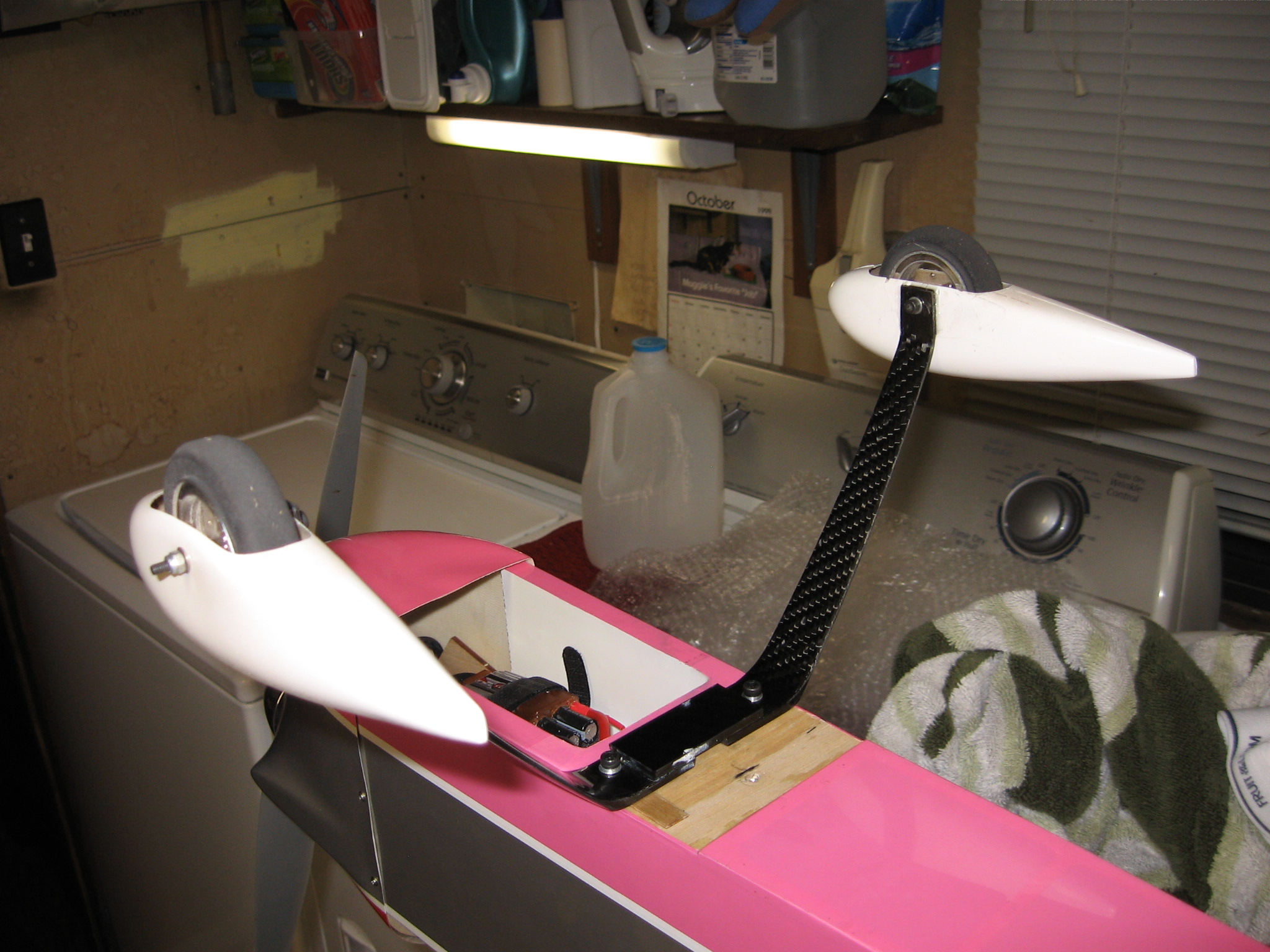

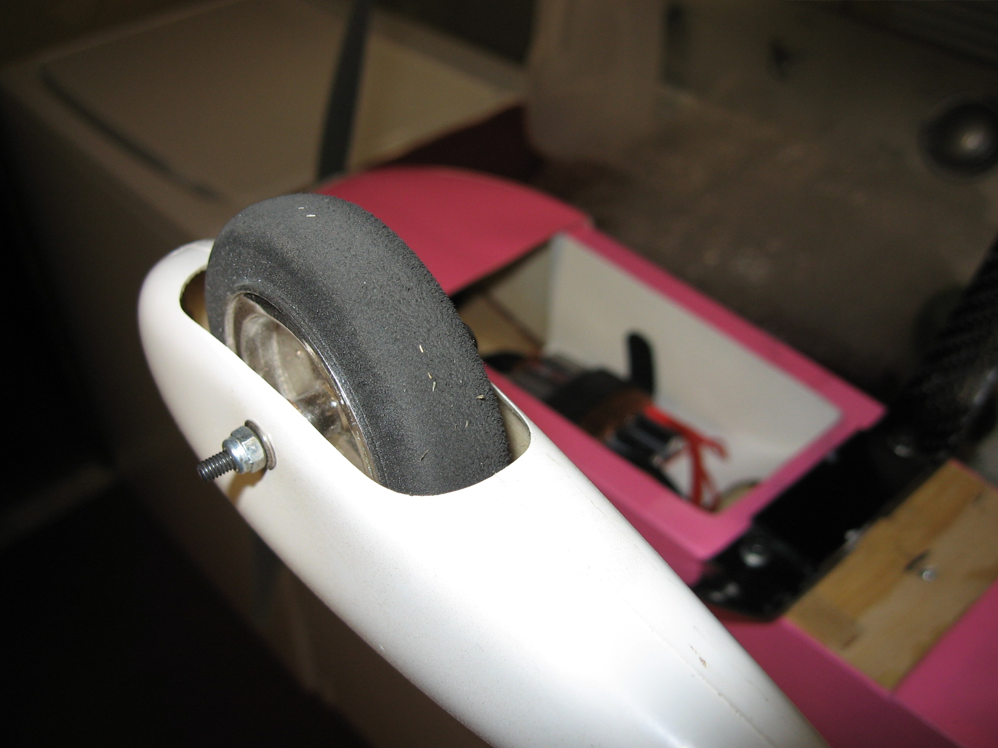

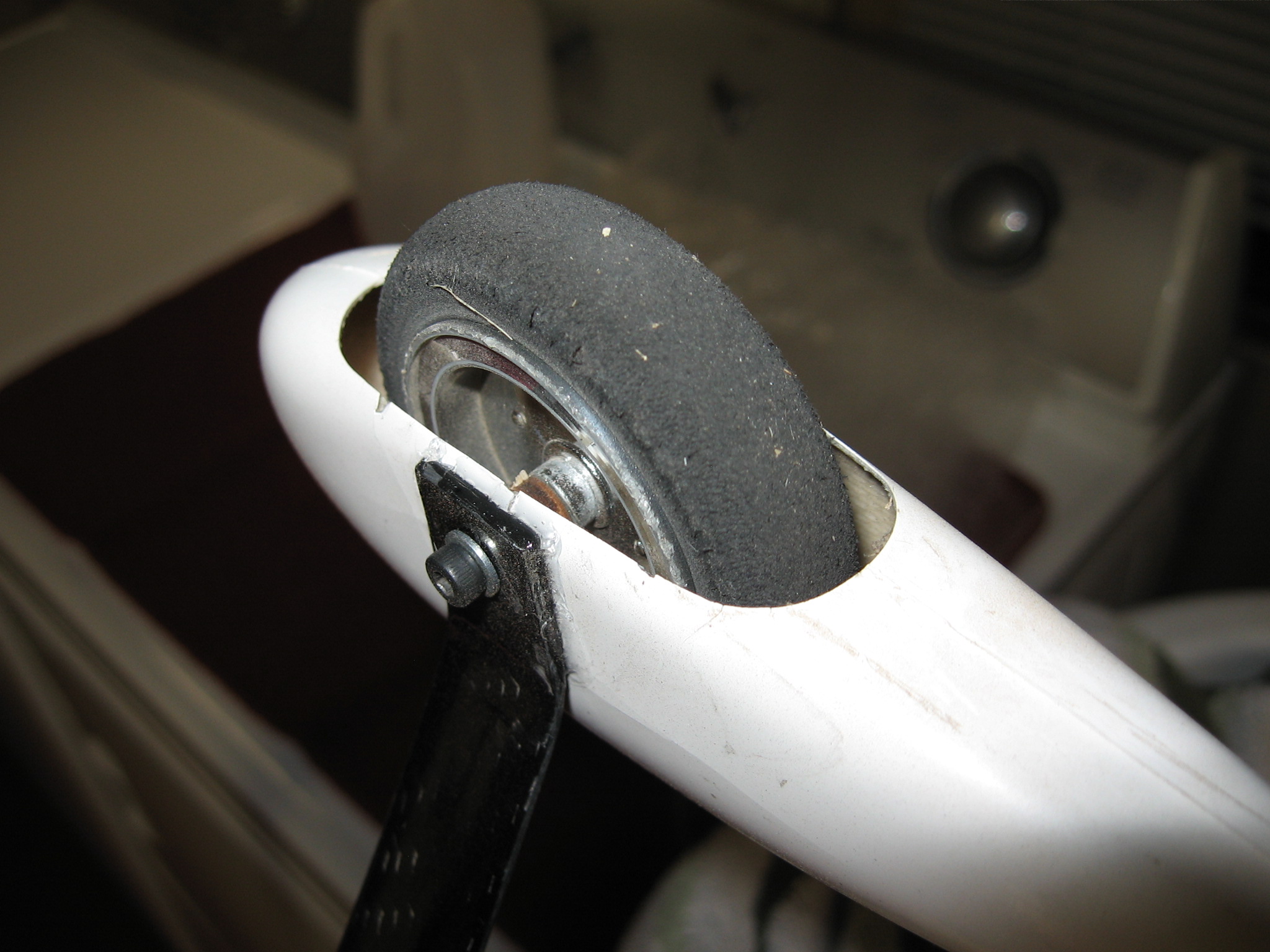

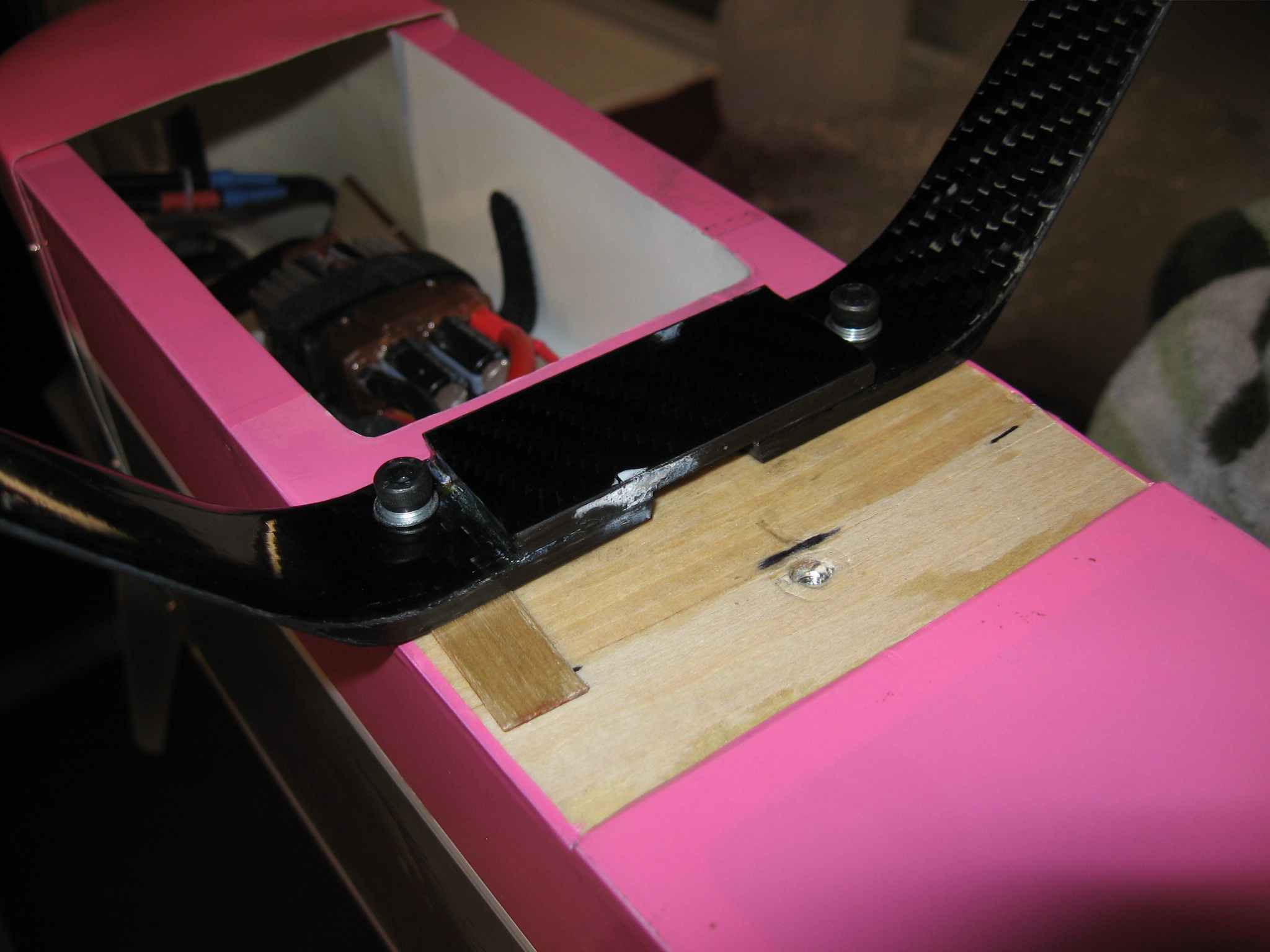

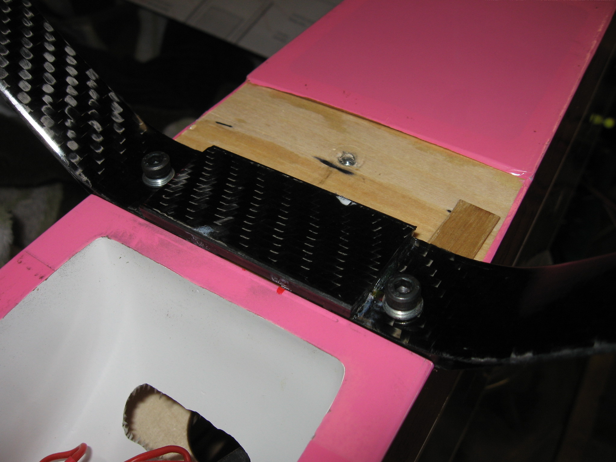

here's the link to the gear I bought for the ML 70 off ebay. They shipped pretty fast, I think about 10 days, maybe little less.http://www.ebay.com/itm/151098185636...84.m1439.l2649
The part attaching at the fuse is too wide, of course. So, what I did was cut the "top" such that I left about 30mm of "tab" for each leg, and that left a section of CF that I could glue to span the two legs after installed.
All I did was drill mounting holes in each leg-top where the original mounting holes are located, and used the screws provided from the kit. After those were mounted, tight and flat, I roughened up the outer surface where the spanner-doubler would glue in place, did the same to the doubler. Removed both legs, glued and clamped, then reinstalled.
Drilled holes for the screws/axles, mounted pants and wheels, and done.
Not half bad, and survived three landings of mine already!
Pics attached.
Pics attached.
