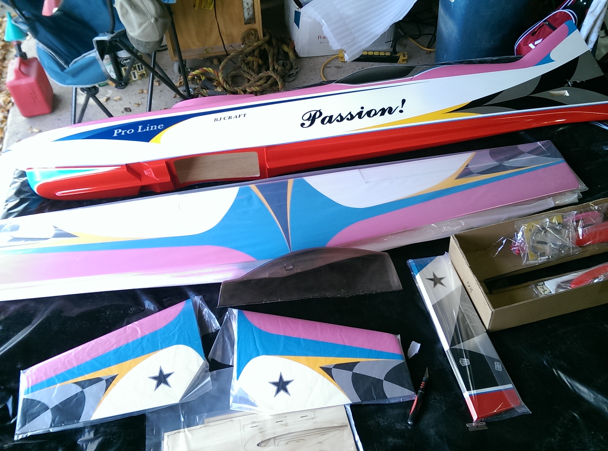

As a long time fan of Akiba's designs, I have been talking to Mike about this plane since the US Nats. It has finally arrived and I am very excited to get my hands on one of the first ones Mike has brought in. Yes, it is true..Mark Hunt has purchased a 2 meter arf. Anyway, so far I have only unboxed and drooled over the dry fitted assembly. Dry weight included the ply parts pack is 5lbs 4oz...2385g. Equipment planned is a Neu, CC esc, and futaba servos. There are no instructions so I will be starting on the easy stuff first. Initial impressions of the parts finish and dry fit are very good.

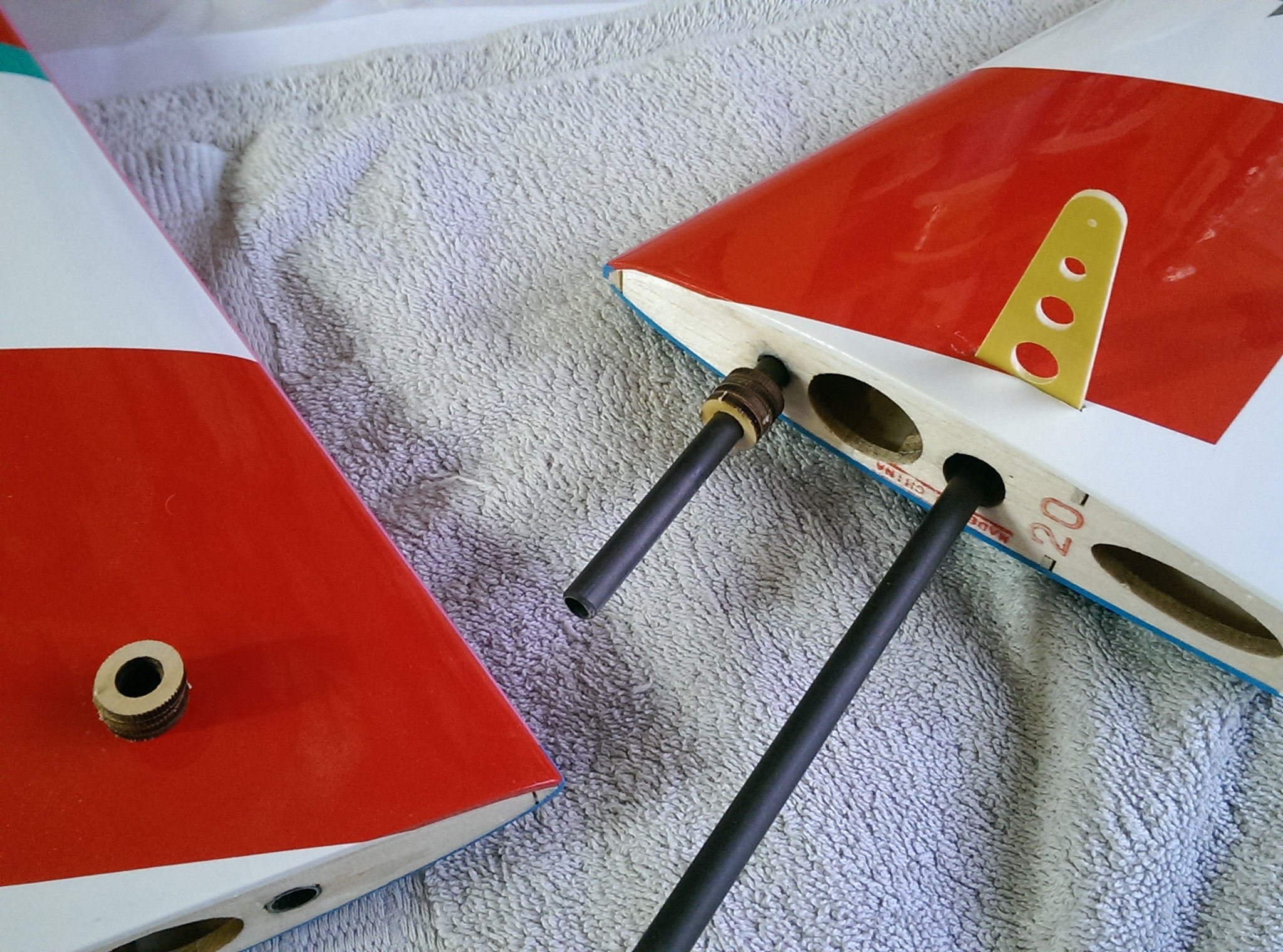

Last night I was able to work on getting the aileron servos fitted. A minor adjustment to the length of each servo box was required...I guess BJ is a JR fan. Although I could not make any ID of a horn slot for the G10 type horns I was able to conclude that the ailerons are quite strong and certainly solid in the area where a hardpoint is required. I fell back on my old faithful carbon rod control horns which have never failed me in the past. I used a simple jig to make sure my clevis pivot would be centered directly over the hinge line.
I was able to then look at how square and true the bottom wing to fuselage was. Seems very square to the tailpost, and a measure from the tailpost to each wingtip was pleasantly dead on. The bottom wing rtf weighs in at a scant 16.9oz. The top wing with servos, rtf weighs 17.4oz.

If this is like all of BJ's other planes, there is likely a Laser CNC cut jig that you use to locate where to cut the slots for the G10 horns. It is probably in the bag with the other laser cut plywood parts. He probably has a jig for ailerons and a separate one for the rudder and also elevator. The elevator jig likely has a hole which fits over the forward tube in the stab and helps locate the slot for the horn. That one is important to find and use. Check the BiSide thread, I'd bet that this one is very similar in construction method and fixtures.

This morning I did find a laser cut ply piece that appeared to be the aileron horn jig but when placed even with the root end of the aileron the slot is a inch or so too far to the inboard side of the where the horn should be. I was able to easily find the slot in the left stab for the large control horn. I have not found any indication of where a rudder hardpoint might be located. I will try using what I thought was the aileron jig....that may locate the rudder horn? The ply parts included a rudder servo tray that fits perfectly in the forward (bottom wing area) area of the fuselage. Pull-pull cables are included as well.
I would like to know for sure at some point what is the Akiba recommended incidences, thrust and CG.

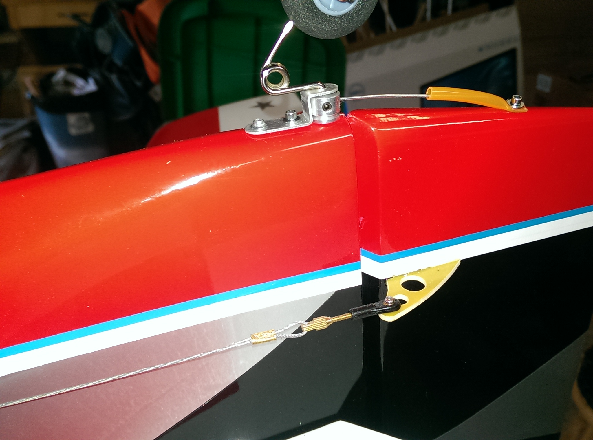

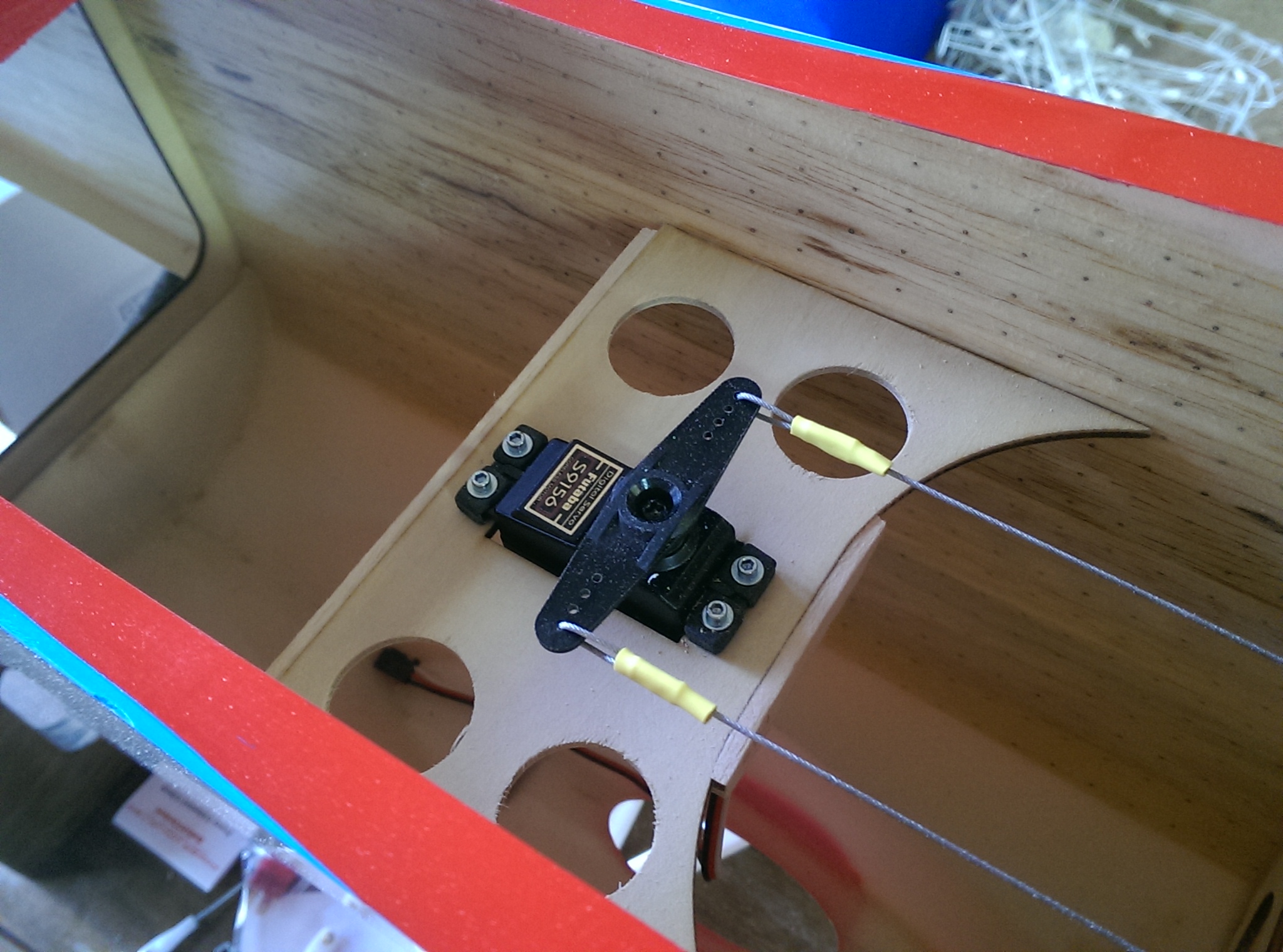

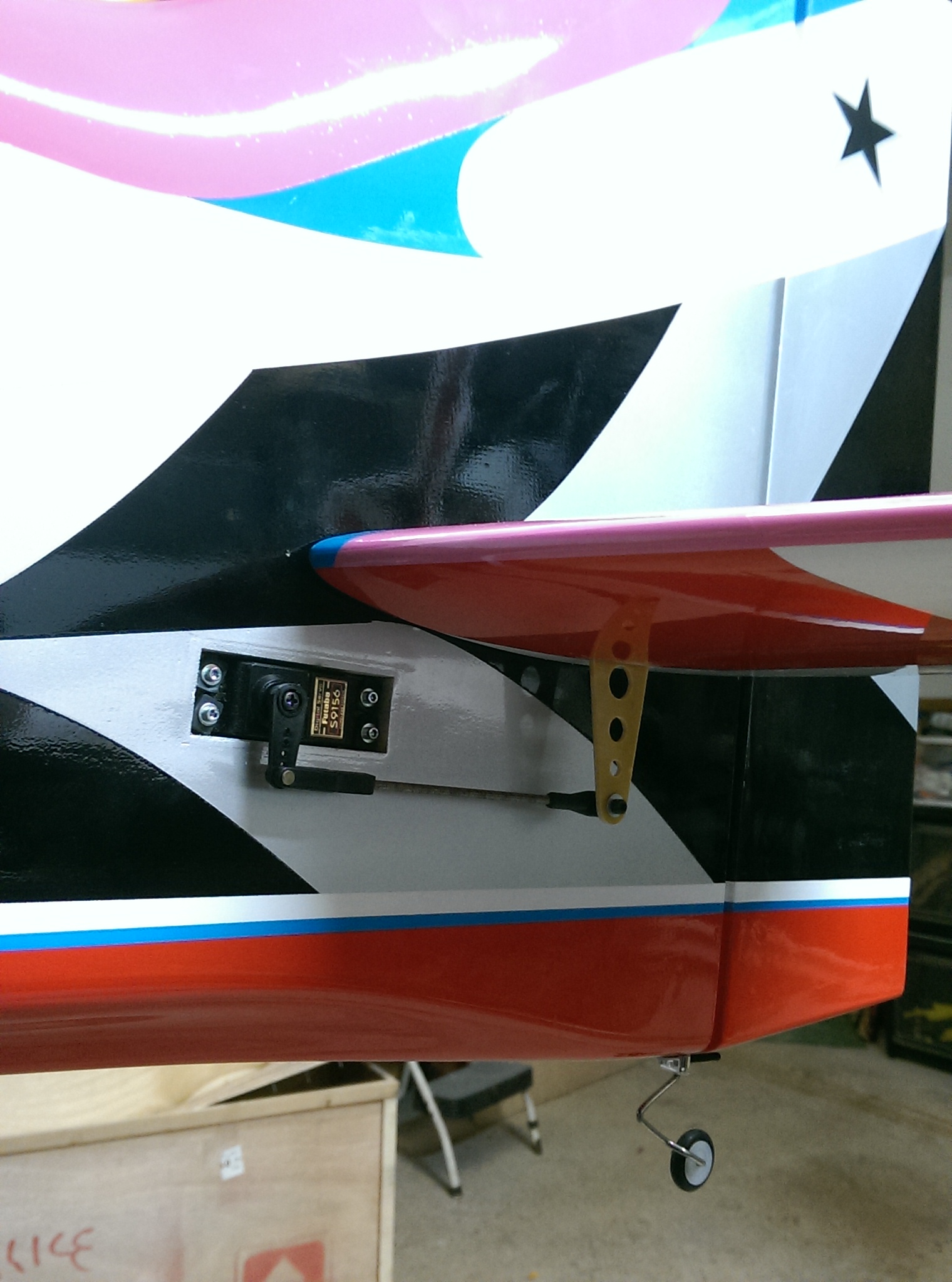

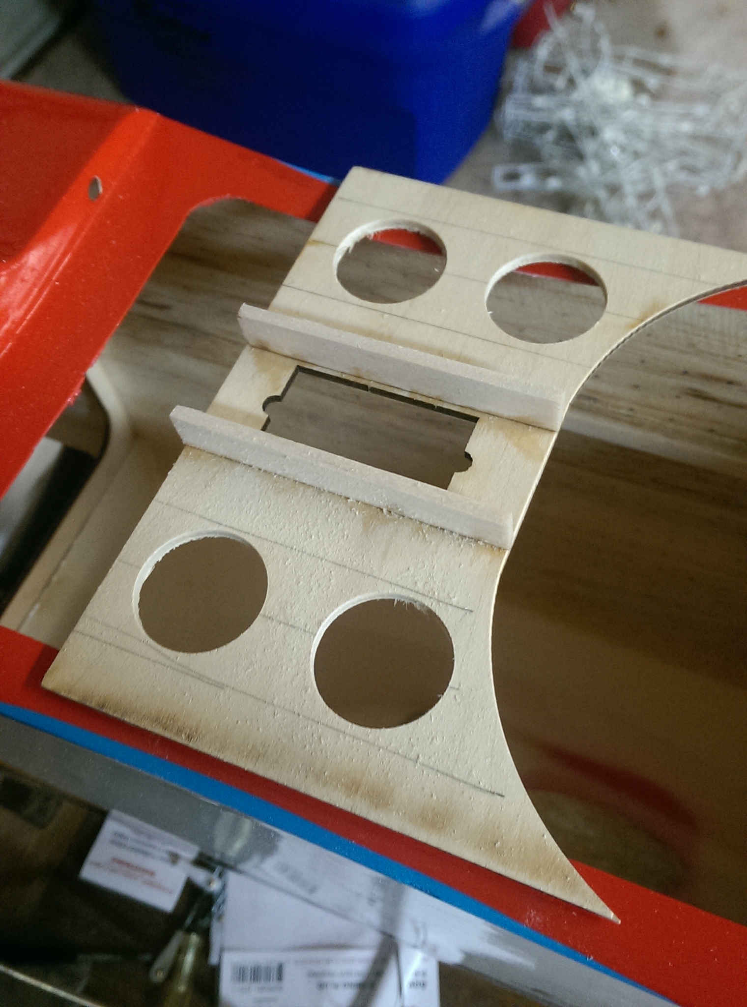

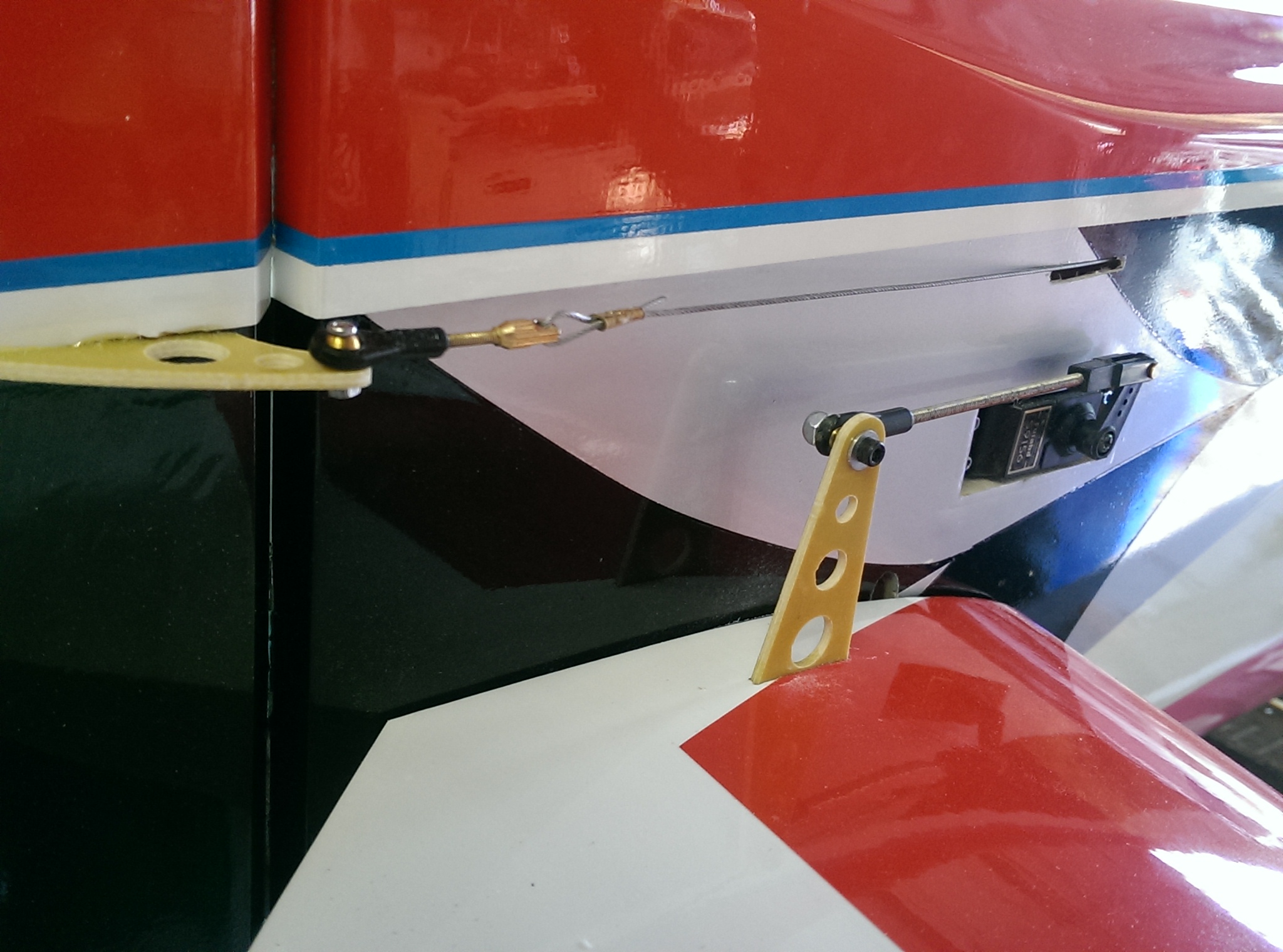

The kit included a rudder servo tray and it seemed to dry fit centered in the fuse above the bottom wing saddle. I glued balsa rails into the fuse sides so setting the tray would be easier and stronger. After careful inspection I could see that the bottom 2"ish of the LE on the rudder was made of a large piece of solid balsa. I laid out a piece of string (low tech I know) and decided where I would like the horn. Using dividers I marked the position of the cable exits. I used the included cable (looped at the servo arm) and ball link ends (at the rudder horn) to finish up the linkage.
I reinforced the rudder tray with some hard balsa planks along each side of the servo cutout and across the front and rear face/edge. I also cut a couple lightening holes on either side of the servo. On one side I also cut slots for a narrow Velcro strap (Rx).
I also installed an F3AU tailwheel while working on the rudder setup.
