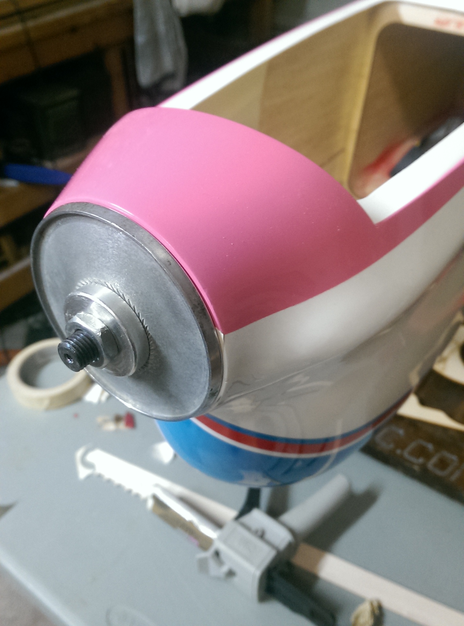

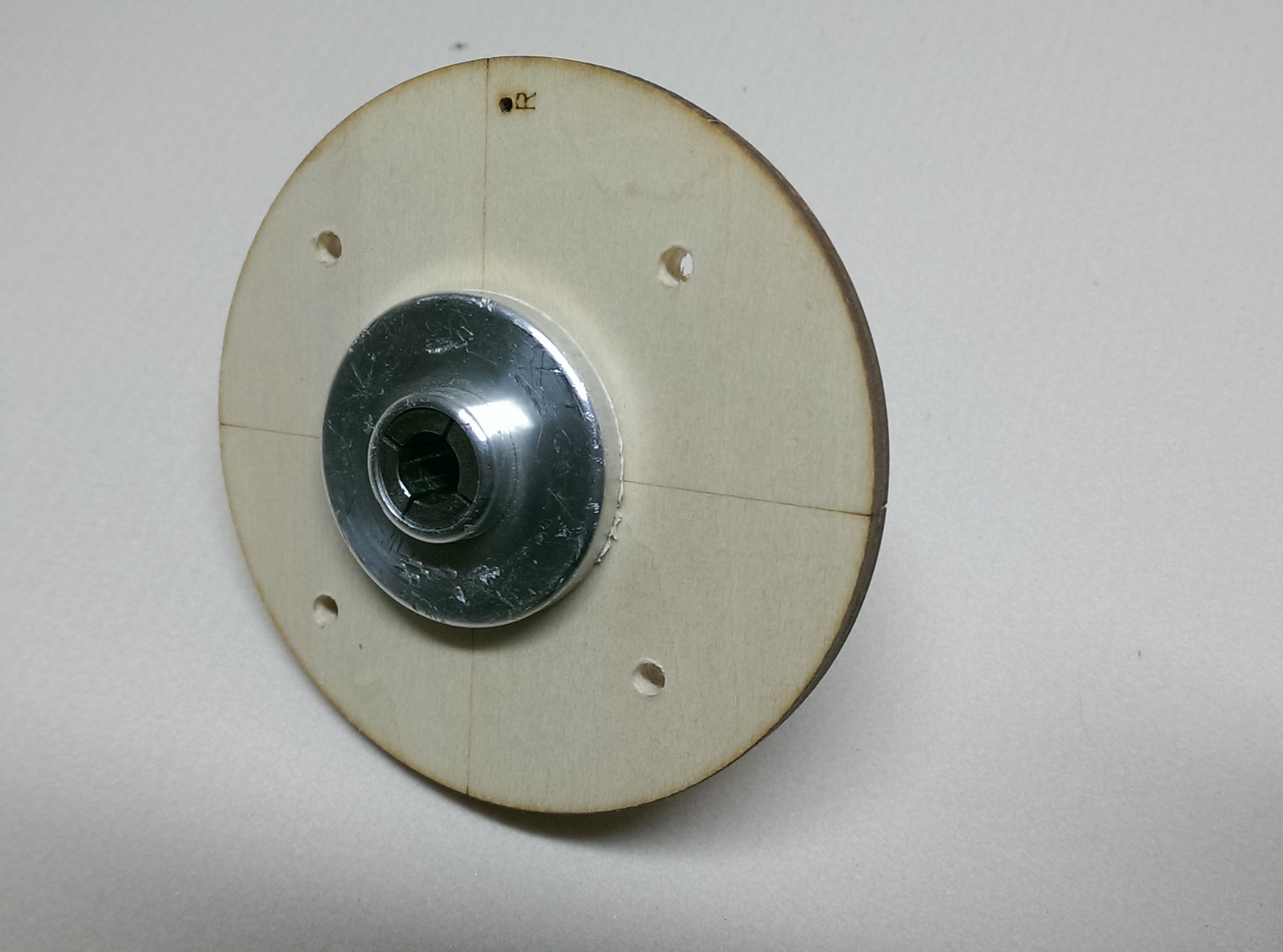

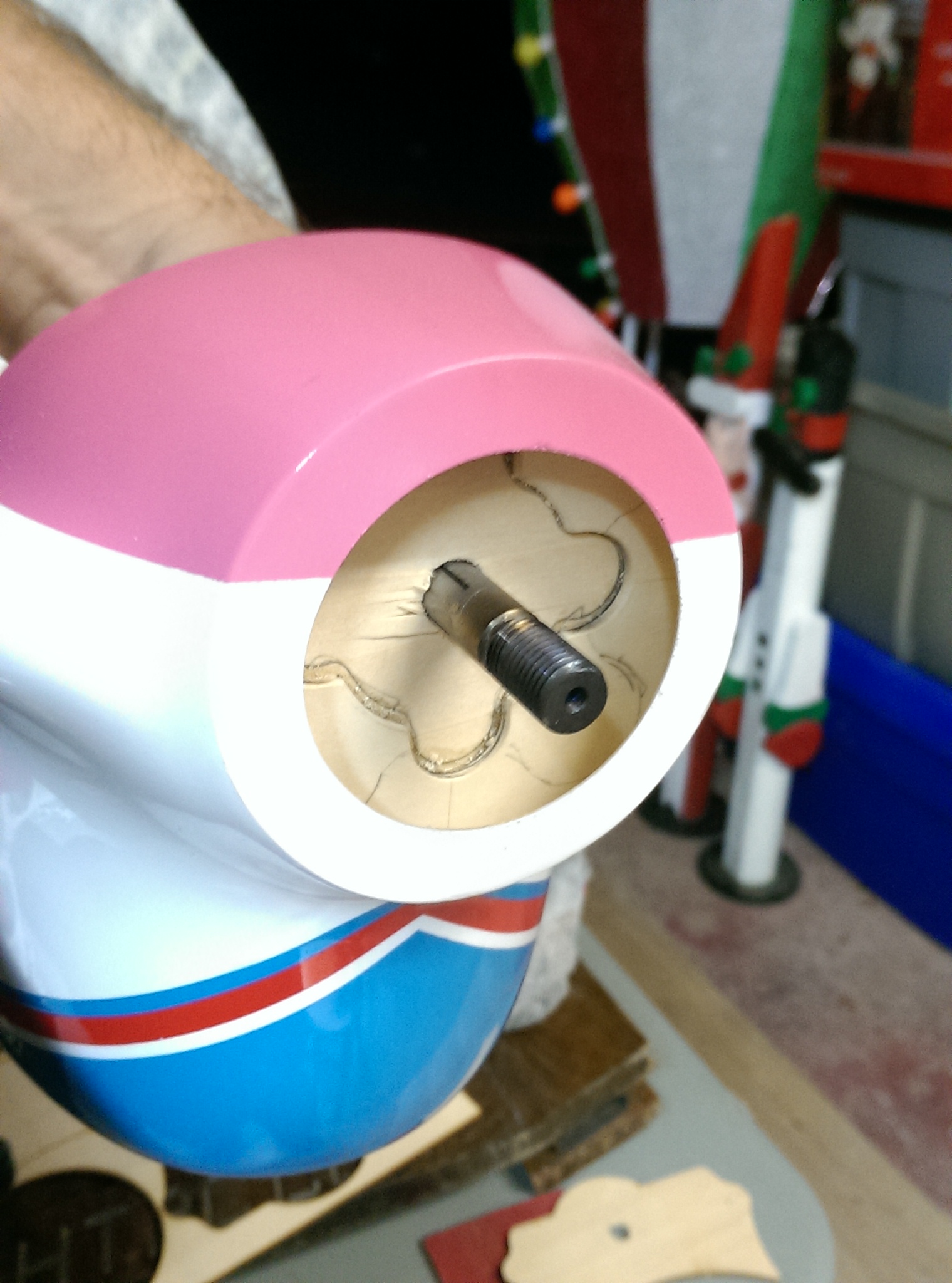

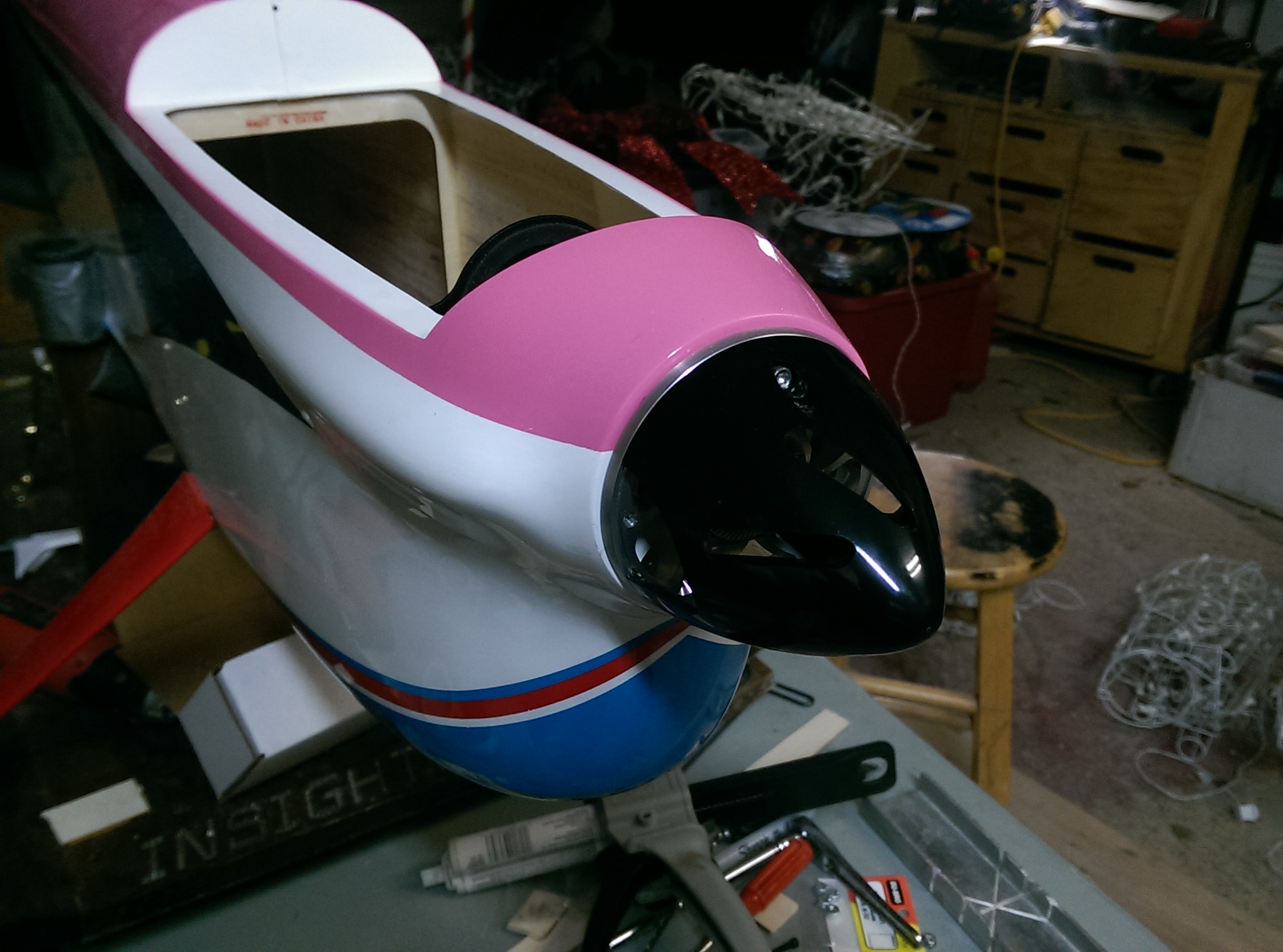

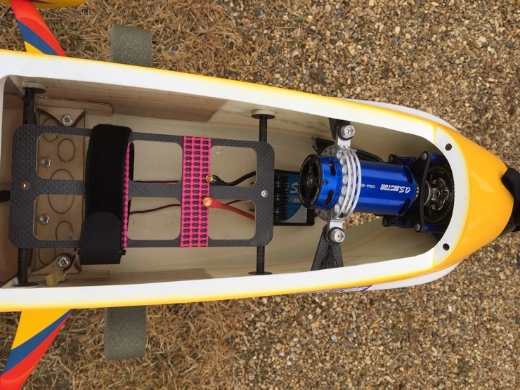

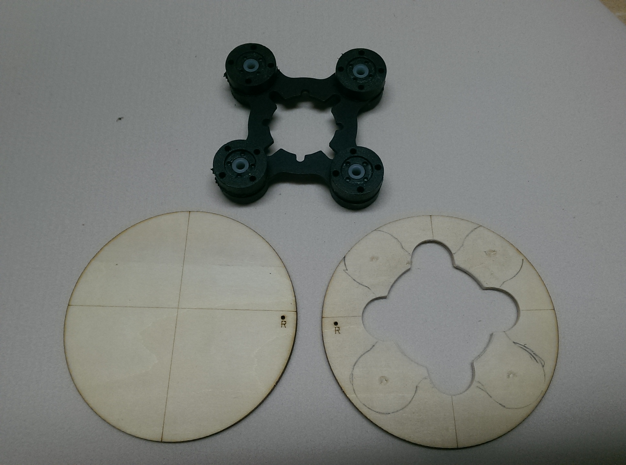

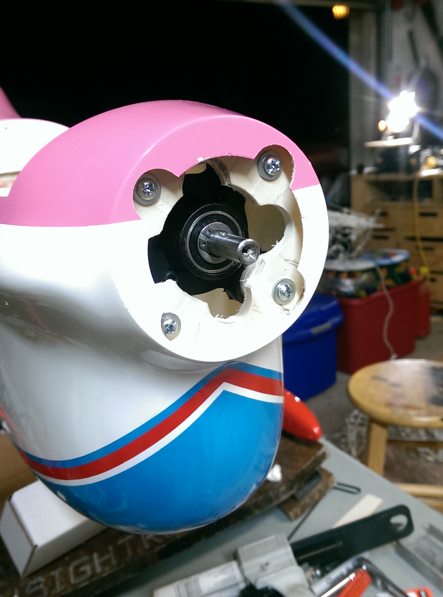

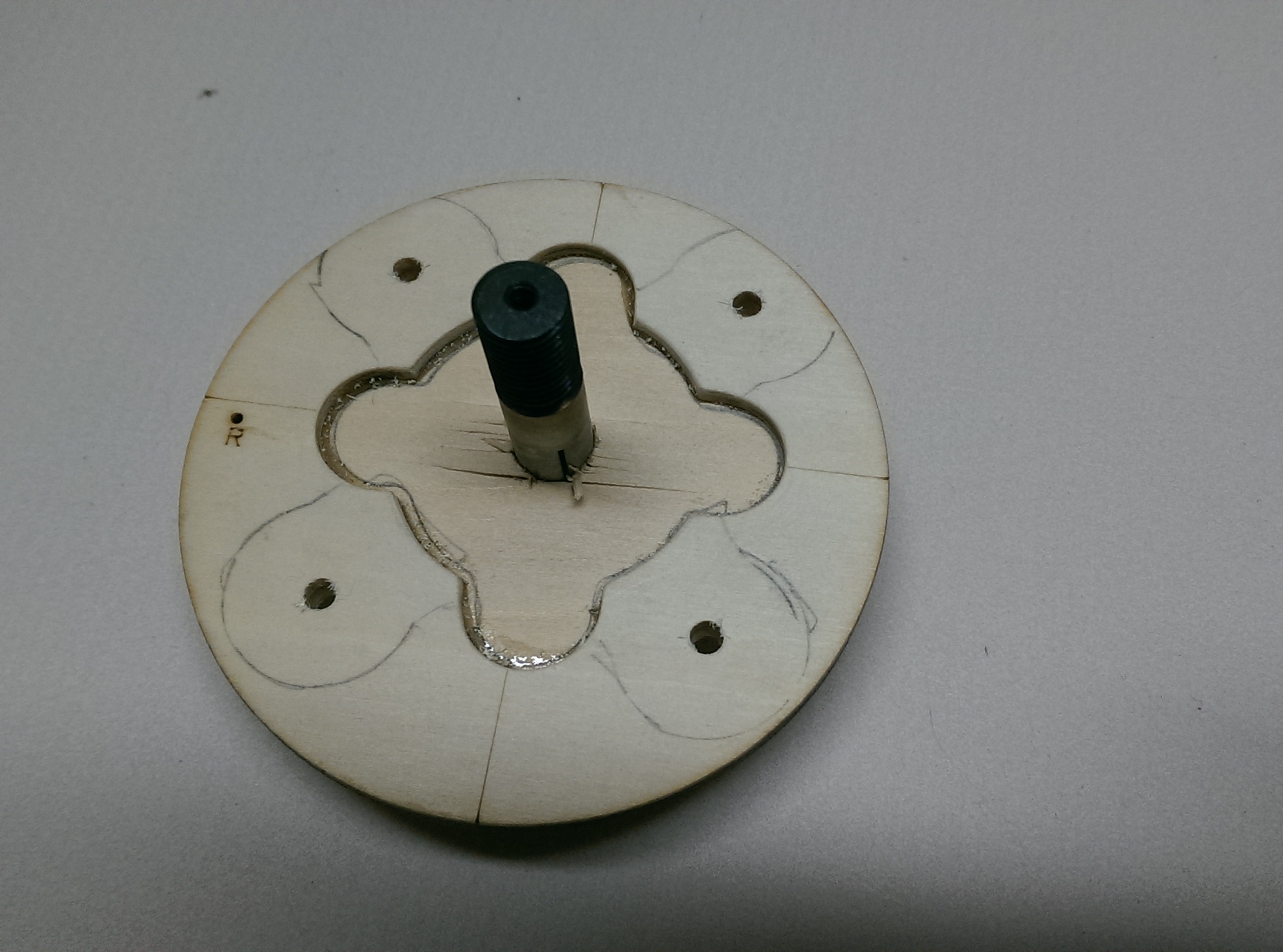

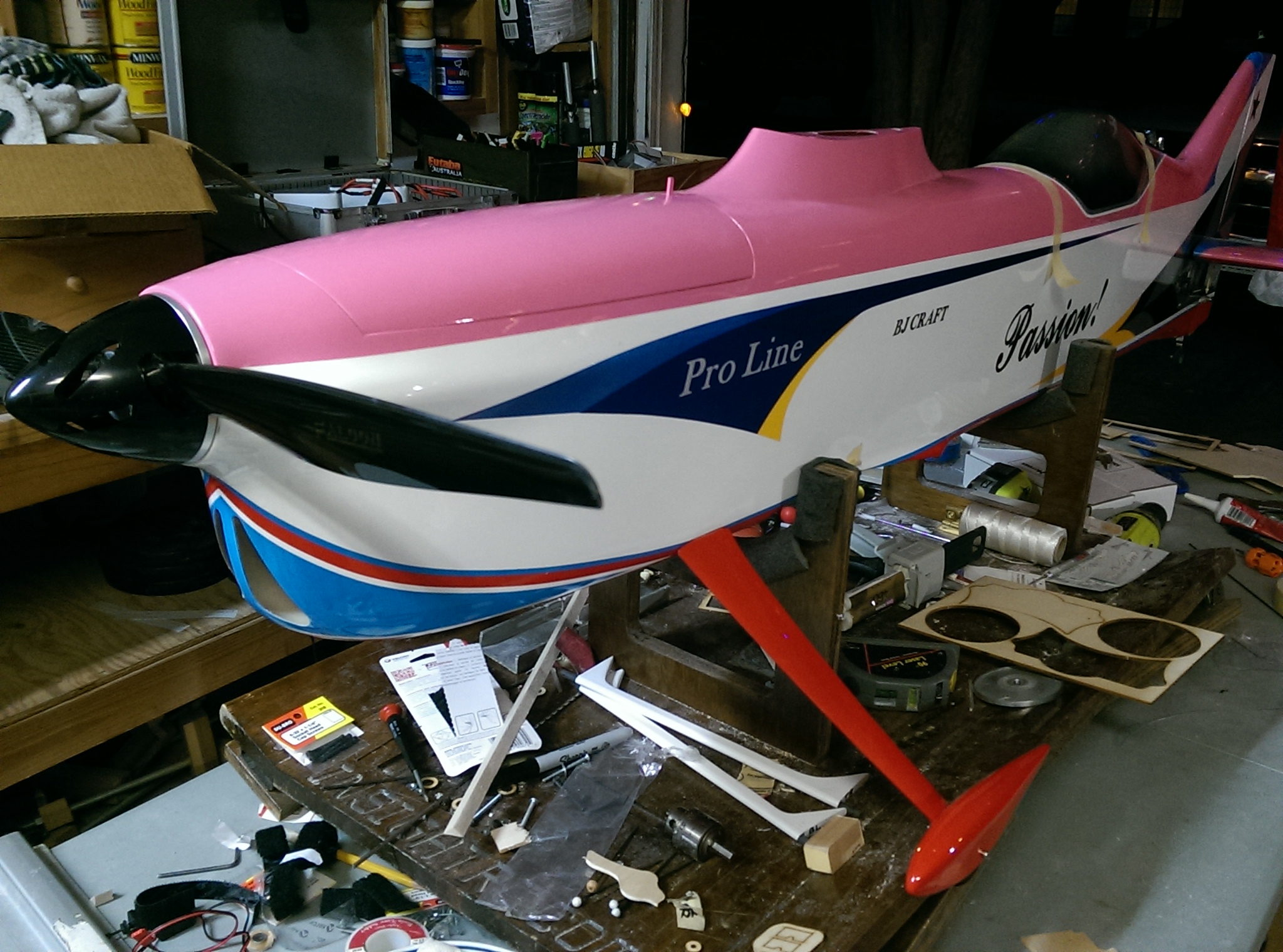

With the rudder tray mounted up I moved on to mounting the Neu motor and esc. I must thank my good friend Richard for his help in figuring out the best way to get the job done. The kit included two round discs that appear to fit back to back and are marked with a centerline offset for thrust. We decided to cut and fit the front facing disc roughly to handle the budd mount. We glued the two discs together and drilled a hole through the blank disc (centered) for the Neu prop shaft. We put the shaft and prop washer through and used an old spinner backplate to draw it up snug inside the nose. This was not going to necessarily keep the front firewall parallel to the nose so we assembled a set of ply washers to go between the back of the spinner backplate and the firewall face. The height of the stack of washers was just enough to let the firewall touch the inside of the nose but not wedge. This took plenty of sanding on the laminated discs to get the fit just right. The spinner backplate/shaft/firewall was taped to the nose so I would not move and from the rear of the firewall I applied hysol epoxy around the firewall disc. I let it cure and the next morning applied another small bead of hysol, this time around the front edge of the firewall. The rear disc was then dremeled out to match the front facing disc. I still needed 3/8" thick spacers to get the Neu to the right distance from the nose face....clear as mud right?..
Anyway, I'm quite happy with the final results. With the motor front mounted I fitted the rear supports and glued those in. BTW, the screws in the front pic were temporary...didn't have the 6-32 SHCS in the length I needed.

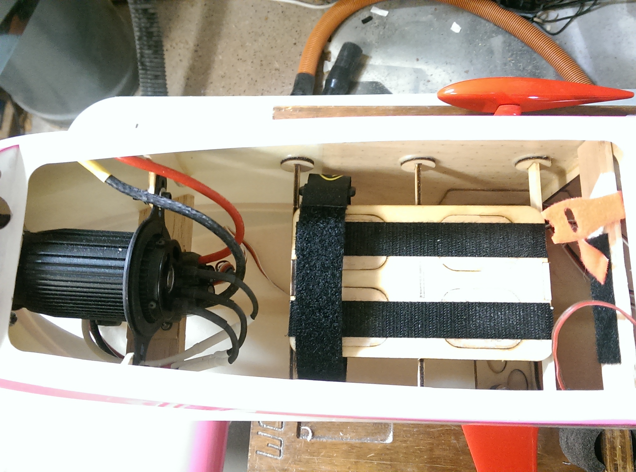

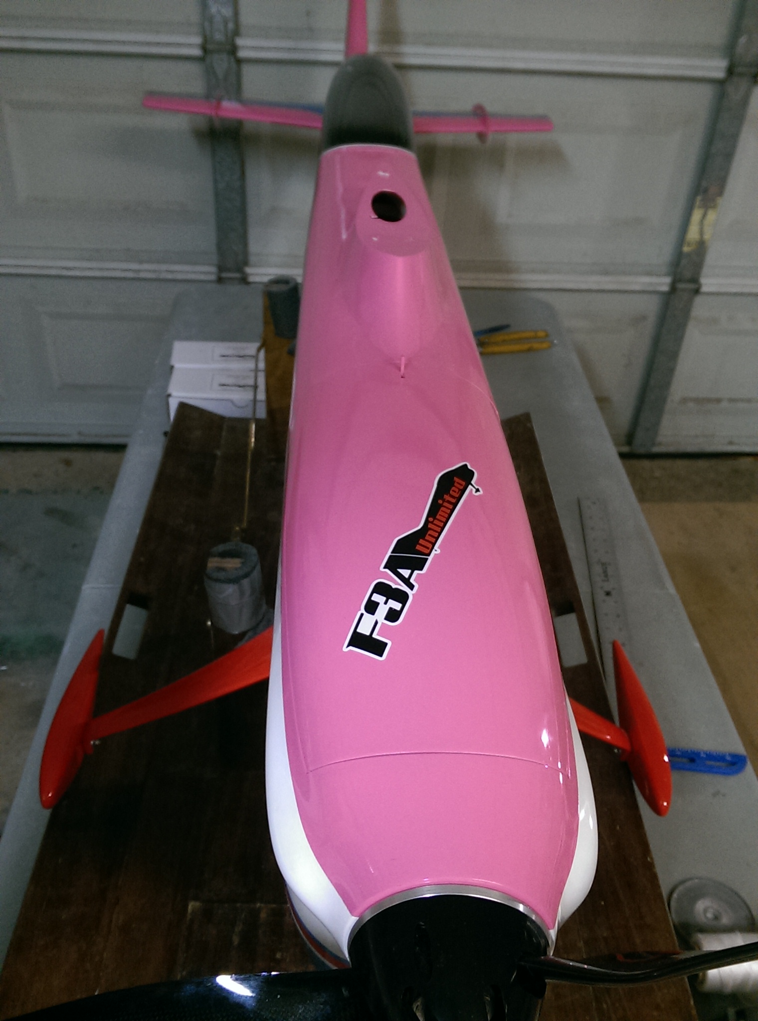

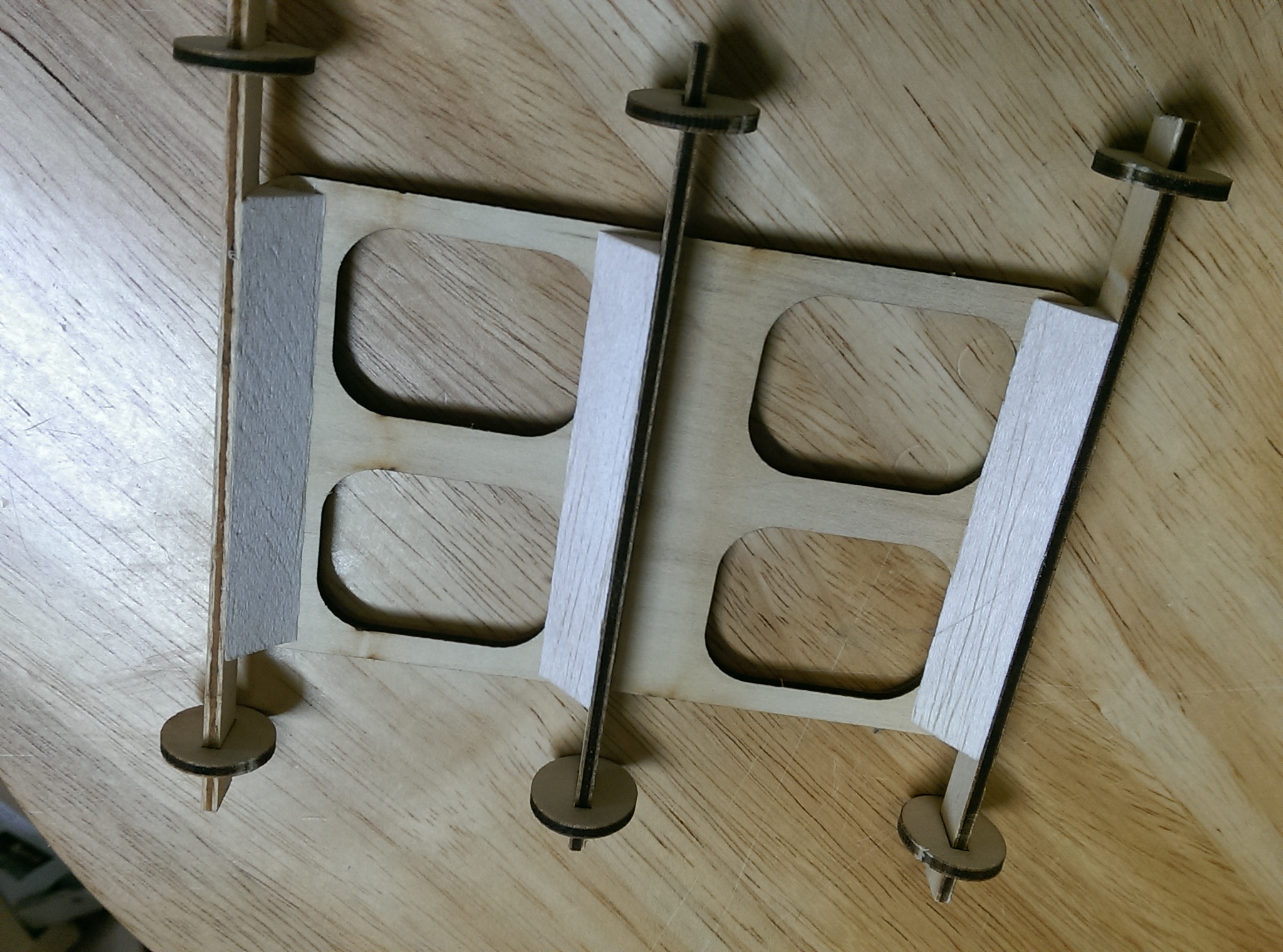

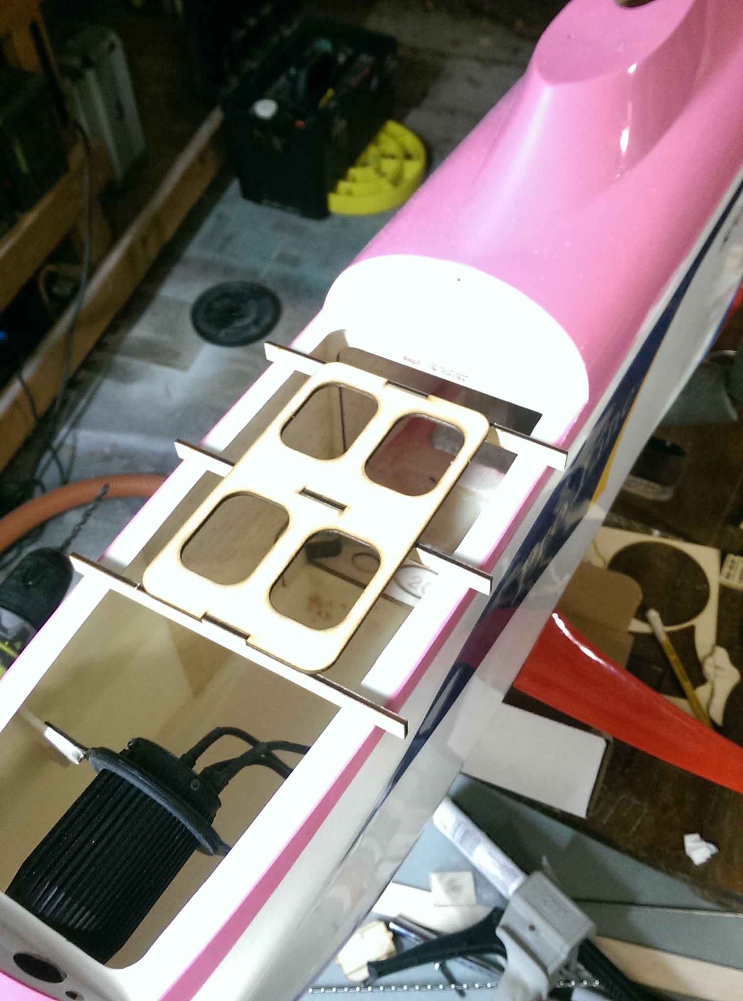

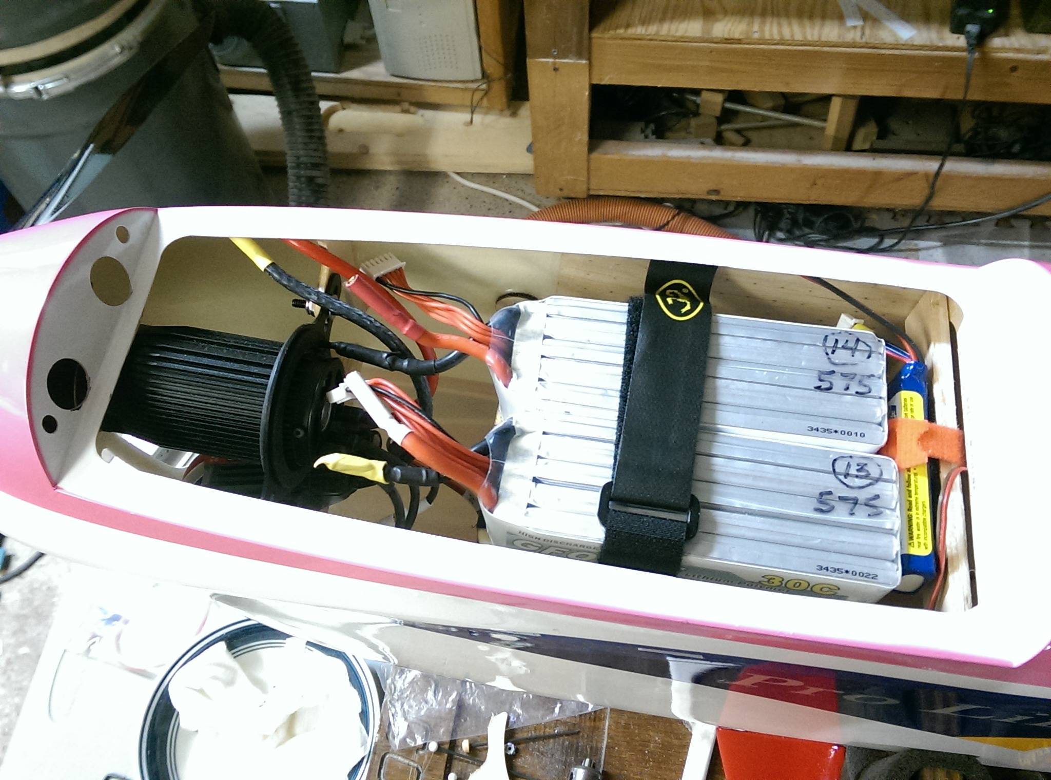

Time for the battery tray. The laser parts included in the make a simple tray. I fitted the crossbraces to inside width of the fuse right behind the motor. I added some hard balsa triangle stock and tack glued the tray inside the fuse. I set the tray height basically even with the height of the motor. I secured the tray and support donuts with Hysol. The HV80 esc was mounted on a hard balsa and lite ply plate below the motor right behind the nose air inlets. I added a hard balsa plate across the back of the battery access area and mounted a Rx battery here. This may change but I really wanted access to it for the first flights. In the end I needed to fill the lightening holes in the battery tray to allow me to use full length Velcro strips on the tray..just my preference. I cut and fitted some hard balsa in these holes and used a little sanding block to get the surface smooth and flush. Everything is a rather tight fit so hopefully the CG will not need serious adjustment. I briefly picked up the loaded fuselage and thankfully the balance point is about a third back on the bottom wing saddle. That should be close enough to adjust with minimal equipment movement and/or added weight. As you can in the last pic, I added the included stab fences with some silicone glue. The included fence fixture worked very nicely. The kit includes a clear canopy that can be fitted as seen in another thread here on rcu. I'm not sure what I want to do exactly with the canopy so I used silicone glue to secure the stock fiberglass one for now until I decide later.
#28

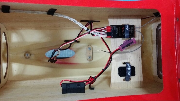

I mounted the Rx under the rudder tray and set up the radio stuff. With a falcon prop and no batteries the assemble plane weighs in at 3726g. I have 1150g batteries as well as 1200g (5100mah) batteries to use. Very good in my opinion.
If the weather breaks later today I hope to give it a go. I'll get some assembled pics in good light as well.

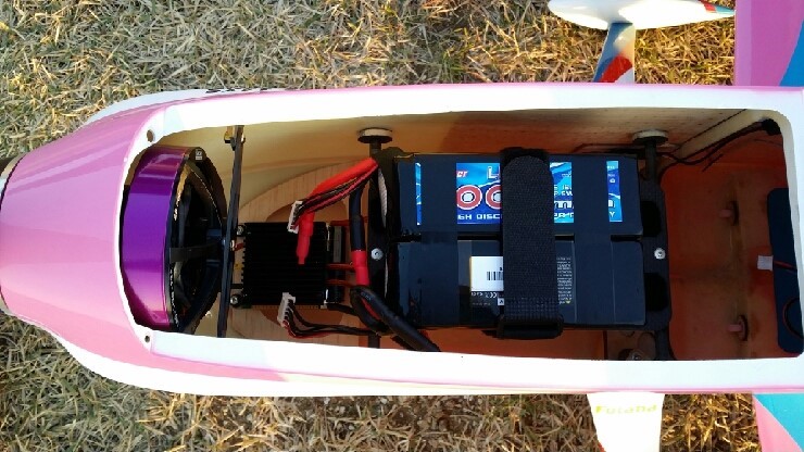

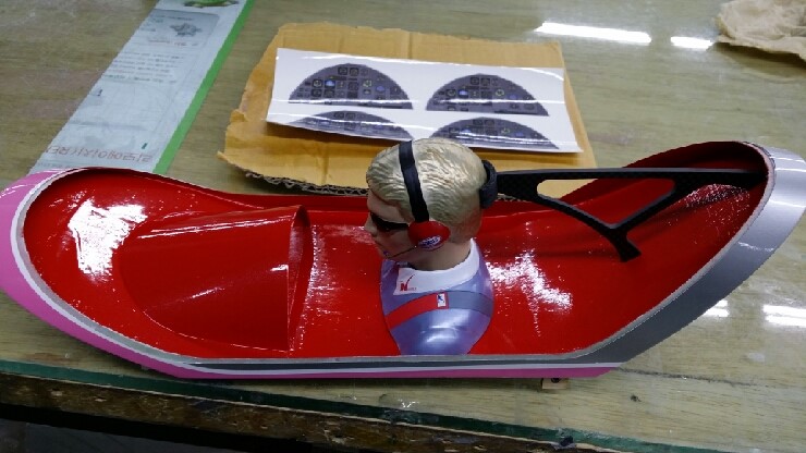

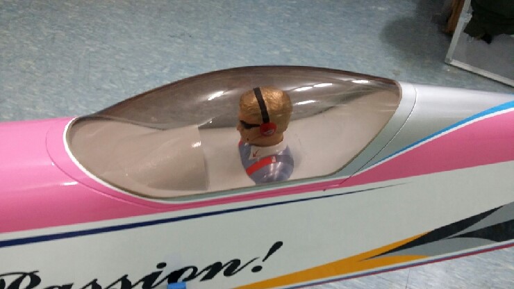

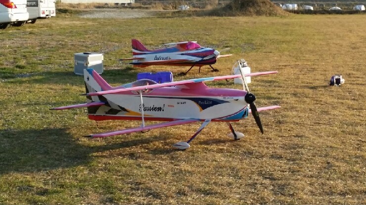

a friend of mine in Korea, newly got a BJ CRAFT PASSION this month and did a successful maiden flight.
Maybe he is the first flyer for PASSION in Korea, he said a great plane. He just did a maiden flight with some maneuvers only. so I couldn't get details report
but, he said the general performance is better then his previous Axiom. I post some pictures here.

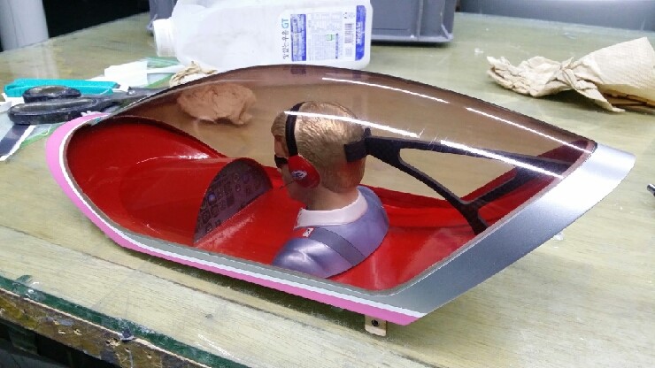

The transparent canopy comes with the plane together but had to cut out and add some his additional job.
Elec. motor: Hacker Q80 14XS, The other one is OS motor
ESC: Master spin pro 95A
Transmiter: Futaba 18MZ both
Weight: 4,880g with battery (battery only 1,260g)

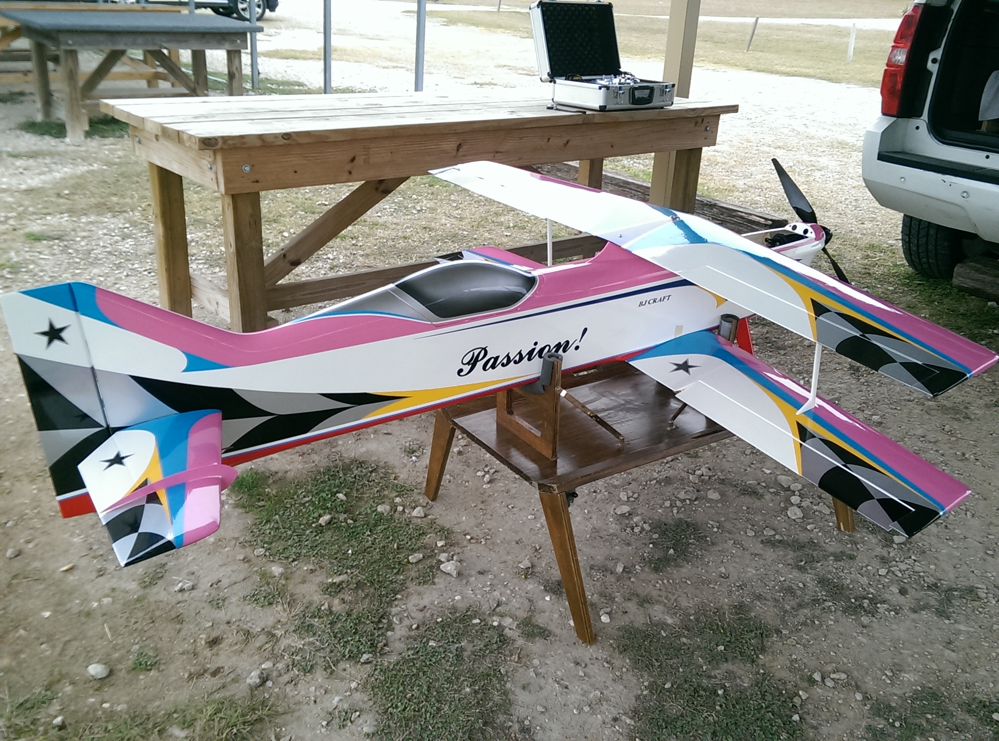

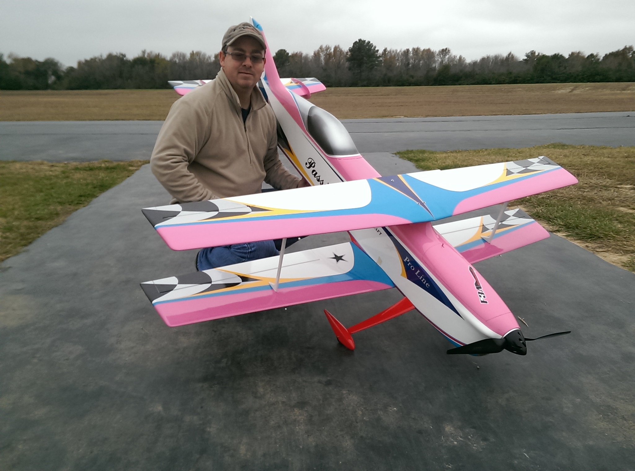

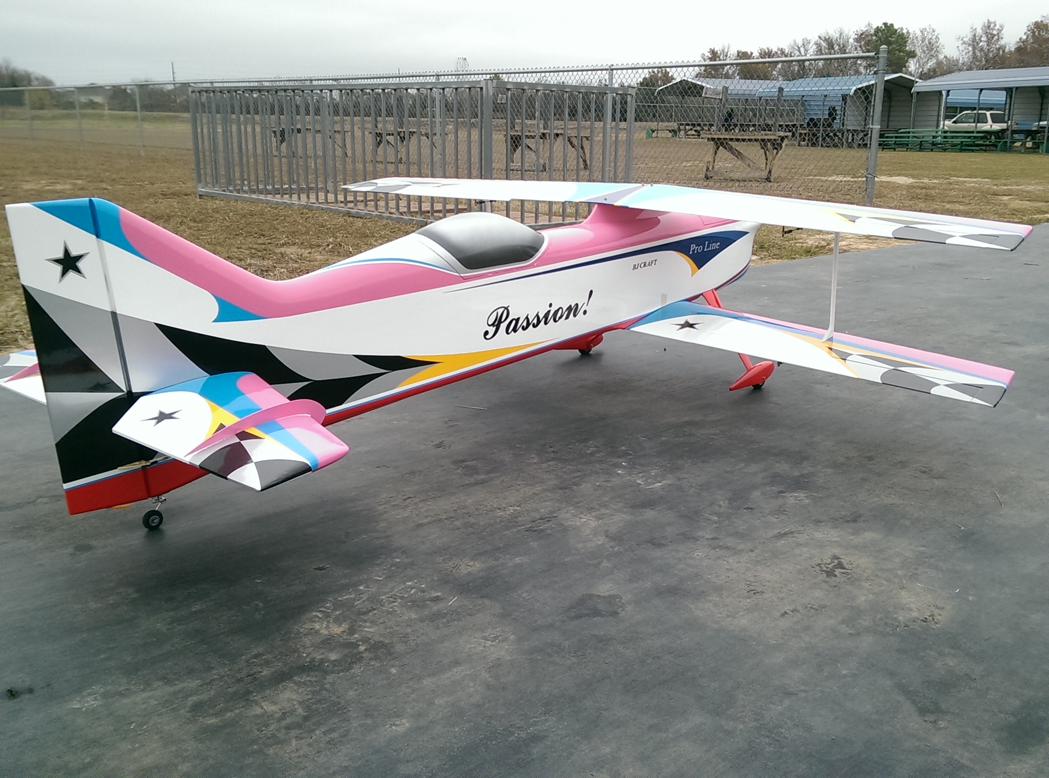

Despite the overcast weather, I got 4 flights on the new Passion today. I must say I'm quite impressed. I had a 21x13.5 falcon on hand so that is what I tested with and this plane is surprisingly fast...but this prop may be a touch more pitch than is needed. The CG is very close as the plane shows a very slight pull tendency in downlines. 1% down with idle took care of that. A 45° power-on upline, rolled to inverted and the plane nearly held the line without dropping the nose. Again, I think the CG is very close and could perhaps go back very slightly..I will get a few more flights before trying a change. The motor could use a pinch more right thrust..but only a pinch. Snaps are excellent, spin entry and rotation seems just fine, stall turns are very controllable. KE there is zero roll couple and I mean dead zero. There is a very slight pitch to the canopy in both directions, but again, I'm wondering if moving the CG back very slightly will take care of that. I mixed only about 6% down with full rudder (nowhere near the KE rudder input and cruise speed) and it seemed to take care of it for the short term.
I'm impressed with the rudder power, roll stability throughout a KE loop and the energy with which the airframe carries out from a downline. Perhaps the frontal area (as it appears) is quite small and the drag and yaw/pitch stability created by the large tail/aft area contributes to how good this plane feels. I noted a similar aspect in Bryan Hebert's Allure. Akiba has hit a nice compromise on yaw/KE sportiness and straight line stability. Time will tell as more flights, fine tuning, and flights in front of my peers will allow me to report further. Surprising to me, several non-pattern guys at the field were excited about the looks of the airplane.
For having only 4 flights, I'm very pleased that I am only able to nit-pick at the little things listed above. Based on post flight voltage, my battery usage looks to be about 2900-3000 mah for the "P" pattern. In front of judges and at a little more distance I would expect more but not more than 3300mah. Again, time will tell. Maybe next time out I'll put it through some "F" patterns
Many thanks to Mike of F3AU for letting me get my hands on one of the first ones.
.Many thanks to Mike of F3AU for letting me get my hands on one of the first ones.

Hello
I asked them today, they said,
The Prop. Q80 one used Falcon 20.5-14.5 and The OS one used 21.5 - 14.5
Elevator servo, Q80 one used JR NP91MK2, The OS one used Futaba 9071SD.
I hope it's helpful to you.
Sungho

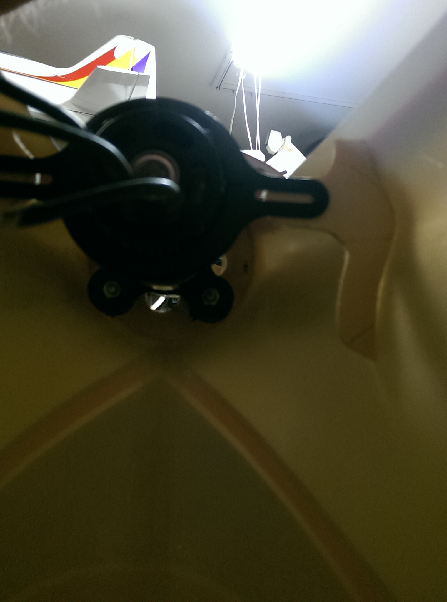

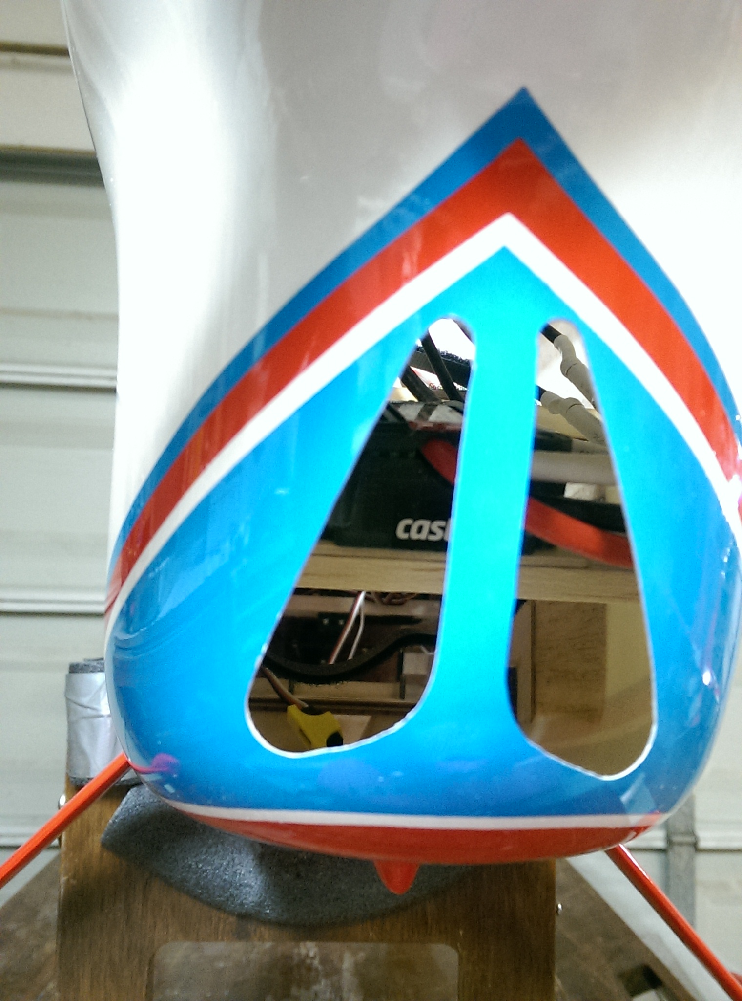

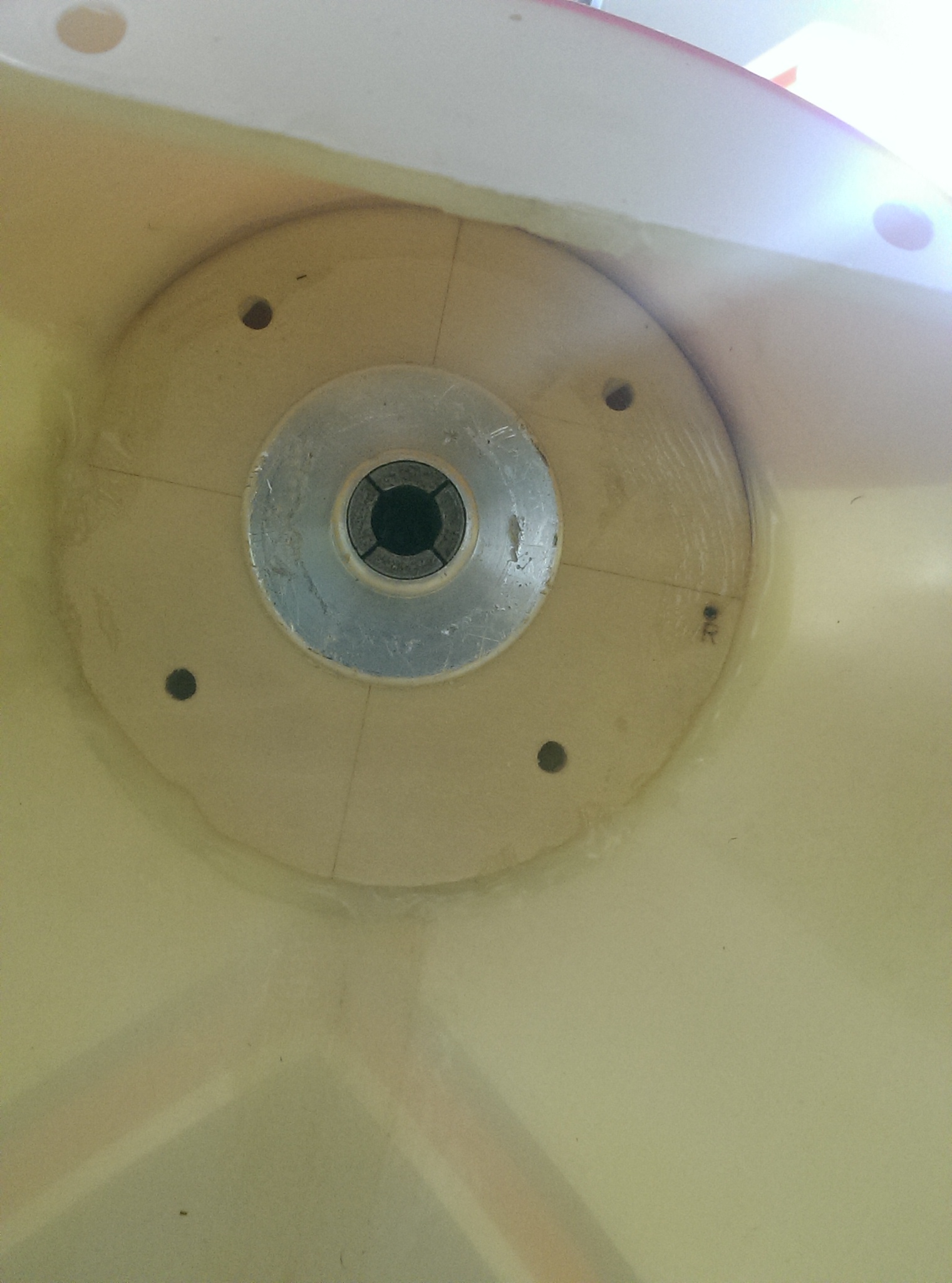

Can you tell me how many degrees right/down thrust you wound up with.
From the interior picture showing the back end of the motor, it looks like there was considerable right thrust built into the nose ring.

yes, there is a good amount of right thrust in the nose. I actually ended up adding a touch more as well. I also have a 1.5mm shim under the te of the bottom wing and under the le of the top wing. The shims seem to be common among passion owners in the far East. My cg is about 115mm back from le on the bottom wing. I'm not sure the shims would be needed if running a more aft cg. I am really pleased with how it tracks and Flys.
good luck,
Mark
