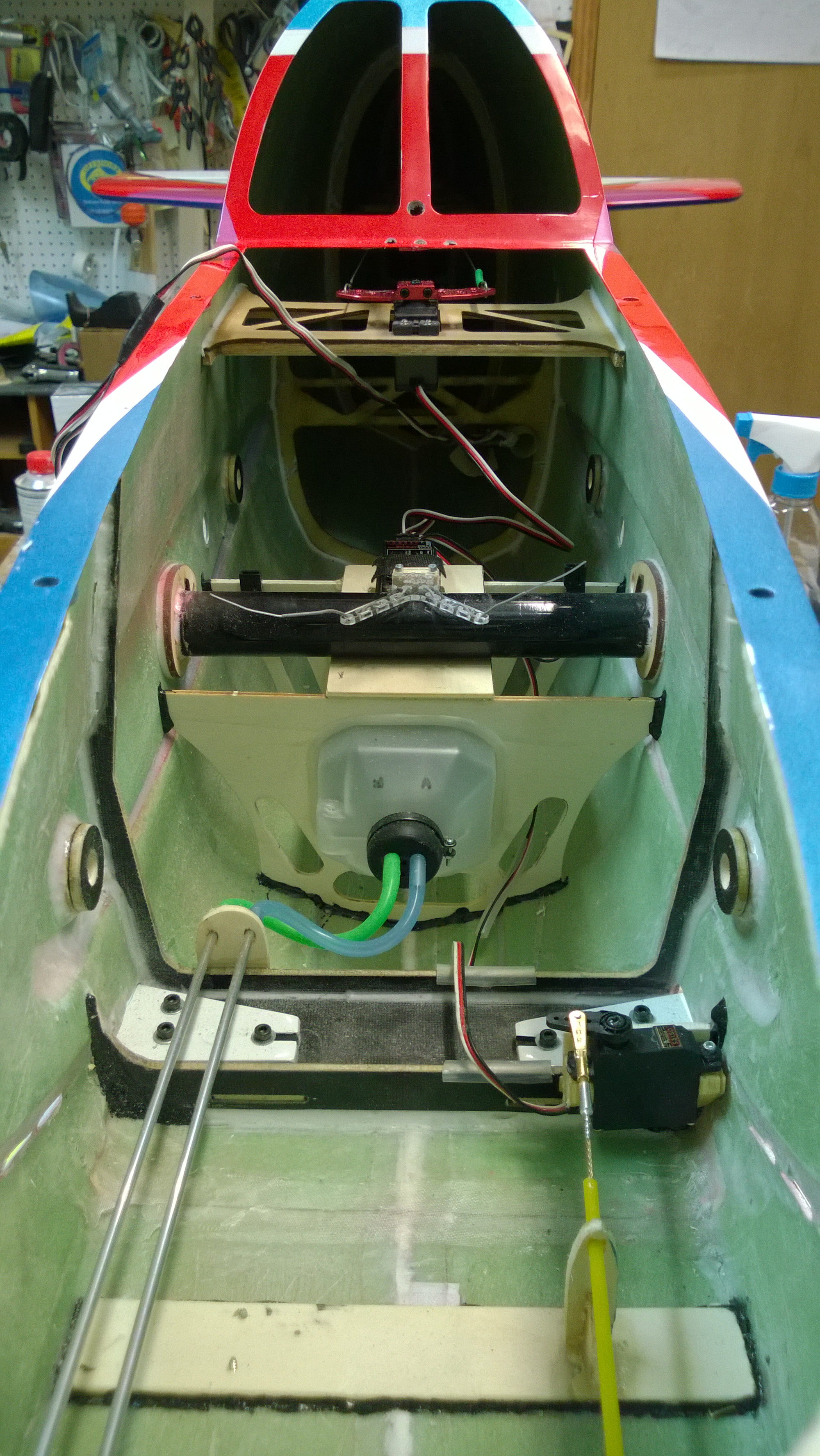

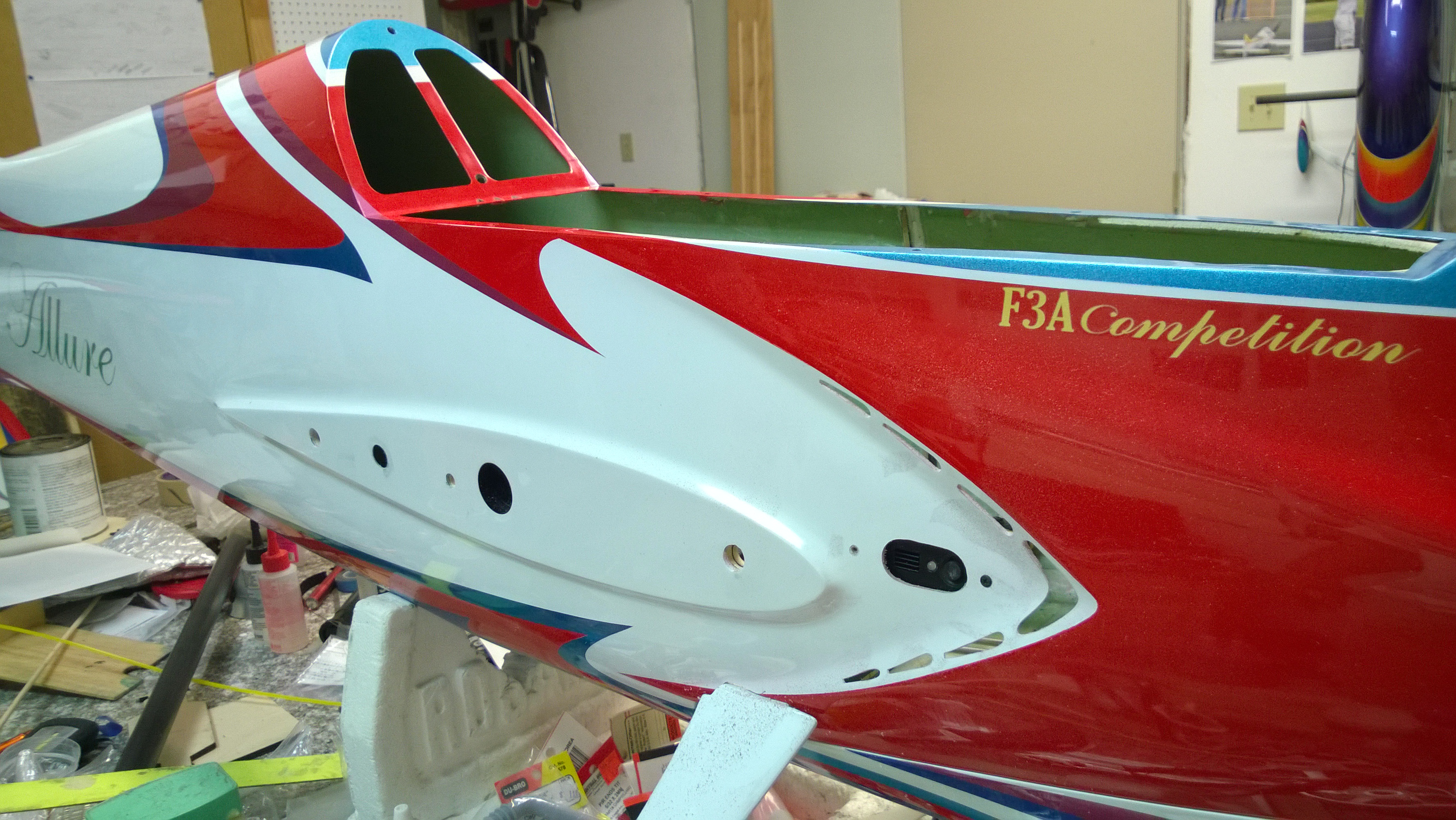

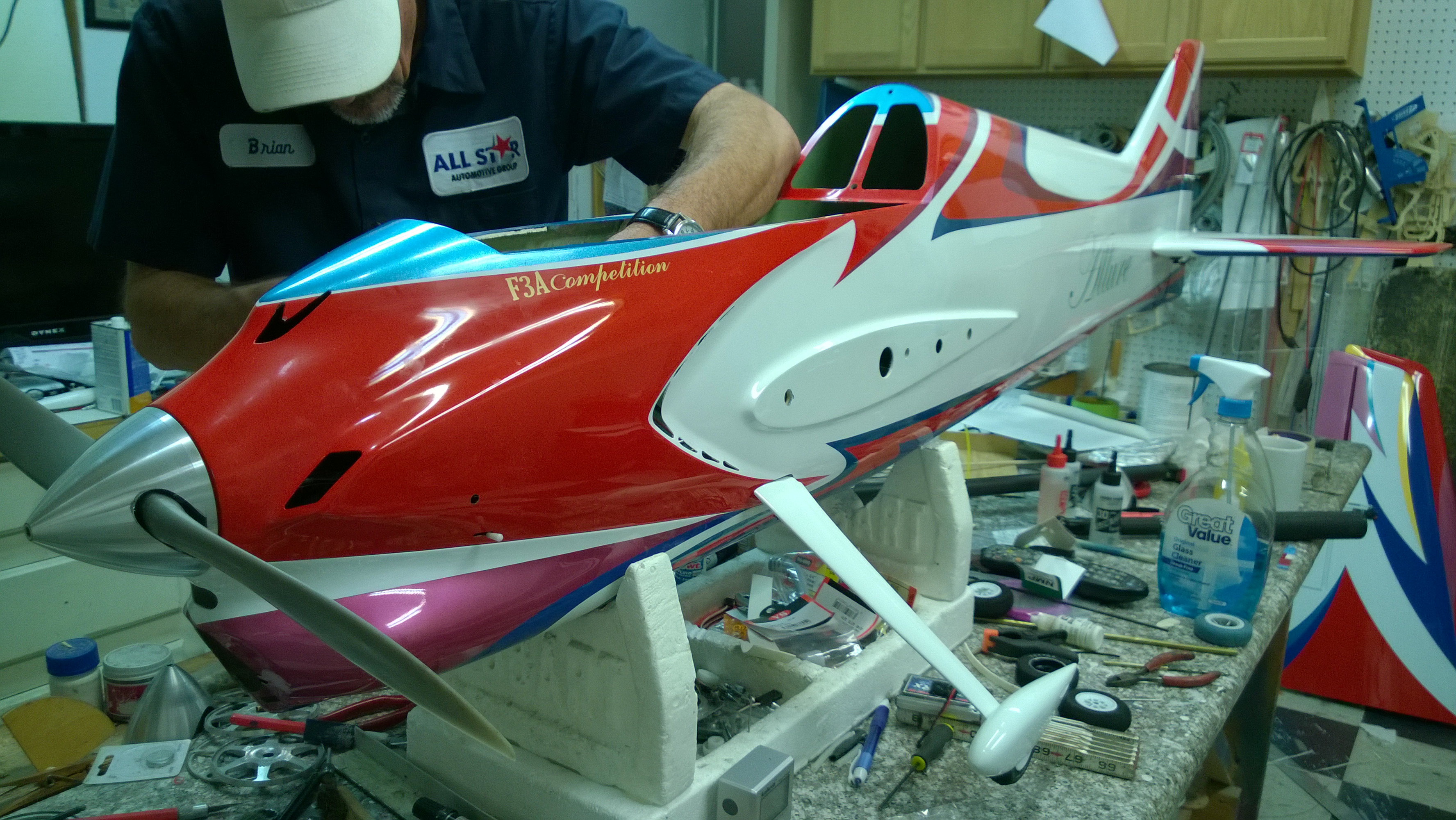

I will have both proto Allures E and Glow, at the Nat`s and will try to give as many test hops as we can , It`s a team trials year So I will be busy with Brett and my flight team. I have chose not to compete so I can be better equipped to help and discuss my new products. If you look me up , I will tell you what`s up with the plans for,production schedule, first order, weights, anything you want to know just look me up.
The airplane has a few changes that will be done in production, Colors Scheme, some aero changes, all minor it`s why we have the proto.
I will offer the Glow version chin removable, for Electric, the electric version chin removable, and two color scheme choices.
The Contra will have a molded in place chin for weight reduction and better gear placement. and some other minor changes all to make it better for the unit.
My new website will have details on a Introductory waiting list for the first batch with a 20% off price for a limited time. I will release details soon, You will get the opportunity, to pay a non refundable deposit,this will guarantee you get one from the first shipment. after that the price will go up and we will have to wait a few months to get another production run in.
I will also be releasing a 120 sized pattern plane in the near future aimed at the entry level pilot , and will be concentrating on the Alferma Project as well for a spring release . Very Busy ! But Working with good People and good pilots help a lot. Look me up at the Nats !

It's a bit rough when your employer can't get your name right...
Last edited by Jason Arnold; 07-17-2014 at 08:03 PM. Reason: Poor quality image uploaded....
