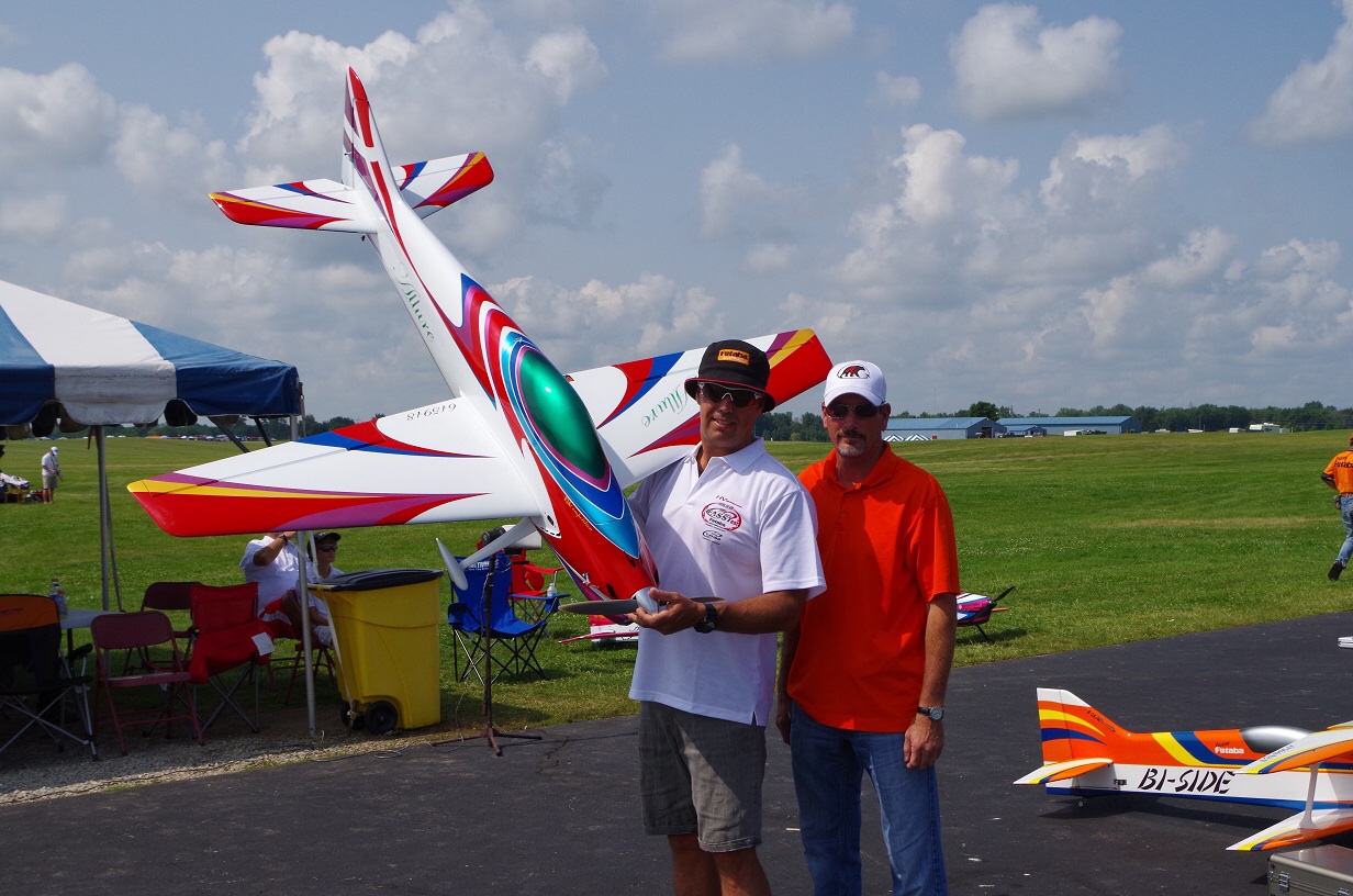

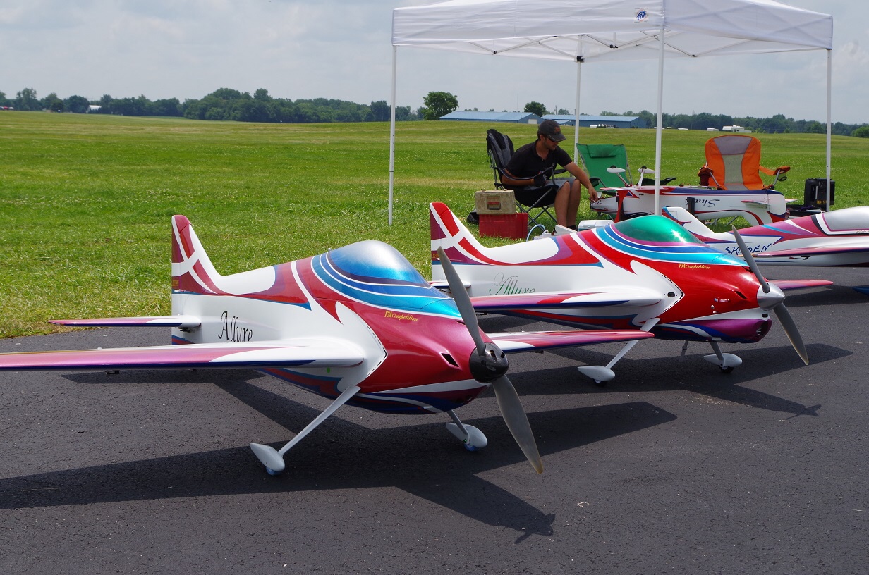

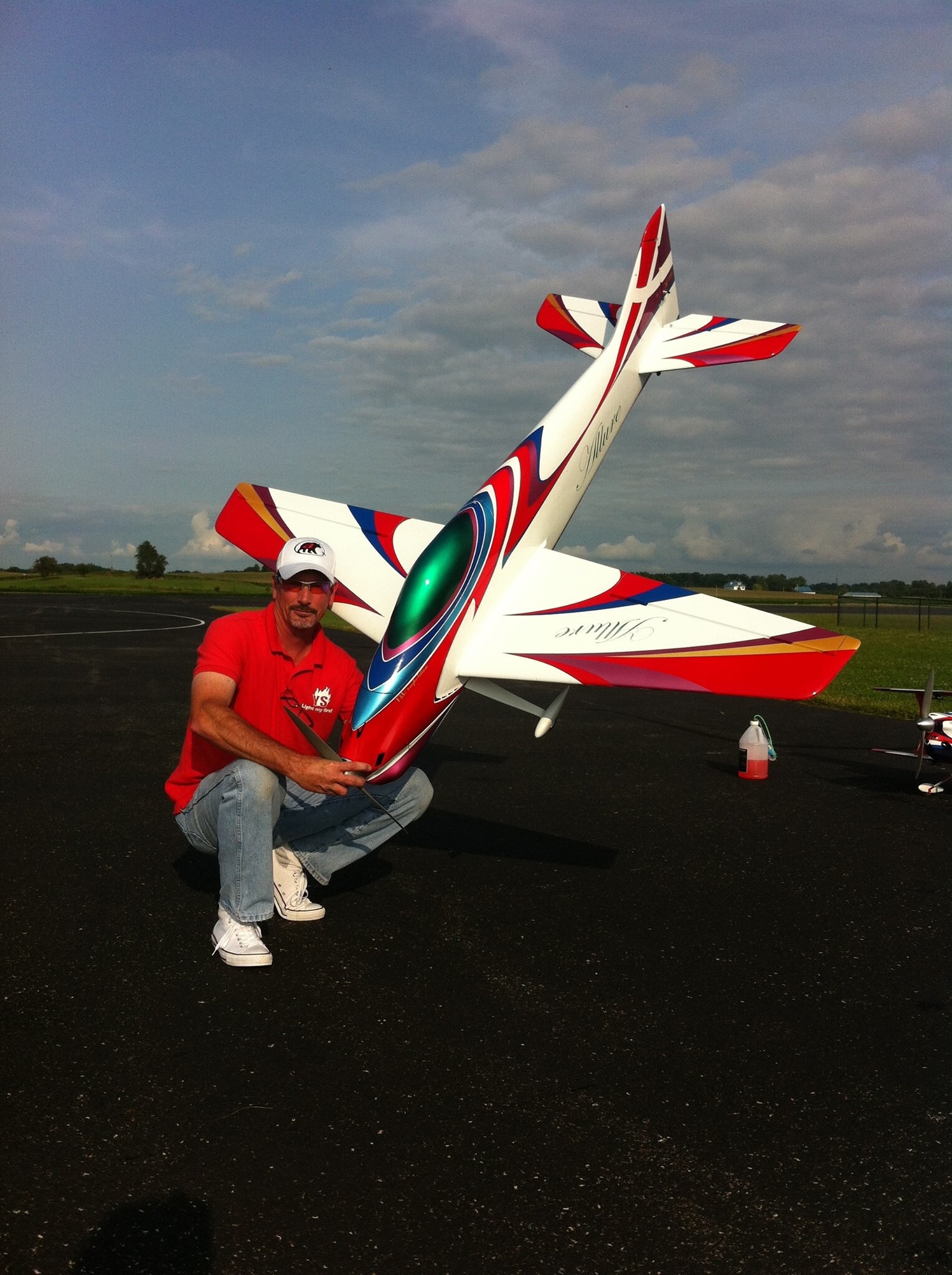

Well I`m Back home and I have my Baby with me the glow Allure
Brett had about 10flights on the airplane before we competed with it and flew it very well indeed, He managed to win a round with it and it performed flawlessly through the event.
I know some said it was a risk to fly it with no time on the model But it goes to show how good the airplane is and How a good setup from the designer can make it work from the building table to the team trials.
After Brett flew the first flight with it he called me and said, Dude this thing is Awesome and flies with the speed control of the Alferma! This made me smile. finishing the airplane with no time for errors to overcome.
The YS 1.75 on the YS mount was perfect for this airplane , Smooth, Quiet, and reliable.
The Xtreme team did a great job constructing this Model and the outcome shows how well it came together with no time to spare.
I have quite a few pre orders now the cut off date is August 15 for the discount.

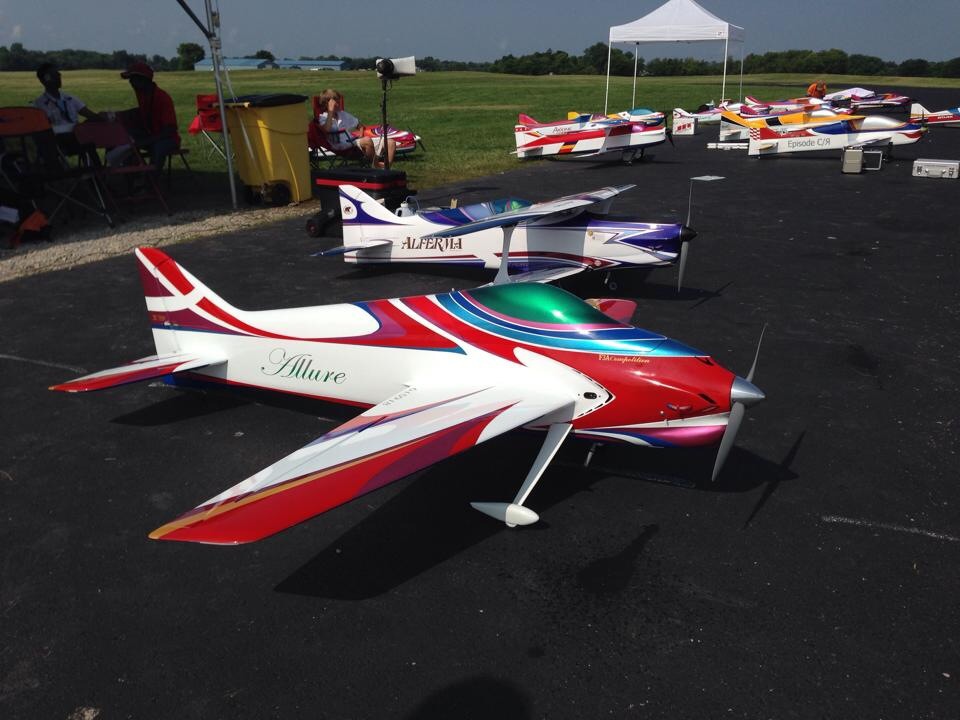

Through a series of interesting events just prior to the US Nats, I was fortunate enough to be able to bring the Electric prototype Allure along with me to show for Byran. He convinced me that I should get a flight on it just in case it would be needed as a backup plane to my Evo. After two short trim flights (about 2300 mah each) the airplane was tracking very nicely. I was able to put just a couple of full flights on the plane during and after the Nats with a Neu motor and APC prop (apc was needed for balance). It flys the masters pattern at a very nice pace and presents very well (large, swept wing presence in the air). In my opinion the airplane tracks like a bit smaller fuselage, very solid in yaw with a slight tendency to help feed itself into a cross-wind. This is certainly not what I expected due to the massive size of the fuselage. I think Bryan has really hit the mark on area distribution on the fuselage allowing it to be light in knife edge yet soft on the rudder. In person the tail section sculpting/design is simply beautiful. The wing and stab are little larger than what I have been flying on my airplane, but they certainly don't feel or look too big in the air. The snaps required a good bit of aileron (just as Bryan instructed) but were very clean for such a new setup. I would highly recommend this airplane and I want to thank Bryan for letting me weigh in with my thoughts on his brand new design. We have traded a lot of thoughts and laser files over the past few seasons about design and building and it was really flattering to have him ask me for my thoughts and input.
Ready to fly weight: 4870g with the Neu, Budd mount, APC 22x12, falcon spinner, HV80, Gforce 5000mah (1150g), 800mah Rx lipo, 5v regulator, standard Rx switch, futaba digitals all around, MK wheels. Bryan spent the time to visit the factory and the final weight and finish is evidence of how valuable that trip was.
As usual, Bryan ran down a long list with me of the very small changes to be made/corrected before production begins...perfectionist as always.

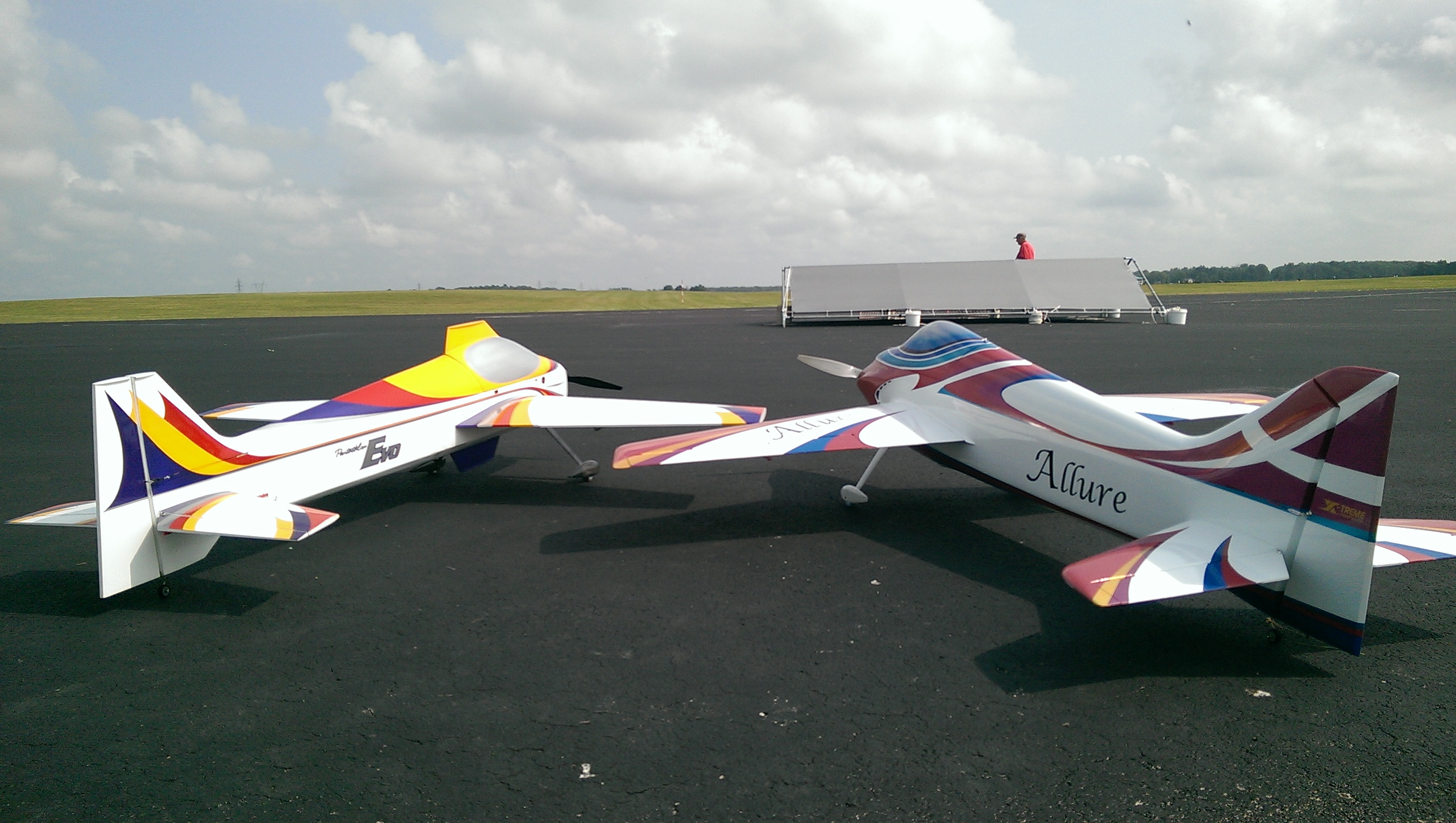

Just wanted to add in my two cents on the Allure. I knew this was going to be a solid airframe before I flew it because it's based off the platform of the Shinden, a design that we know is solid and pure. What I didn't know was how much I was going to love this airplane!
It's been 3 years since I've even flown a monoplane in competition. What a lot of people don't realize is modern designs are being formed around, for the most part, the unknown maneuvers. The trend towards biplanes has a lot to do with the unknowns, and for good reason. You can't beat the yaw authority and flexibility the biplane gives you in unknowns, but there are some compromises made with ease of setup, tracking, and purity. Bryan and I have made huge gains in these areas with the biplane but the compromises are still there. The Allure takes advantage of that natural locked-in feeling and runs with it.
The first time I flew the airplane I was immediately struck by that locked on feeling. Matt Stringer made this comment when he flew the airplane, that as soon as you let go of the elevator the airplane instantly sticks to where it's at. I think that's a great way to put it. The airplane feels the same way in roll. Over all, and I made this comment many times when I was asked about it at the nats, the airplane is just easy to fly and the sheer size of it makes it present so well it ruins every other monoplane on the line (in my opinion, at least). It keeps it's pace incredibly well, never becoming "zoomy" on the exit of tall verticals. The size also gives it great yaw authority. It's not like the Alferma (you probably wouldn't want to do Knife Edge Vertical 8's downwind with it), but plenty to do the downwind radius in the golfball in F-15, and plenty to do a beautiful Knife Edge Humpty Bump in P-15. The large vertical stab gives it tremendous stability in Yaw so the airplane never feels uncomfortable either. When you let go of the rudder, that's where the airplane is going to stay. There's no messaging the backside of that humpty bump in P, or really trying hard to make that last 3/4 roll of the gofball axial. Let go of the rudder, do the roll, done. Easy.
I regret not having the time to really fly the Allure through F-15. I did the golfball a few times and I did some various snaps but never ran it through the whole pattern. The golfball was remarkably easy though and 1.5 snaps, and especially knife edge snaps, we're crisp, tight, and controllable. I am more impressed with this airplane than I ever thought I was going to be.
I know I'm biased. Of course, I stand to gain from people buying this airplane. But like Bryan I also stand behind what I put out there. This is a fantastic airplane and I'm very excited to be associated with it and for other people to get it into their hands.
