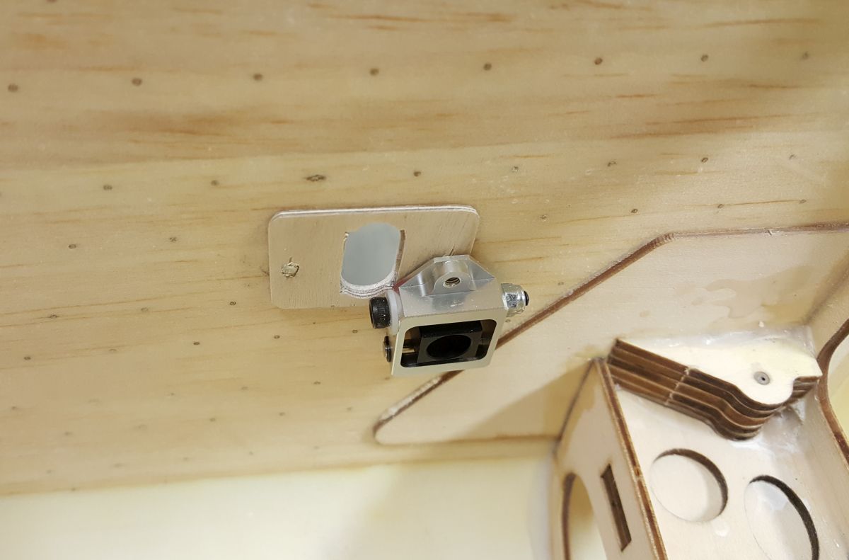

Remove the motor mount.
Bring the motor in from behind and install the spinner backplate, cutoff prop and spinner.
Put some medium CA glue on the metal tabs of the motor mount.
Bring up the wood motor mount from behind and while holding the spinner aligned to the front of the fuselage....press the wood motor mount in place.
After the glue kicks, remove the spinner, prop and backplate and slide the wood Motor mount and motor out the back.
Mark the motor mount holes in the wood motor mount.
Pop off the motor from the wood motor mount.
Drill holes.
Put it all back together again with Hysol.
Most guys have been using this method for many years and it works very well.

On this style of BJ airplane I open the front leaving about a 3/8" flange.

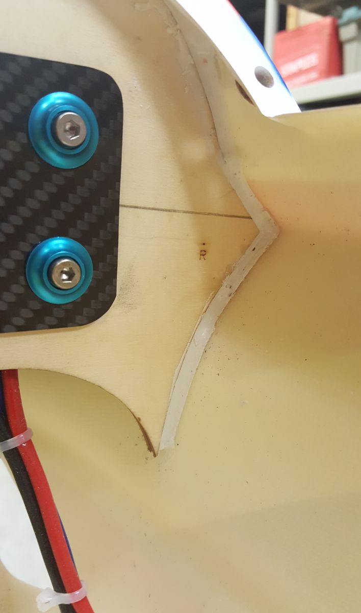

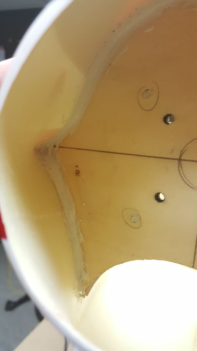

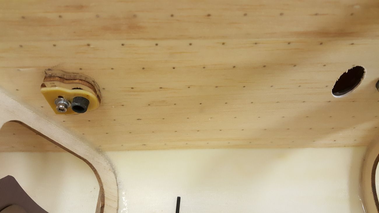

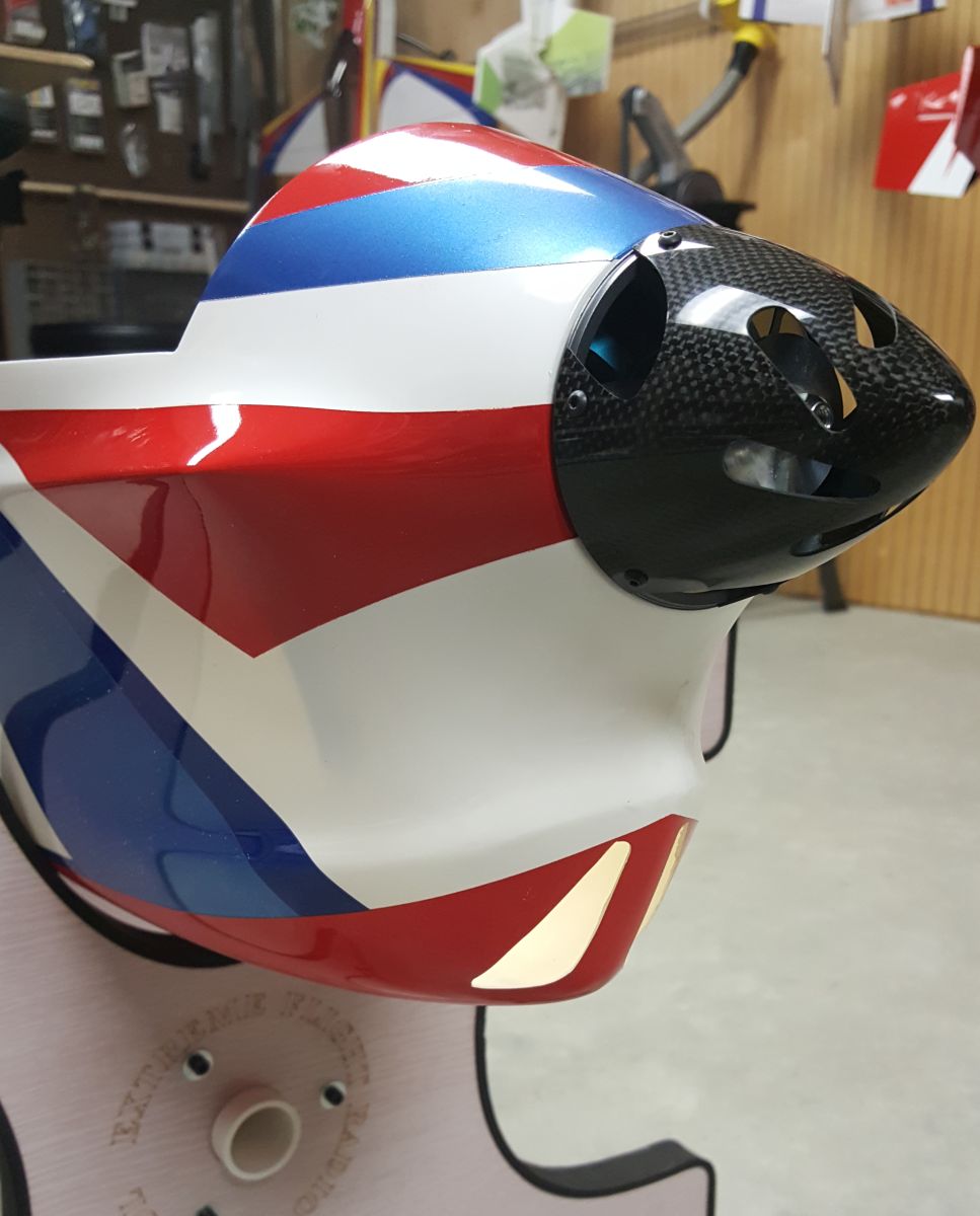

Default Firewall & Cooling Vents Update

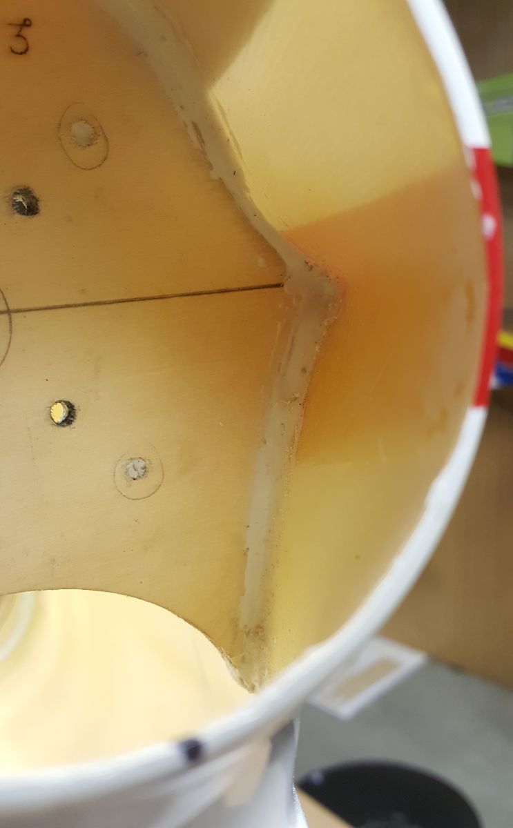

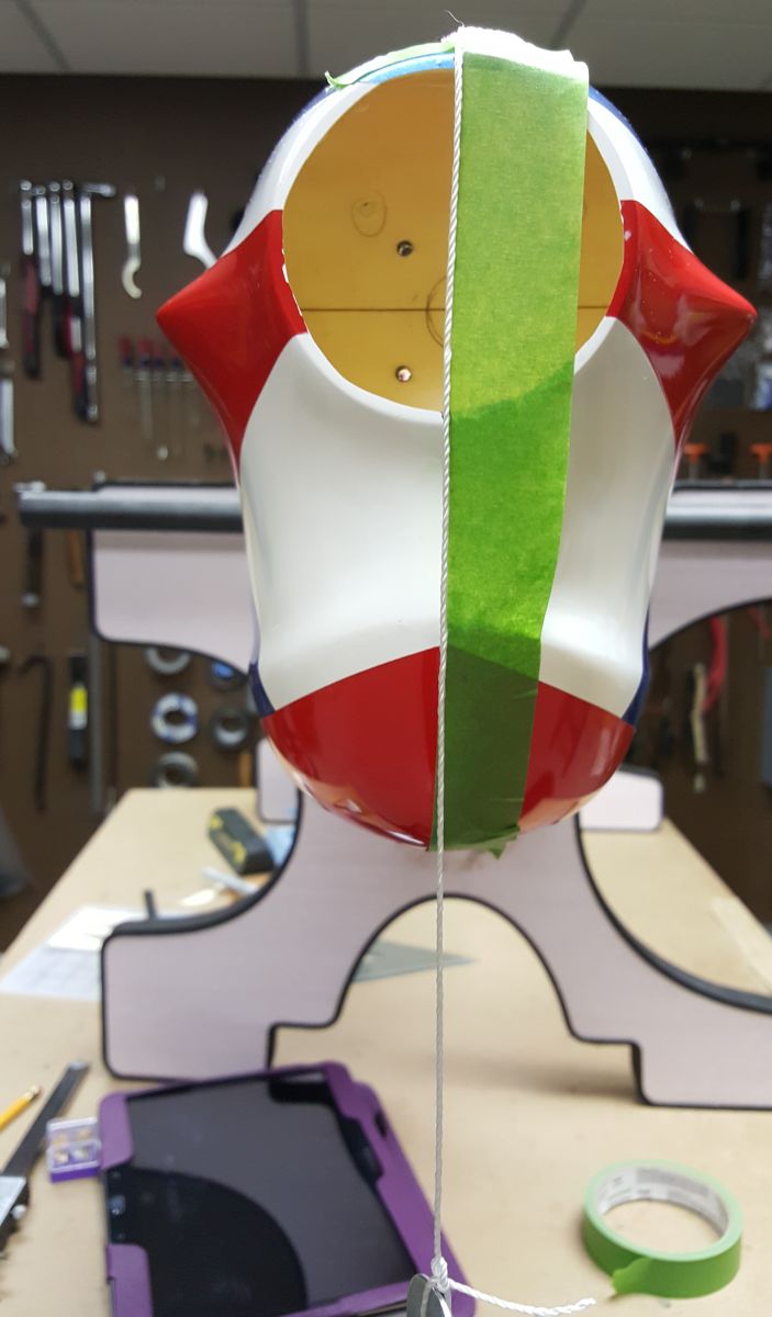

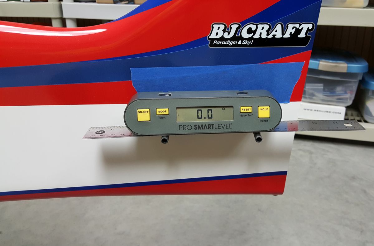

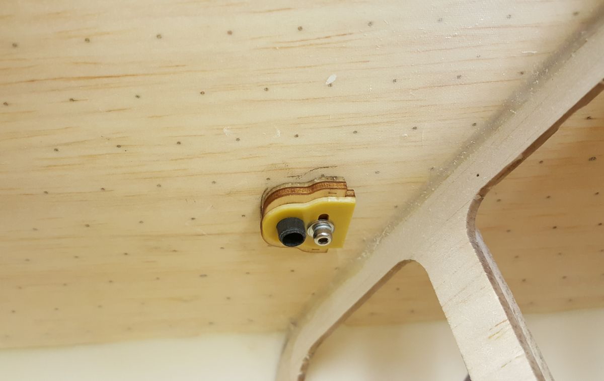

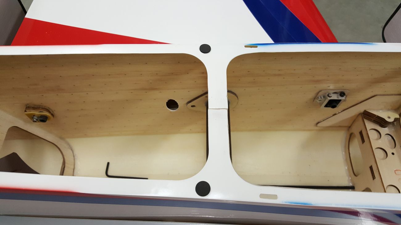

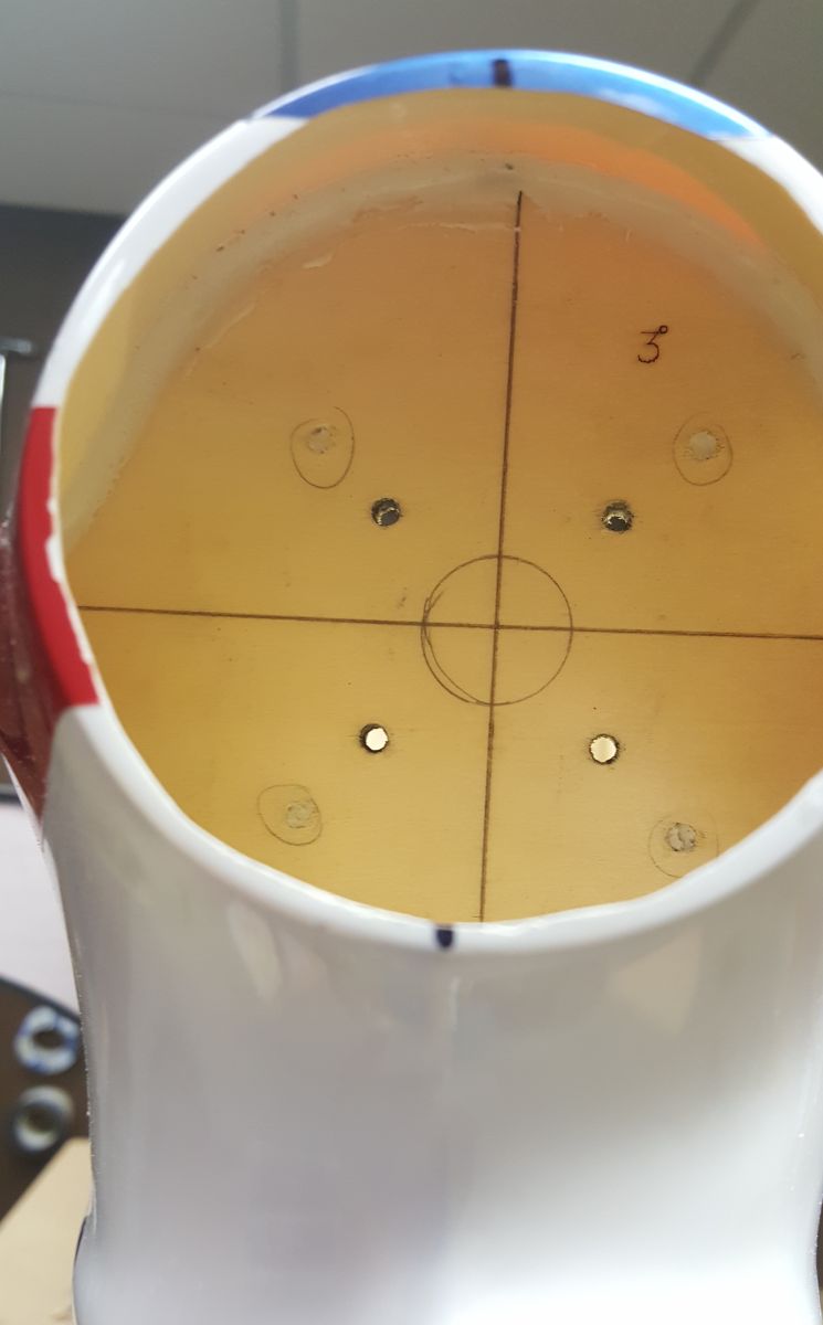

Here's my update.
I liken this to making a cake, you need a lot of different ingredients for it to come our right. I took a advice from the helpers here and went forward.
The firewall is installed and I can't make it any better, second time around helps too. After setting the firewall and tacking it in with some ca, using a 2 mm spacer behind the spinner backplate I realized this was TOO much of a gap. Tore it out and used a 1.1 mm spacer, much better. 32Ford set me straight here!
On to the cooling vents.
Not much to report other than trying to find the center-line of the nose ring. I layed out the tape lines on fuse where I would trace the template with a marker pen. Used a Dremel with a cut-off wheel to do the rough cut, filed and hand sanded the rest.
No matter how much time I spent on the layout It still didn't come out as symmetrical as I would have liked. It's close but needs some TLC.

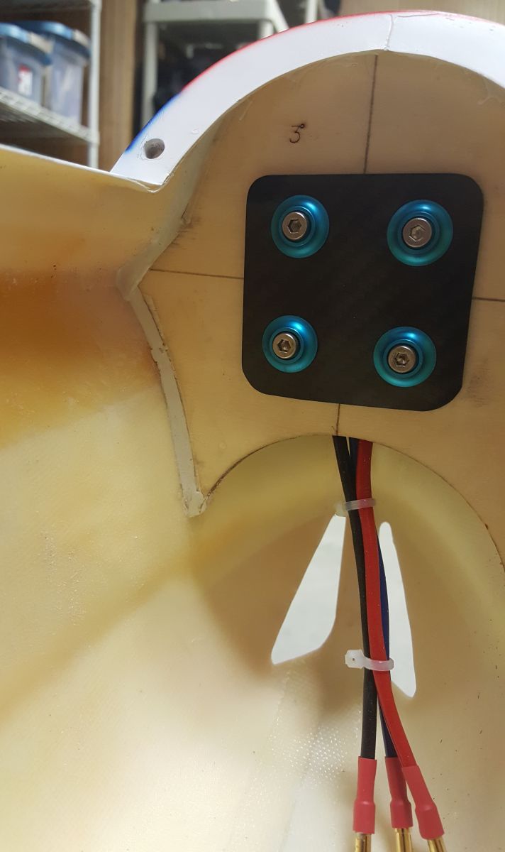

Looks very good. I must have used 1.0mm cf strips for my spinner backplate spacing as my clearance is much less than your 2mm picture. I would sure go back and make sure that the Hysol filet is around the entirety of the firewall-fuse contact area. Your picture doesn't appear to have a filet across the top of the structure. The vent holes on the nose look fine to do the job. Be careful cutting the ones on the bottom of the fuse aft of the canopy compartment. That area of the fuse is really thin, egg shell thin at most. I reinforced mine structurally after cutting the vent hole pattern.
Old 02-28-2017 | 05:44 AM
  #109
My Feedback: (8)
Joined: Nov 2004
Posts: 149
Received 8 Likes on 8 Posts
From: Syracuse, NY
Yes, I knew you would pick out the LACK of adhesive used. This was the first application to secure the firewall. I did apply an entire bead on both side of the firewall, pictures forthcoming in the next round. The difficult part was trying to apply epoxy behind the firewall where it meet the top deck of the fuselage, pretty tight fit.
The spacing on the spinner was after my second attempt, I'm not showing the first round, it was ugly.
I used the same motor on my Caelus and noticed after a number of flight the prop shaft moves fore and aft, hence my 1 mm gap.

It may be a good idea to add a piece of carbon fiber plate (0.75mm) of the size of the motor on the back of the firewall (like the front one). This can help prevent the washers being pushed into the firewall and secure the motor better.
On my front-mounted Pletty, I added one piece from the front for the same purpose.

Nice work Mike! A mirror and a flashlight in the fuse can work well to let you see into the dark corners. Don't let the paint fool you either because it is never as symmetrical as you think.

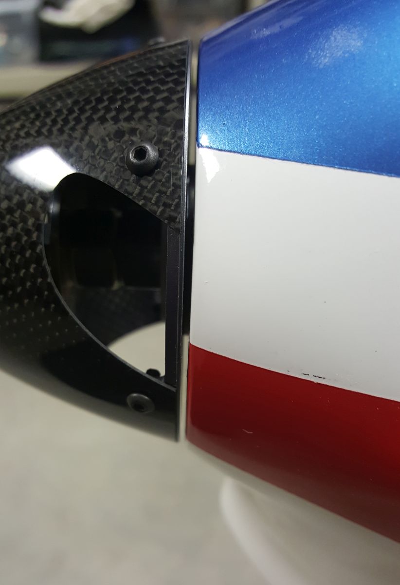

Sorry for the novice question, but what is wrong with a 2mm gap between fuselage and spinner backplate?
Is it strictly looks?
Old 03-01-2017 | 11:54 AM
  #114
Joined: Oct 2005
Posts: 63
From: OSLO, NORWAY
Nothing wrong with 2 mm gap, it's more a cosmetic details.

If the motor is soft-mounted, I believe you may need a gap bigger than 1mm (such as 1/16 inch) to prevent the possible rubbing of backplate to the node ring.
Old 03-01-2017 | 01:00 PM
  #116
Posts: 689
From: Sperry, OK
No real need for soft mounts on electric motors....unless you are trying to increase the weight.
The gap on my Nuance and Essence is 1/16" or a little less.
Old 03-01-2017 | 01:19 PM
  #117
nonstoprc's Avatar
My Feedback: (90)
Joined: Sep 2003
Posts: 2,466
From: Central, TX
1/16" is the distance I have been using with soft mount for Neu motors. 1mm is less safe.
Soft-mounting can reduce the noise level, supposedly.

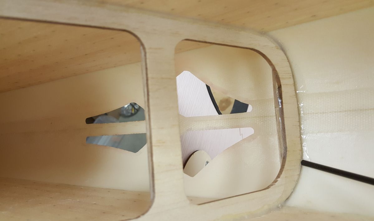

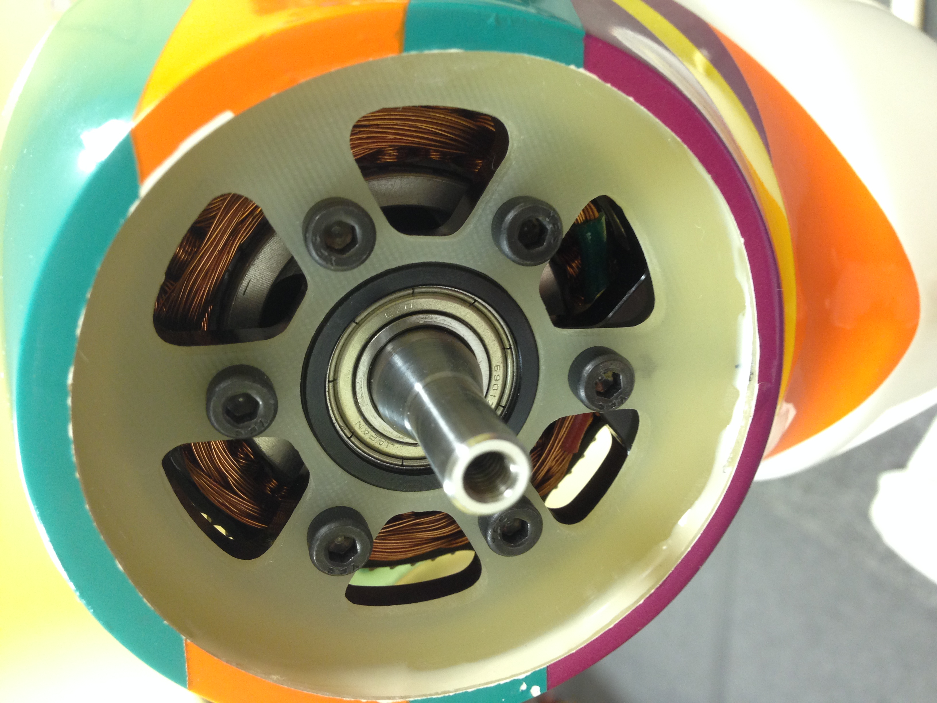

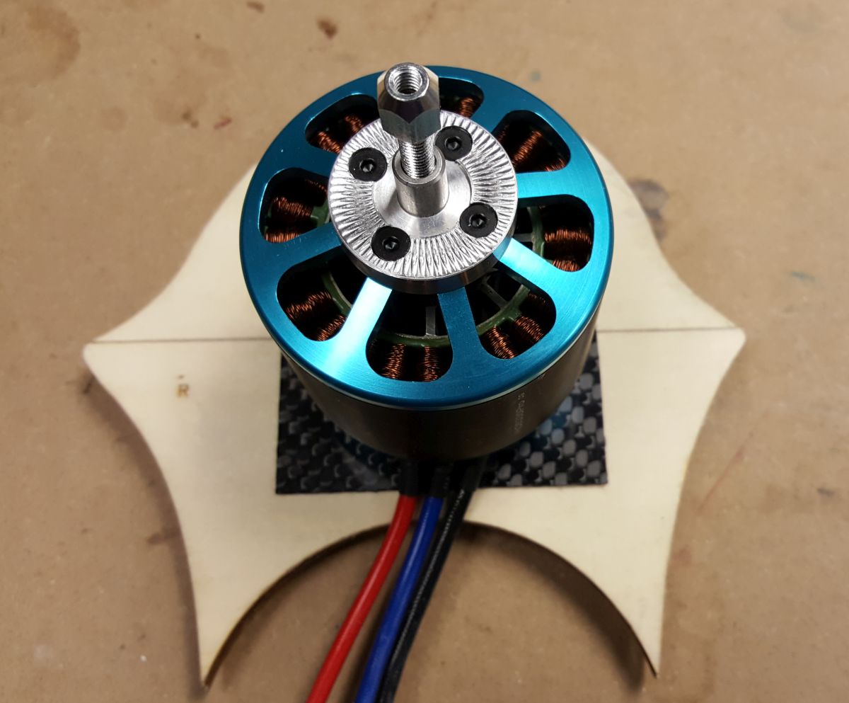

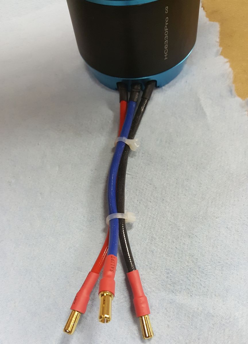

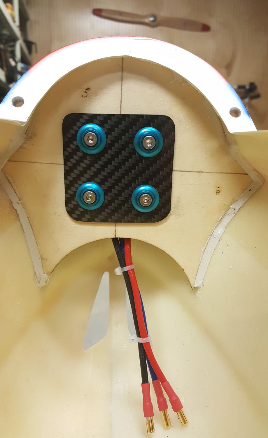

Default Firewall Update Part 2

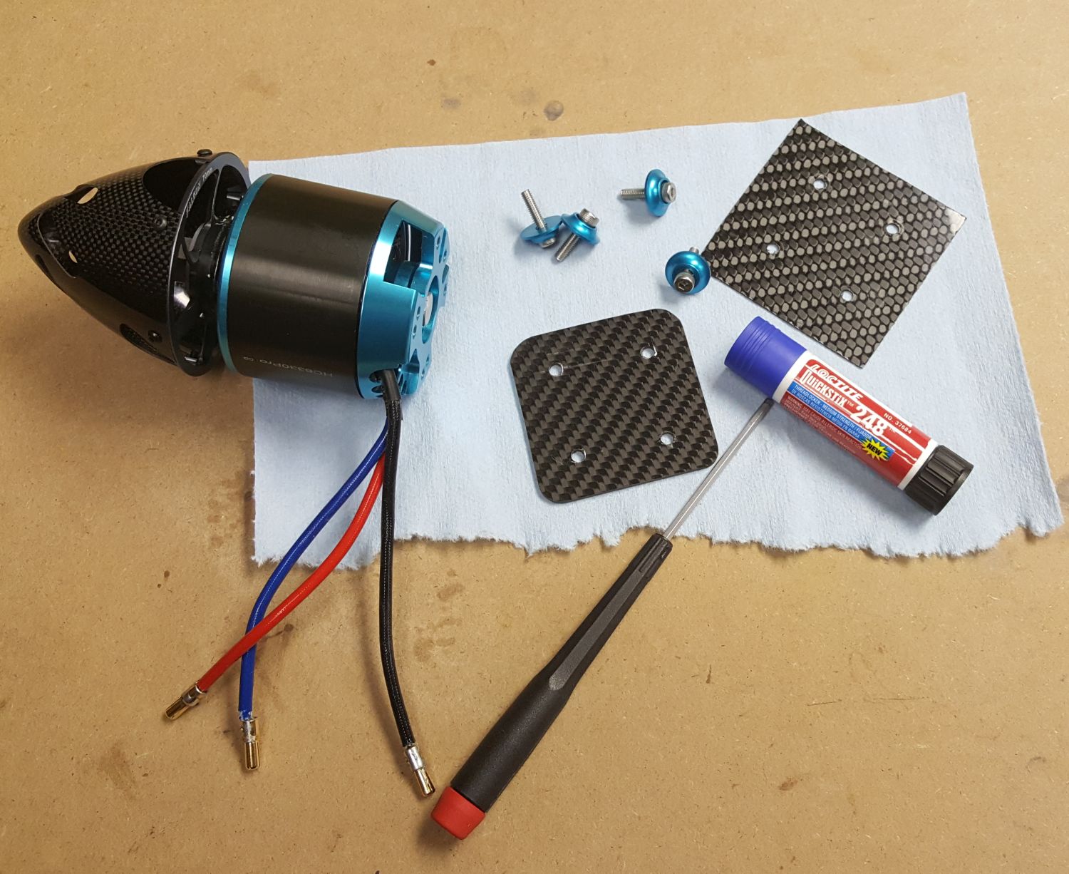

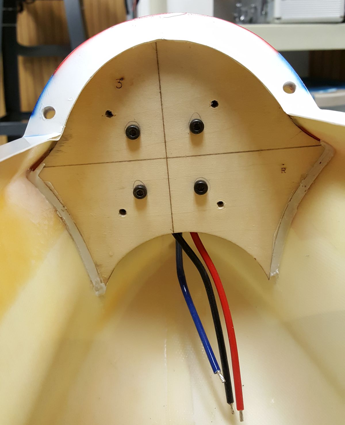

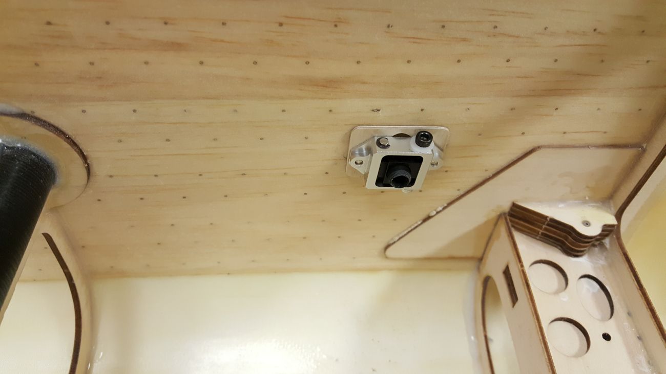

The firewall is now completed.
Soldered 4 mm Castle bullet connectors to the Himax 6330-210 motor leads, added heat shrink tubing. Connected to a 70 mm Falcon three blade spinner.
I used Hysol 1C (that's what I had while waiting for the HP 60 to arrive). The adhesive sets up in 25 minutes, dries white and easy to work with. Applied an adequate amount on both sides of the firewall. To keep the lines of epoxy straight I placed masking tape to the fuse and the firewall to replace an ugly mess. Spread the epoxy, worked into the gaps and removed the tape.
I placed a 1 mm carbon fiber sheet sandwiched between the motor and firewall with a 2 mm plate on the rear of the firewall. This helps spread the load when you wrench down on the motor mounting bolts, IMO, and prevents the oversize washers from crushing the wood. Applied loctite thread locking paste (blue) to the motor bolts and called it a day.
This is as good as I get.
Next step, cut the cooling vents on the underside of the fuselage.

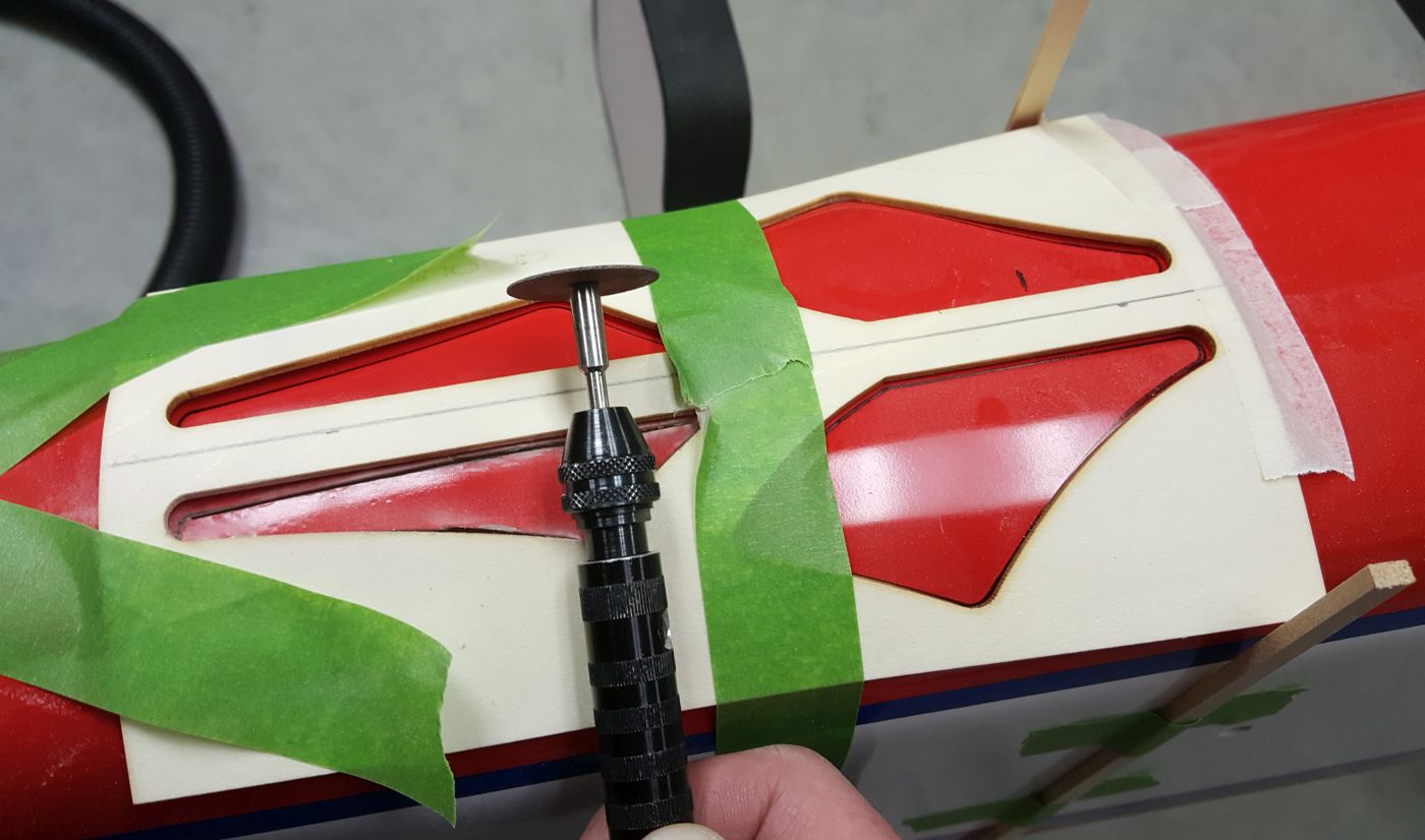

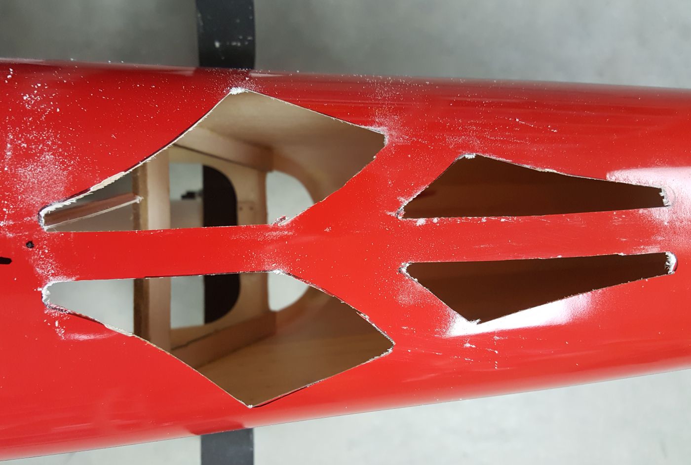

Old 03-02-2017 | 08:10 PM
  #121
My Feedback: (8)
Joined: Nov 2004
Posts: 149
From: Syracuse, NY

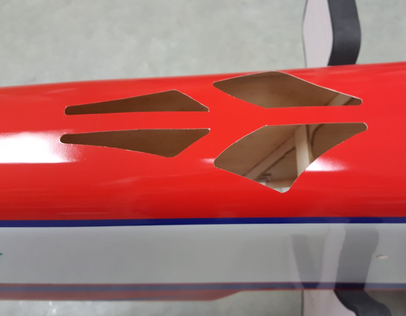

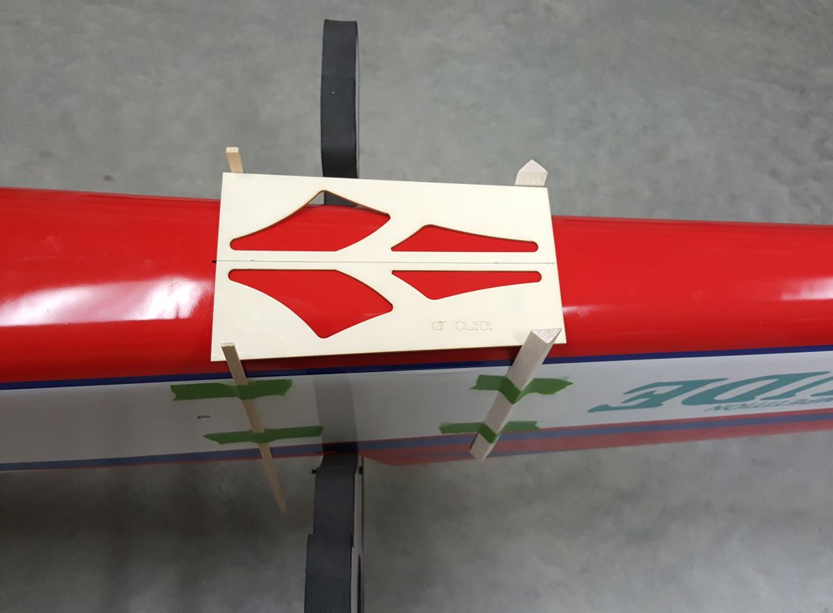

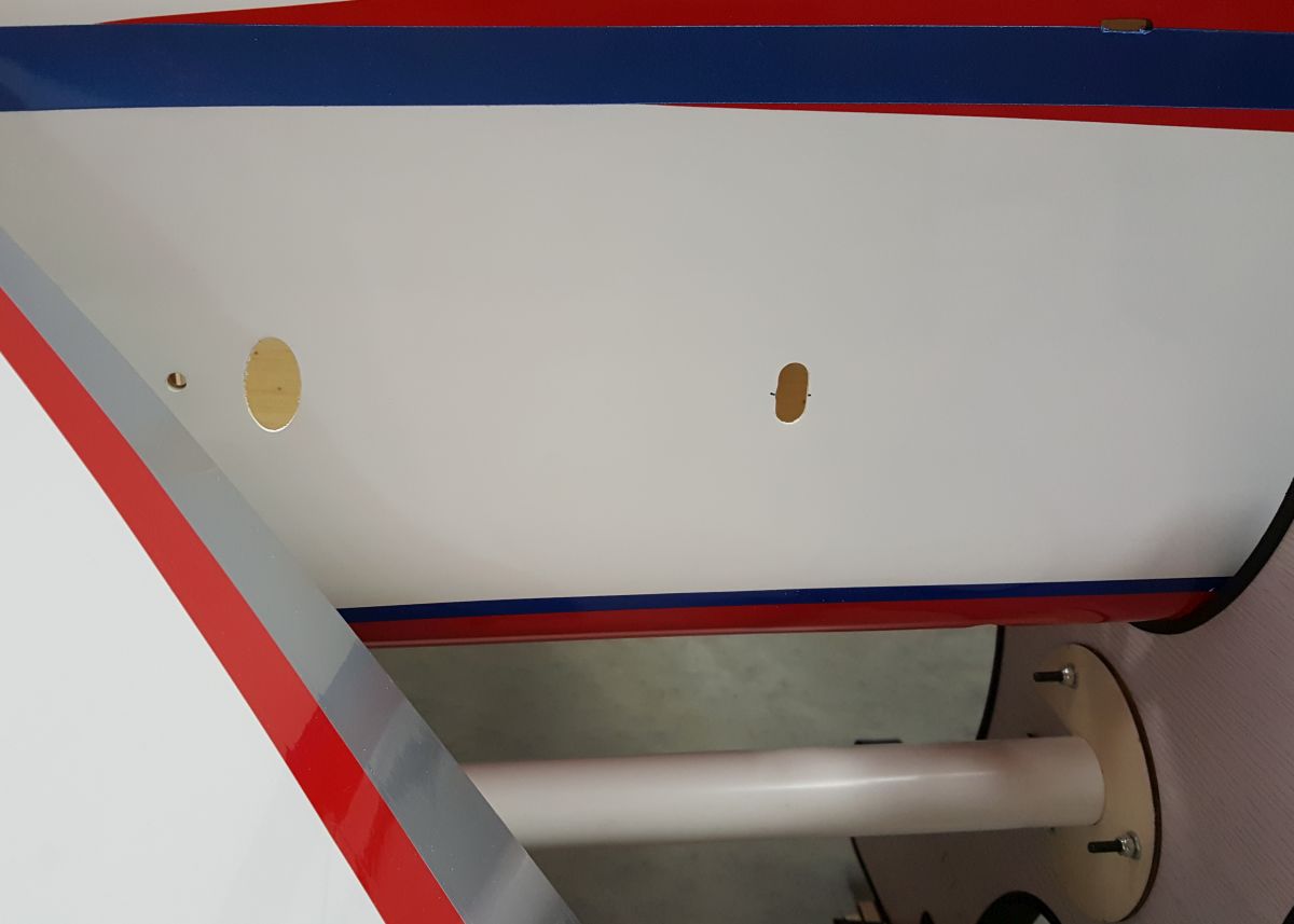

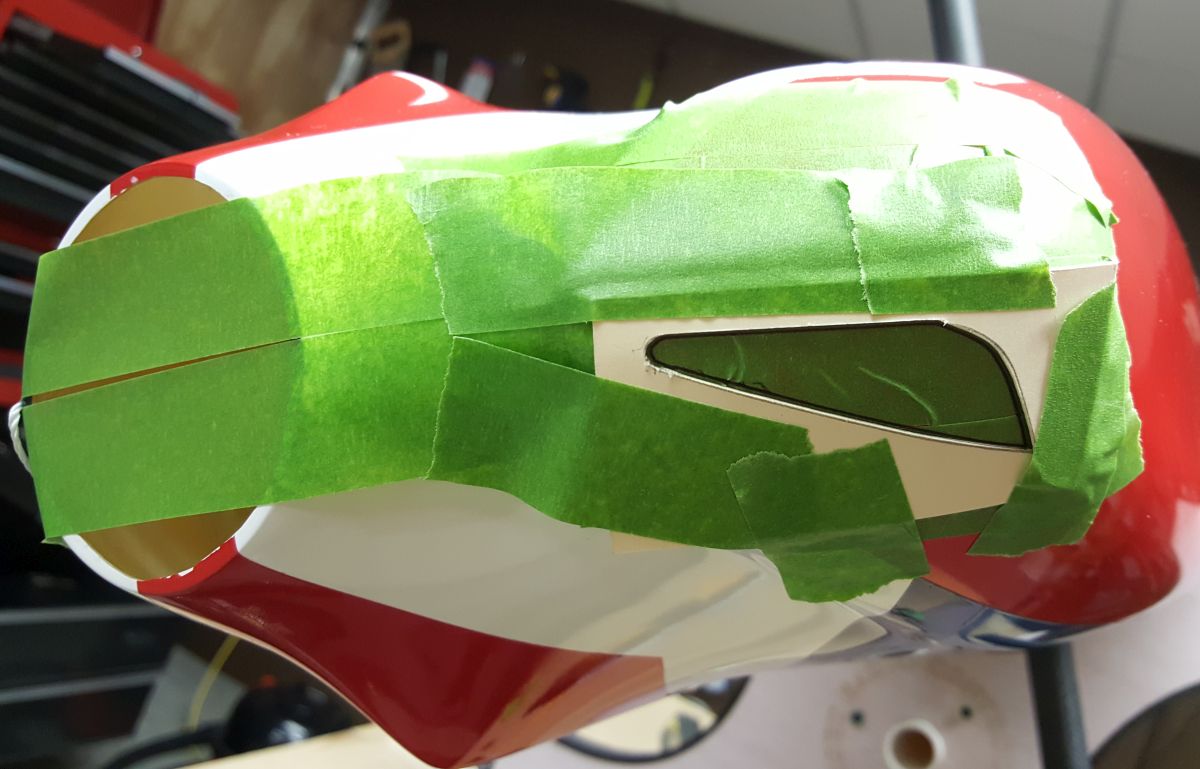

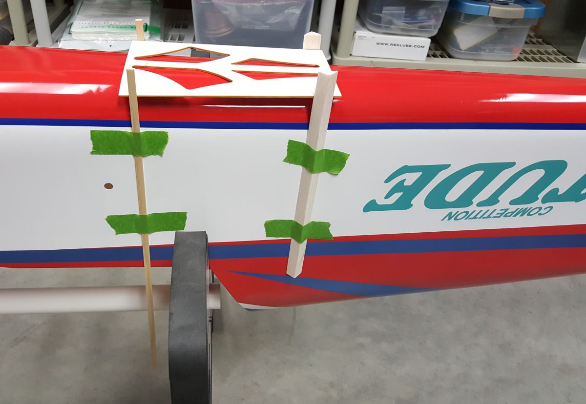

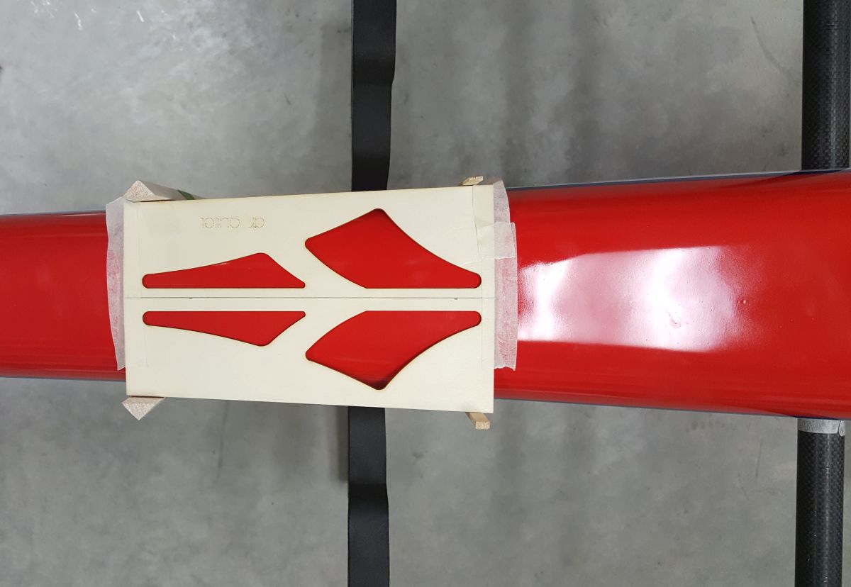

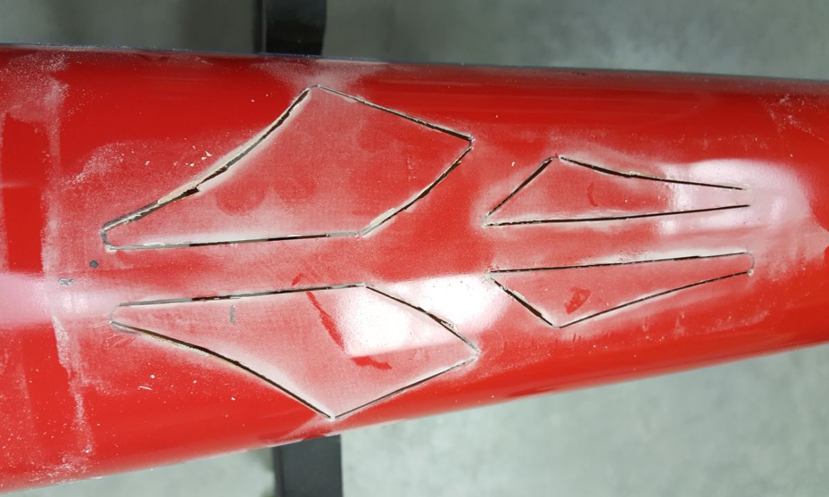

Default Cooling- Venting Part 2

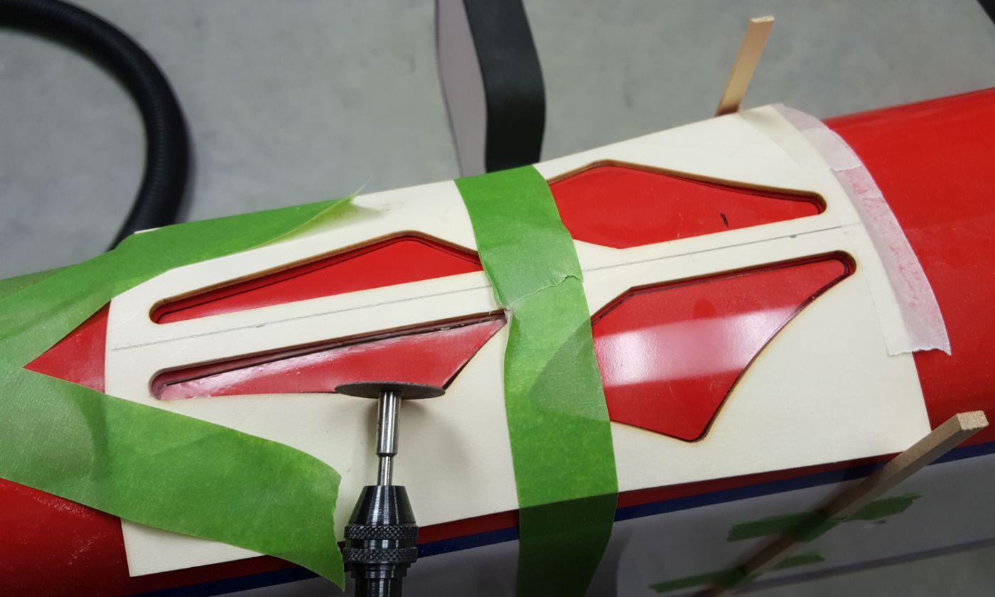

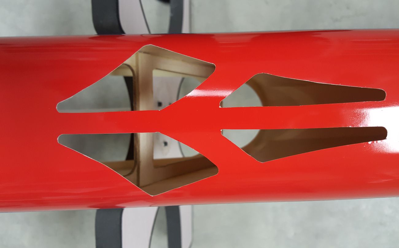

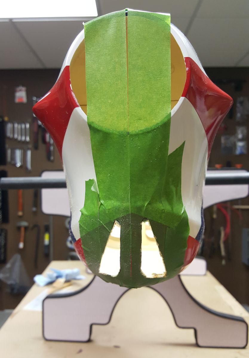

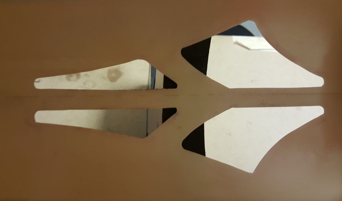

The saga continues.
This had to be one of the easiest jobs I've completed on the plane so far. It really does help when you spend about an hour digging through various sites and photos. Much time could be saved if you supplied some sort of building manual. I hope someone here can benefit from my photo postings.
The trick was knowing exactly where to place the supplied wood template on the fuselage. After looking at a few photos it became clear it needed to be placed behind the former aft of the trailing edge of the wing.
I taped 4 balsa pieces to the fuselage and placed the light ply template between the balsa stock. It lined up pretty close. Took a few more measurements and taped the template to the fuselage. Proceeded to mark the fuse with a marking pen to make the lines more pronounced. Took my Dremel with the snake extension and a cut-off wheel, the snake cable is one handy gizmo to have. Put the Dremel to work and cut inside the template where I could and finished cutting the fine edges with a micro cutter bit. Placed the fine grind stone on the snake and rounded the corners. Removed the template and finish sanded all the edges to clean it up.

Old 03-02-2017 | 08:27 PM
  #122
Posts: 689
From: Sperry, OK
Looks good....that's the same way I did it.
You can put some thin CA on your finger and run it around on the inside of the cuts to keep the paint from chipping away as it ages.
Old 03-02-2017 | 08:34 PM
  #123
My Feedback: (8)
Joined: Nov 2004
Posts: 149
From: Syracuse, NY
Great idea, will do it.
Thanks.

Some of Neu F3a motors have straight gears, so it is mainly the gear noise to suppress. The newer version utilizes helical gears and the gear noice almost does not exist.
The Hyde soft mount (both front and rear) for Neu is 1.5 oz in weight, very minimal.

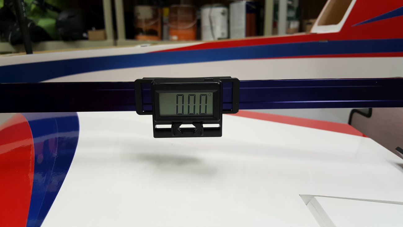

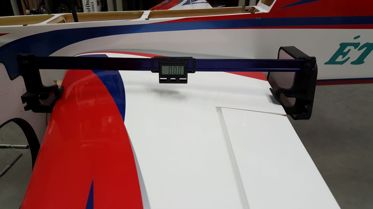

Default Wing Adjuster Installation

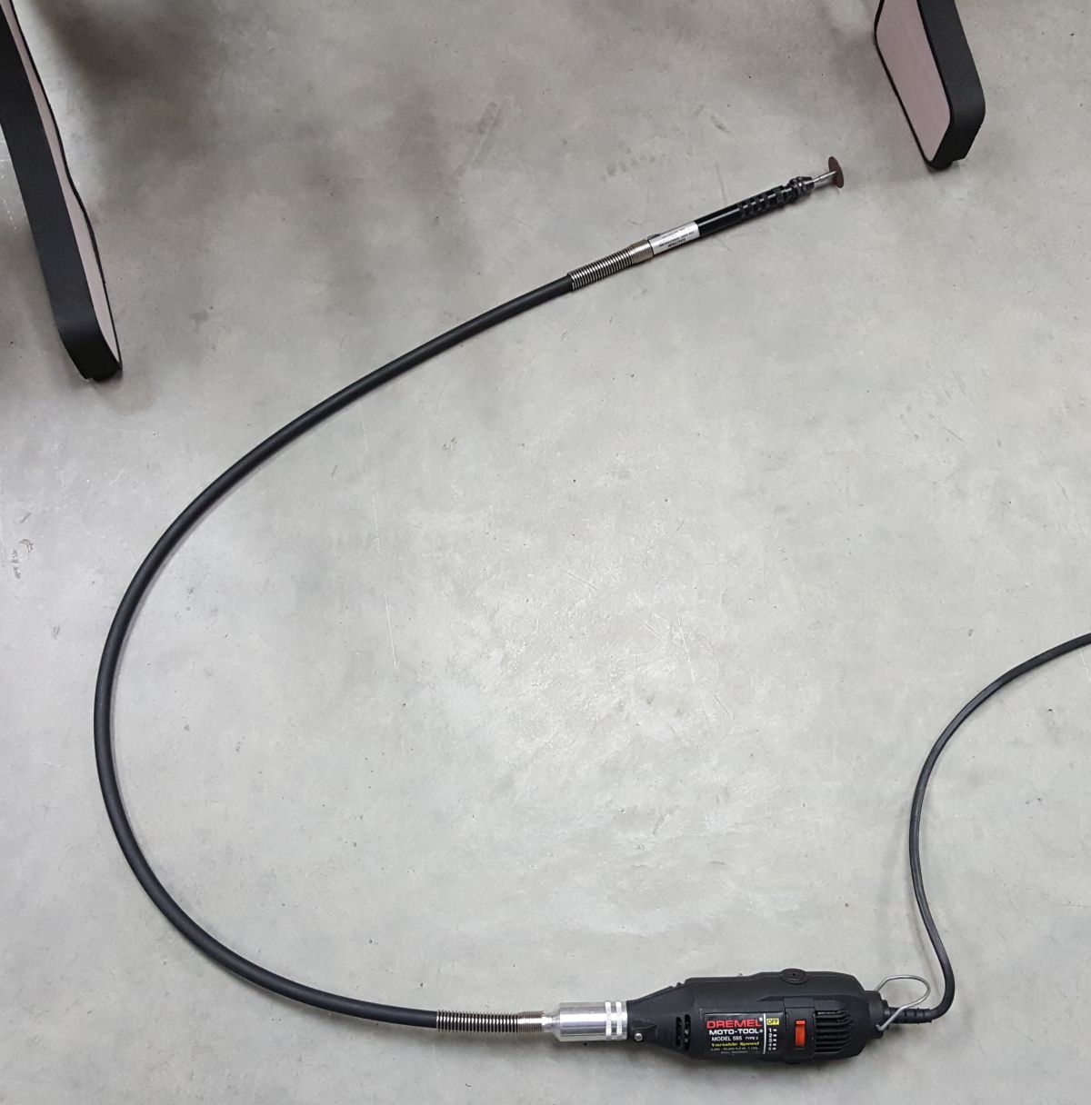

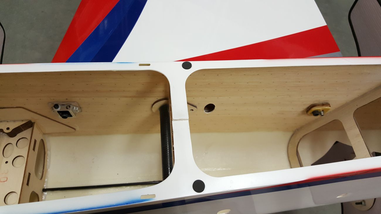

On to phase ????
It's time to install the wing adjusters. I ordered a set of wing adjusters from F3A, the style best suited for the BJ Craft birds and decided to mount them in the leading edge, no specific reason to mount them there, just looked easier. Installed the oem set in the rear.
In the past I've typically used the canopy line to gain a reference point and I could not have more mistaken. The zero line is taken from the stab tubes and set the wing incidence to the stab tubes.
I must have spent 2 hours measuring and couldn't figure it out. If it were not for the help of 32Ford I would still be scratching my head. I called him on the phone and within 15 minutes he set me straight, he really bailed me out.
Much of this could be avoided if BJ Craft supplied some sort of building manual, the Caelus I built last year is really a cut above when it comes to instructions.
Here's a rundown of the photo build.
Thanks 32Ford I owe you!
