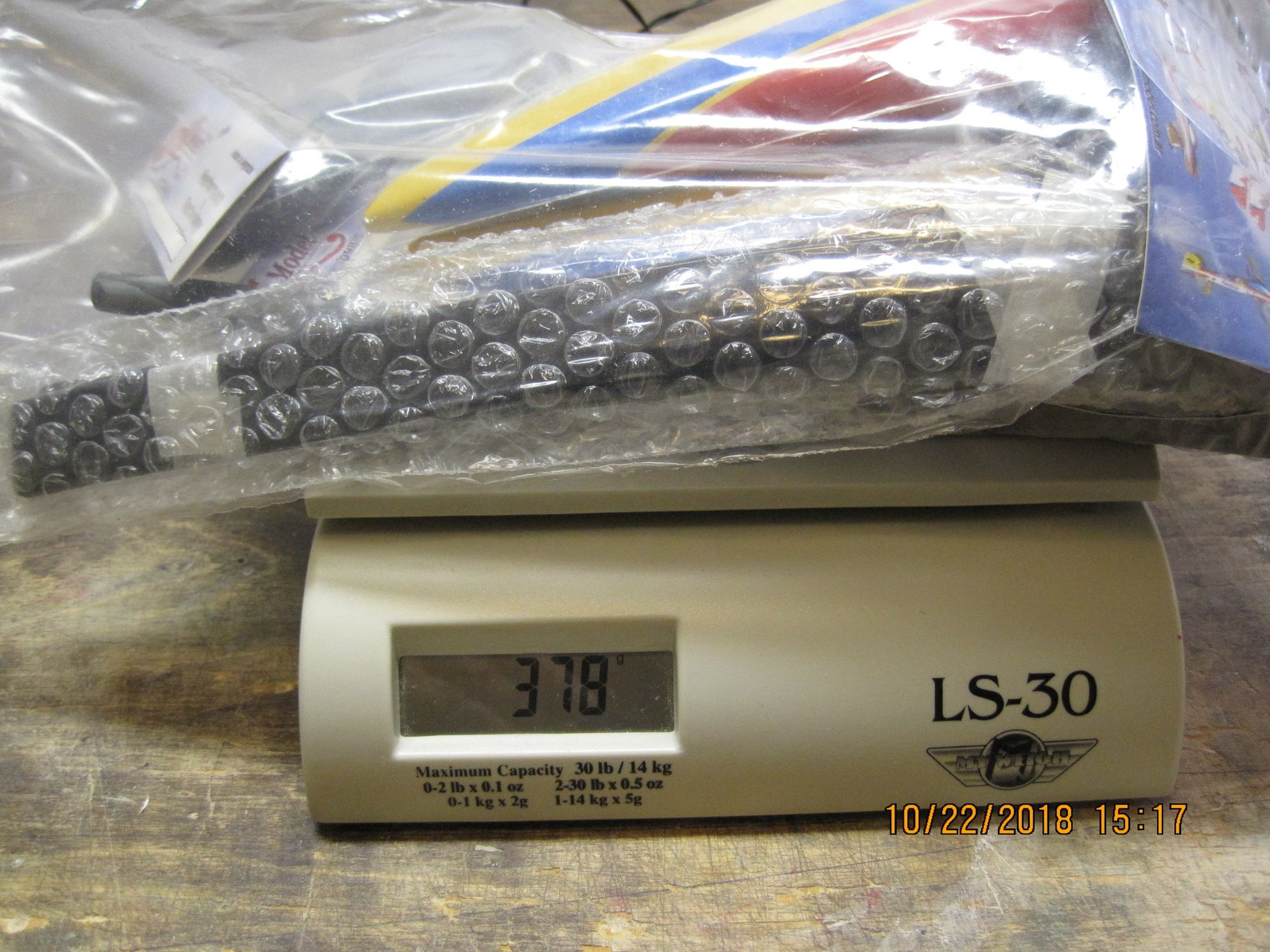

I just received my yellow base color Andes biplane that I ordered from F3A Unlimited. Mike Mueller took care of all the ordering details from CA Model Argentina. This is a yellow base color and it only took five weeks to arrive. So far the quality is very good and the fuse paint job is nice. I'm not sure who supplies the metallic blue covering. I'd like to order a roll as a back-up. These are the component weights:
accessory pack: 378g
Fuselage: 966g
Canopy: 160g
Rudder: 58g
Right stab: 82g
Left stab: 78g
Top wing: 470g
Bottom wing: 528g
Spinner: 30g
Wheel pants: 50g
Wheels: 20g
Front Plettenberg plywood nose mount: 10g
Landing gear: 120g

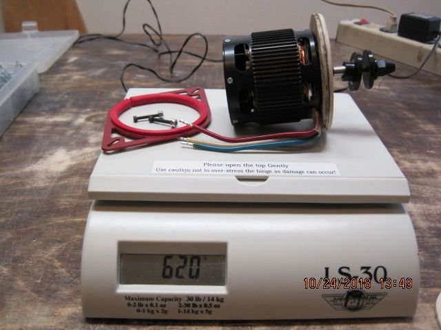

Attached are photos of my three motor options with mounting hardware weights included. I plan on using the Hacker C54 Acro motor. The estimated final build weight should be approx. 4950g. Now just need to determine recommended right and down thrusts.
From my understanding of people who have owned this model; follow the nose attach your motor and go, seems like the thrust that's built in, is right on.
can you show pics of your hardware?

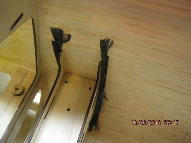

I am installing the Falcon long Allure CF gear. It only weighs 106g. I am also installing CK Aero Allure wheel pants and MPI thin wheets. This set with axels only weighs 58.5g. I ended up installing blind nuts in the landing gear plywood mounts. I had to cut access holes in the bottom of the fuse for the soc hd cap screws.
My Feedback: (76)

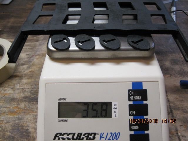

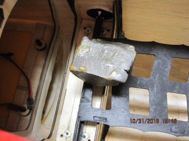

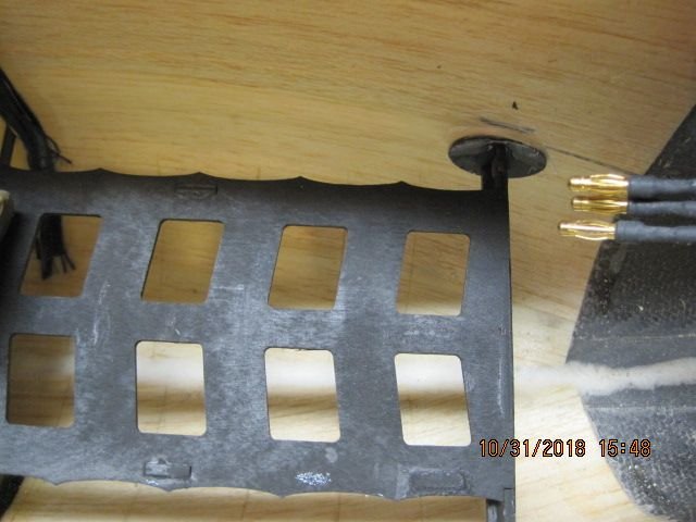

I chose the Falcon gear because they were lighter. Falcon also makes a shorter gear that fits as well. It's the number 102 gear. The two holes on each fuse side are too wide for either the CA landing gear or the Falcon gear. I simply just drilled holes that were less far apart. I used the factory ply battery tray. It was fairly light. I did paint it black simply for looks.
