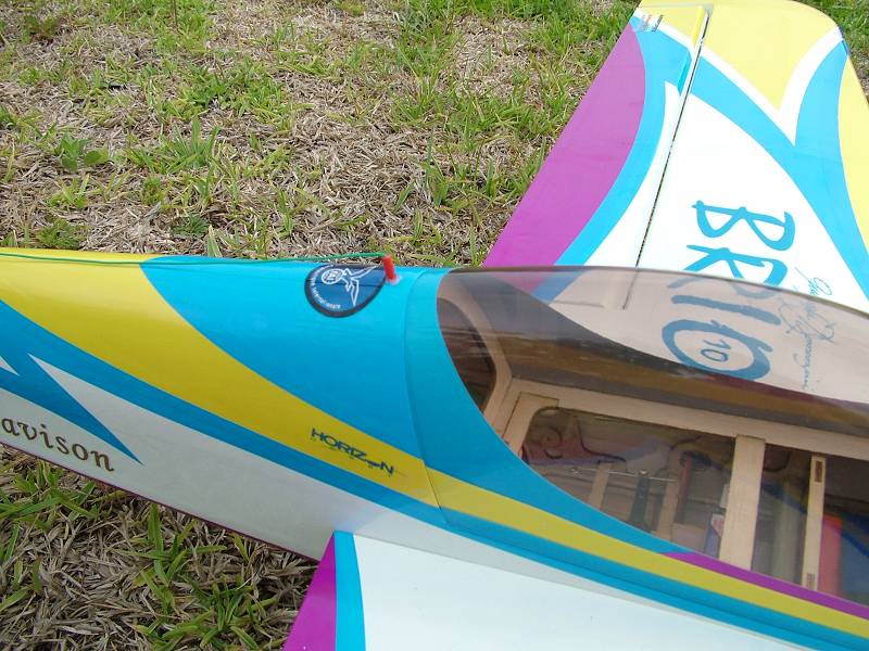

Just maidened mine. Of course, the canopy blew off and pieces of wood came raining down on the field. Overall, the plane flies great. The 480 isn't enough at our altitude (3500ft), but we'll see. Also, the spinner doesn't work at all with the APC E type props that were recommended. Where do you buy those rare earth magnets for my next canopy to hold it in place?

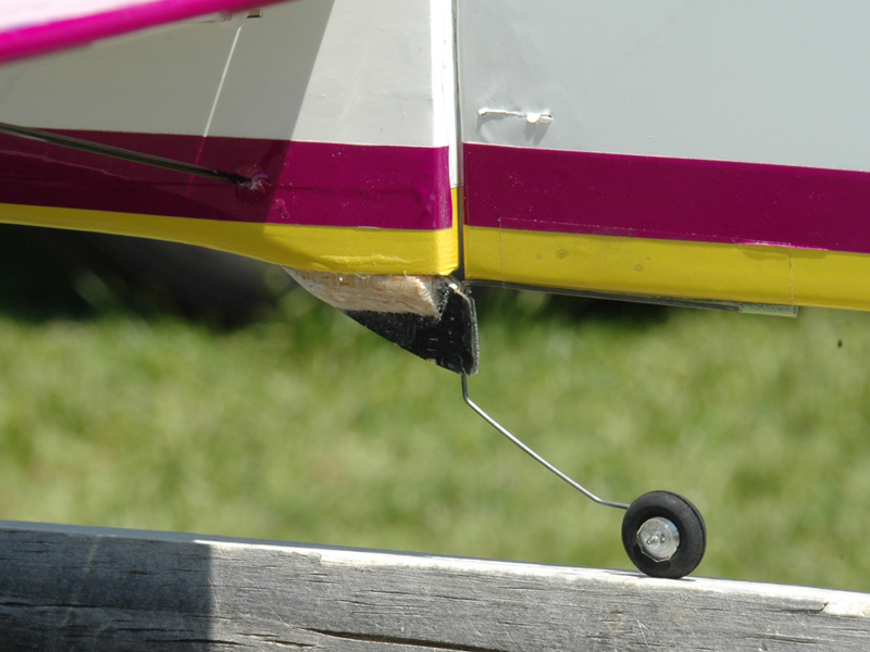

I noticed that after RCU crash last night my previous post with my tailwheel pics disappeared. So here they are again!
The tailwheel bracket is a piece of 1/16 balsa with a 3/8 inch long piece of 1/16 alum tubing CA glued to end - cross grain. Then I wrap 2 oz carbon cloth from one side of the balsa across the tube to the other side, when cured, trim and epoxy 1/4 triangle stock on both sides of the carbon/balsa lam to form the mounting surface - when that cures trim and sand to fit the mounting area in front of the rudder post. I don't remember what size music wire - but it's the size the fits the 1/16 tubing, bend to shape - I made the wheel retainer by cutting out a tiny circle of plastic - slipping that over the music wire and adding a drop of epoxy. I think the tail wheel is 3/8 or 1/4 - you can see all this in the photos...
I may remake the length of the wire, but at this size it will keep the bottom of the rudder of the ground
and has plenty of support.

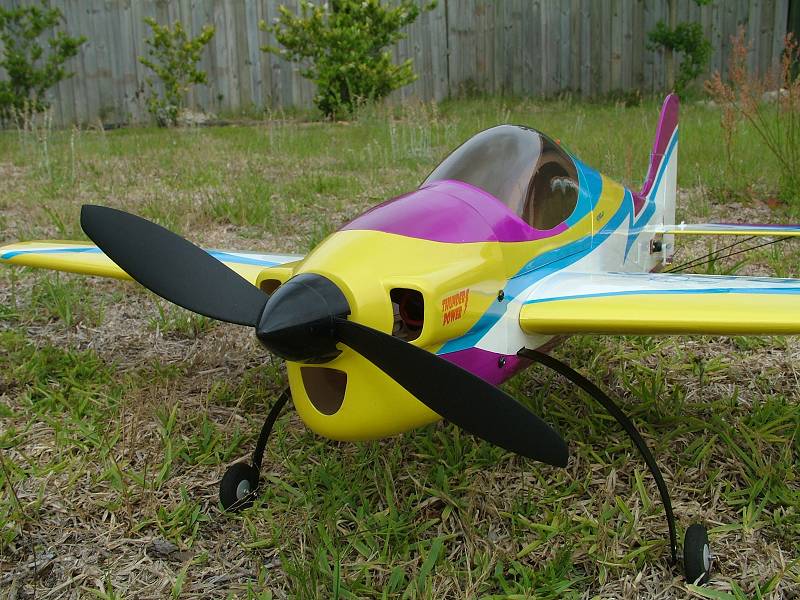

I chucked the wheel pants on mine and used the LYT53 2-1/16" wheels (5 grs each) from Hobby Lobby and used the NMP aluminum extra long fixed gear axles from Central Hobbies I had laying around. This is still about a few tenths of an oz. lighter than the wheel pants, wheels, etc that come in the box and at least I know I can taxi on a grass field now based on my experience with the Eflite Edge 540. The wheel pants are .6 ozs. by the way. My kit had some warped pieces and the rear alignment dowel hole required a touch of filing to make the wing fit. Time to get the iron out and unwarp some pieces.<g>

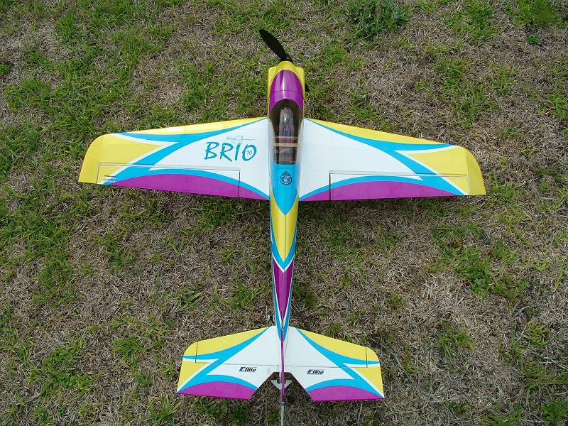

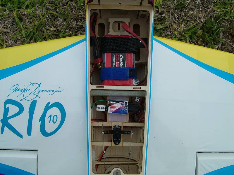

I finally finished my Brio, its all ready to fly. The weather here has been uncooperative, so I have yet to maiden it. I am using the pull/pull and the CG is spot on at 110mm. Here are some pics.
#66
Joined: Aug 2004
Posts: 3,360
From: Warner Robins,
GA

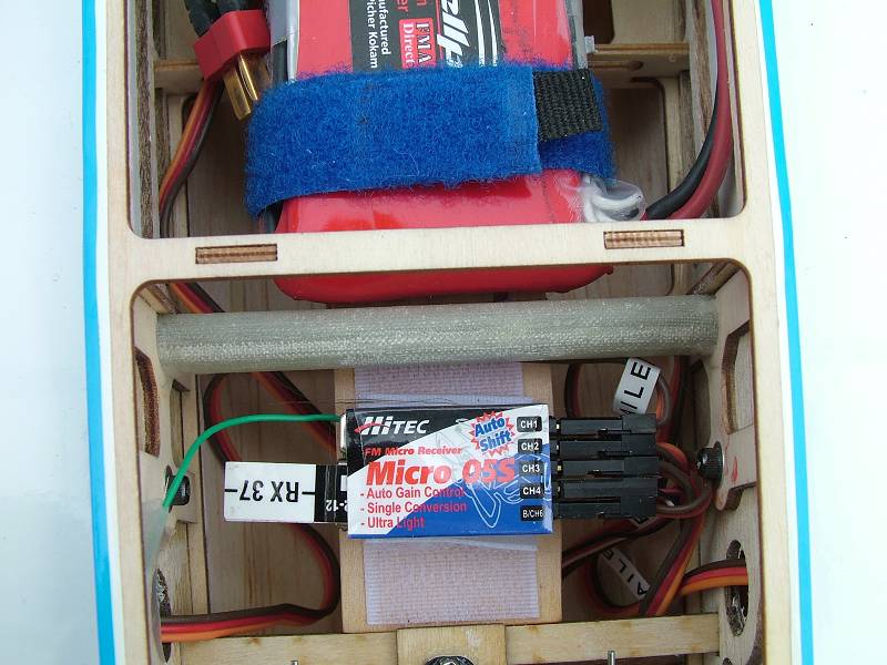

I like a clean set-up inside. I hate rats nest of wires. I built a little light ply stand in the middle for the reciever, and also added a light ply surround for the rudder servo.

Im using the E-flite Park 480. I dont run geared motors, so I dont know much about them. If you plan on using the pull/pull. Balance everything, and adjust the motor so that the CG is in the right place. I think this is why some people are having problems getting the CG in the correct space. The motor mounts arent all that great, so you have to cut and trim them so that they are positioned correctly for the CG to line up. Not sure about the geared set-up.
Fishing the cables is a little tricky. Its not like a big bird where you can reach back there to get them. A long flexible carbon rod with a hook on the end will help lots. Cross them in the fuselage, the exit holes seem to work just fine.

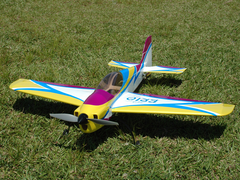

I finally maidened the Brio...
BEST KNIFE-EDGE PLANE EVAR!!!! This thing KE's like its on rails. Its definatly a pattern plane. Nice BIG loops, clean verticals, stops on points very well.
It KE's so well, slow rolls take very little rudder input. I was over controlling it in the slow rolls with too much rudder. Im pretty sure its capable of KE loops.
I thought the ailerons were going to be very fast due to their size, but at the rates suggested in the manual, its really docile, and smooth.
