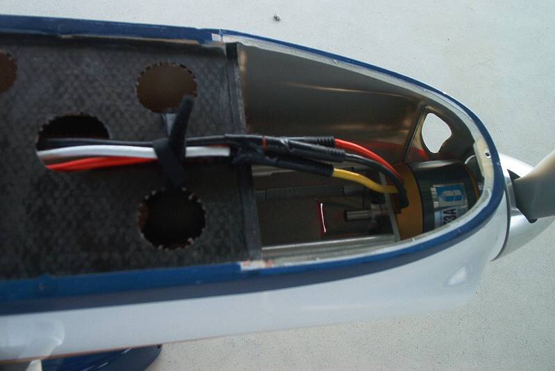

Well, these aren't the best pics in the world. The sun was blinding and my camera just wasn't happy.
But, here's a couple of pics and I hope you can make something out....

The motor mount I bought from Esprit models...
http://www.espritmodel.com/
Look under accessories.
Emory.
