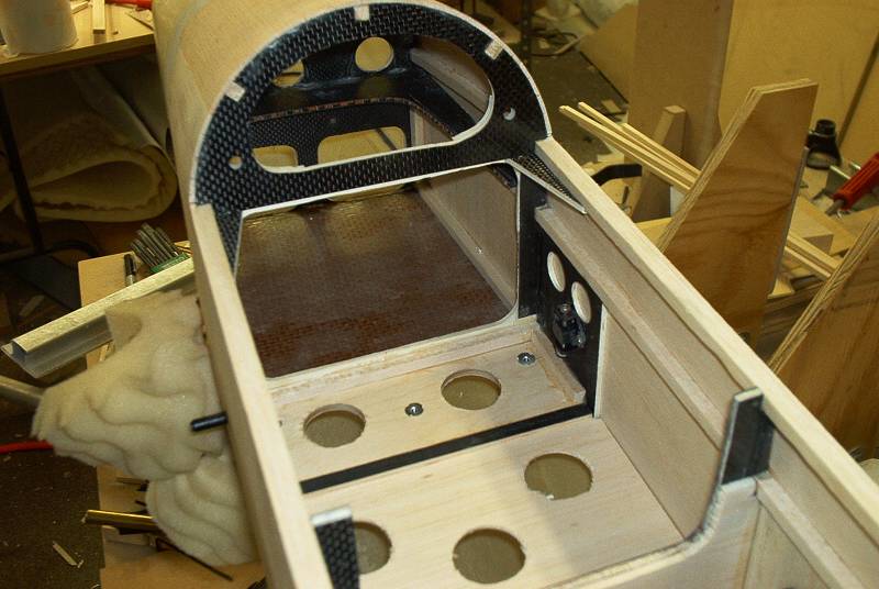

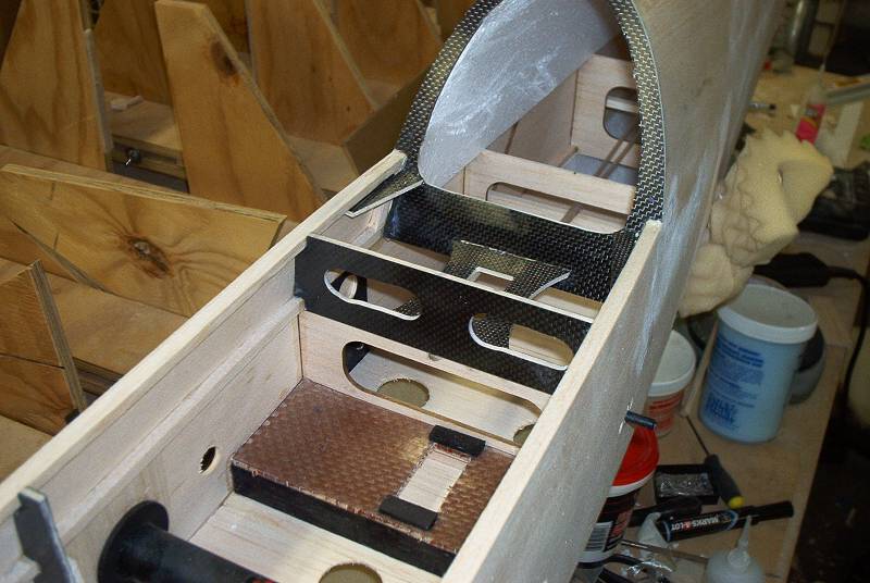

It's been a while since I have scratch build. Can you explain the construction of the firewall. It appears it is plywood with laminated carbon fiber. Also, what is the material you used for the "floor" between the firewall and the next former. It appears to be a sandwich carbon fiber material.

Well, since there is a LOT of torque on those stand offs with the outrunner, I had to make the firewall stiff. REALLY stiff.
It's a piece of 1/8" A/C ply bonded to a piece of 1/8" balsa, then laminated on both sides with 2.4 ounce C/F and .2 oz carbon tissue. Vacuum pulled to about 22 in Hg. It's REALLY strong and light.
At the points where the stand offs screw into the firewall, I used a piece of 1/2" tubing to remove a round section of the balsa from the back, careful not to get into the A/C ply. Then I installed small flush discs of hardwood dowel, and drilled...voila. Sounds much more complicated than it is
but it works great. I don't think I've ever seen Emory's spinner move even a fraction of an inch under any load.
The floor pieces between F1 and F2, and between the gear block and F3 is a 1/8" carbon/nomex panel, with lightening holes. Honestly I think it's overkill at this point. Lite ply and 1/8" balsa behind the gear block is plenty.
FWIW, I do laminate the electric firewalls here now and they come laminated in carbon. I don't cut out the discs though because that depends on your mount. I can say that the mounts we used on this plane are the cat's nippies for outrunners. Solid as a rock, but they weigh a couple ounces. You can pick the plane up and swing the whole thing by the spinner (not that I'd recommend that, but you could....)
