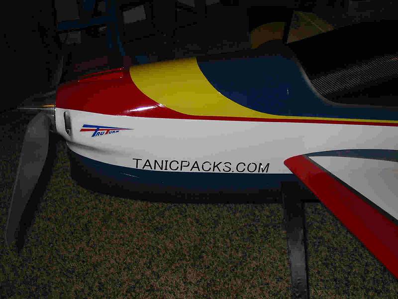

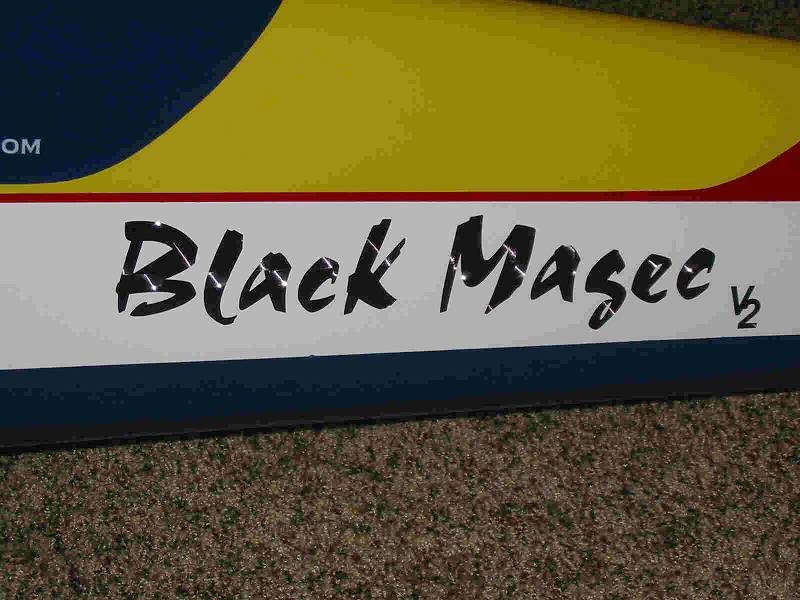

OK, here are some new photos of the electric Black Magic. I was finally able to get some graphics slapped on there. These photos are taken indoors, so aren't the greatest. I will get some new pictures taken this weekend.
