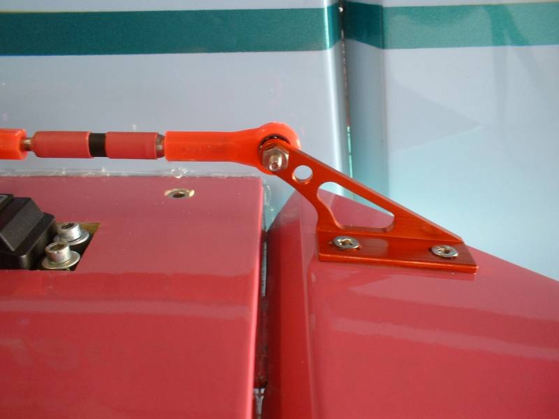

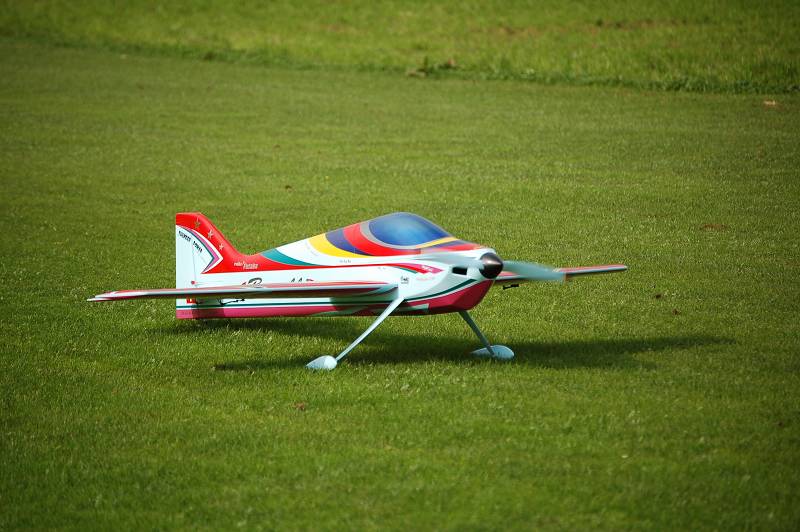

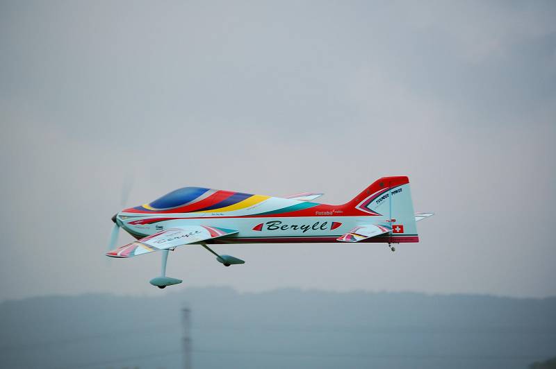

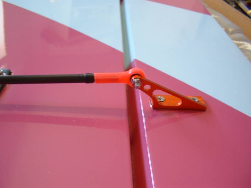

Kit weight from Oxai was 2320 grams and weight at maiden flight was 4706 grams. Will measure throws and setup tonight and post. Attached some photos.

Some general stats on the Oxai kit in grams out of the box for those that want to compare apples with apples.
Stabs 94 grams left and right
Wings 374 grams left and right
Landing gears 73 grams left and 68 grams right. If you use ZN Line gears they weigh 37 grams each.
Spats 16 grams left and right
Canopy 183 grams
Fuselage including rudder and all formers already installed 969 grams.
Wing joiner tube 57 grams and stab joiner tube 8 grams
The wings and stabs are pre manufacturred for Futaba servos and rather than butchering the beautiful finish I opted for these rather than my usual JR servos. Using 8411 on rudder and JR PCM 10 X. Out of box to fly in two days, only install radio, fix gears, spats and engine.
15 mm throw on ailerons (10 % exp) and 10 mm on elevator (15% exp). Rudder max throw with (50% exp). 8 point throttle curve as with Hacker no use for more than half throttle to fly most of the F3A schedule. Only mix is ruder to elevator for knife edge flight.
All linkages are MK, MK tail wheel and power box digi swith (only 15 grams). Control horns from ZN Line as my kit did not have these although I paid for it. No spinner was included in kit although again paid for and opted for Carbon spinner 82 mm.
EVO 20 (1200mah) receiver battery, will give more than 5 flights easy.

Thanks for the information. Our airframe has very similar weights. You have done a nice job finishing it off.
