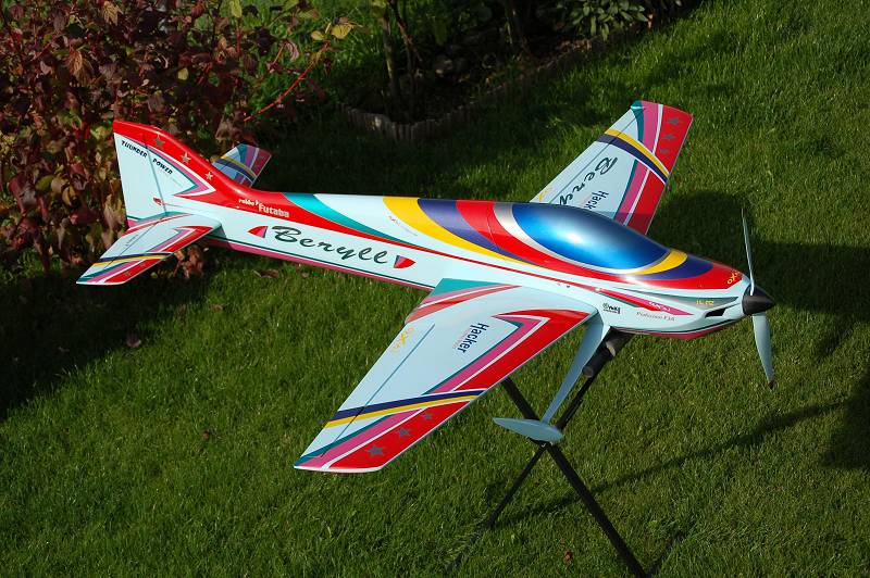

It you mean the 2005 at RMAC and you refer to Rodney Donaldson then yes. I will look at my old photos. If not mistaken that was also the year that John Mee and friends came out. Congratulations on the Beryll, you will never regret the purchase. Attach photo taken of my Beryll two weeks ago at our Masters and also group photo, you will recognise some of the pilots like Pierre Marais, Andre Stockwell and Ivan Olivier.

my memorie is still pritty good hey,yes the beryll is a great model and quality is out of this world,i will carry on now and kit the beasty out soon as possible,i will go with the hacker motor speed controller and the thunder power batteries etc.this does seem to be the best set up overall and reliable which it is all about..hope to chat more!!.
