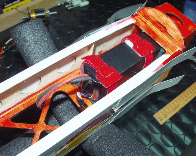

I'm just about to maiden this new ship tomorrow or this coming week-end. Here's my config:
-Xpert battery and switch for safety;
-Hitec Electron 6 /JR compatible receiver. I put Hitec receivers in most of my electric planes because the JR Sport models have issues with cold weather;
-AXI 2820-12 motor;
-Castle Creation 60 AMP ESC;
-MN48 servos all around;
-TD 4200 MHA 11.1V pack.
With the above material CG was right on at 135 mm. The lipo pack is up front (will post pics later).
As mentioned on another thread a few things to improve:
-Wheel Pants pre-drilled holes were not set correctly
-Canopy trimming was a bit long to adjust the hatch
-Accessories list at the beginning of the manual: need to add 12'' servo extensions (2) + Long arms (2 packages).
Will report on the maiden later.

Maiden done today! Plane is awsome! Lots of power with the Axi motor and the Lipo pack. Very precise, crisp and responsive. Many witnesses made positive comments. It was gaining altitude very quickly!
Unfortunately I made a quick landing on rough terrain and ripped the landing gear balsa structure off[].
For a plane of this size and weight I found the bottom structure very weak. Decided to put strong plywood piece and spread 30 min epoxy all aroung. Used new covering so the plane looks perfect!
In fact I'm glad that I had to reinforce the structure since I will be using this terrain again.

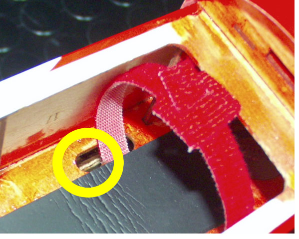

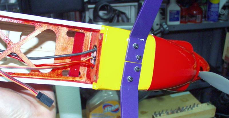

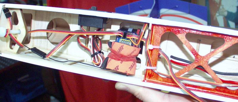

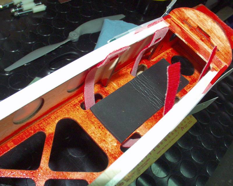

Hi,
I'm no engineer but I can't help but notice how strong and heavy are the landing gear brackets and how big the wheels are compared to such a small, weak plywood structure underneath.
At my opinion, unless you make a perfect landing on pavement, you will rip off the bottom.
In my case I removed all the bottom surface using my Dremel tool, cut a thick plywood piece and install plywood parts on all 4 sides of the piece for added strength. Used 30 min. epoxy all around. Of course I had to drill holes and reinstall the 4 blind nuts. Used same yellow covering that I had for my J3 Cub 25.
Pictures of the receiver setup and the new bottom. Inside the yellow circles you can see the side plywood pieces that also hold the bottom to the balsa structure on the side.
The result is rock solid. I don't expect any other trouble. Of course the weight has changed but hey! Now I can land on grass and rough terrain.
