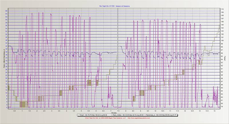

Here we go again. I was just thinking of starting a new thread on the Spin to see if anone is happy with them.
My original did not work well on the bench. Rough starting and many cutouts at all speeds. I sent it back and got a new one. The new one didn't seem to cutout but was still rough starting. I flew it in my Impact with a Hacker C50 for one flight. It was too hard on the gearbox during start up.
I then put it in my Abbra with the Dualsky and flew about 15 flights. It worked at first but didn't start and idle as well as I'd like and that is why I was fooling with the curve. The expo was neat on the ground but no good in the air. I went back to linear.
On flight 12 or so I thought I heard a cutout. This continued and then on the last flight I heard a noise that sounded like a rough restart. I landed and put in my Hacker Master 0-90.
The Master 0-90/Dualsky combo works great. Starts at 200 to 400 rpm and you can leave it there. I use from 3000 to 3500 mAh per flight on TP5300 Prolites. I'm running the 22x12 and having no heating problems.
I don't understand why they can't make the Spin work as well as the Master 0-90 and have all the added features.
A little shirter this time, Hope it goes through.
Jim
Jim

ORIGINAL: OhD
Manual brake 12% initial, 68% final (prop just stops as plane is touching down.)
21 degrees timing (was running 25, plenty of power with 21 and a few less amps.)
1.0 sec acceleration
Slowdown cutoff
Initial point auto - on
End point 2.0 (output pulse measured at 1.93...Jeti says to be less than measured for high stick but full throttle was reached too early)
Auto inc end - off
Expo throttle curve (12Z transmitter, 3 point spline, point 2 at -17, +22 rate)
I fly with an idle up set for about 400 rpm (once motor is running...just flipping on idle up will not start the motor.) I went the idle up route because a few times early on, after an extended down line, it would make an awful noise on throttle up if I got into the throttle too quick.
Scott

Have you checked M, Amp and Volt data recordings against a known source? My logged RPM data was ok, but Volts and Amps weren't even close.
Don

I'm running the Spin 99 with AXI 5330 FAI and TP 5300's. I didn't like the 1second throttle and back that down to .3 sec. Linear throttle. I've played with timing and can't tell a huge difference...I'm between 23 and 25 degrees (24 default). I'm flying a DX7 so throttle curve isn't available. I just initialize the ESC with the throttle trim pulled back about 15 clicks, then click the trim up to near neutral. If you click it up far enough to actually start the motor, it will be a little too fast for "idle". but there is a range where the motor will continue to run once started by stick movenment just before it starts from trim movement where it idles well.
The only issue that I've had with the ESC is the "horrible noise after extended downline" that someone else mentioned. I'm guessing that it has something to do with the windmilling prop being driven faster than the esc can keep up with, but I'd sure like one of you smart guys to tell me what it is and how to fix it. I haven't used the brake, and perhaps that would prevent overspeeding.....?

Hello again folks,
I put the Spin back in my Abbra with the Dualsky 6360 and have flown 11 more flights. I've had no cutouts or big noises in the air. I've tried timing from 21 to 24 degrees and acceleration from .5 to 2.0 seconds. The big problem is starting especially the first start of the day. It wants to run backwards. I try bringing the idle trim up slowly and bringing the stick up fast. Neither works. The best compromise is to set the idle trim where I know it will idle after it starts properly, and then start it with the stick. Sometimes it still wants to start backwards and it won't stop by bringing the stick back but only when the trim is also pulled back.
I could defiinately feel the lag in acceleration with it set in the 1.5 to 2.0 second range. The change in timing was not significant as far as I could see but the low timing and slow acceleration seemed to conserve energy. I used less than 3000 mAh on all flights that consisted of just the masters program. With many extra maneuvers I was still under 3500.
I guess one could get used to it but after seeing how great the Jeti/Hacker Master 90-0 works I'm not completely satisfied. I failed to mention that I've had the brake turned off through all of this. I guess I should try it to see if it affects the starting.
Jim
