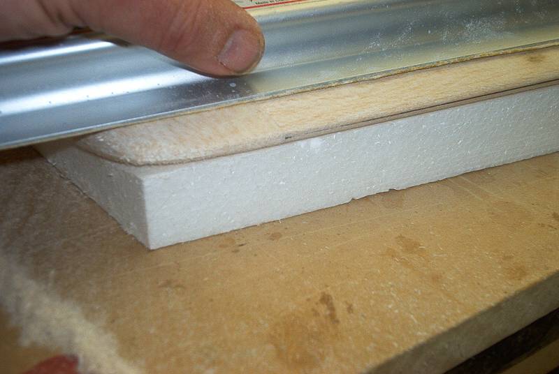

Capping the cores

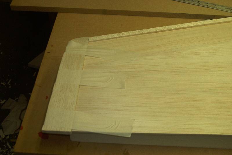

First, trim the LEs of the wings, stabs and fin down fairly close to the core. Sand this flush using either a block sander or long, stiff bar sander. be careful to keep it all straight and true, and don't sand too much.
Cut out a piece of capping for each core. The Wing and Fin LEs are made from 1/2" contest balsa, and the stabs are capped with 3/8" contest balsa. Cut these a little oversized so you can trim them back.
Glue the LE caps in place with polyurethane glue. All you need is a thin film, just enough to be damp. Anything more is dead weight. Spread it on with a finger and then go over it with a paper towel. if it's just damp, it's perfect.
Tape the LEs in place with masking tape in numerous locations. Pull the tape snug so there is no gap.
Let the cores sit for 6-8 hours before trimming.

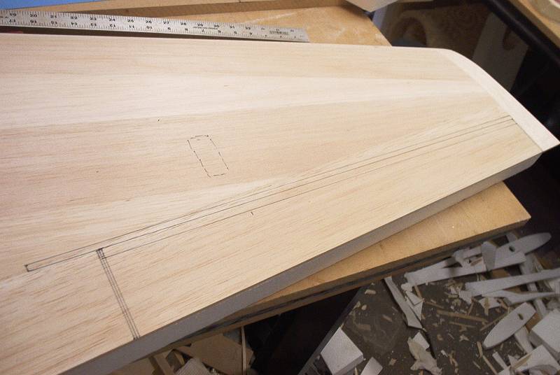

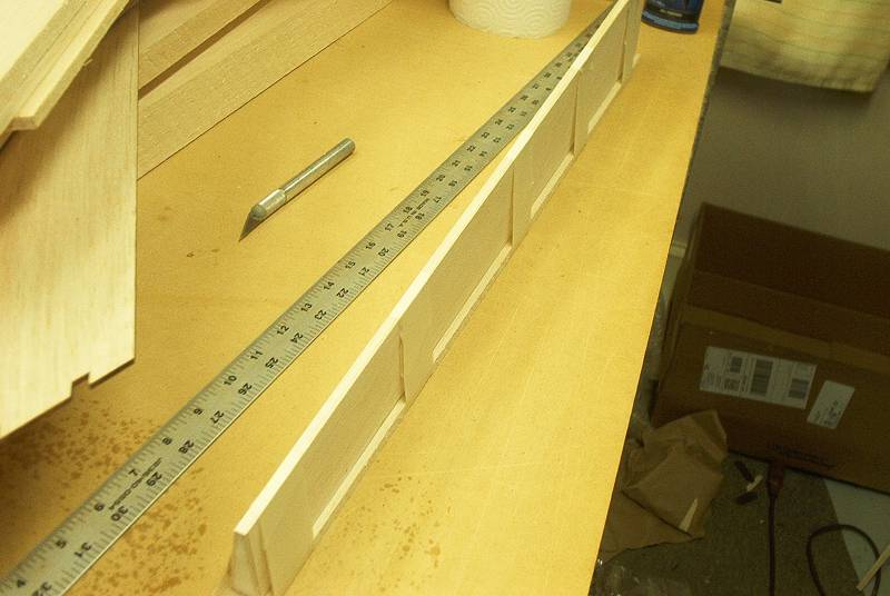

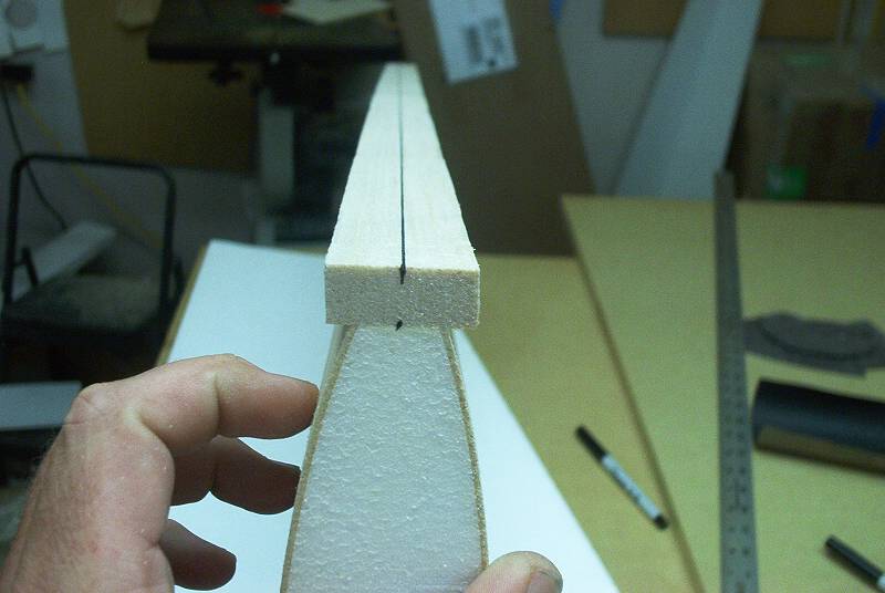

After a few hours, you can remove the tape from the LEs.
Trim and sand the tips flush at this point. Take care to keep the tip face at a right angle to the center line of the wing. Rough sand the roots flush as well. DO NOT final sand these, just get them close.
Make marks at the center of the LE capping where the core meets the capping, and one mark at the center of the TE capping. Using a straight edge, make a mark on the face of the LE capping at the root and the tip.
Use a straight edge to make a line donw the center of the LE using the reference marks. This will give you a reference to sand to.

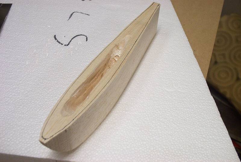

Now prepare the tips. the wing tips are made from 2" contest balsa blocks, hollowed as much as possible. Roughly trim it to shape.
The Stab tips are made from 1" contest balsa.
On the fin tip, I normally stack 2 pieces of 1" contest balsa, and sandwich a piece of .007" carbon between them. This stands up vertically and gives this piece a lot of stiffness.
Using the same method as the TE with the polyurethane glue, attach the tips and tape firmly in place with masking tape.
Let all of this cure overnight.

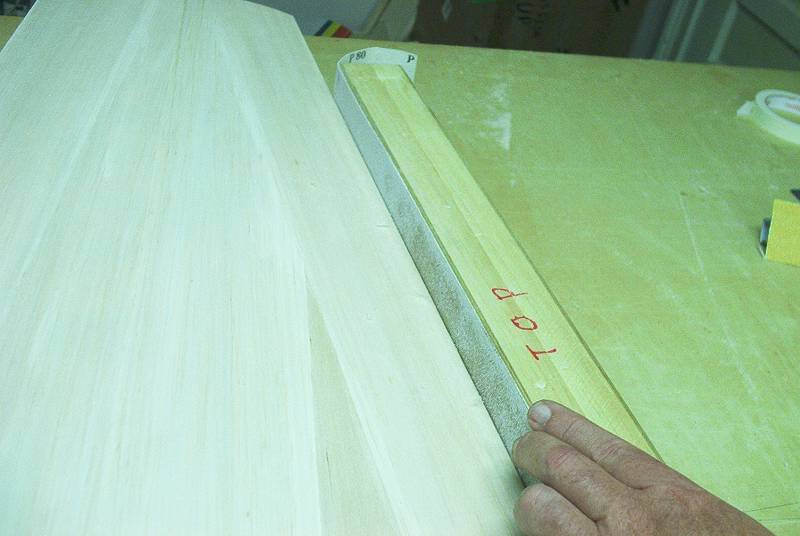

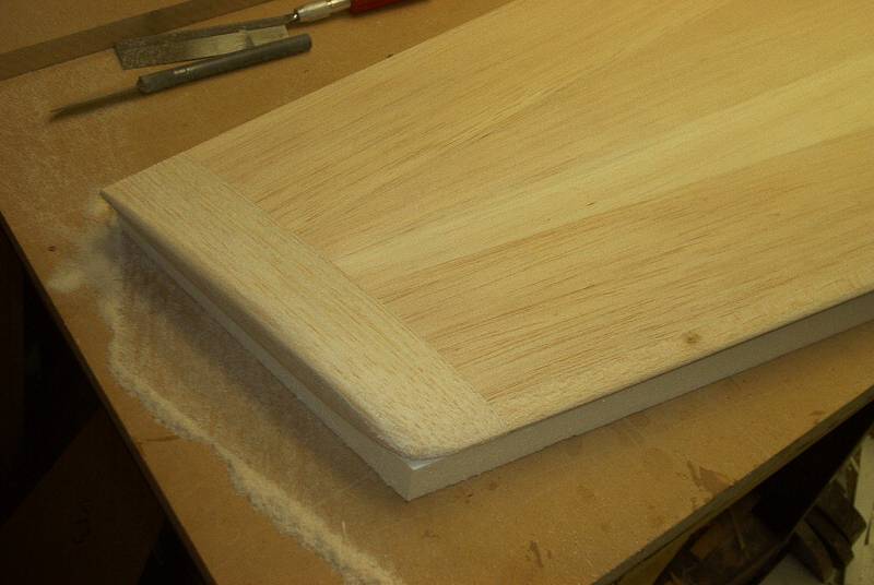

After the caps have cured overnight, it's time to sand them to shape.
I suggest a 14" sanding block (or so) with fresh 80 grit sticky back paper. This takes a lot of the work out of this step.
Start by sanding the tips flush with the wing panel. be CAREFUL that you don't sand into the skin here. Block control is critital. Just take your time and pay attention to the angle of the block. If in doubt, apply some masking tape to the skins and that will "warn" you if you're getting out of shape.
On the leading edges, first sand the LEs flush to the wing or stab or whatever, at about the same angle. Again be very careful here.
After The LEs are "blocked" to the contour of the core, start turning the corner, a little at a time, toward the center line. Keep it round.
Once you have achieved a roughing in of these shapes, STOP. Don't do any more until completion of the plane.

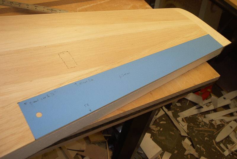

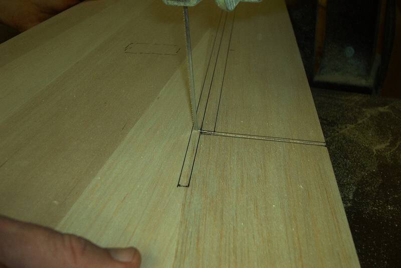

Now we need to mark and cut out the control surfaces.
The best way to do this, starting with the wing, is to make a poster board template. If you just free hand it, you're less likely to get it equal.
Mark out the cut lines, the relief lines for all of the capping, and the servo boxes.
It's critical to extend the wing capping into the wing about 2 1/4" or so.
Make all of your marks on the bottom and leave the cores in the top shuck for cutting.

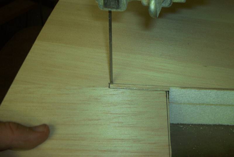

The best tool for this job is a band saw. You can cut it out by hand if you mark both sides and trim/sand to the lines, but a band saw makes this job painless.
Make certain your band saw table is 90 degrees to the cutting blade. begin your cut carefully and cut about 1/8" away from the actual outline. This will allow you to sand to final position for a perfect fit.
Cut out the ailerons, and then trim away the excess material.
-M
